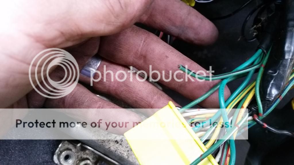

I haven't checked that green/black wire yet. Though I will when ready to finish off the engine harness

And this wire. No place for it to go to in the harness:
Went to tracing wires yesterday. Found the Green/black stripe wires are for Sensor grounds, and this wire should run to pin 24 in C-61. There is already a solid green wire there, so it looks like someone already replaced the bad wire, but left the remnants, so that is good news.

Harness is still flaky. I have removed it twice more and tested all connections. Still causes the MPI relay to flicker over bumps, killing the car and resetting the DSMLink to back to firmware (I need to update the firmware to a better tune than stock). So, bought a new harness off Pot. Hoping for good results.

Swapped out the current harness for the harness I purchased from Pot. Did it in 45 minutes from start to finish, including the removal/replacement of all panels and glovebox. Impressed myself (although this also indicates I have R/R'd the harness too many times recently to get very efficient at it).
Everything works as it should now (although I get Intermittent TPS errors, I got these before, so I guess the TPS is bad) and I can reliably drive it and give her some WOT tuning now, as she is running stock rich when getting on it. The new harness is unmolested (except for some twisted and taped connections for the O2 sensor wiring that I corrected) so I will take the flaky harness and make it the new/future tucked harness, slowly replacing all the wiring I can with new wiring and shortening everything up to make it nice.
