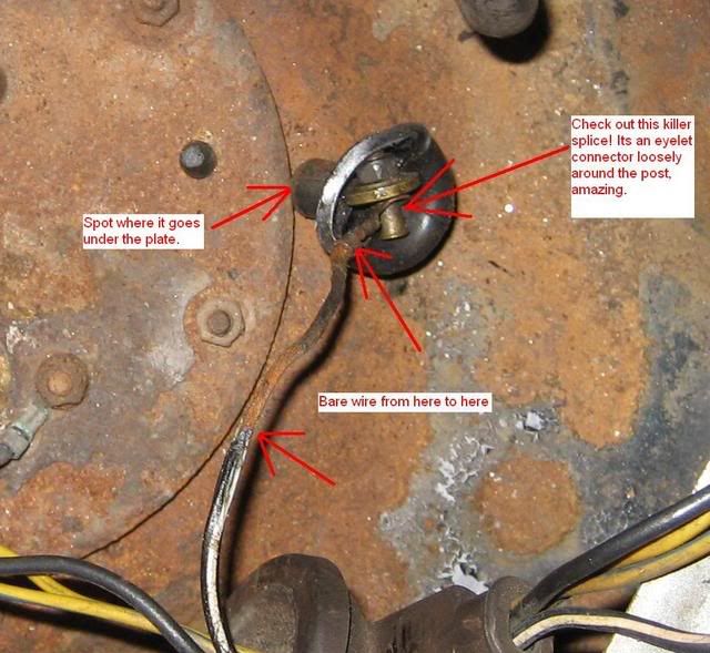

No wonder my car stinks of gas a lot of the time. How incredibly dangerous is this situation? Last time I filled it up there was gas everywhere, pouring out from under the car near the gas cap, and even in the trunk. After removing the cover this is the sight I was greeted with:
The PO said the pump was upgraded to a walbro 255... So it looks like they removed the 12V supply wire from the pump assembly top plate and left the hole open, then they have it coming up between the plate and the tank I dont get it.
Its so rusty in there, it doesnt look like the pump has been out in years and years. Im going to follow the Vfaq for upgrading the fuel pump to remove it some time this week and see whats going on. I wonder how much of this Im going to have to replace?

Yum! That looks BAD! That wire could have shorted out at any time, possibly starting a fire with all that gas that would be around because of the seal not being comolete. Glad you found it before coming to any harm!

I disconnected the battery and removed all of that black tape that was on the 12V wire, take a look at this pretty picture:
Damn I have been really really lucky.

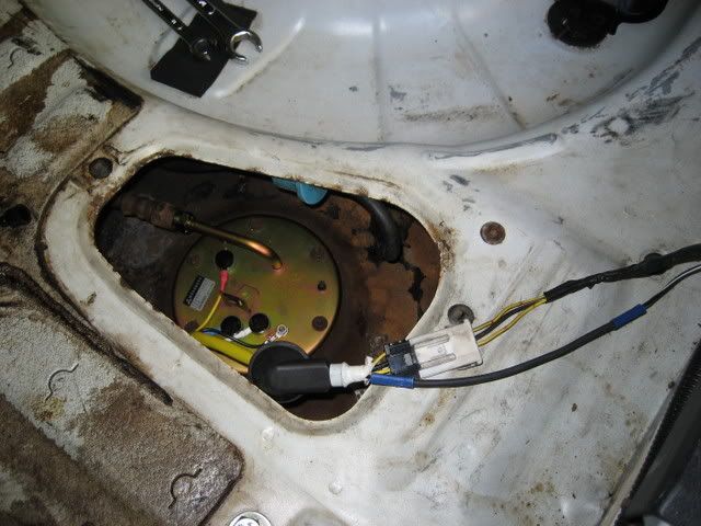

Lol, here is a photo update!
Man, in addition to that shitty splice above with the eyelet and post, this is what I found under the rest of the black tape. I cant imagine the losses the current had going through this line:
PB is amazing stuff... I went out and picked up a can of it and 14mm and 3/4 flare wrenches. It was a bitch, but not at all as bad as I was expecting:
Success!! (*edit: my wife said I was stupid for having that picture here lol)
I have taken that post off the 12V line and routed it back through the hole in the top of the plate. I plan on splicing the wire nicely to the source:
Any suggestions?

i wound up using a bunch of heatshrink tubing over the wire where it passes through the sending unit. i just kept adding a piece, and shrinking it, unti it was coser to the diameter of the hole. i mixed up a little epoxy, and filled in the gap with that. that way its solid, and sealed, and the edge can't cut through the wire...glad you got it apart in one piece. nice work man!

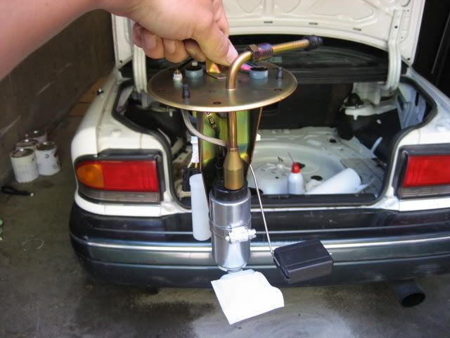

Lol, the point I was making wasnt really the condition of the sending unit or pump. It was the incredibly horrible hack wiring job that was done. That was the cause of the gas smell in the car and the spilling problem when the tank was full.

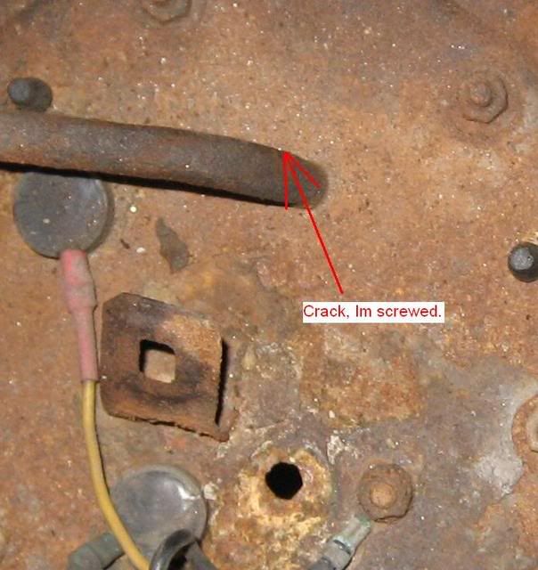

Well goddamn it.
Now what. It looks like I will have to replace the sender. Man what a let down.
I started it up and I was happy, went back to look and there was gas streaming down from under the car. I was praying it was just something that was not connected right and it turned out the pipe was cracked. Shit!

aw, that sucks man...i was hoping all was well....you can mod it like the directions abouve, or if you order one from the dealer, they are quite pricey, and i think you have to get the stock pump with it as well. i don't remember if they are still available, so keep us posted. good luck!!

Well we are right its not the correct part. I called him back and confirmed its just the float assembly for the fuel gauge. The whole pump assembly is the only way you can purchase this part.
Wow thats horrible. $610 is the number.
*edit: the part number is MB831333

you might be able to rebuild the housing...

+1 i believe you can remove the tube in question, and wld in a -6 an port to tie into the hard line, i think you need an elbow as well, but that would be it....was the link above what showed that?? i know you can only get the sending unit with the pump etc. i ran into the same issue, but was lucky enough to get a new SS unit from Dentsport. this was like 2 years ago though, i din't think they have them still...

Here's an easy way to fix that cracked fuel line...scroll down a bit until my post(s).

Well here is the deal, I was so close to pussing out and leaving the stock pump on there because i was deathly afraid of screwing it up transferring the walbro over. Also the filter on the walbro was disgusting and i didnt know if the stock one would fit. But I stuck with it and set it up beautifully (imho), the stock filter fits fine.
So I tested it and its not actively leaking, but... I didnt use any tape or dope on the fuel fitting threads and it seems like its seeping from there. Its not dripping yet but if I touch it after its been running I feel gas. Is there a special type of dope to use with gas or can i just use what i have? Or did I not tighten it enough, Im nervous to over-tighten lol.
I have a few nice pics that I will upload after I resolve the fitting issue. Thanks again.

you can use some pipe dope. alot of guys shy away from thread tape as i think it breaks down. i used that around the lines on my regulator, and they have been fine for 2 yrs. if you have the pipe dope, use a bit of that on the threads, and cinch it down pretty good. i had a few small leaks in other areas when i converted the whole system, but a quick 1/2 turn more and they sealed right up.

Thanks man, i ended up backing the fitting out again and tightened it up and now its not leaking at all, didnt use any dope. woohoo!!

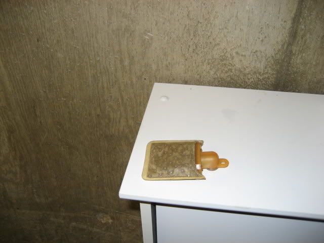

Dirty old walbro filter:
Walbro on new assembly:
And here it is installed with no leaks!!
Thanks again for the help Aaron, and thanks to GVR4.org for giving me the confidence to work on my fuel system. Now Im heading down to the junkyard for a good cover, the one I have isnt airtight, I dont know where its from here is a pic:

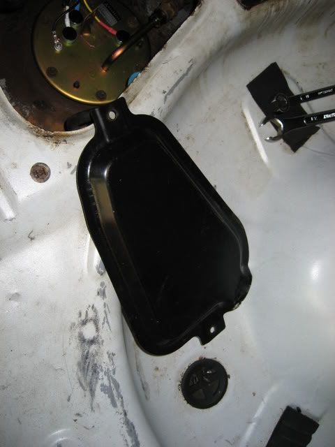

Bleh I just realized when looking at the pics that I will have to cut that 12V line again to get it through the good cover if I get one, oh well.

just run a bead of RTV around the flat edge of the cover, and let it set up before you install it. when it's still semi soft, but not sticky, screw it down kinda loose, and let it cure. when thats done (probably overnight) cinch down the screws, and voila! instant sealed gasket! good work, glad we could be of service!

Last night was the big test... I drove out to Jersey to meet up with a friend and I filled the tank! It was amazing I was able to tell them to fill it up and it actually stopped the pump on its own!! Not a drop of gas on the ground and not the slightest hint of gas smell in the car.
Only thing is I might have kinked the O ring on the top of the pump when I installed it into the assembly. When I left the car for over an hour it didnt start on the first turn of the key, but it did right away on the second. I will know for sure when I try to start it this morning.

Hey how bad do you think it is to have the connector down under the cover thats in the trunk instead of being in the trunk itself? Mine didnt reach with this cover I have, and I didnt find a good one at the junkyard yesterday. Its just under the cover, doesnt look like it would be exposed to any water or anything there.
steveGalant VR4.org Administrator
(Key Fob Guy)
05/10/07 09:38 AM
Re: Fuel Pump Nightmare (pics)
You mean the rubber plug/grommet that the wires go through wont be mounted to the cover plate?

The cover plate I have (see above pic) doesnt have the hole for the plug/grommet thing. It has a bent up lip that allows the wires to go through there. The connector doesnt have enough slack to be on the trunk side of the cover plate so its just under it in the well for the pump assembly.
Its probably just temporary because I want to find the real cover that has the hole for the plug/grommet.

Should be fine, just make sure nothing gets pinched or rubs through.
