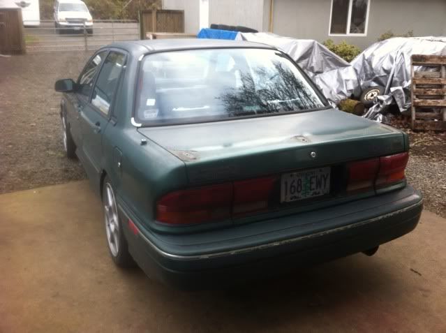

Well since I finaly realized that my intro thread was turning into a build thread I figured I would do things the proper way.
1991 vr4 1865/2000 non sunroof
My plans are 400 ish hp, relocate the radiator forward 2-3 inches to accommodate room for a bigger turbo. Also have plans to upgrade bushing,suspension,coilovers exc. I'm swapping everything from my 93 talon to keep this peice of history alive.
Now onto the pics. Feel free to ask questions as I may fail to explain everything in the pics.

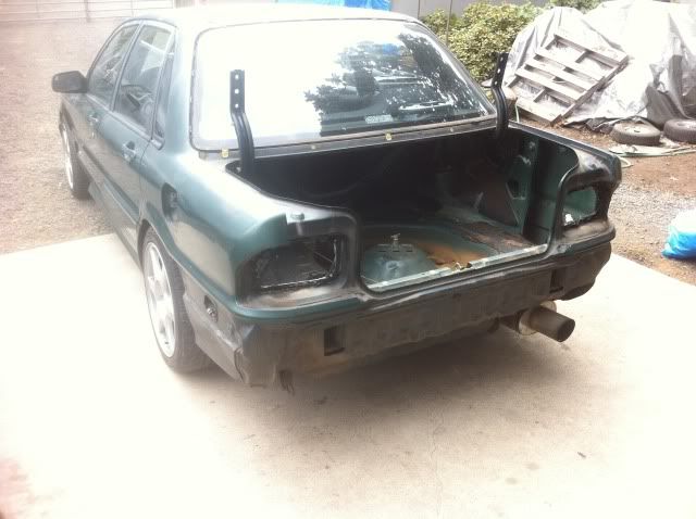

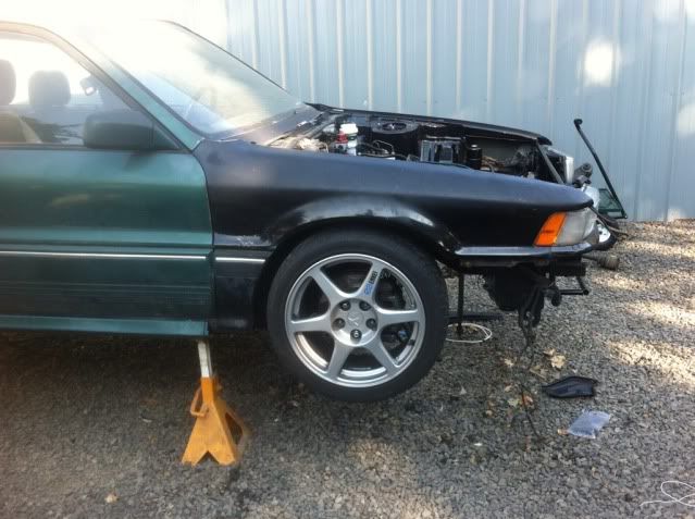

Kind of a standard modification if you own a vr4. A jdm bumper.

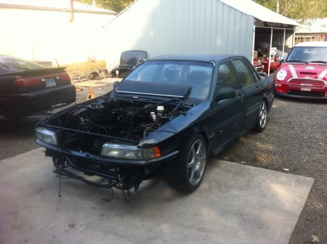

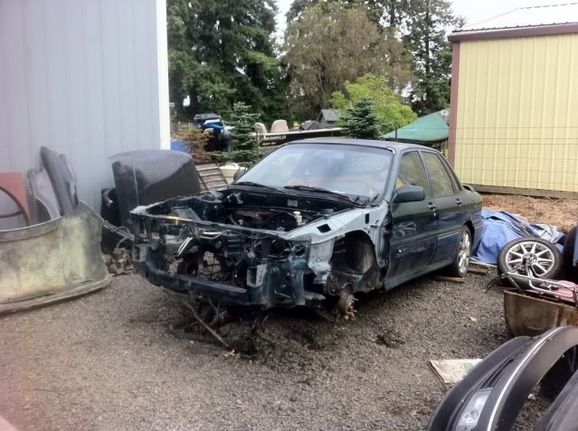

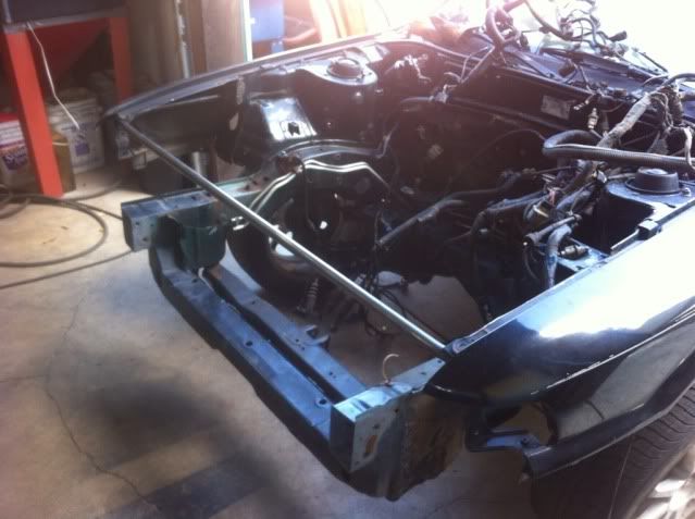

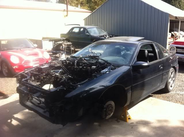

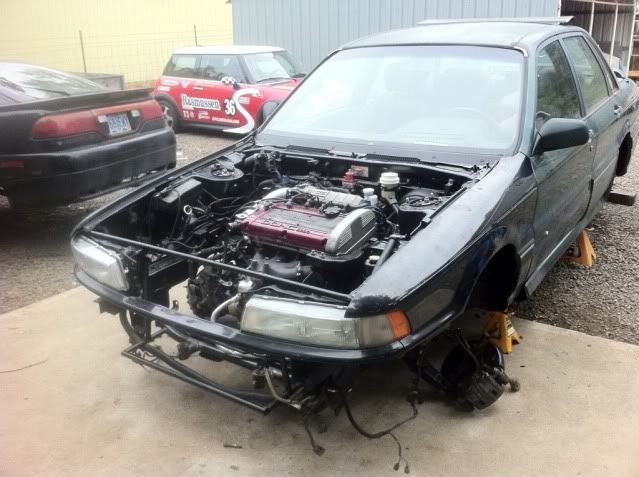

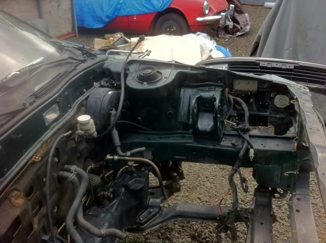

The start of the disassembly.
Noobsauce
(Member)
08/02/12 01:16 AM
Re: 1865 track day and DD

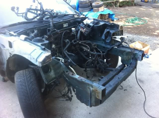

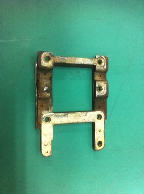

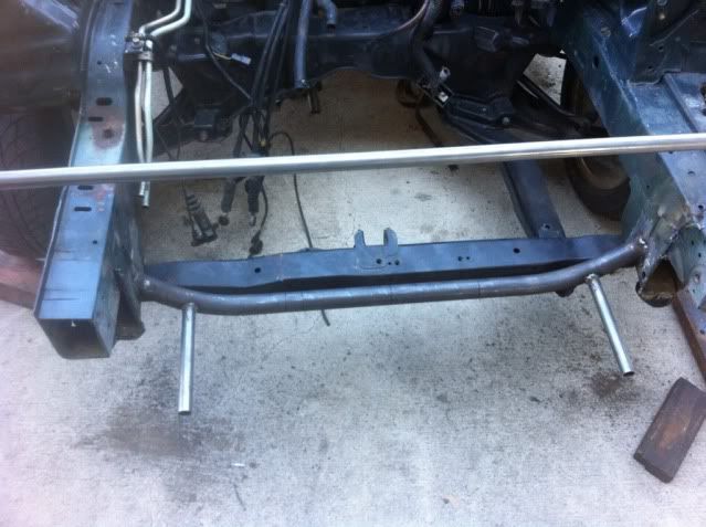

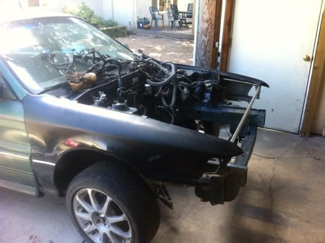

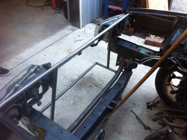

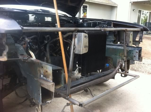

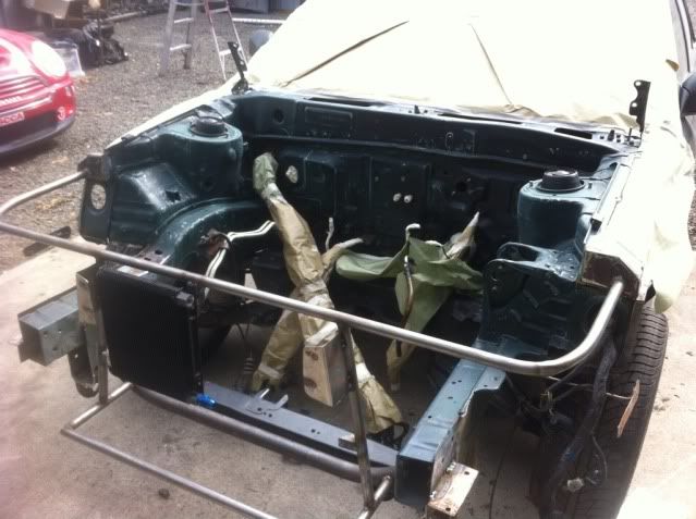

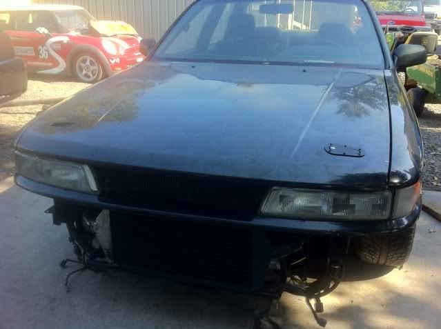

Time for cutting. FYI the front was damaged and needed to be removed anyways. If it wasn't damaged I Probably would have left the front core support alone.
Removed the front support after bending and welding in a new replacment.

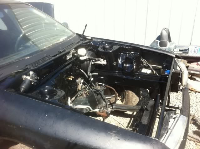

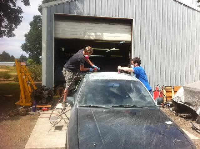

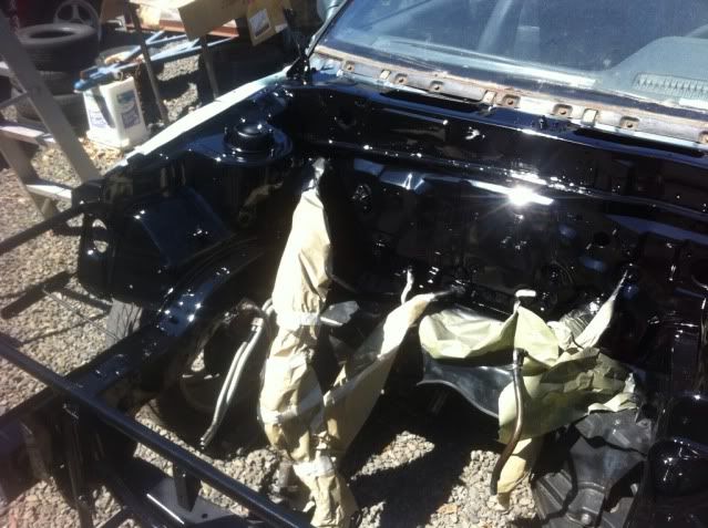

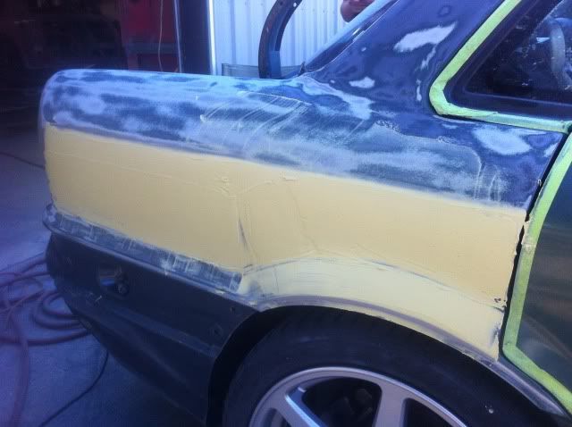

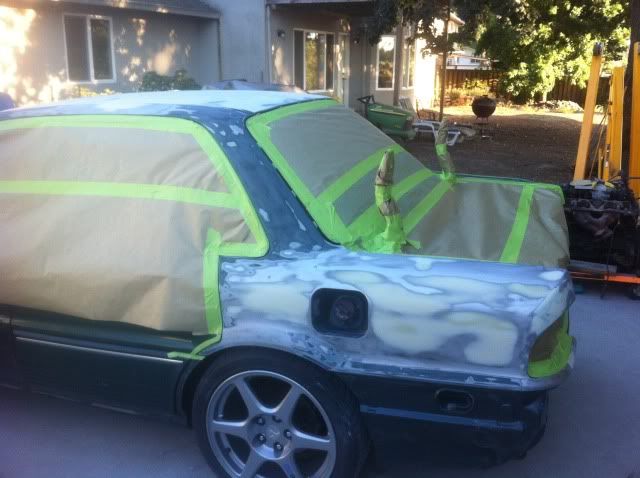

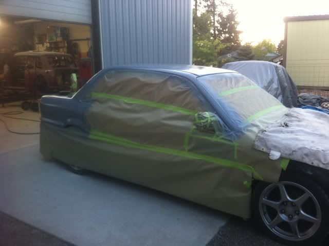

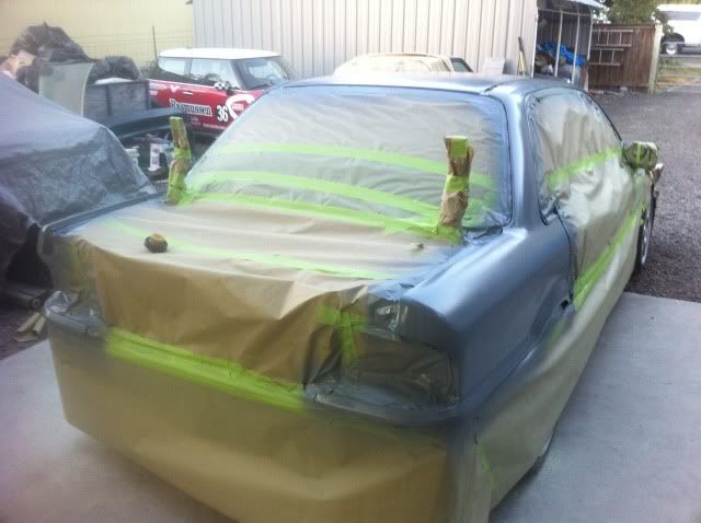

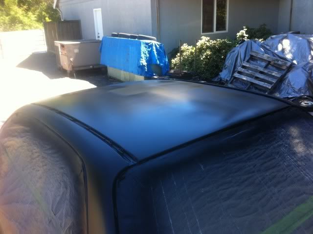

Time for sanding,priming and painting.

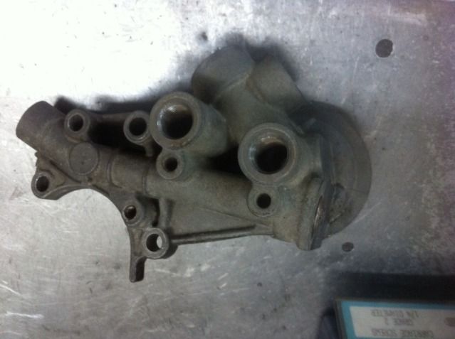

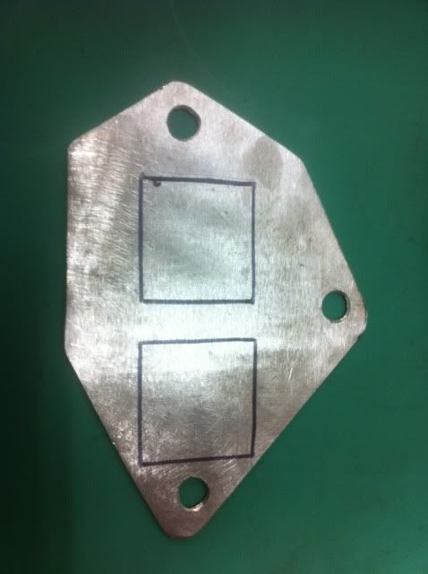

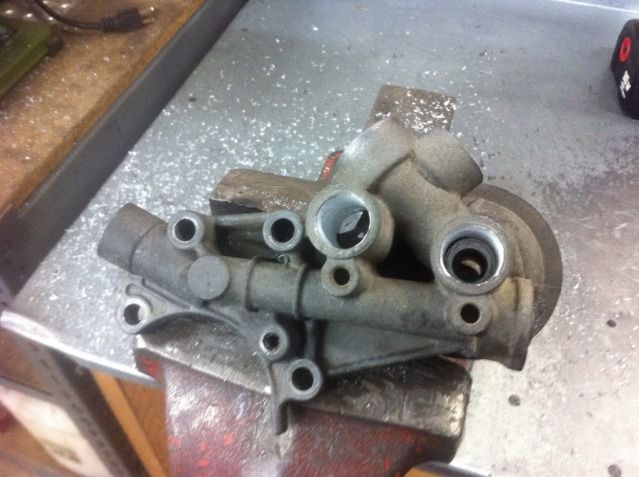

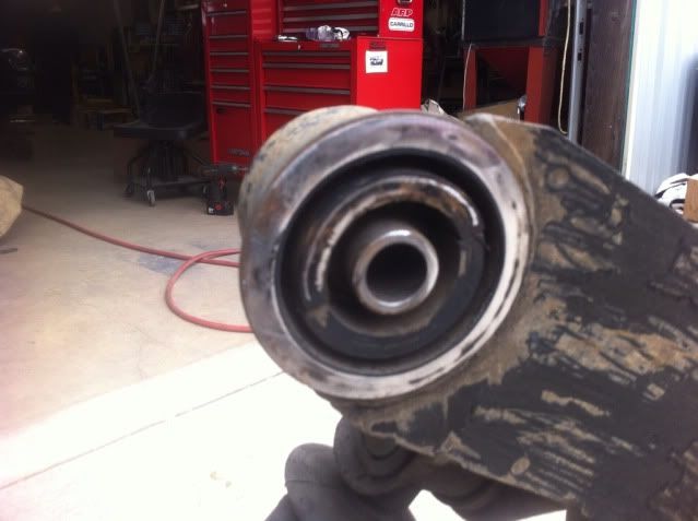

Pulled the front subframe today. Getting ready to install poly bushings. While removing the frame one of the mounting bolts snapped off in the body:(. So looks like I will be ether drilling and re theading or cutting the head off of a bolt sticking it in the hole. (there's about 1.5-2.0" deep recess Before the threads start) and welding studs in.

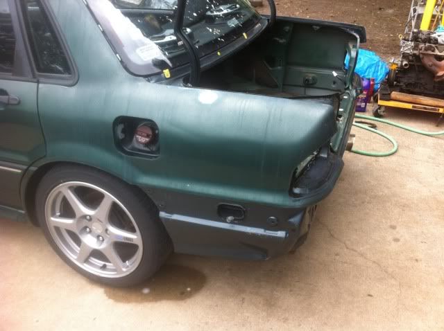

Pulled the rear subframe today. It was 97, I think I hit the sweat part of blood sweat and tears haha.
Noobsauce
(Member)
08/16/12 01:15 PM

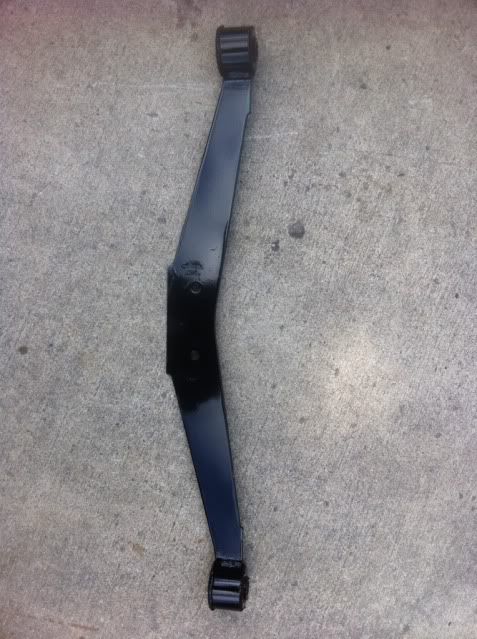

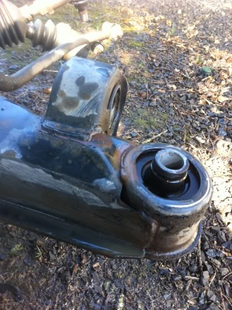

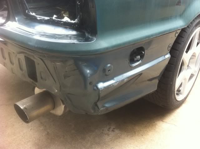

Started the cleaning of the rear subframe and found out its bent at the mounting point.
It's also bent at the trailing arms mounting point. Minor setback since I can just use the talons subframe when the time comes to dismantle it.
Here is a pic of the straight side as a compairison.

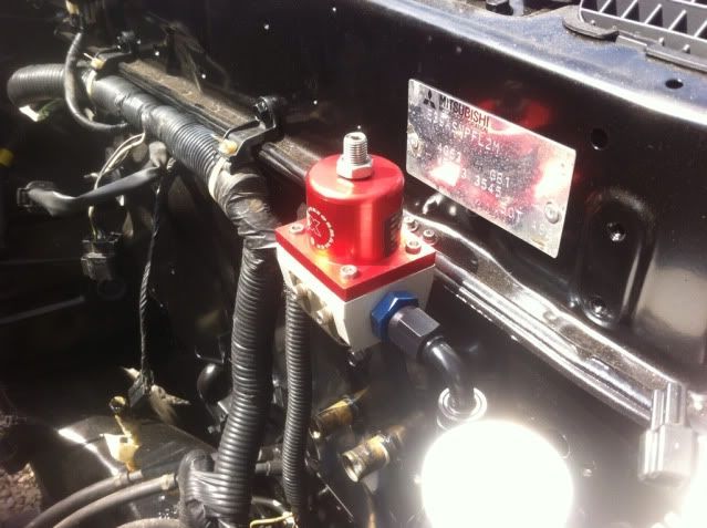

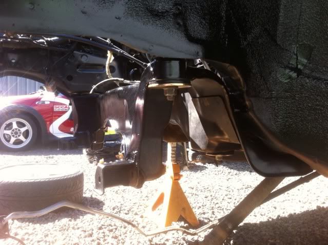

Installed the cleaned up wiring harness as well as mounted the pressure regulator.
Also started solid mounting the rear subframe.

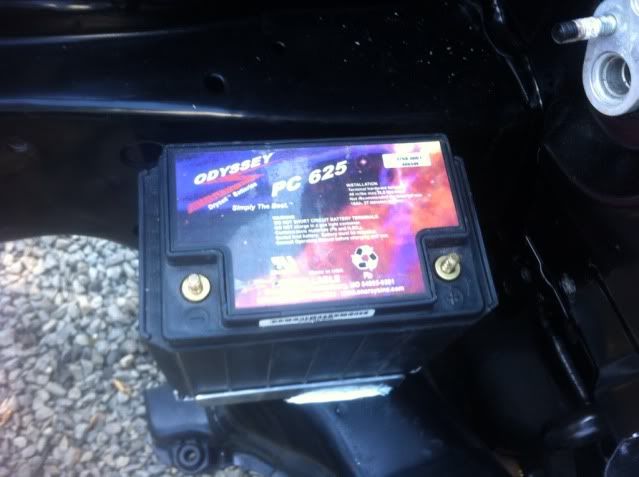

New battery and custom battery holder

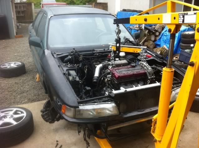

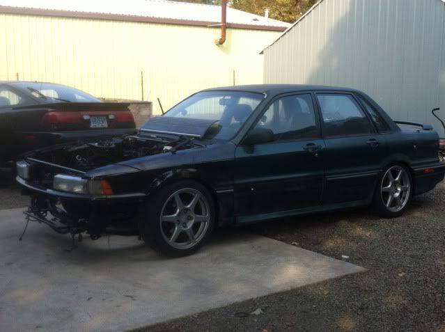

Removed the engine and trans today as well as the coilovers.

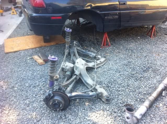

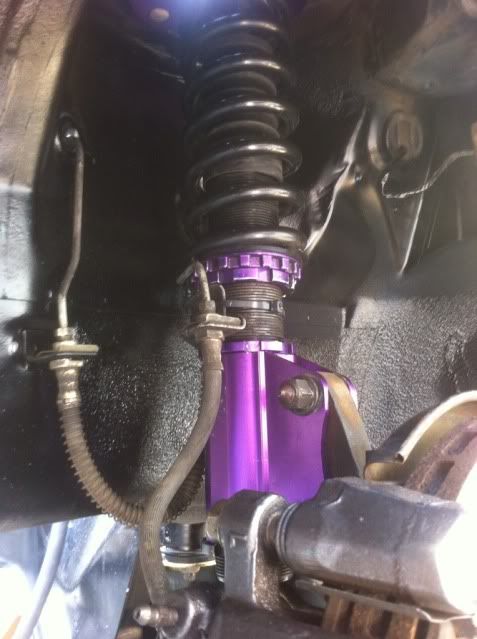

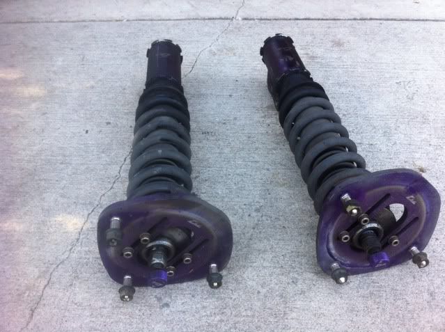

Well I got ahead of myself today and forgot to take pics of the cleaned up coilovers. Tomorow I will take some installed on the car.
Today I swapped the ABS delete,front 5 lug hubs,front coilovers,talon PS rack, poly swaybar bushings and talon PS res with lines.

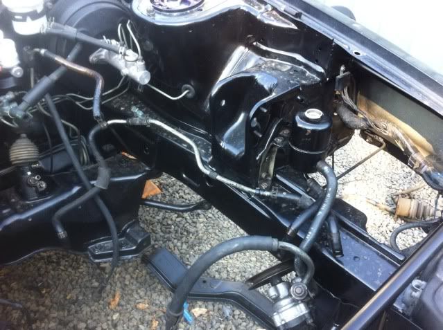

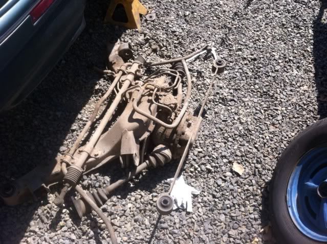

Here's a pic of the front. I haven't cleaned the calipers Or rotors because I will be swapping them out for brembo rotors and race calipers.
I also removed the rear subframe from the talon. Ready for cleaning tomorrow.

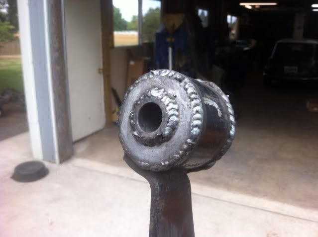

09/19/12 09:05 PM
Completed alot today. Welded the washers onto the subframe,installed subframe,blead the brakes,put the wheels on and dropped the car off the stands.

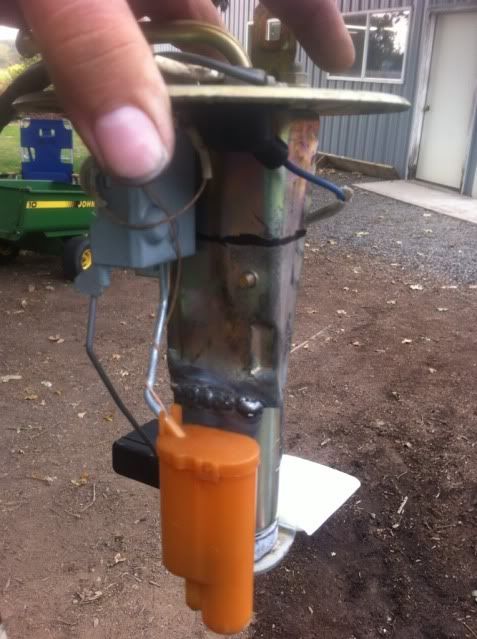

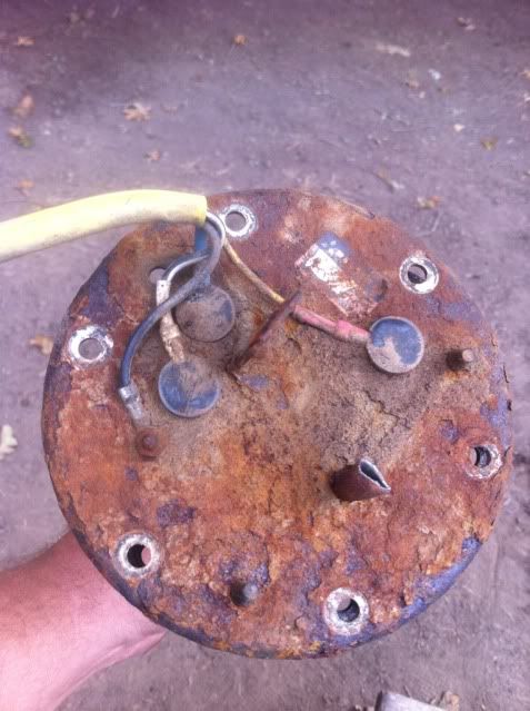

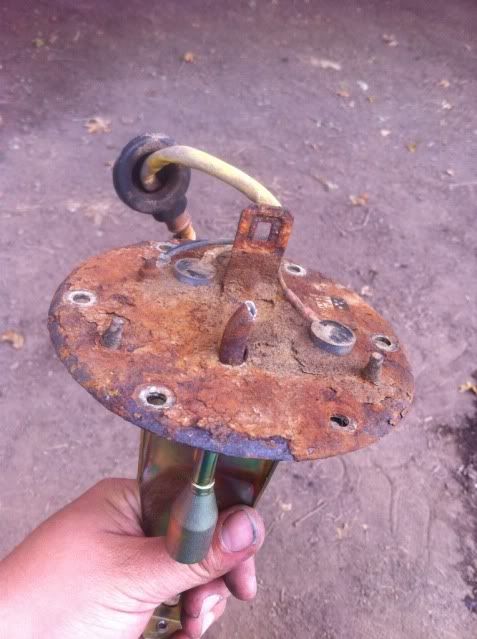

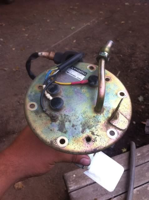

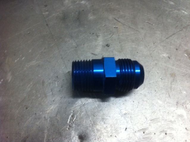

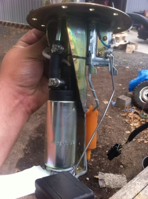

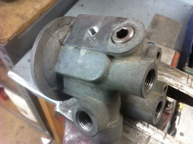

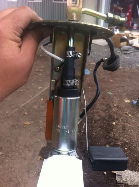

Ready to install the Walbro 255 and found this shit!
The hanger is to rusted to use so I broke the fitting to hopfully save the hose. I then bead blasted the fitting and soaked it in PB blaster.
Looks like the hose will be ok.

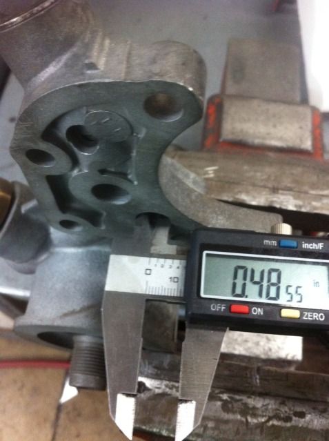

Since the FP is toast I figured I would modify a 1g dsm hanger.
I had to cut and weld the hanger from the 1g to make it fit properly. Took 1 1/4" to match the stock hanger.

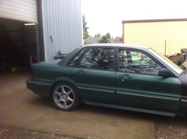

Adjusted the front and rear coilovers so the car sits higher. Was able to weld in the lower radiator mounts and dropped the engine in place.

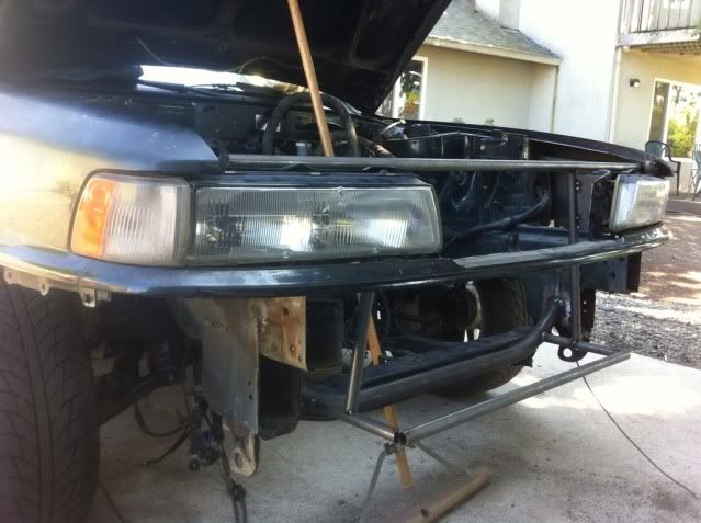

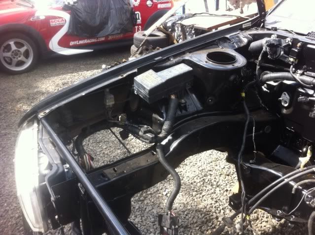

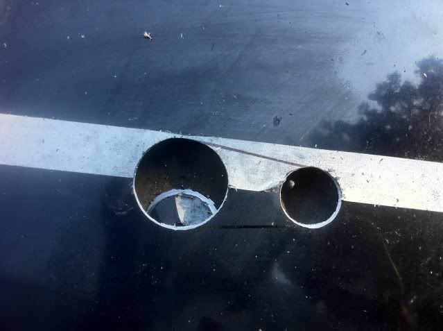

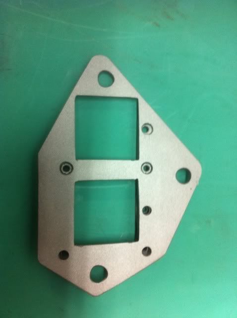

looks really good, do you have any close up pics of how you mounted up the headlights? I want to do the same thing to 1320.
EHmotorsports
(Capt Fabbin Stabbin)
09/26/12 01:08 AM

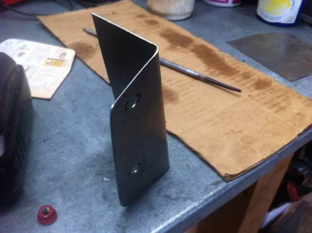

First thing I did was bend a peice of sheet. Drilled the holes and welded nuts to the backside.
Then I welded the brackets to the front bars.

Why is your suspension set up for caster adjustment, and no camber adjust?
(Hard Snarker)
09/26/12 07:08 AM
Because he pulled those coilovers out of a DSM. The bolt pattern for the top plate is different and they will only fit if turned 90 degrees. I had to use new Tein e39a plates on my JIC coilovers since they came off a DSM as well. Otherwise mine would have looked the same way.
EHmotorsports
09/26/12 10:44 AM
Exactly what Turbowop said. I'm shooting for 2-2.5 degs of negative camber but also 4-4.5 degs of caster. So far I very roughly have -1.8 camber and close to 4 of caster.

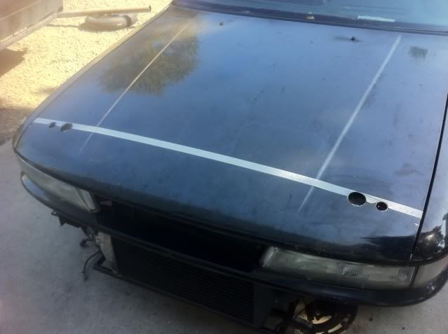

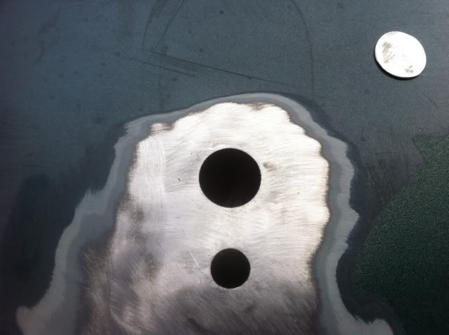

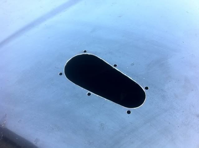

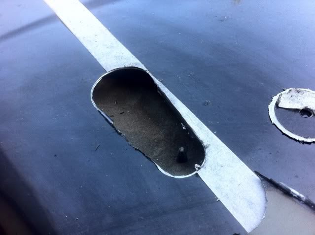

Decided it was time to install the hood latches. I started by masking a centerline. Then traced the pattern provided with the latches.
Used a die grinder to clean up the sharp edges. Then drilled the holes for the fasteners.

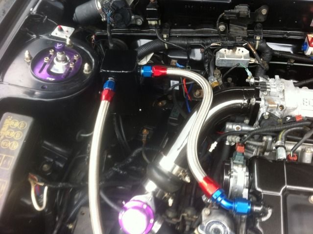

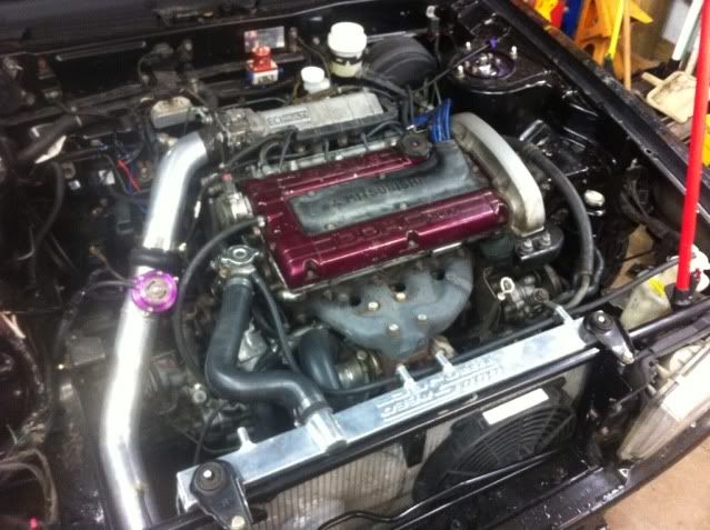

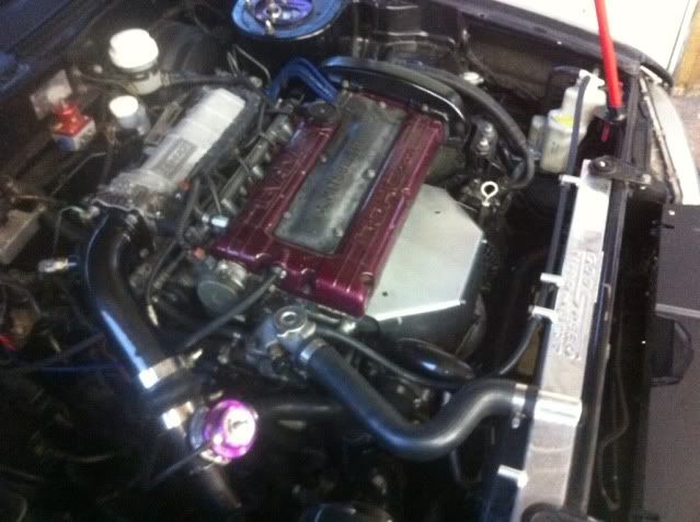

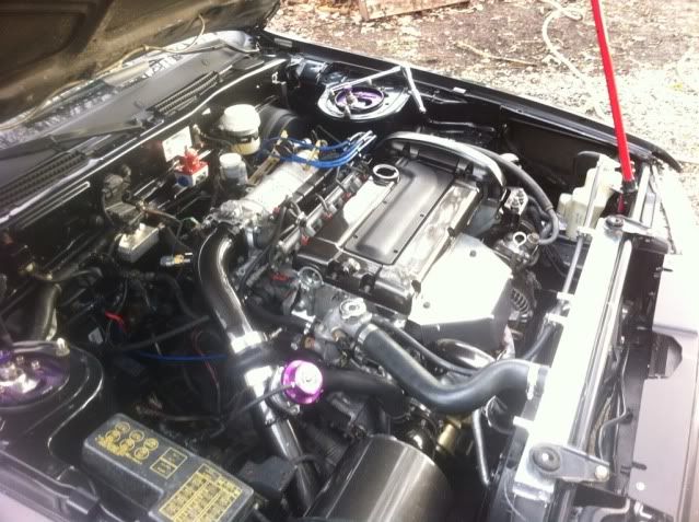

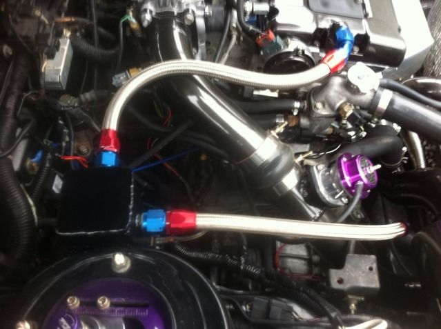

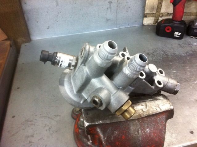

Installed heater hoses,intercooler pipes. Also wired the map and intake temp sensors.
I'm so close to firing this thing. If everything works out it should be running by Sunday.
EHmotorsports

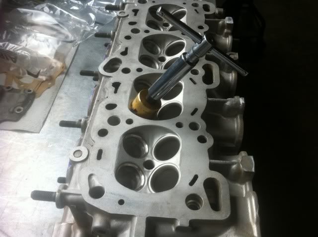

10/10/12 08:52 PM

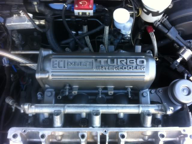

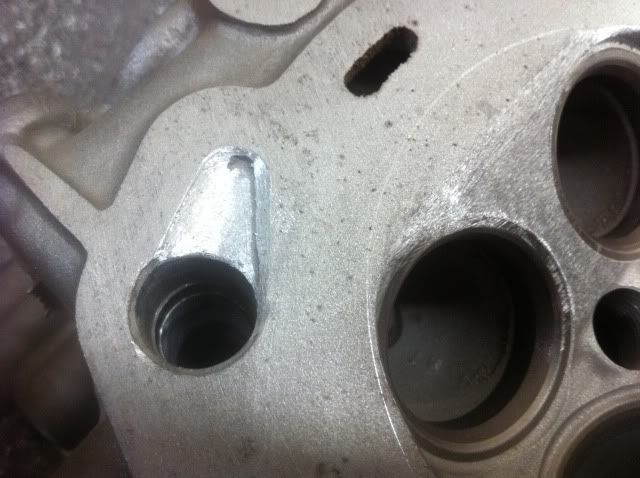

update time

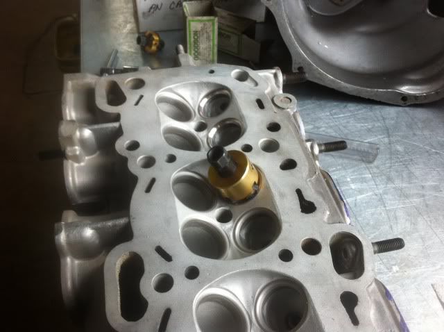

Had an injector O ring leaking pretty bad when cranking the engine over. Replaced all the injector seals.
Found that the fuel supply line going to the fuel filter was bottoming out on the threads causing a major leak. Took one thread off the end. tested again with no leaks.
also found i wasn't getting power to half of the MPI relay. tested power going in and out. found the BR wire coming from the fuseable link #8 had no power. traced and found a bad fuse at the engine fuse panel.
Now that all the issues (for now) are fixed i am able to connect to Dsmlink. the car starts and runs great!!
I just need to make a bracket for the coolant overflow tank,wire the cooling fan relay and weld the 3" exhaust up.
more pics will come.

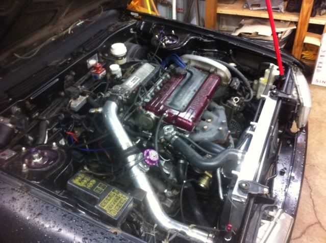

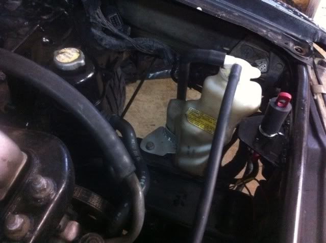

Made a bracket for the talon overflow bottle since I don't have the factory one.
Today was the first day of driving and so far so good. I will go through the entire car in a couple days to make sure nothing is loose.

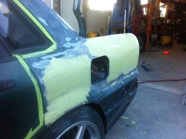

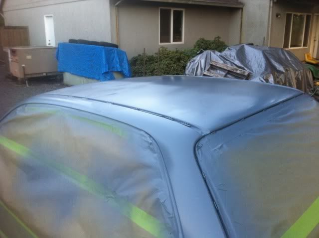

At least now I'm at a point that I can start cleaning everything up. Body work will Probably be the next step.
GVR47111K
(slurpees, hot dogs and pickled eggs are still offered)
10/17/12 10:21 PM
I kinda like how it is two colors.

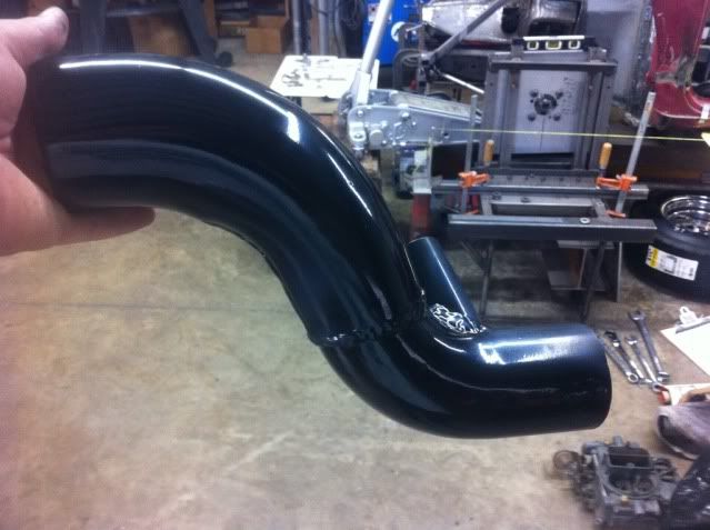

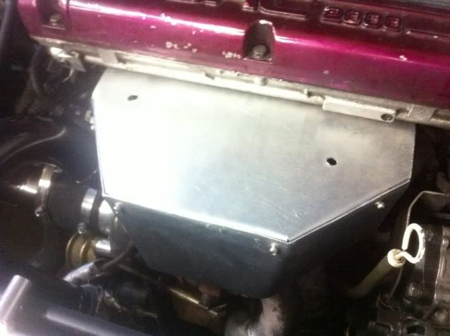

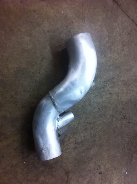

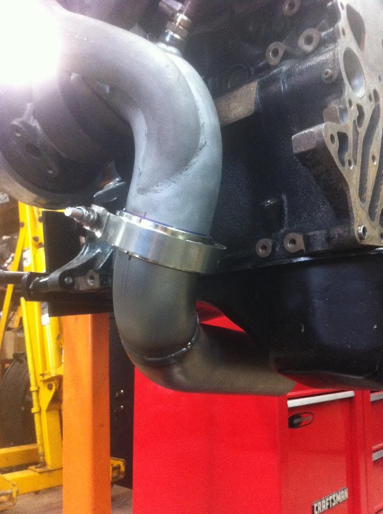

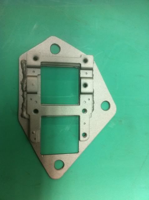

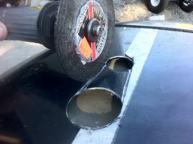

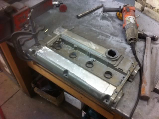

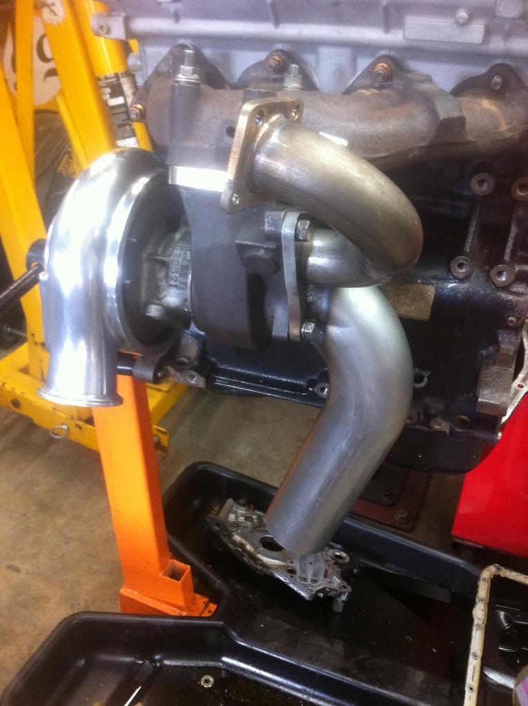

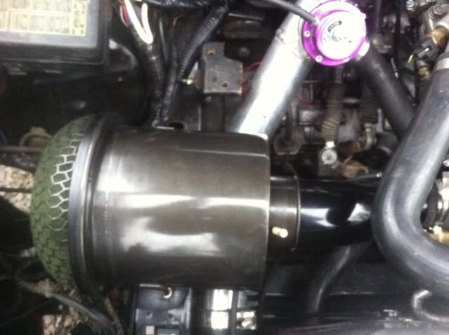

Decided to improve on my tig welding skills and make an intake for the galant airbox.
Still have a ways to go to make the welds look pretty but I will get it with more practice.
EHmotorsports
11/03/12 08:32 PM

Used the galant air can for now. Just wanted some sort of filter while I gather parts for the HX35.

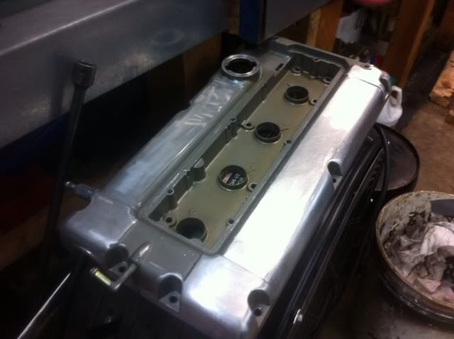

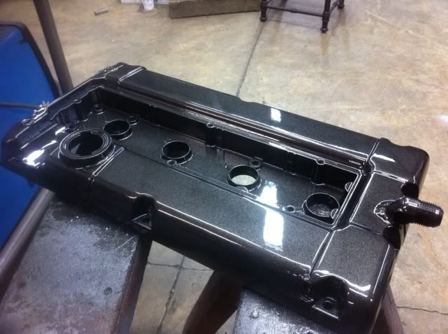

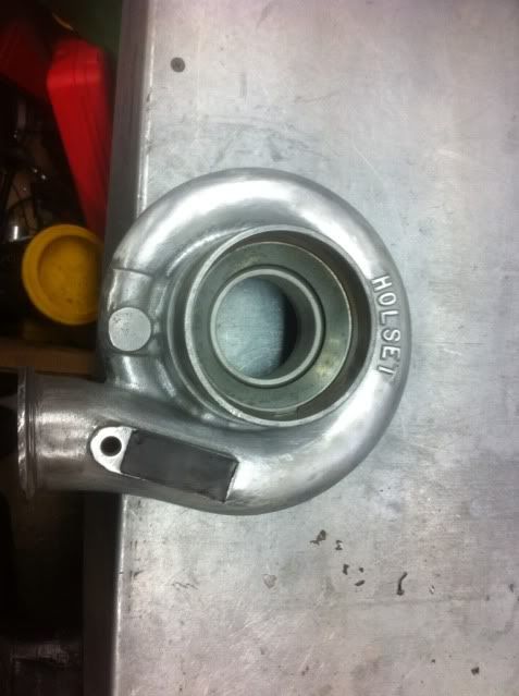

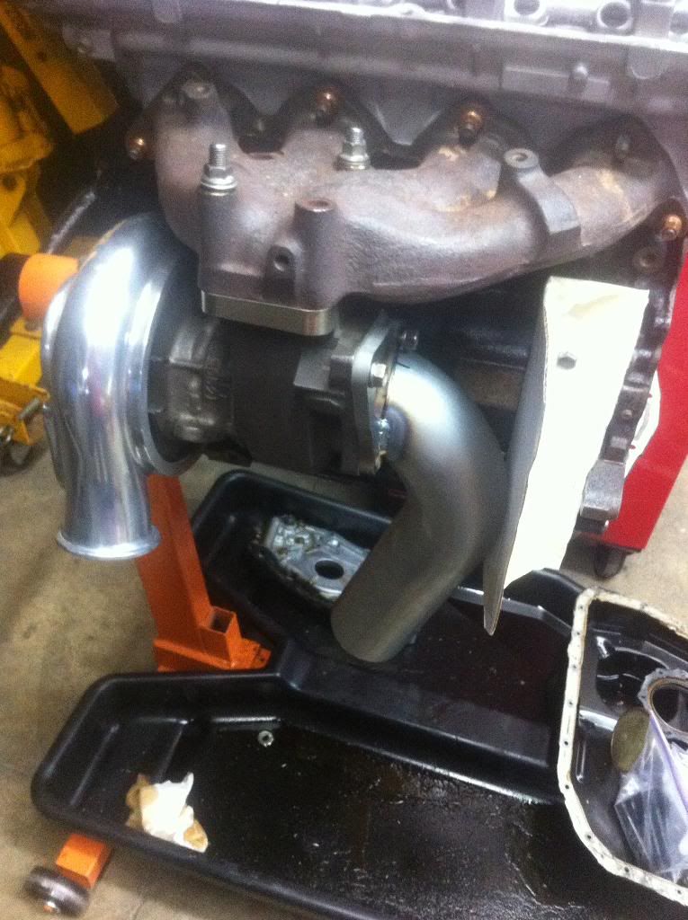

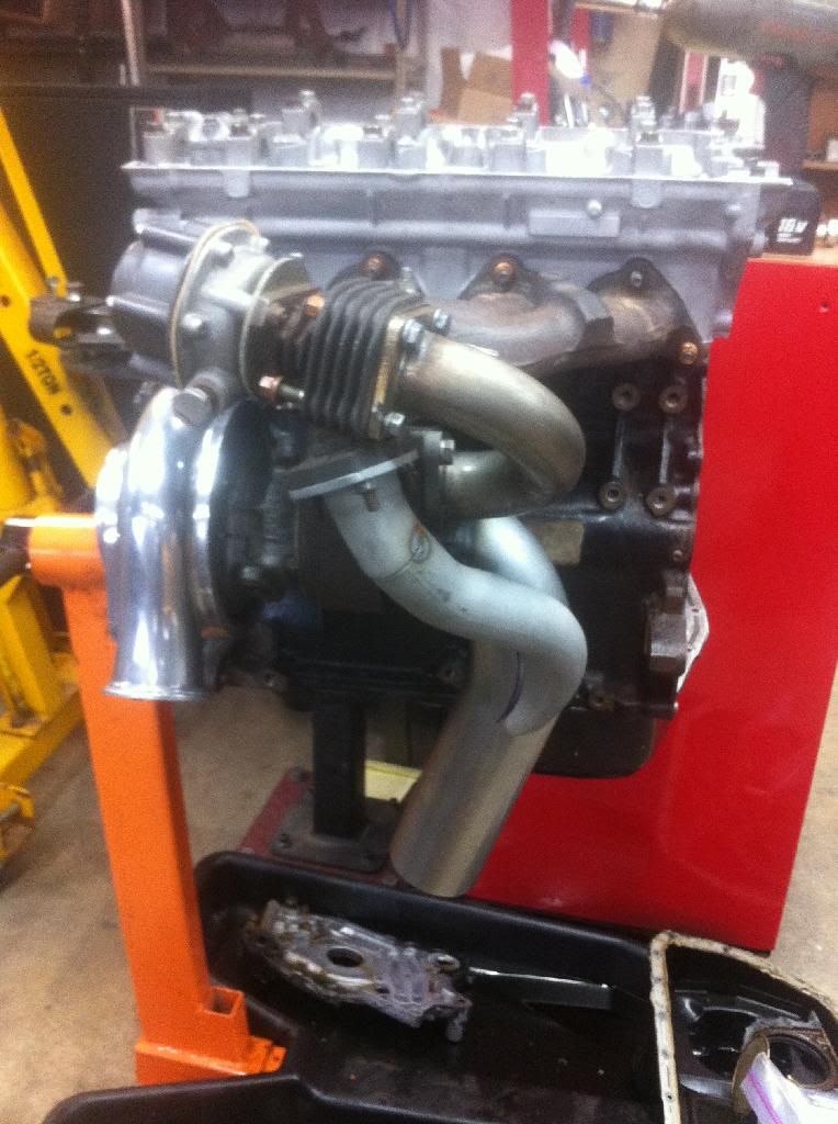

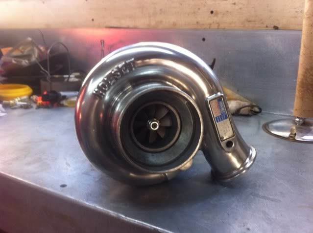

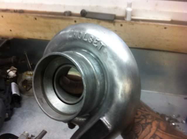

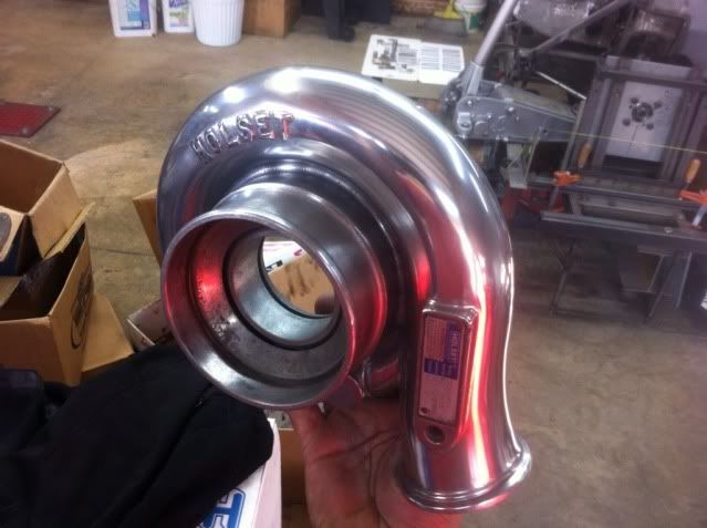

I also started sanding down the HX35 compressor housing.
EHmotorsports

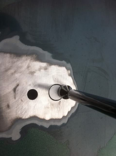

11/14/12 08:11 PM

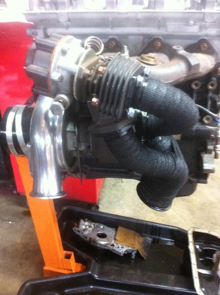

Finished polishing the turbo housing today. I also rebuilt the turbos center section for peice of mind.

the picture with the polished compressor cover and the red light looks pretty sick!
now just remove that silencer ring

Haha yes it does look sinister doesn't it? After I order the BEP housing I will be removing that silencer
At first I was worried that it may effect performance by removing it. But I have a buddy thats an engineer for daimler and he said it was just designed to make it quieter. He sold me on removing it;)
DynastyLCD
(Dissapointing Member)
11/15/12 11:04 AM
are you using the bolt-on Mitsubishi flanged housing, or the T3?
im curious for results. and i love the build so far - the effort you've put into this is awesome!
EHmotorsports
11/15/12 11:19 AM
It will be the mitsu housing. It's an 8 blade hx so from what I've read it doesn't have the highest flow for an hx but it's good for lower boost and quicker spool up.
I have plans for 20-25 psi and I'm not shooting for max power. Just usable power on the track. I can't wait for next season to startup.

12/29/12 07:42 PM
Removed the rear wing today.
Started filling the holes

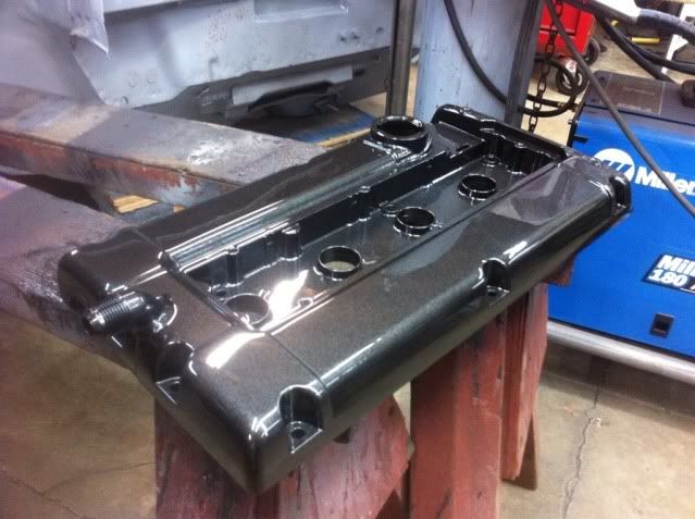

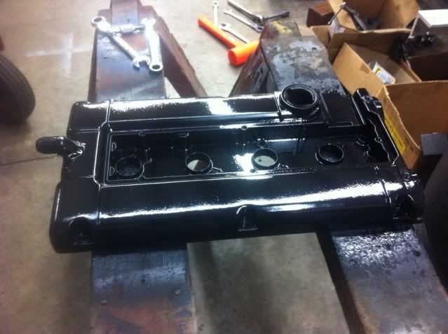

Shaved and painted the valve cover today. I also tig welded a -10 an fitting for the breather system.
Primer
LIV4PSI
(dyslexic 1051 )
01/06/13 03:13 AM
Looking good. We have matching valve covers
EHmotorsports
01/06/13 06:00 AM
My brotha from anotha valve cova!!

I wish I had your fabrication skills. I've been following your work since day one, Noobsauce
GSX_TC
(295hp 35r BR4)
01/06/13 12:09 PM
Nice, your valve cover looks identical to the paint on my car. Very nice.

01/09/13 08:33 PM
Fabricated a heat shield for the exhaust manifold. Also installed the new valve cover and painted intercooler piping.
faqinshiet
(Member +)
01/09/13 08:59 PM
Looks great! Did you fabricate the intercooler piping?
EHmotorsports
01/09/13 09:03 PM
ya i fabricated it. next time around i will build it better. after i install the Hx-35 i will have to.
EHmotorsports

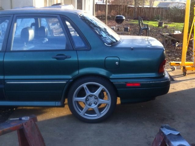

02/02/13 03:25 AM

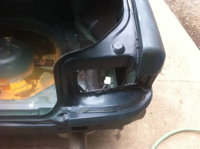

Oil catch can installed and plumbed.
Also shortened the rear bumper 3 inches.

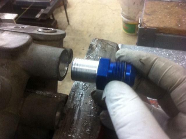

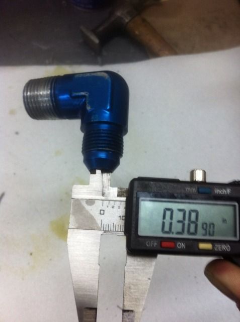

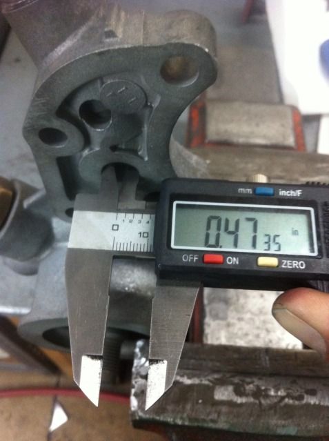

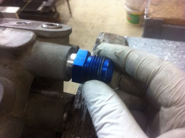

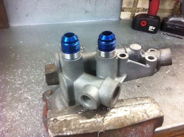

Getting everything ready to install my oil cooler.
Started with cleaning the housing and taping for the 1/4npt pressure sender. I also turned down two -10 an fittings to weld onto the housing. Drilled the housing out so the fittings will slide in.
EHmotorsports
02/27/13 11:48 PM
G
(JDM Unit)
02/28/13 12:01 AM
Looks nice, but why not just buy the fittings that thread in?
EHmotorsports
02/28/13 12:05 AM
At the moment I could only find -8 fittings available. That and I have about 20 -10 in overstock haha.
Also I've found that -8 an doesn't provide enough volume for road racing applications. So we run a minimum of -10 on anything that will see track days.
vr4play
(handles best on 3 tires)
02/28/13 01:25 PM
My engine guy told me I was wasting my time because the port hole in the filter housing outlet was so small that it didn't matter. I figured the extra volume was a benefit anyway. Nice work.
EHmotorsports
02/28/13 02:09 PM
The factory housing ports are almost exactly the same size as a -10 fitting. Anything bigger and I would say its a waste if you don't enlarge the ports.
-8 fitting ID
-10 fitting ID
thecman02
(too lazy to look)
02/28/13 03:54 PM
If I can save you some grief, please install your oil pressure sender on the end of a flexible an line or just return your electric oil pressure sender from Autometer. I've had two sending units die out. The first one they covered under warranty but the second was past warranty and they are not cheap at $70+ for a replacement. They only last about a year in the OFH. I was told doing research that they need to be "isolated."
EHmotorsports
02/28/13 05:28 PM
Thanks for the info:) I was thinking about that today and since I have good poly mounts I should relocate that unit to a flex line and rubber mount it to the body. Your post has solidified the choice to do that. Haha thanks!
Lukefraizer
(Member)
04/06/13 10:25 PM
How did you shorten the rear bumper? Did you keep the bumper and just cut down the cover? or remove it all?
EHmotorsports
04/07/13 02:59 AM
I cut down the bumper cover, then cut the lower half of the steel bumper off to clear the lower part of the cover.
Lukefraizer
(Member)
04/07/13 11:50 AM
do you have any close ups of how you did the wheel well to attach it there? I have the bumper off already and have just been chickening out because I want it to look really good.
EHmotorsports
04/07/13 01:45 PM
I had to cut the side brackets and move them back to accommodate everything being shifted forward. Then welded back in place. I don't believe I took many pics due to being in a hurry to get the car out of the shop. But I will dig around.
MarW90GSX
(Junior Member)
04/11/13 07:20 AM
I have always liked the rear bumper on the US spec cars and this makes it so much better! LOVE IT!
05/17/13 06:57 PM

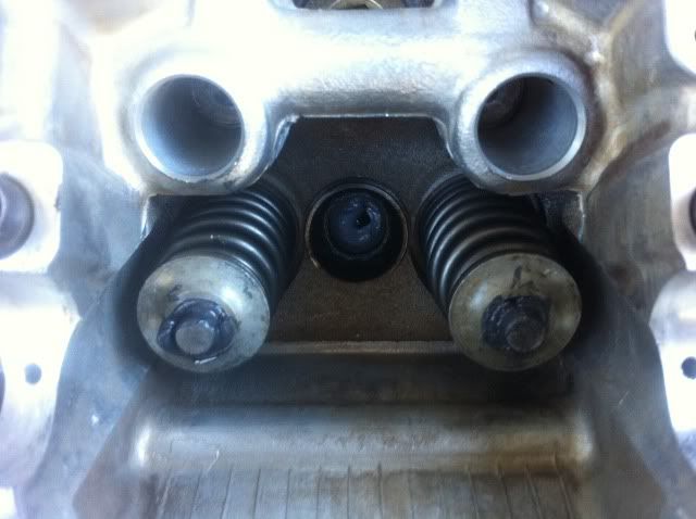

Well it's been a long day. The T belt stripped at the crank and bent valves galore. Was going about 60 on the hwy and then nothing......
Found a rebuildable used head along with Evo springs,retainers ad exhaust valves. Guess I will be busy this week.

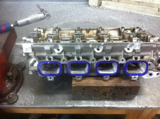

Update

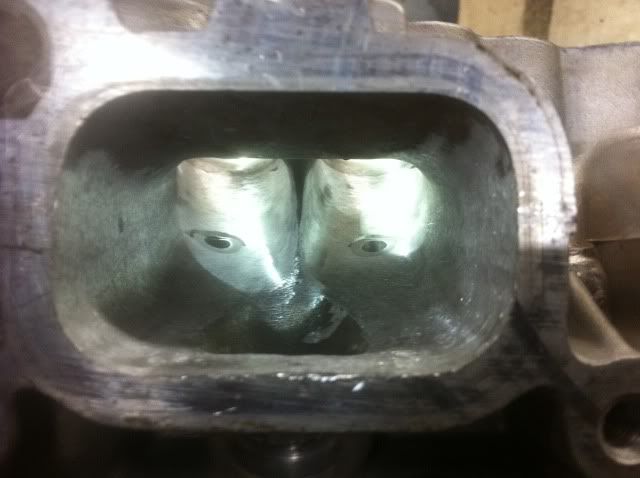

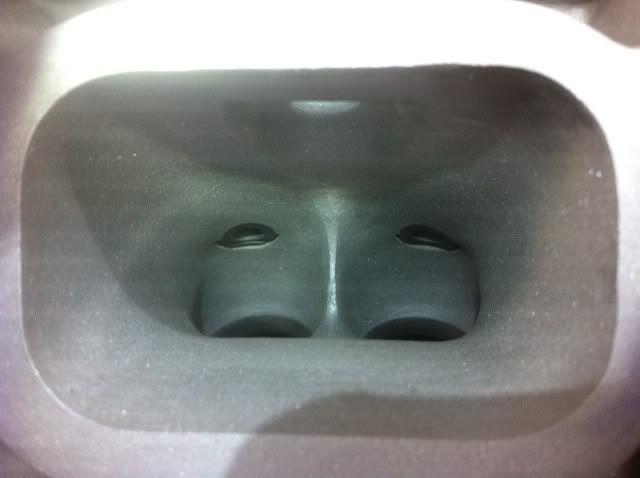

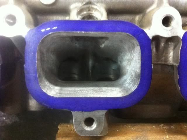

Ported and rebuilt another cylinder head. And installed the cyclone intake manifold.
EHmotorsports
06/17/13 01:29 AM
Cutting the seats
Evo 8 beehive springs and retainers as well as the sodium filled exhaust valves.

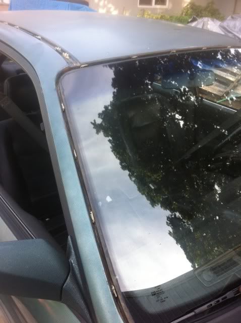

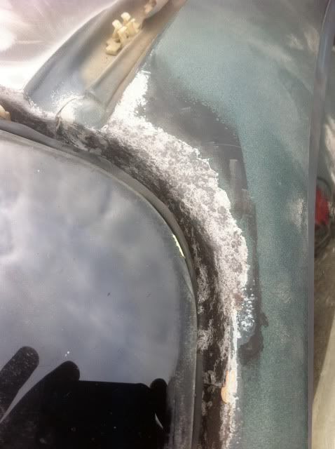

Well it's body and paint time. My only goal for the car right now is to get the main body/chassis painted. I will be able to paint the rest at a later date.
Started stripping all the trim and panels off today.
Finally able to kill the only bad rust on the car.
Bumper and trunk removed. Ready to be cleaned.
Cleaned and degreased
Let the sanding begin!!

More bodywork picks.
EHmotorsports
08/05/13 01:00 AM
Finished working the body filler and epoxy primed about an hr ago.

Thanks guys this is my first time trying to do body work and paint it the right way. "As much as I can with no paint booth"

Well spot filled pin holes and block sanded. Also sprayed with another coat of filler/sealer primer. I have hopes of this being the final wet sand before one more coat of sealer. Then onto color!!!
Pulled the doors of and time to clean and scuff the jams for primer.

08/17/13 12:55 AM
marvinmadman
(Senior Member)
08/17/13 01:33 AM
I fucking knew it! I grew up in a paint and body shop

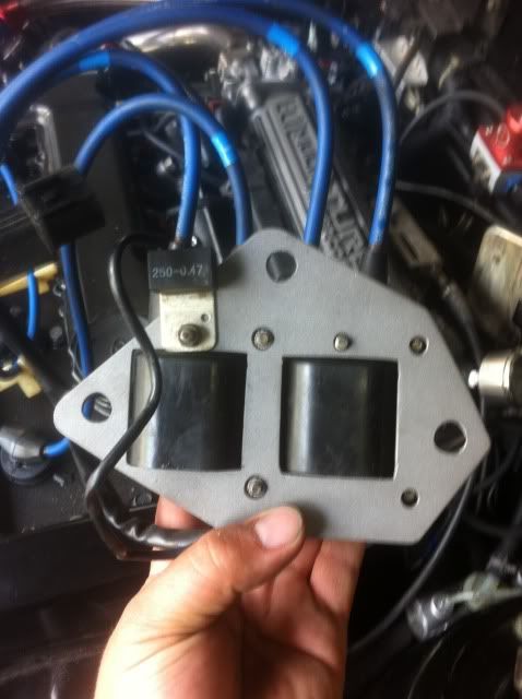

slugsgomoo
(god hates stupid people)
08/17/13 03:48 AM

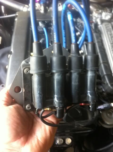

I like that coil bracket. Is it mounted to the manifold like stock, or do you have it bolted to the block?
EHmotorsports
08/17/13 11:20 AM
It's mounted to the stock location on the cyclone manifold.

found a smoking deal on a bolt on BEP housing for the HX-35
at a later date i will most likely make a manifold for the 12cm holset housing. but i am not planning to max the car out yet.

So until then i will be gathering the small parts list to install the HX-35 within the next few months.

is that hx35 going to be a t3 w/ internal gate or gated from the o2 housing? if so i have a really nice manifold that is heat wrapped ill sell you for super cheap.
EHmotorsports
01/10/14 11:57 AM
It's a dsm flanged BEP housing in the pics. Eventually I will be running a 12cm housing and making a divided manifold for better spool up.

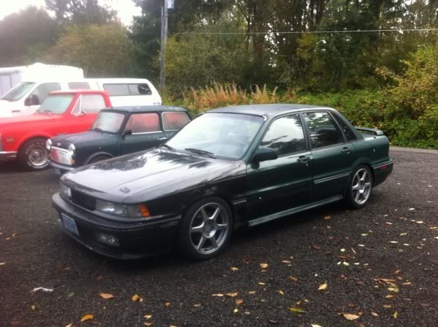

Wheels are dry and ready to install.
MellowVR4
(5" too short)
01/10/14 12:53 PM
I wanna se pics of this vr4 in the sun qith that wild paint.
EHmotorsports
01/10/14 01:08 PM
you will have to wait until summer then haha

Is it just the angle of the photo or are your sidewalls bowed in slightly because of the wider width of those tires to fit on those wheels? Would you recommend getting those 235s or go smaller to a 225? I think 245s are out of the question for those tires on an Evo 8 wheel.
It seems like the 225s only come in a 45 series sidewall.
(A hole)
01/10/14 02:51 PM
Wheels look great Evan! I was always a big fan of the Evo 8 wheels on the GVR4. I gotta agree with Wop though, a set of gold wheels would really compliment that dark green. I know shitting out money for whatever wheels you want is something we all wish for, but gold RPF1s on that thing or bust!
coyotes
(Hipster VR4)
01/10/14 03:00 PM
I'll take those.
I wonder what Evo 8 wheels would look like in bronze or gold.
EHmotorsports
01/10/14 07:52 PM
I've had gold wheels on most of my old cars and wanted to change it up a bit. I had gold rota grids on my white 89 civic SI HB, gold wheels on my Levin converted AE86. As far as the tire. The sidewall does slightly come in but not that bad. I wouldn't put 245's on as that is overkill. The 225 45 will roughly be the same thickness as a 235/40 so it wouldn't be to bad.

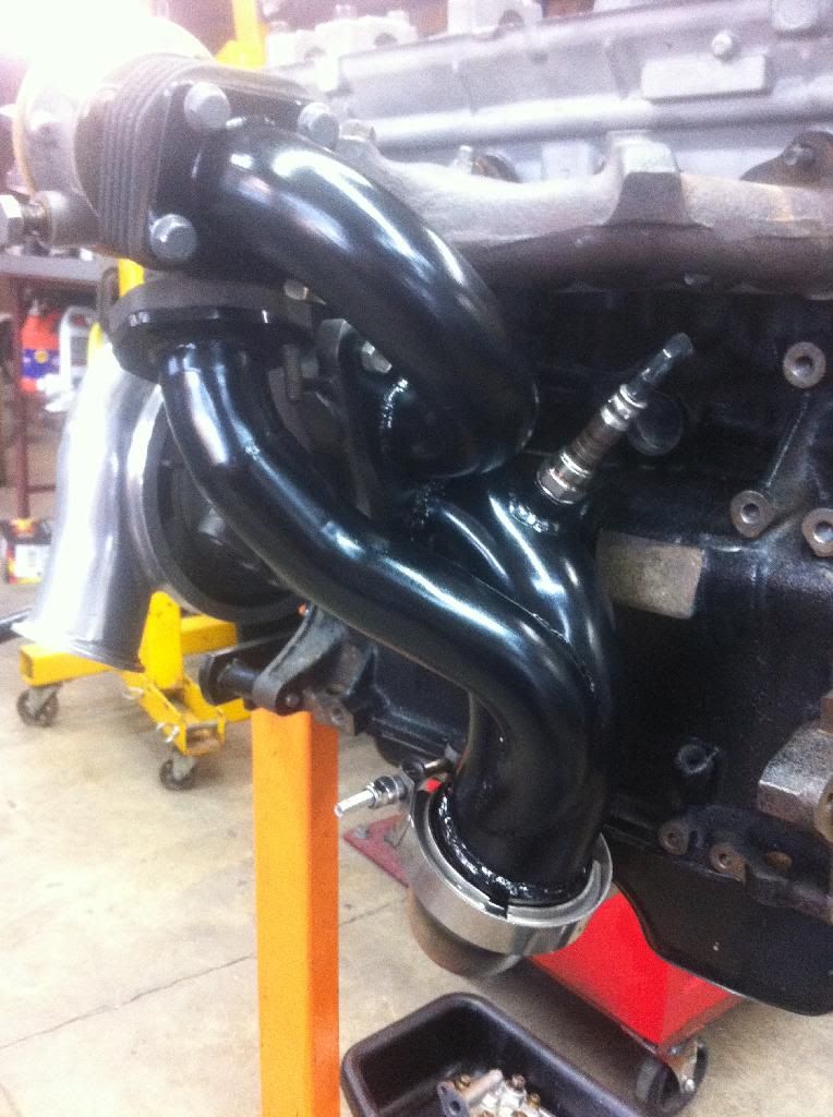

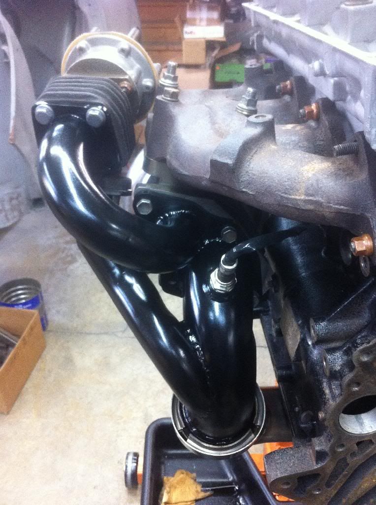

Started making the O2 housing and finding a location for the Audi wastegate. Not the easyest when the PS and alternator are in the stock location.
coyotes
(Hipster VR4)
03/30/14 12:31 AM
Is that for my engine? Sweeeeeeeet.
Looking good.
EHmotorsports
03/30/14 12:42 AM
Haha it is on it for now haha. And thanks:)

so looking at this on my PC and not my phone. i love how the wastegate is going to support it self. like its aimed down, so the recerc dump is bracing it.
also love the audi wastegate, havent seen anyone use one in a LONG ass time.
i should probably read back threw cuz i cant remember now, but what are the specs on the motor and holset?
EHmotorsports
04/01/14 08:56 PM
Yeah I may tack a small brace from flange to flange but I thought the expansion difference may make more stress on the tubing and promote cracking. But I may also run a brace from the WG to the manifold for vibration so it's still in the works.
It's an 8 blade HX35 with the BEP bolt on housing. The engine is a 6 bolt with 2g dsm pistons. Running ARP mains,rods and head studs. Stock cams for now but that will eventually change. EVO 8 exhaust valves,springs and retainers.
EHmotorsports
04/13/14 04:01 PM
Heat wraped and ready to go. Waiting on the oil feed fittings and a resonator.

I picked up a 3000gt vr4 brake setup using slotted and dimpled cobra 13" rotors.
The calipers needed some TLC so I decided to start cleaning and finishing them.
Tig welded the small dimples and started smoothing it all out.

G
(JDM Unit)
08/24/14 01:11 AM
Looks nice, what was the welding for?
Are those 1g or 2g calipers?
Are the cobra rotors bigger than the 2g 3kgtvr4 rotors?
Where did you get those brackets?
EHmotorsports
08/24/14 01:27 AM
The welding was to fill in small casting divets so I can smooth everything out.
The brakes are 1g 3kgt calipers. I am not fully sure the differences from the vr4 rotor to cobra rotors.
RTM racing sells the brake kits but I traded parts for this kit.

09/16/14 10:19 PM

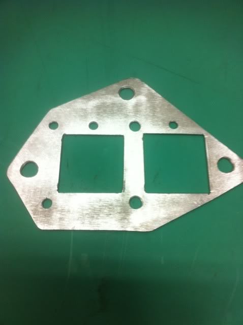

Starting the heat shield template.
EHmotorsports
02/25/15 10:12 PM
I have had the shield on for a while now. So far so good.

Making seat brackets for the evo 8 SSL seats.

Don't worry I will be doing a full deep vacuume and cleaning

CutlassJim
(poop load of room)
03/07/15 04:36 PM
Not to be a Debbie Downer but that's not a good spot for a BOV. Besides the signal line having to be so long and inducing a delay in the pressure release making that massive amount of air have to change direction and travel all the way back from the throttle plate plus through the restrictive core again seems counter intuitive. Nevermind the possible line or BOV damage from road debris (maybe it will be hidden behind the bumper?). And don't forget that when cruising around the BOV will be open so you could get some sand in your vag, errrrr intercooler, so be sure to put a filter on that thang. The end tanks do make me pitch a little tent though.
EHmotorsports
03/07/15 06:22 PM
contrary to what you are saying having the BOV closer to the turbo is beneficial as it is venting hot pressure vs already cooled pressure. pressure will still vent off as the turbo is the source of the pressure not the throttle plate. I have chatted with several Aussies that build drag RX3's and have come to the conclusion that having the BOV pre cooler is more beneficial.
also having an extra 2 feet of signal line is hardly enough to cause a severe delay in response but i have plans on hard piping 3/4 of the line along the fender well to the firewall due to myself having the same concern.but the main reason for doing this is to clean up the engine bay. And thank you for voicing your concerns and compliment I truly do Appreciate it all:)
EHmotorsports
03/07/15 06:26 PM
CutlassJim
(poop load of room)
03/07/15 08:23 PM
Quoting EHmotorsports:
Please don't take my comment as negative in any way just tossing ideas around.
I still think the focus should be on the mass of air and not the pressure which is just a byproduct of that mass of air. Kind of how people are so concerned with how much boost pressure you are running when it's mass airflow that matters. EFR turbo's do have the BOV right on the turbo housing and BW engineers are a lot smarter than me so there's that. Keep us updated if it works well so we can all copy you.
EHmotorsports
03/07/15 08:53 PM
Oh yeah I completley appreciate the input. I'm always willing to discuss:) I do have another flange ready to weld back on close to the TB if things don't work out. It is still and experiment right now.

What a PITA... Machining the center diff housing for a Torrington bearing upgrade.

All this work and doesn't have a proper hood prop....
Just a red pipe
I have the hood strut kit but tightening down one of the pivot balls it snapped. so its on the list to find non china pivots and drill/extract the little shit out of the body.

It's been a while since I have updated this build. HX35 is installed and i just finished making the catch can. Wiring and a proper air box will be the next goal.
(A hole)
07/04/16 06:10 PM
Looks great, Evan. That catch can is legit.
Which size BEP housing are you running?
ApexHunter
(Extreme Indoor Cyclist)
07/04/16 09:47 PM
The way the fitting on the valve cover for the vent was grafted on there looks real nice. I was wondering how this car was doing.
EHmotorsports
07/05/16 06:11 PM
Quoting GSTwithPSI:
It's just the basic housing for the HX35. Nothing special but in the long run I will ether upgrade the turbo to something a lot nicer or I will use the 12cm twin scroll housing and make a proper manifold.
EHmotorsports
07/05/16 06:13 PM
Quoting ApexHunter:
Thanks guys! If I had to do it all over again I might change things slightly. But I am happy with how it is for now:) the build never ends haha.
