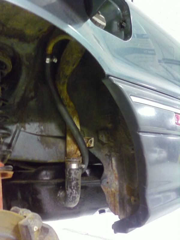

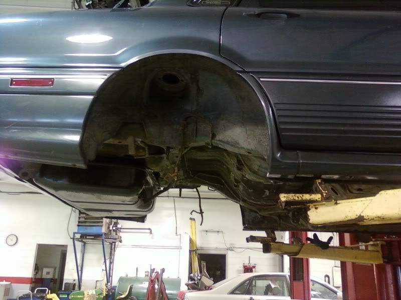

Body is pretty damn straight. There's a few paint scratches down to metal but will be fairly simple to repair:
Worst of the rust is under where the fenders sit. It's the same on both sides, will be stripping it down and painting it tonight:

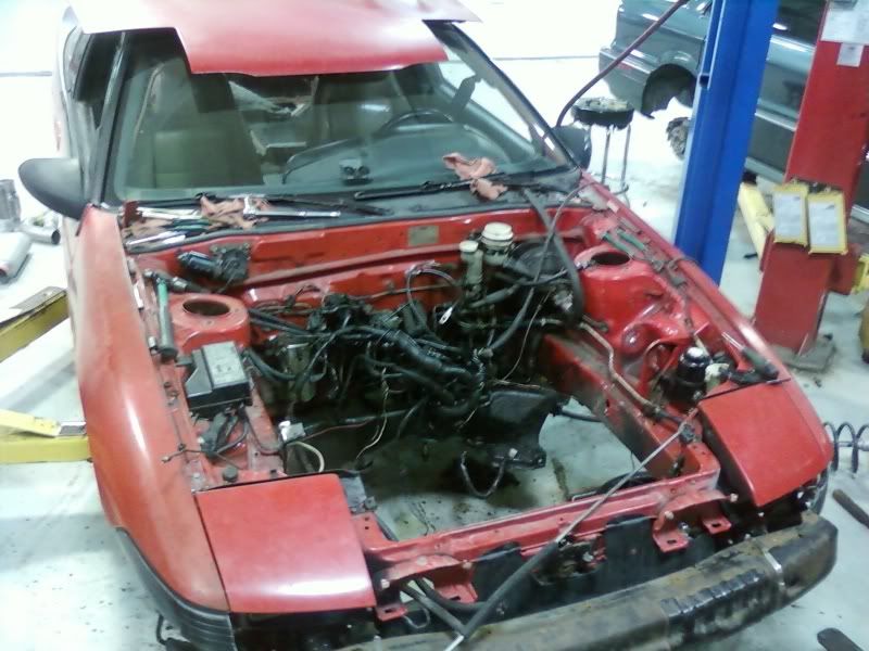

Engine bay shot again:
I plan to put the DSM ps res. in instead of the 4ws stuff, ABS was already taken out so the seller gave me a non-abs prop valve but I'll need to make 4 new lines. Will a DSM engine harness work with the stock Galant gauges without too much work? I want to make it easy and swap my Talon's harness that I've gone through and re- routed.

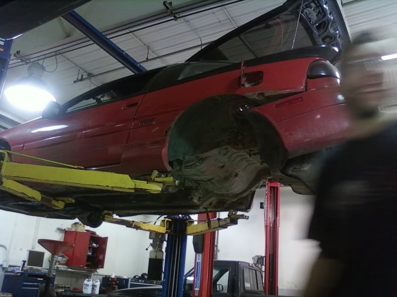

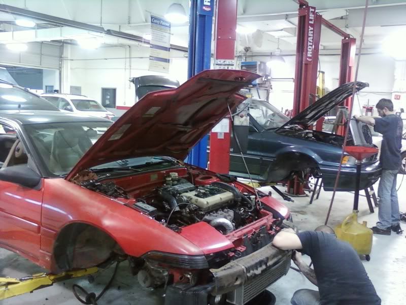

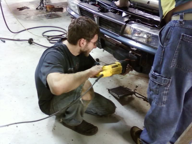

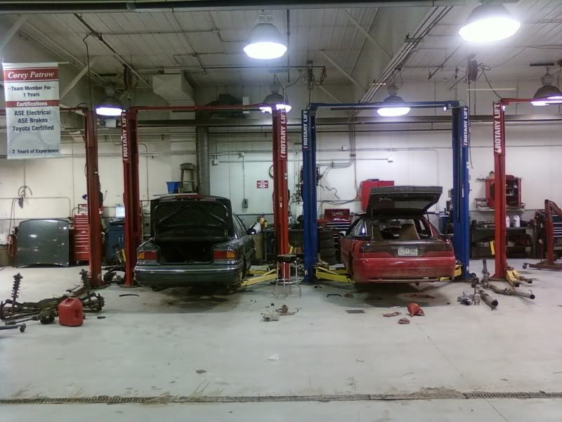

Yea, apparently to my friends that helped put this car together this weekend, the car is a flying penis fortress. lol
Galant is running and driving! Drove it 27 miles yesterday for the first time. Already the car drives better than my Talon did, but then again maybe thats because I have more poly bushings up front and the correct motor mounts. Still needs to be put up on the alignment rack, hopefully that'll happen tonight after work. Here's a bunch of pics twack and my friend took:
For anyone ever wondering, yes, a 1g filler neck and hose fits great:
Here's the crew that made it possible:

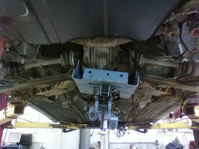

First things first, swap rear ends:
Doin werk:
Where'd it go:
Here it be:

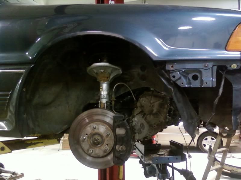

Poor Talon:
Camaro brakes rockin strong:
Because intercooler:
Exhaust:
Here's 1945, with 100% new life:

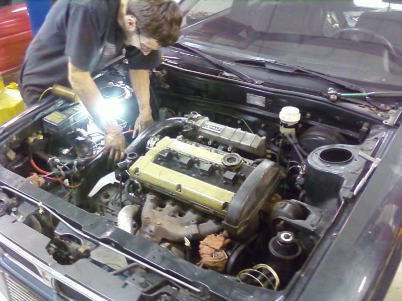

Gave the car an alignment at work today. I'm thinking one of my control arms is bent because one side has more camber than the other in the front end. I have some much better control arms that I had sand blasted then I painted them and put new moog ball joints in them. I just need to buy a poly bushing kit for them.
Pic of engine bay as is:
I need to pull the power steering pump out of the way and tighten the bracket that bolts to the block tonight yet. Somehow, it's loose and being my daily driver I can't have something happening.

Put the transmission back together friday night. Was up till about 3 am when I finished it. Installed it back in the car saturday morning, and drove it home around 530. So far no leaks, no weird noises. Occasional 2nd and 3rd gear crunch but otherwise it all seems good.
123abc
(Member)
01/26/12 12:48 PM
Re: 1945 is now mine!
Well, now that I lost my job, I have much more time to tinker with the Gaylant. Finally mounted the DSM ecu up where it should be in the Galant, ran the release cables for the trunk and the fuel door, also stole the latch off my Talon so now the fuel door is on. I took the stupid lawn mower battery out and put a real one in the trunk with all the stuff from the Talon. Bolted down the battery box, ran the cables. Fixed the non-working reverse lights.
Took a couple pics:
Engine bay is much easier to work in now. Also safer without the battery up there.
