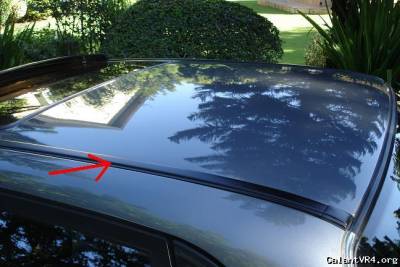

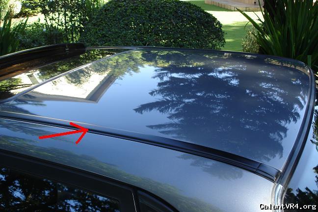

I think you're in the right track when you say "you've seen some spot welds under the rubber strips". In the PH, we've had some Galant owners who wanted moonroofs installed, do it this way - take out the rubber strips, trace the spot welds and "unweld". From the donor car, do the same and then swap. Yup windshields come of. Of course, if the previous owner had already cut from the pillar, its a different story.
