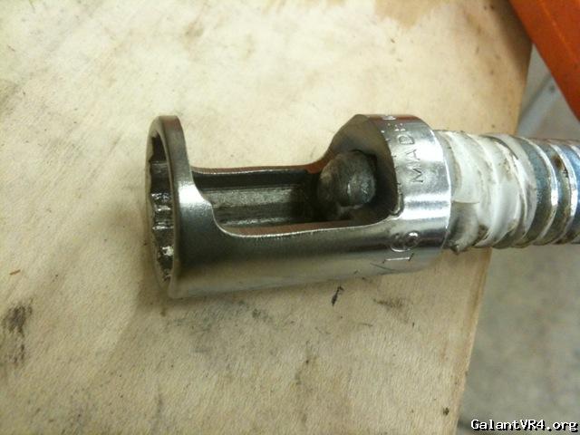

I've used a big harbor freight C clamp with windowed socket JB welded onto it a few times. Works like a charm and cost all of $5.
