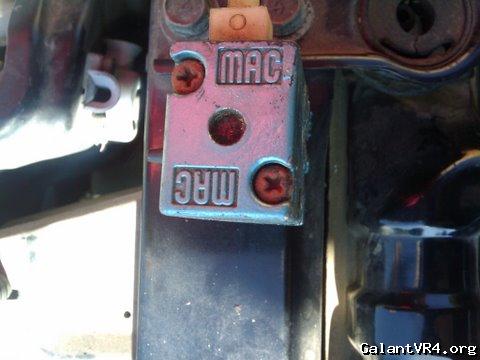

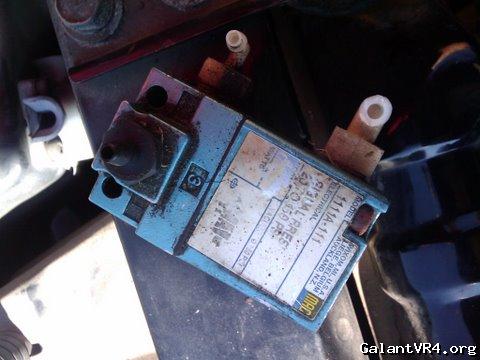

What is this and its purpose"pics"
this must be old school or something.I cant find this for the life of me, i google it and nothing and if anyone knows what it is please school me and if possible link to there site.

Mac 3-way Pneumatic Air Valve used in the glass & tire industry.
Yes, that is what I thought. It looks like the 3-way valve that Dejon supplied with their BOV mod kit.
Okay well I have the dejon intake still but I just put on an hks ssq and is vented to air now
