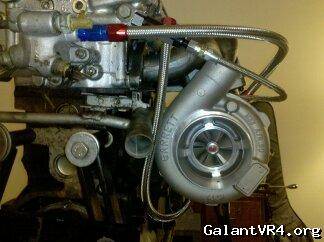

Like others before me, I went with the 3052 to make for a nice street car/grocery getter. I had some money to play with so I thought I might as well do it right.
Sizing the oil and coolant lines. I went with all SS lines except for the oil drain, I used -10 Earl's nylon braided for ease of the transition. I used -6 for the coolant.

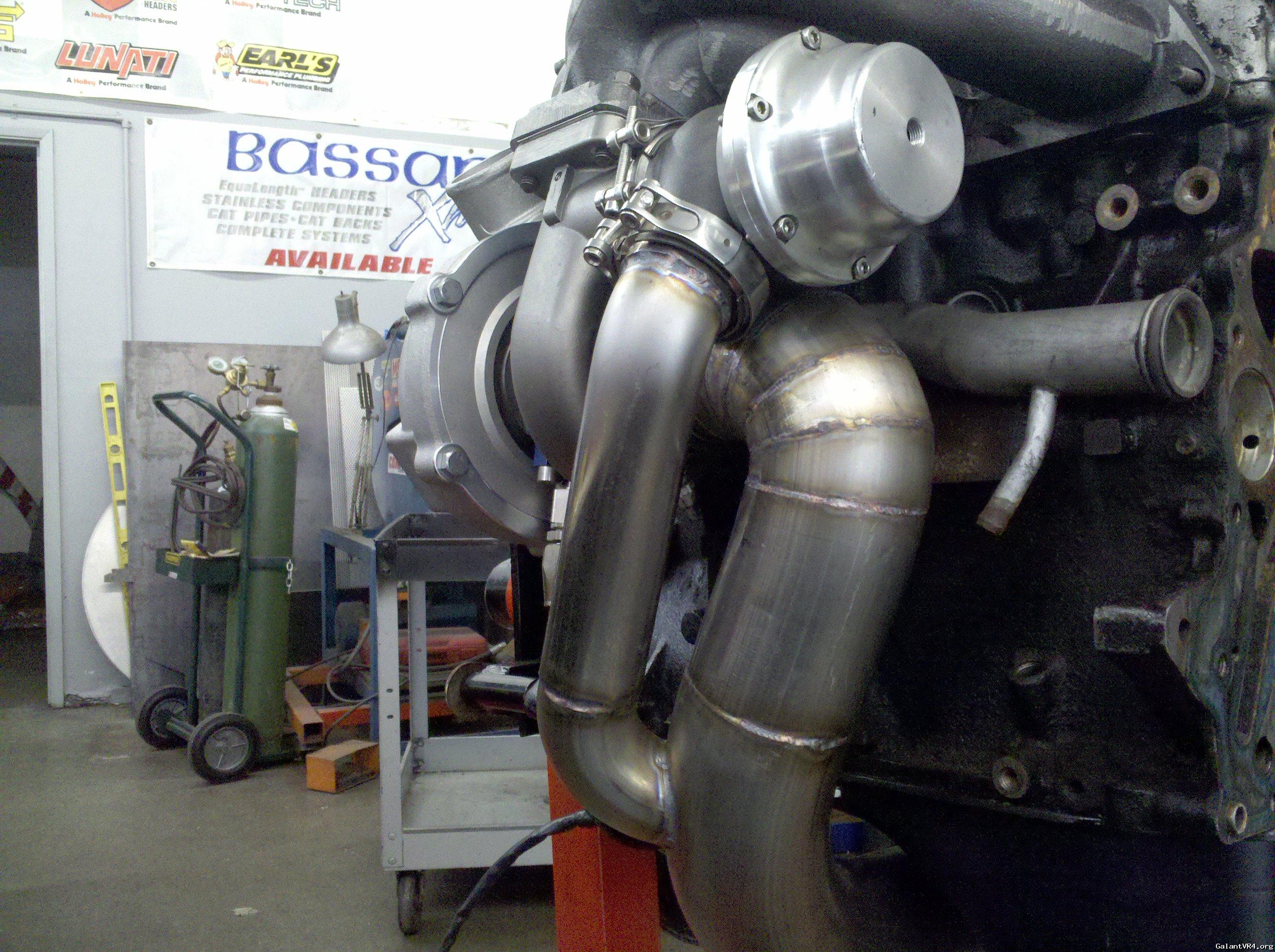

A buddy of mine made the downpipe for me. My radiator is 3in thick so he didnt have a whole lot of room to work with. We took all the necessary measurments and should be good to go but just in case I might even have to notch the core-support and tilt the rad in a little for clearance.

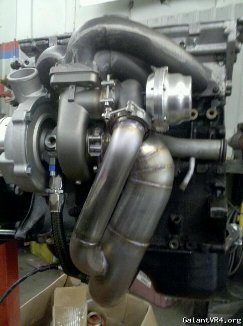

Another pic. I will be wrapping the DP with header-wrap. Gotta help the ALT survive as much as I can.

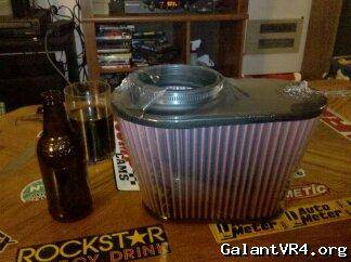

Here's my Air Filter. I borrowed the idea from my buddy. It was spendy but it shoud work great.
