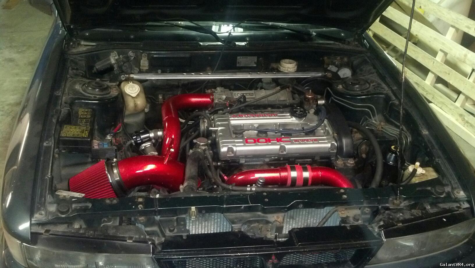

As it was bought:
~Turbo back 2.5in exhaust w/ Magnaflow twin tip muffler
~2.5in pipping with some FMIC (Knowing the PO's its probably Ebay)
~Big 16g turbo
~560cc injectors
~Walbro Fuel pump
~Act 2600? clutch
~KYB Gr2's
~Ebay FPR with Jegs Fuel pressure gauge
~Some Random BOV.
~AEM Filter that adds mad HP yo!. (being replaced since its GLUED onto the EBAY MAF and its so dirty idk how its getting air.
~S13 SE 240sx wheels hahaha.
~and a shitload of problems.........

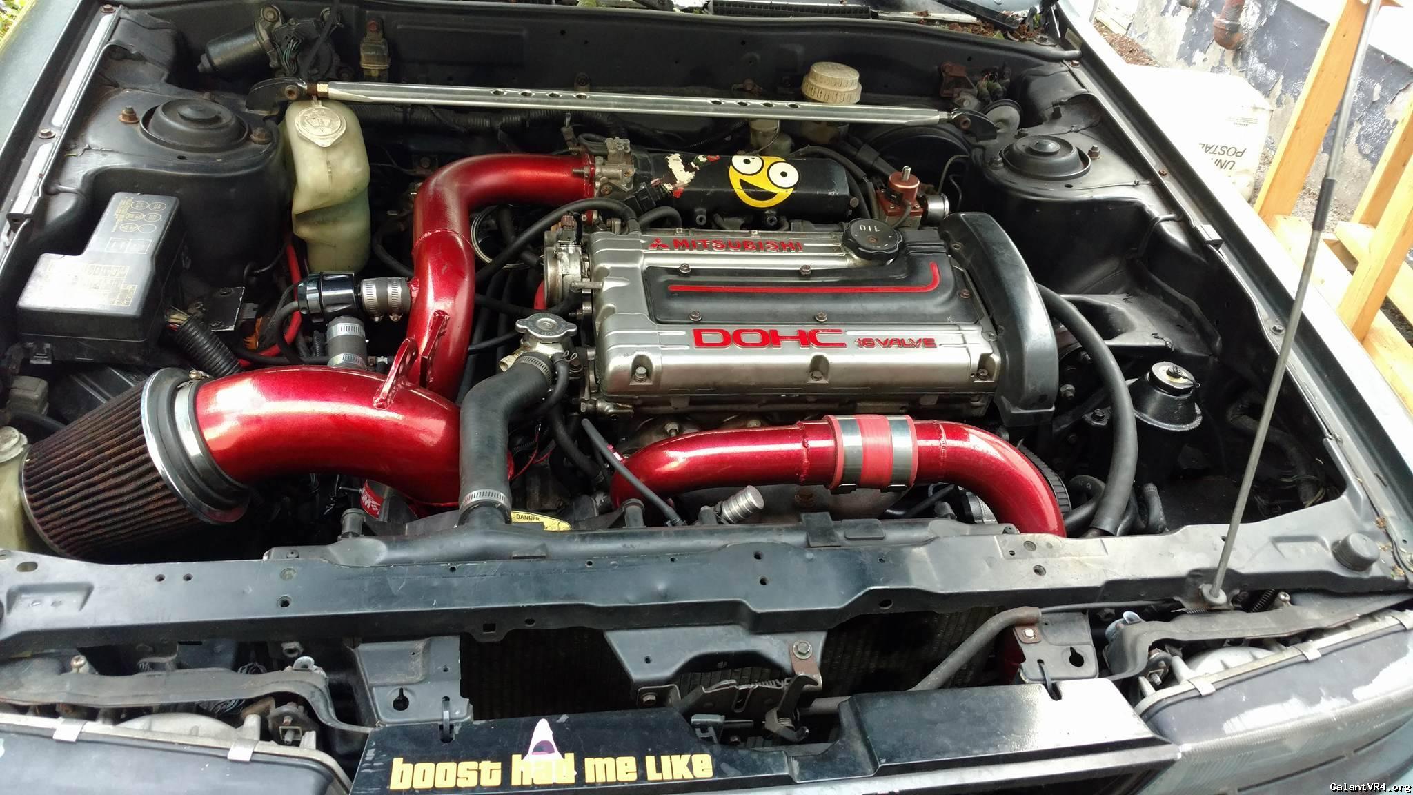

****Current Mod list****
Engine :
~Rebuilt stock block with BSE
Head
~5 angle Valve job
~Port and polish
~HKS 272/272 cams
~3G lifters
~Supertech everything
~Bronze guides
~ARP Headstuds
~Stock Intake manifold with port matched runners and EGR block off
Turbo System
~MHI 20G w/billet 7blade
~Evo 3 Exhaust manifold

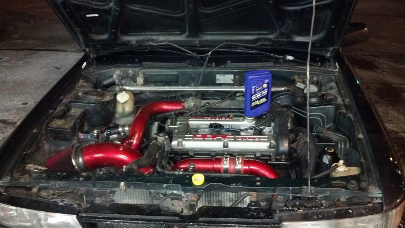

~Custom intercooler pipping & powdercoated red flake
~XS power Intercooler
~Samco Diverter value
~Innovate Wideband o2
Fuel
~PTE 880cc
~Walbro 255LPH pump
~New fuel lines front to back
Engine Management
DSM Link V3 Full
Misc
~Act 2600 clutch
~ACT Streetlite Flywheel
~KYB AGX 8 way adjustable
~Poly Motor mounts
~Brad Penn 10W30
~New valve cover and Timing belt cover
~OEM thermostat
~2 New fan relays
~Countless hours into fixing wiring issues
~ABS delete
~4WS delete
~Period correct OEM Radio/CD player
~Random missing parts from the parts car (fog lights,Oem floor mats,spark plug cover etc)
~Mishimoto Slim Fan
so much more....

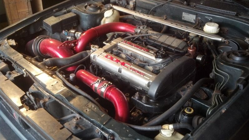

Hey how did you make the "custom IC piping" was it a kit or did you fab them up yourself?
Also really dig the red flake. Keep up the good work!
TurboTurtle
Active member
Sep 13, 2011
37
Rotterdam NY
Buddys shop made it. Capital Region Customs in guilderland NY. Powercoated on site too. Not what i would have done but i love it.

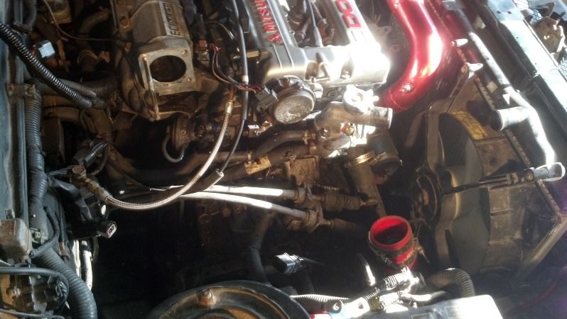

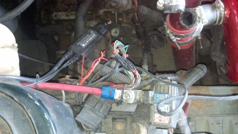

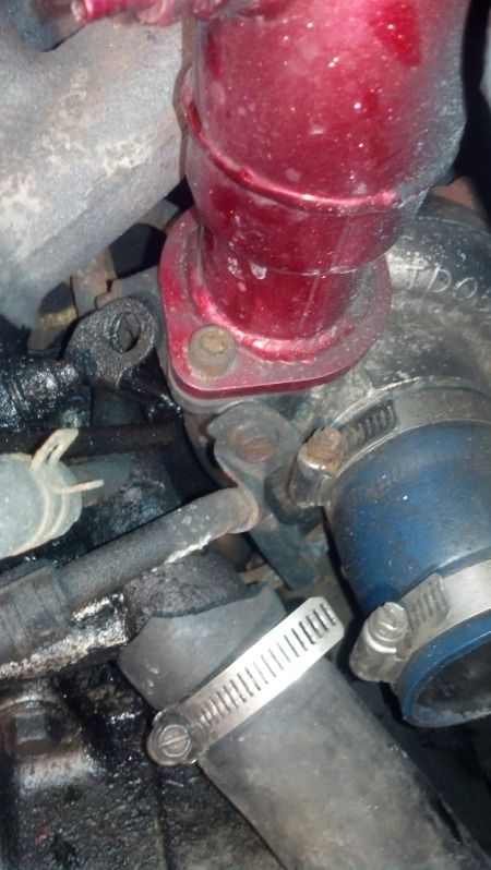

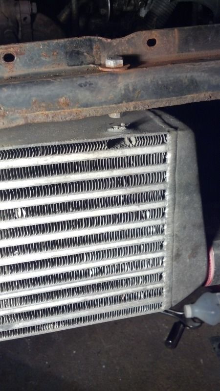

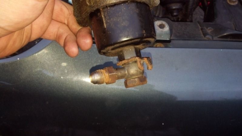

And its begun!
Within an hour here's what I got to before I had to goto work.
-Wiring was horrendous.
-Catch can oil shows signs of head gasket issue

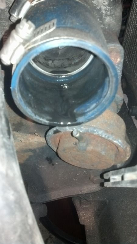

-Turbo has blown seals and leaking oil
-1G radiator has Togo.
Intercooler pipping bolts are stripped. Should be fun to get out...
Lotsssss more pics to come when I get some progress going.

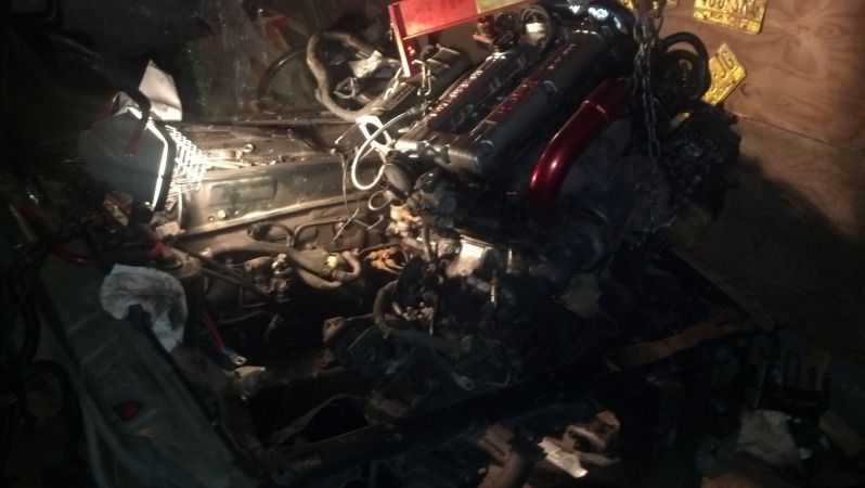

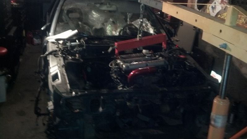

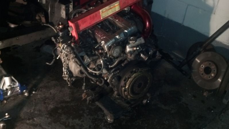

Well as of 1130pm 5.6.13 the motor/trans is finally pulled.
As i pulled it i realized how clean and new the freeze plugs were. Upon finshing up i went inside and went to town searching the internet and BINGO!!

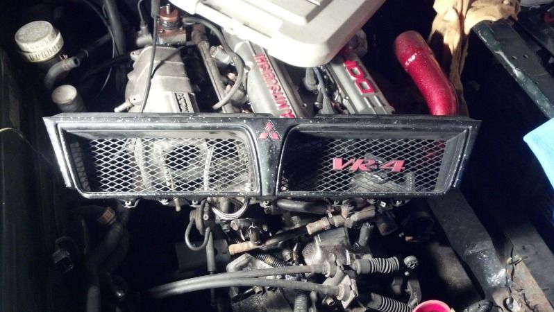

Seriously... wtf lol
Grill before i repainted it (Paint is drying now so no pics yet)

UP UP...
AND AWAYYYYYYYYYYYYY WE GOOO!
Motor out and trans/diff off.

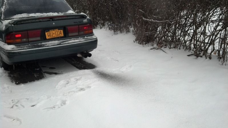

To give you an idea HOW rich it runs. Taken 2 months ago.

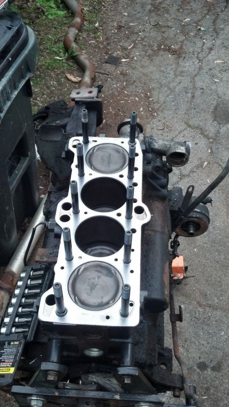

~Got the engine bay 95% clean and in primer til I decide a color

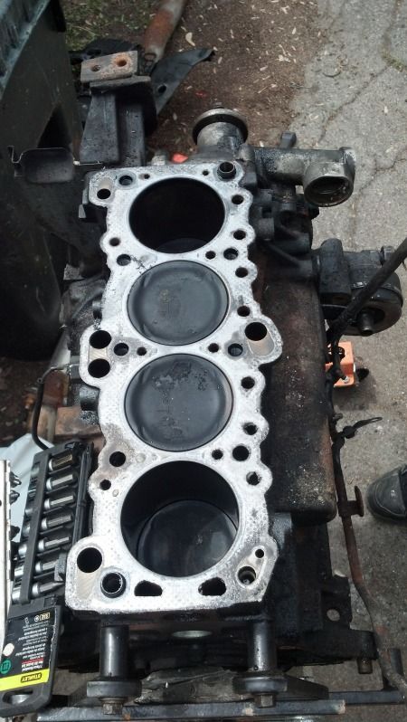

~swapped the head / cleaned up the pistons a bit and installed new HG.
~Dropped the rear subframe and pulled out of the garage
~Started taking brake lines out. Going to replace every brake and fuel line on the car.
Pics!

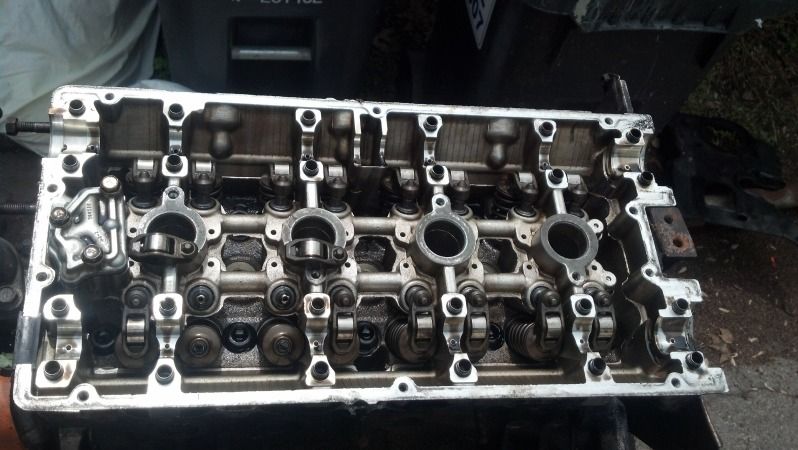

Found that my engine got rebuilt at 100k (now 185k) by a previous owner and found that the head was rebuilt with the 3G lifters and bronze guides as well!
Valve slap...rut Rob raggy
ARP studs!

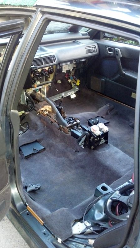

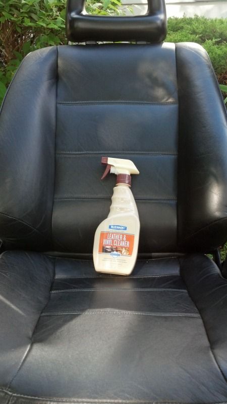

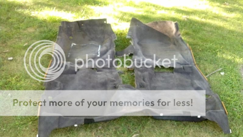

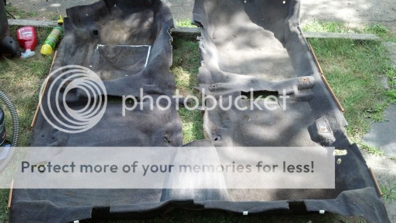

Took the interior apart and cleaned everything 10x over.

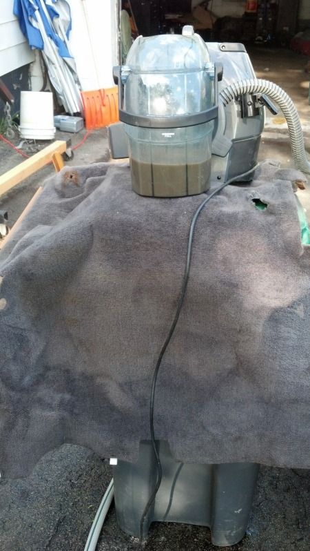

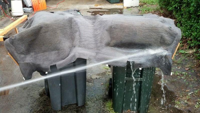

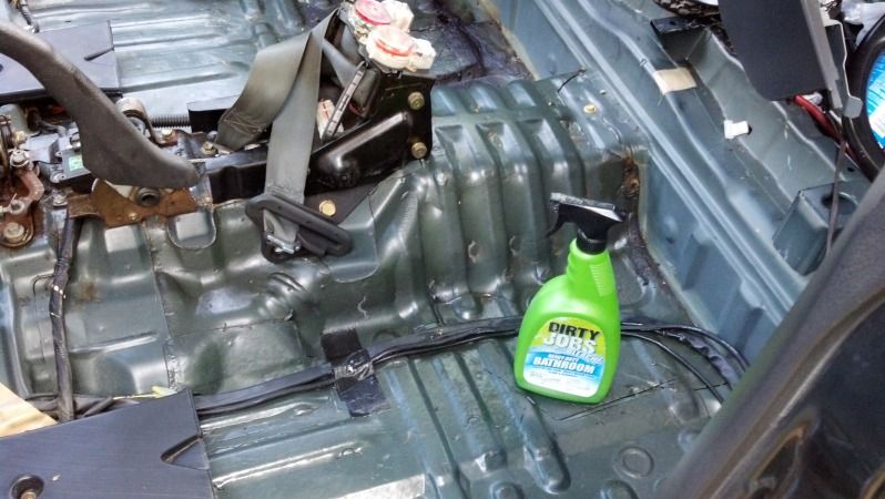

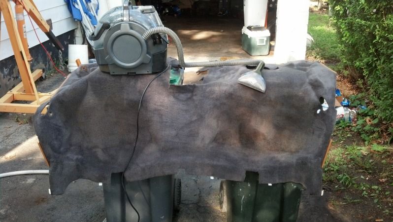

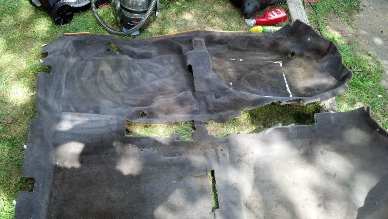

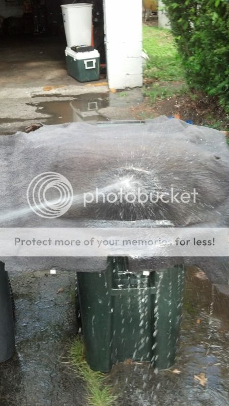

30minute soak in boiling water and oxyclean. Cleaned with a rug shampooer then draped over my garbage cans and sprayed on jet setting with my hose til I seen no dirty water coming off. Took 2 hours total.
I had my 4 bolt rear subframe in my back seat and the diff leaked, and this cleaned up all the rest of the best oil great.
Can't say enough about this stuff

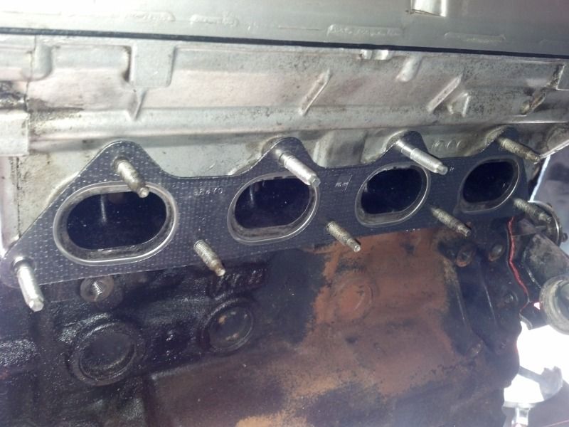

Who knew extra exhaust studs from 20 years ago in my grandfathers basement fits the 4g63 just as good as stock!!
