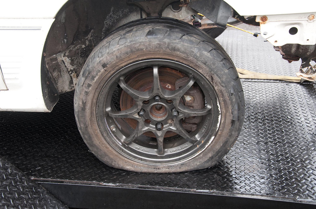

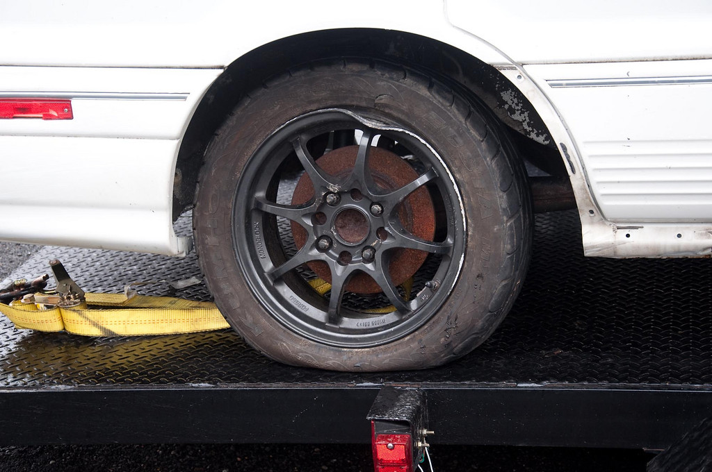

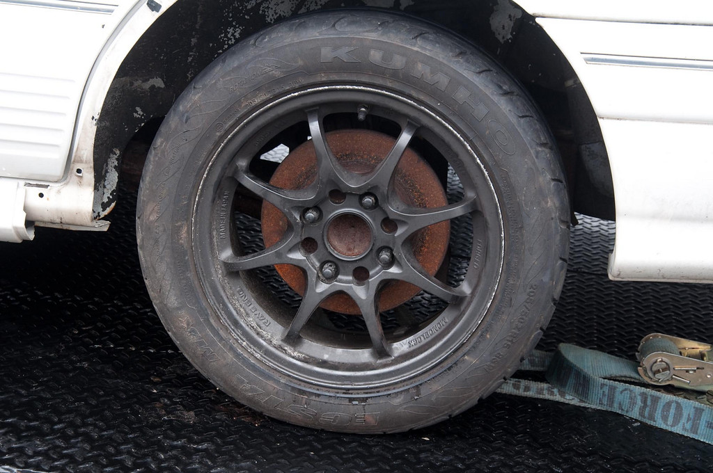

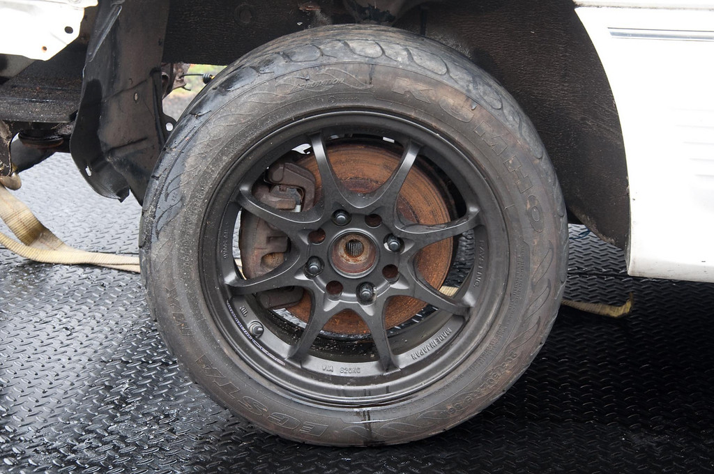

I'v got a set of Volk CE28N wheels off a parts car, I'd like to somehow salvage these things as they are stupid light (something like 9lb each).
The car was run off the road and the pass rear wheel hit a rock/curb or something. Two of the other wheels seem straight, but have some edge rash. One is pretty much perfect. Online I'm seeing these at $499 to $550 a wheel, so I'd really hate to have to pony up for one replacement to make a set.
They are 4 x 114.3 bolt pattern. +43mm offset. 15"x7.0"
Black in color. (I'v only been able to find bronze or silver for sale new as well)
I'm not sure how sellable these are going to be with the curb rash, and Im sure a wheel repair place will ruin the coating in the process of trying to straighen that dent if it's even possible.
Best wheel
Second best wheel with some minor rash
Worst Rash, but looks straight
Dented...obviously needs professional repair
Anyone have any advise? That dent look fixable? If so any recomendation for a wheel repair shop to take/send it to?
I'm thinking the rash could maybe be sanded.smoothed down by hand to be a little less noticable then spray the outside 1" lip of all 4 wheels to look the same. If all 4 hold air and are straight, I'd put 4 lug hubs on my DSM and use these wheels if I can't sell them for some good $ due to cosmetics.

I pulled the wheels off the car today, dismounted the tires. Three good nearly new tires (Kumho Ecsta MX), one tire was sidewall torn. Both pass side wheels had bends, the rear as shown and the front one had a dent on the inside lip. All four ran true on the balancing machine without a tire (other than the two dents obviously) so none of the wheels took a hard enough hit to bend the spokes, egg shape, or twist the wheel. All 4 balanced within .25 ounce too (irrelevant).
My grandfather, who owns the tire shop, sent the two bent wheels out to a repair place today. Should cost $130/wheel to repair the dents and fix the rash. I should know either tomorrow or friday if they were both fixable or not. They said they could fix the rash on the straight wheel, but it would cost the same $130. I decided to hold onto that wheel until I see what happens to the other two: if they come out perfect and look real nice, Ill consider having the last one fixed up for cosmetics vs sanding/painting it myself.
So, I'm crossing my fingers that I'll end up with a set of 9.75lb (on my shipping scale with metal valve stem) Volk wheels to run with slicks for a grand total of $260 invested. /ubbthreads/images/graemlins/devil.gif
