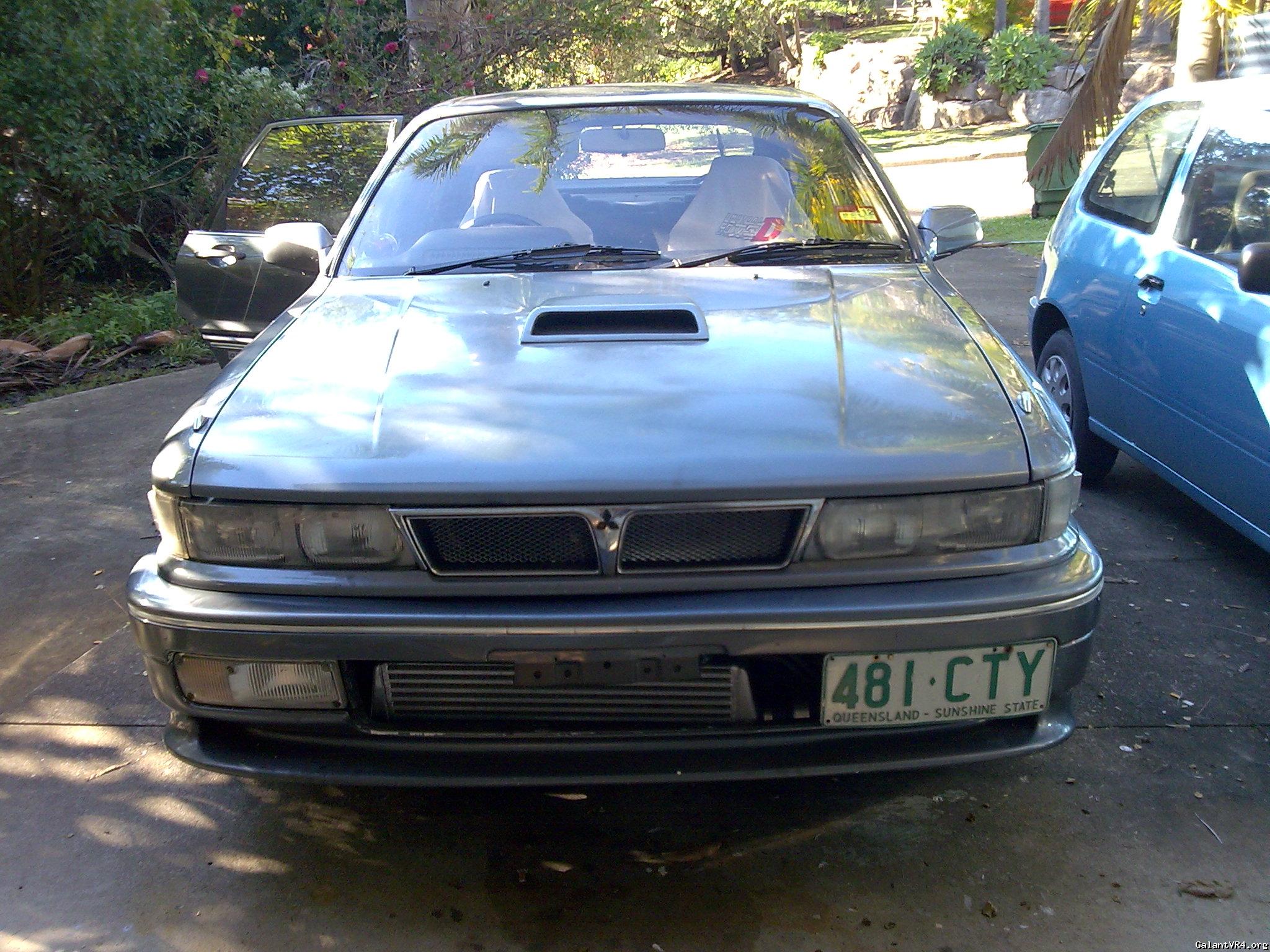

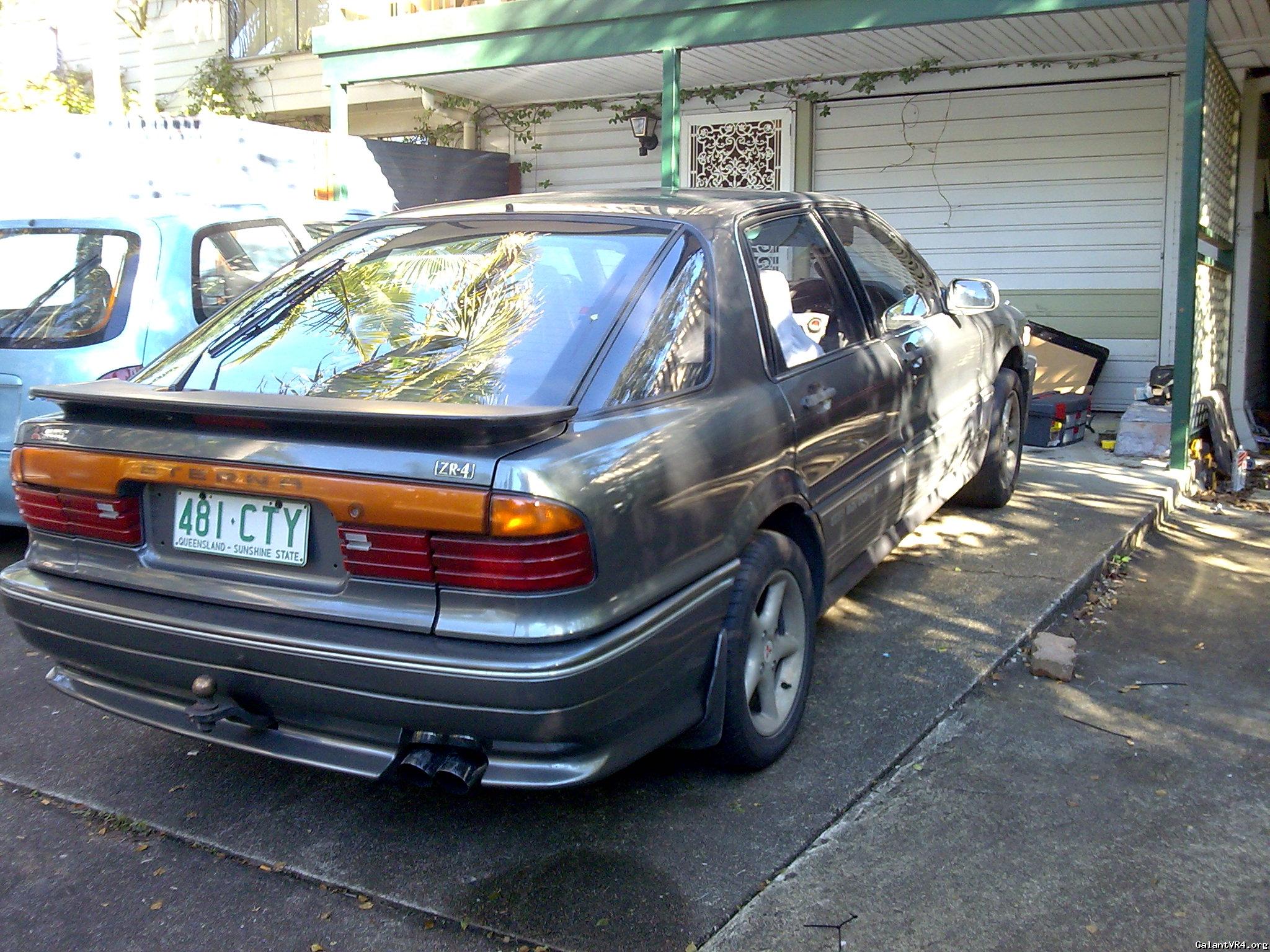

Why wouldn't you just rebuild the motor for the ZR4? Any pictures of it?
I didn't know there was another real ZR4 in Brisbane?
i sold it when i blew it up. i did the rings in and couldn't afford to fix it lol i got pics eh.
brisvr4
Feb 13, 2004
955
brisbane australia
Man, If I ever meet you remind me to kick you in the ass HARD for selling that car!!!! /ubbthreads/images/graemlins/rofl.gif
Actually a few of us are heading out to Willowbank on May 8th for a drag night, you are more than welcome to come say hi if you like.
i do regret selling it it was awesome eh i built it from stock to make 160kw at all four. i dol it to my uncle he is 4g tuner.
