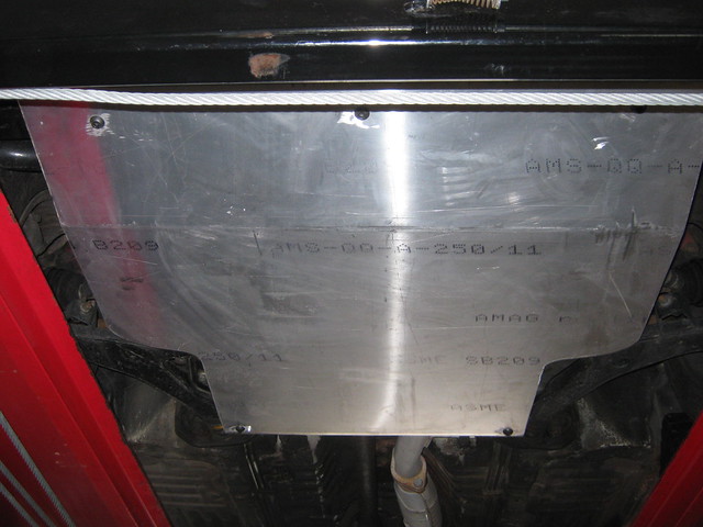

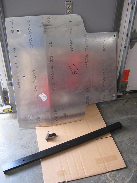

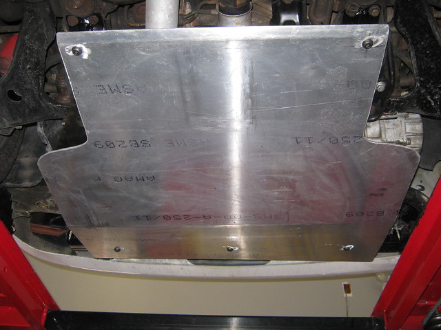

Ryan at TRF fabbed me up a skid plate for my Galant based on the Galant they used to have at the shop. 6061, 3/16 Aluminum
Not pictured is one of the rear brackets.

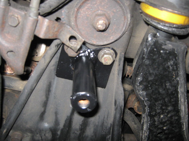

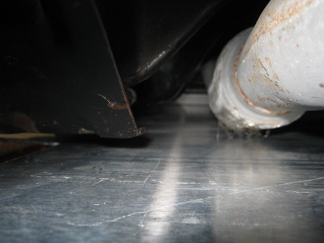

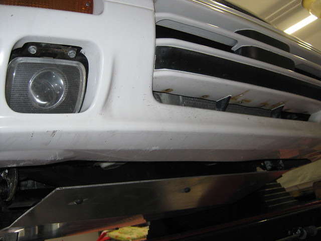

The front bracket mounts between the tow hooks. You can see where the car bottomed out a couple times on me. Mind you I'm not racing just driving out to watch and photograph on the stages. What happens is you head out in the begining of the day, the roads are solid and hard packed. After a few passes of rally cars the roads are now soft and rocky. That's when the car starts to bottom out.
IMG_1456.JPG by Drew84(PASCARPHOTO), on Flickr

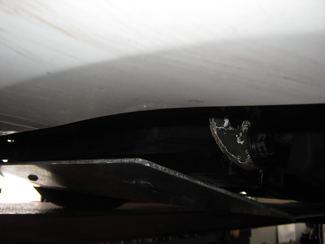

There are two brackets like this at the rear to hold the plate
IMG_1460.JPG by Drew84(PASCARPHOTO), on Flickr

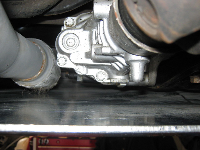

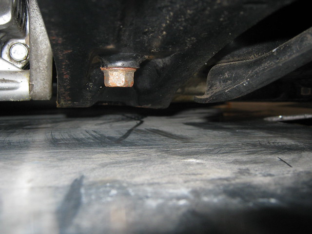

Installed looking toward the front of the car
IMG_1461.JPG by Drew84(PASCARPHOTO), on Flickr

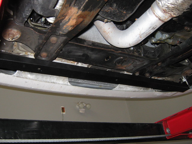

Looking rearward, the black bar and cable is part of the lift.
IMG_1462.JPG by Drew84(PASCARPHOTO), on Flickr

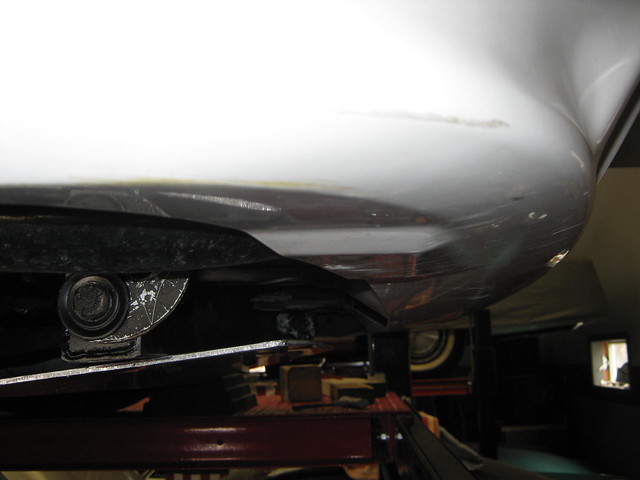

The gap looks bigger here than it really is. If I were actually rallying this car I would have the plate come in front of the bumper and turn up.
IMG_1463.JPG by Drew84(PASCARPHOTO), on Flickr
