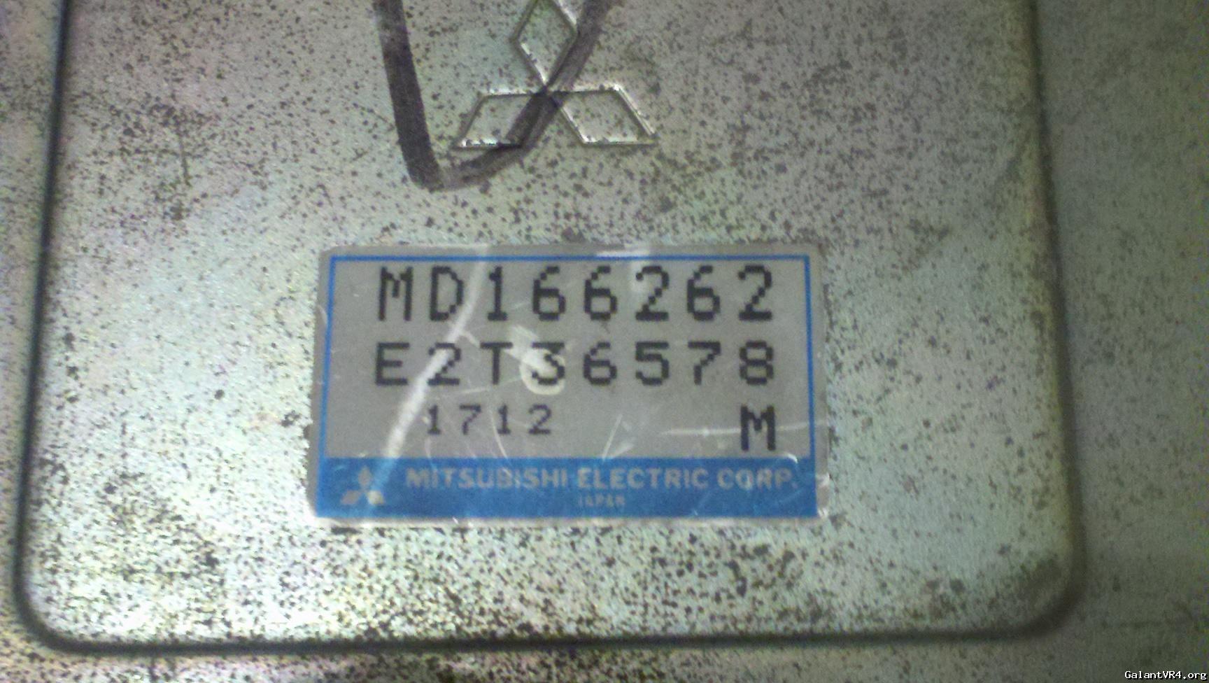

This is the ecu that i pulled from my car.
This is what was in my galant, isnt this a talon ecu? No wonder my engine is running like sh*t. Im pissed
So after doing alot of searching around the net. This is what i found. Im Glad to have this on here now.

I dunno that 90-92 talon ecu worked with the original motor, im just wondering why it was in my galant.
