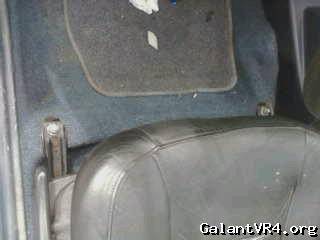

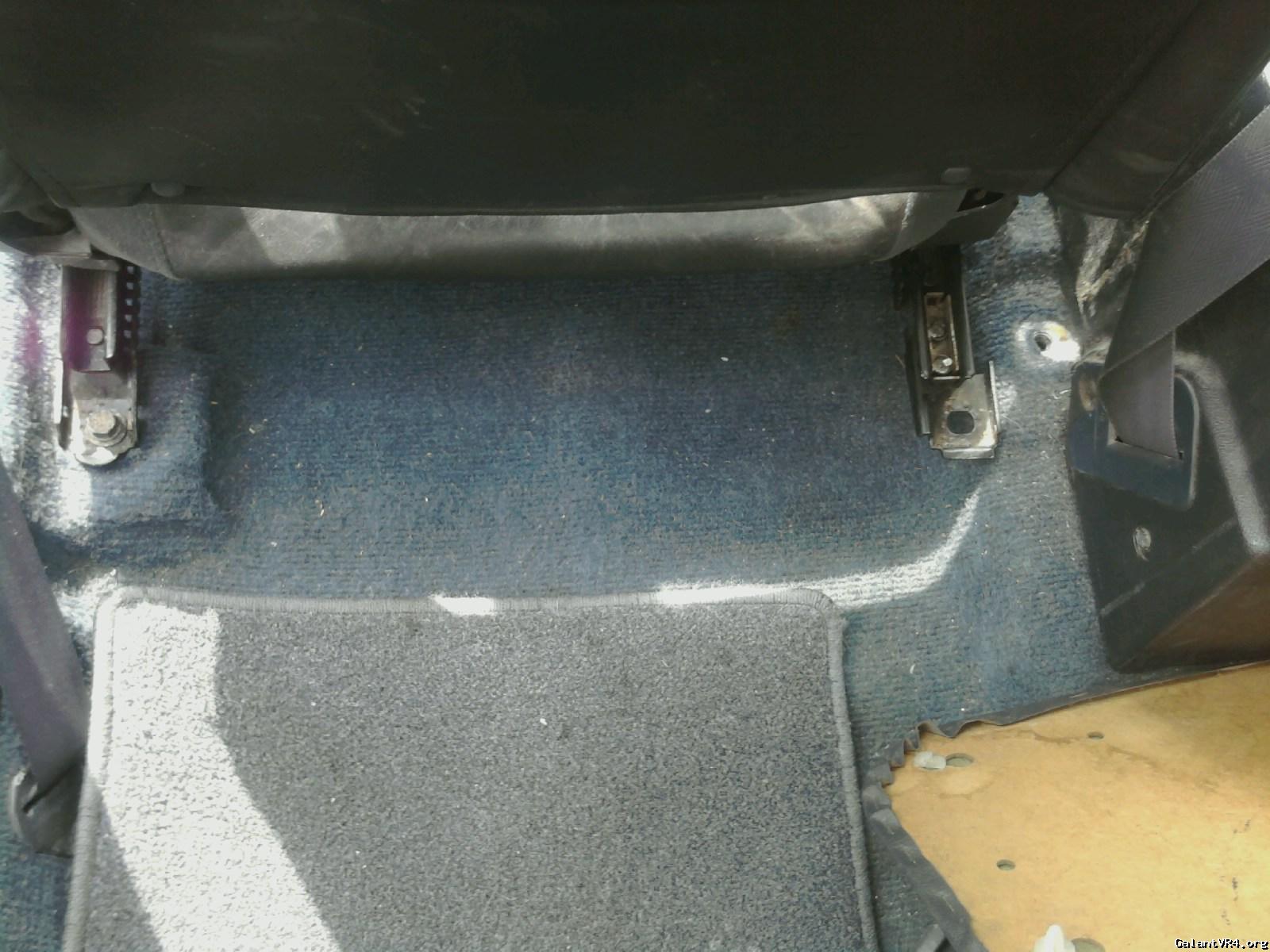

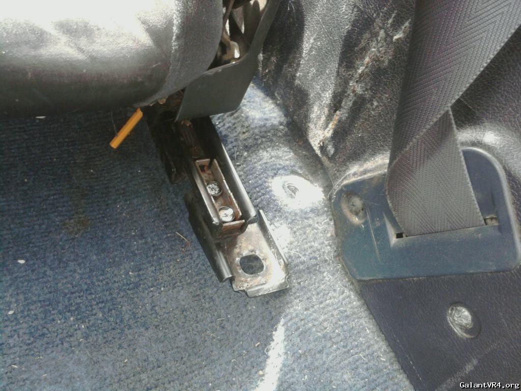

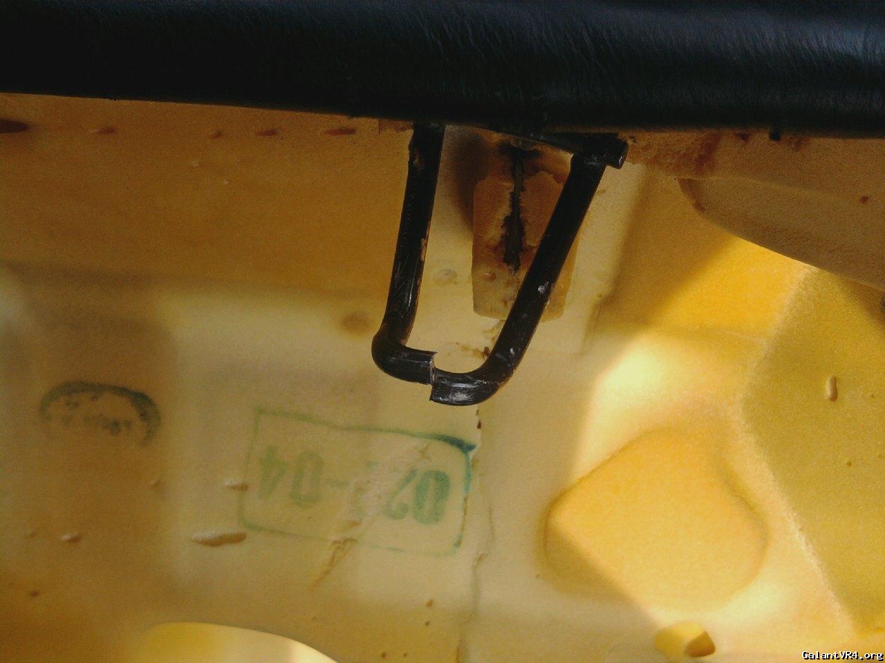

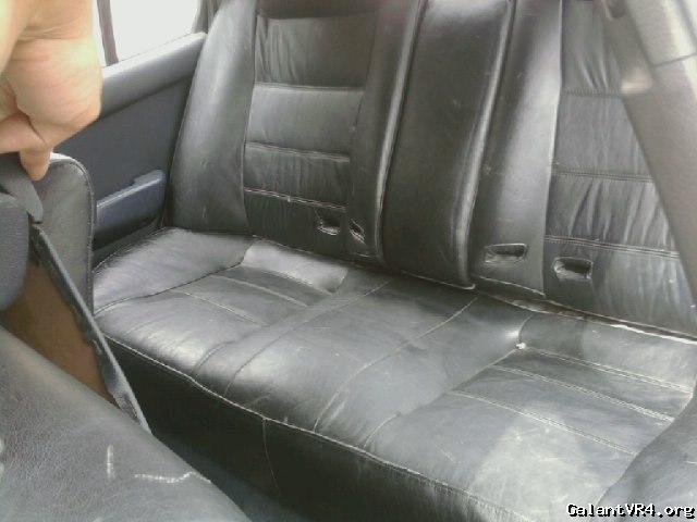

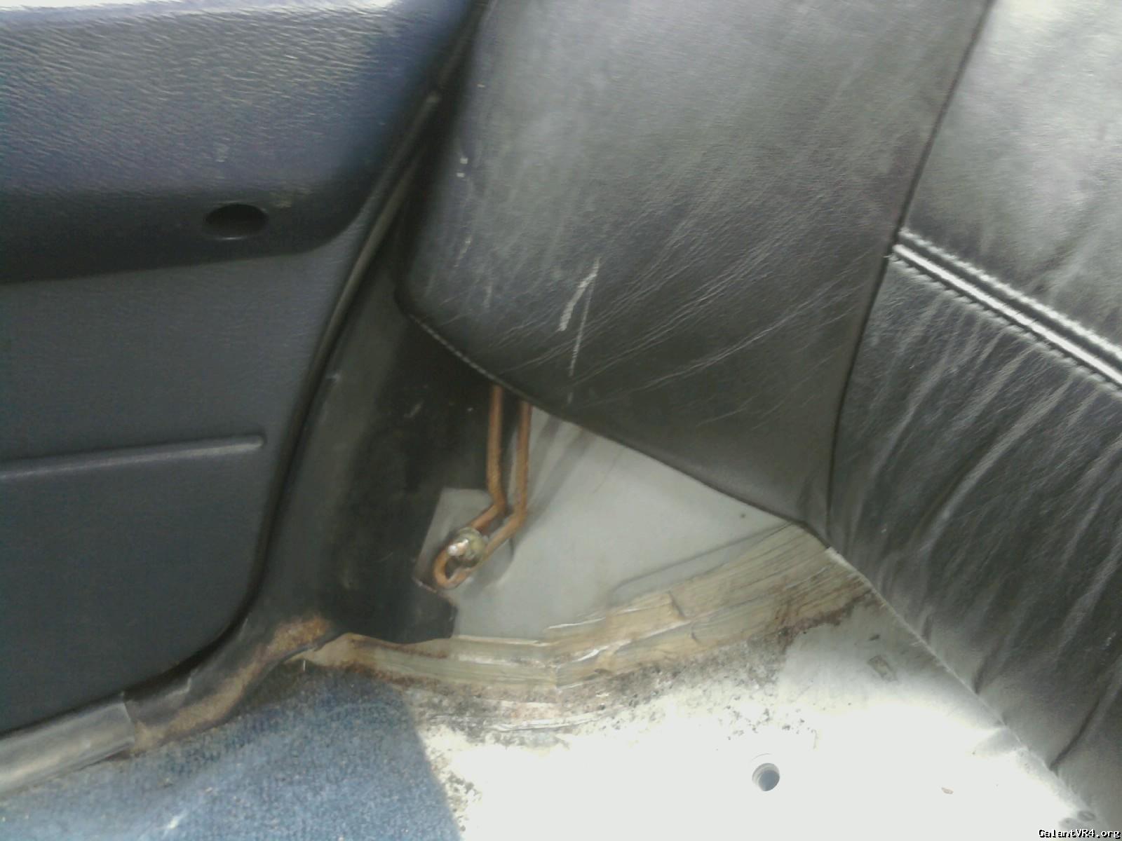

Yeah, my buddy is planning on putting dsm front seats into his csm hatch but we are not sure if they will be close enough to fit. I will go take pics of how the seats are installed on my car and post a link to them. I am satisfied on how they fit and wont be changing them anytime soon. It only took me about hr and a half to get it all done.
TRBODSM
Feb 4, 2009
278
Northglenn, CO
that is how the rear seats were installed. The mounting tabs had to be straightened out to bolt down.
the bottom had to be cut a little bit and compressed back together for the smaller mounting holes on the csm.
rears installed
only one of the rears mounted up
both fronts fit
