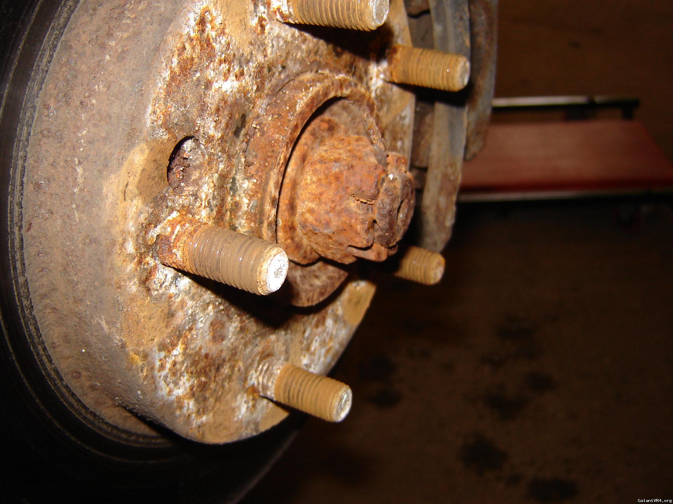

Here is a very rusted axle nut.

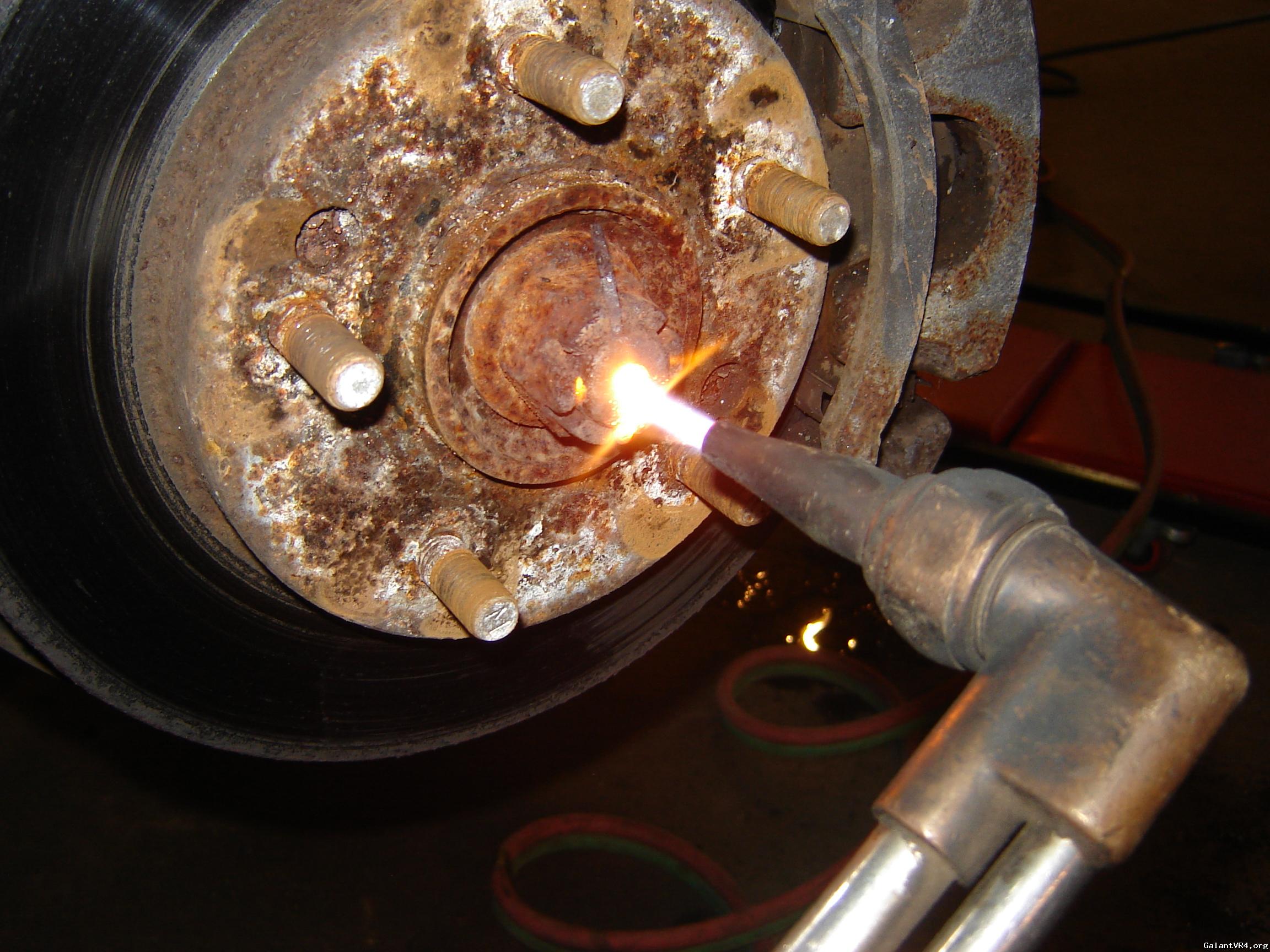

I use the torch to heat up the ruted cotter pin to remove it. I only put the heat to it for aproximately 30 seconds.

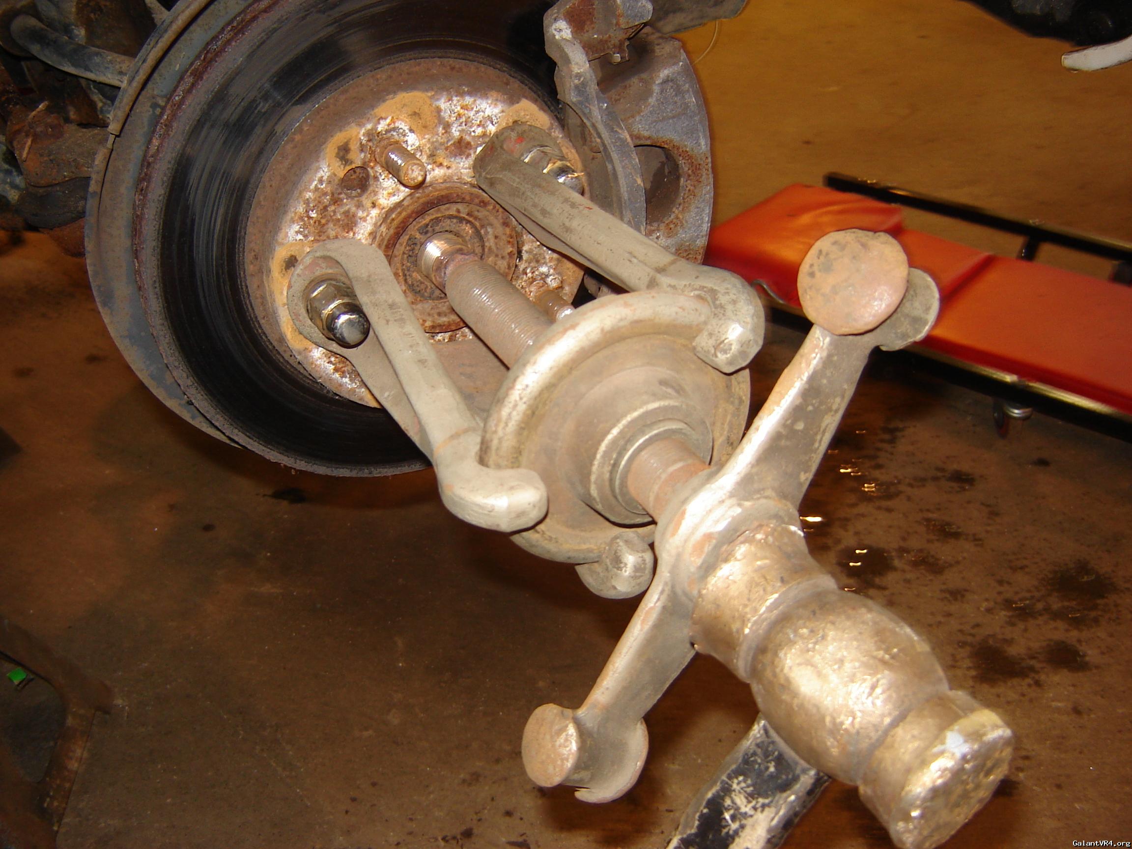

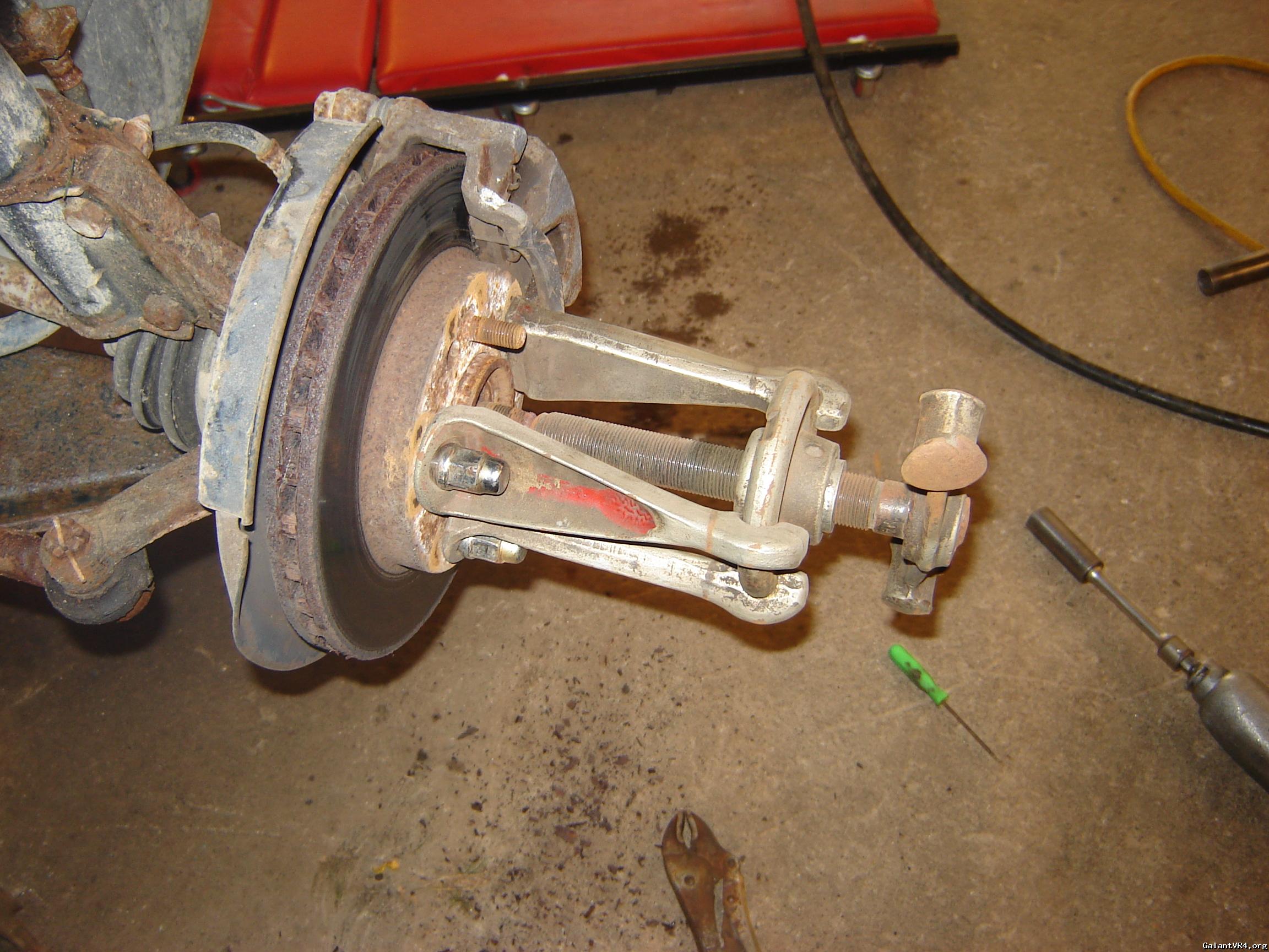

This is the sxle/ wheel bearing press setup on the axle.
And finally, Here is the process that I recorded on to youtube. Rusted Axle Removal by Me
