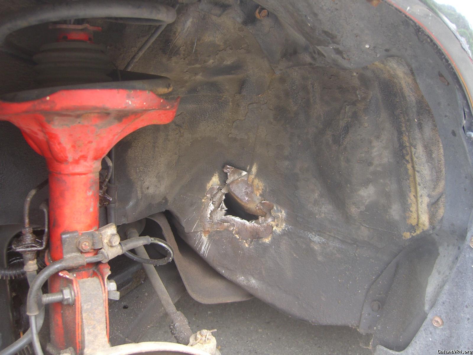

I'm going through it too. So far i've got 3 holes. One about 1" or so in diameter in the driver's footwell, and then one in each front wheel well, both on a seam in the same area. Driver's side (pictured) got as much of the rotted stuff out as possible then used rattle can Rustoleum primer and paint. The passenger side one, same deal but used POR-15. Same for the one in the footwell. POR-15 is great stuff. I coated a relatively large portion of the rear undercarriage with it too just to kill surface rust and because it's pretty durable stuff. As far as a permanent solution to those 3 fully rotted areas, the plan is to cut out whatever's left and patch.
I didn't know about any of the fully rotted areas when i bought the car. The next one i get i will be going over with a fine toothed comb as you couldn't even see this, i found it by prodding and prying with a large screwdriver. I freakin hate this sh*t. It sucked so bad each time finding it. /ubbthreads/images/graemlins/banghead.gif /ubbthreads/images/graemlins/bawling.gif I know it could be much worse though.

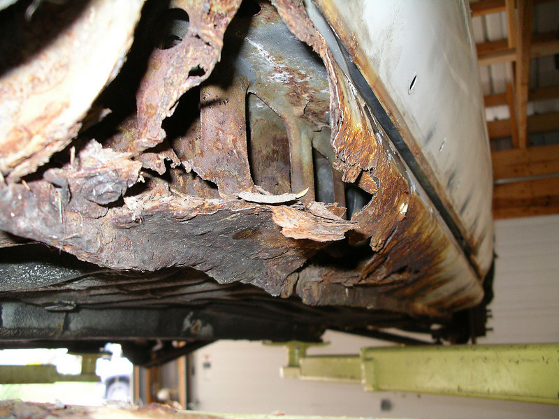

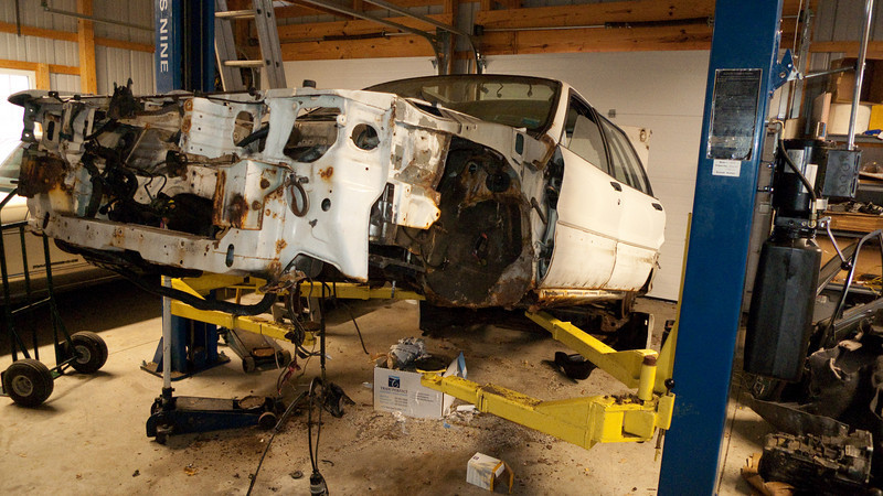

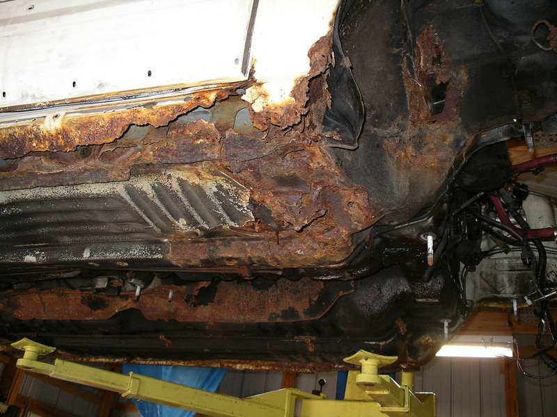

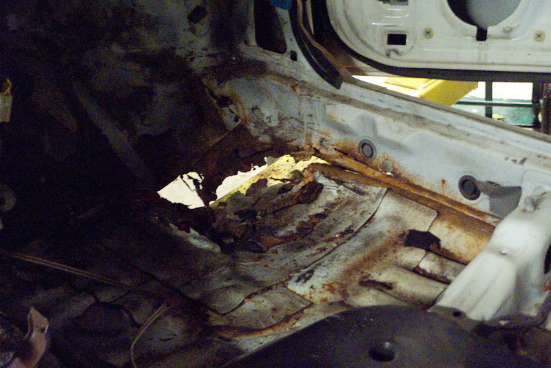

yeah, that was 255/2000 from Rochester NY (GreenGSX....he's the One Lap guy). This car was rotted so bad on the pass side from water getting through the windshield glass seal and running down the firewall. When I was removing the engine wiring harness during the partout, the harness is fastened to the firewall with a few phillips screws that were so rusted, I couln't remove them. BUT.....pulling on the engine harness itslef was enough to get the harness out....WITH THE FIREWALL ATTACHED! I pulled a good 3 square feet of firewall off by hand. Maybe enough that my 3 year old son could have wiggled his way from the pass seat area into the engine bay via the new under dash passageway. hahahaha
I mean, yeah, the rocker pannels were rotted completely through as were the bottoms of the doors and much of the area that mounted the rear subframe. The car was a goner from rust cancer in those areas anyway from typical rust due to snowy winter use. The windshield rot damage could have happened to a southern california car easily. Don't be fooled into thinking a southern/western car is immune to rust just because the climate is warm and dry. A leaking windshield seal lets water soak the sound deadning mat and the carpet underside...which holds water against sheetmetal pretty much forever.

The wind shield glass was replaced and the installer scratched the hell out of the channel that holds the glass. That caused some serious rot around the windshield which allowed water to leak in. The water pooled inside the a-pillar, the side rails, and by the front wheel. The car also sat outside for a year before I bought it and that after I drove it for a winter it was stored in a garage for almost another year before I put it back on the road. From there is was my winter car for two years and was only driven in the summer a couple a times a month. I autocrossed it a few times and put most of my old race car parts on it so it was fund to drive.
When I sold it to Nate it still looked OK from the outside and went down the road without any problems. There was no outward sign that it was that far gone and really the only way to know would have been for me to tear it apart like Nate did. If I had know it was that far gone I would not have tried to sell it as a "car" I would have parted it out myself or found somebody who would for me. I can't imagine what that car would have done if it were ever in and accident.
