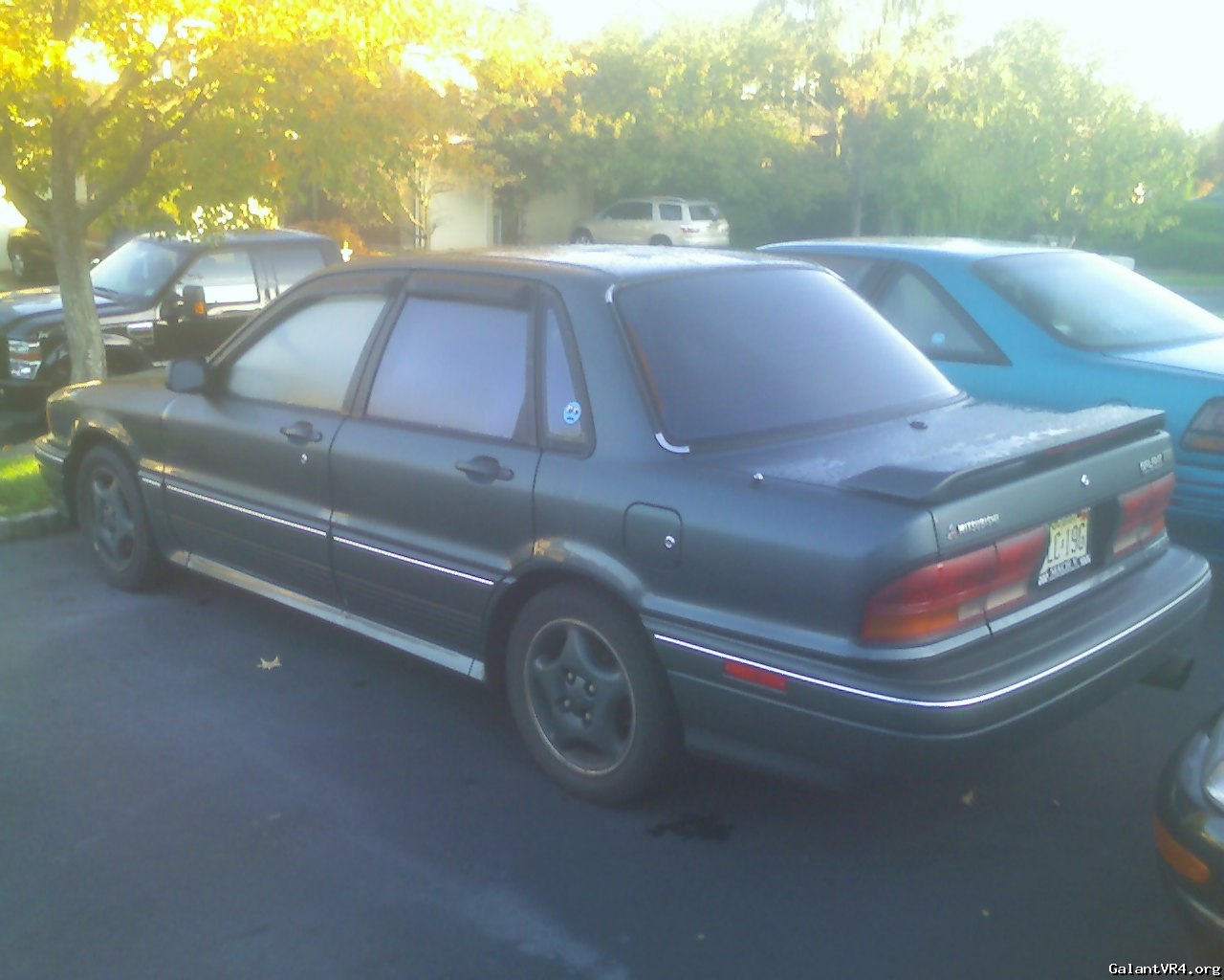

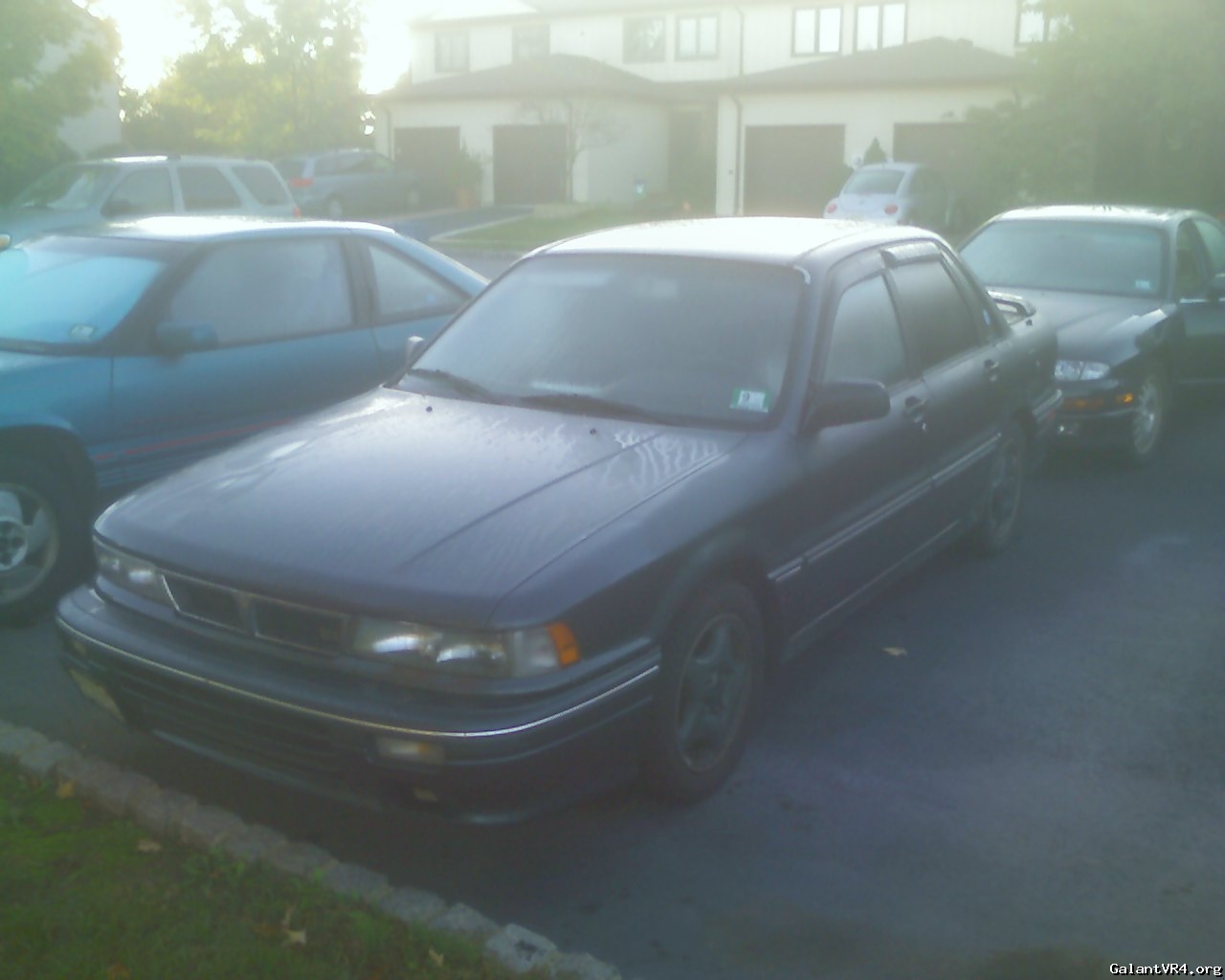

shitty camera phone pics but hopefully JB will lift my temp ban now... Aaron I still owe you interior pics, the camera wasn't gonna cut it for that.
