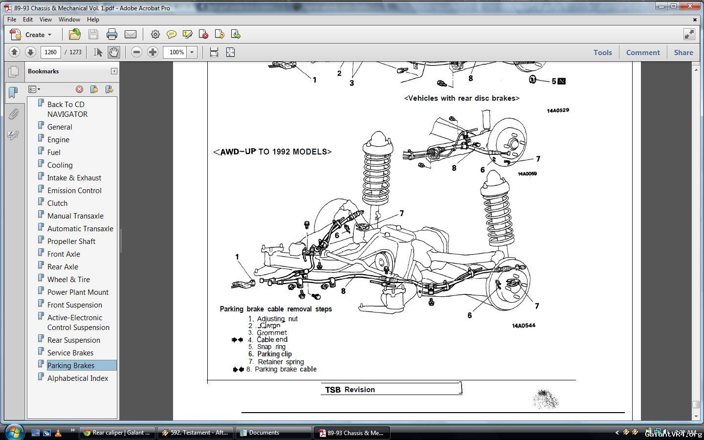

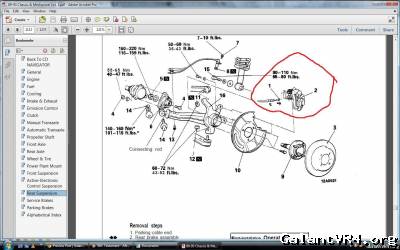

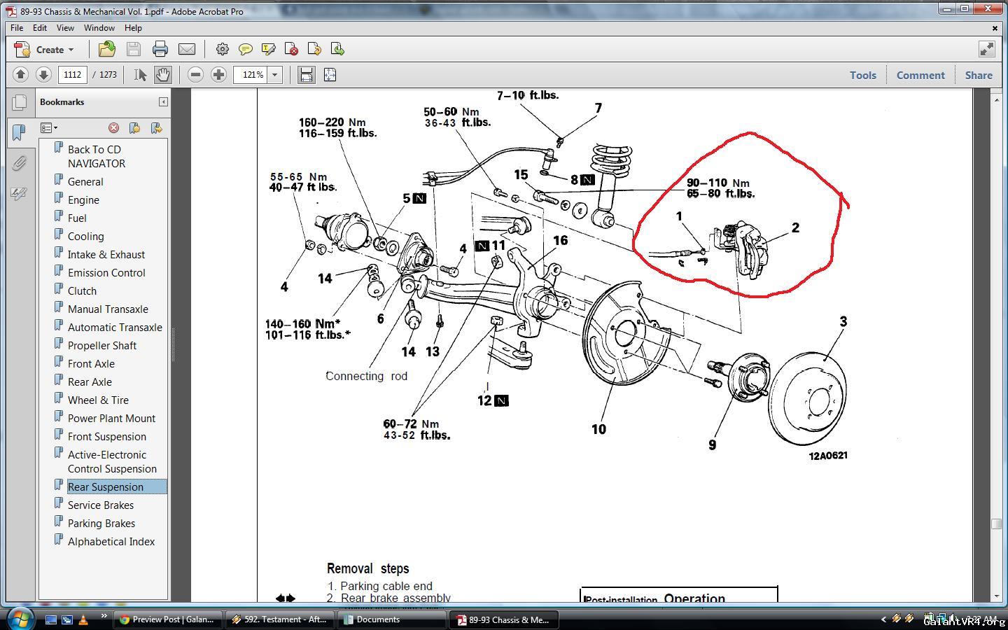

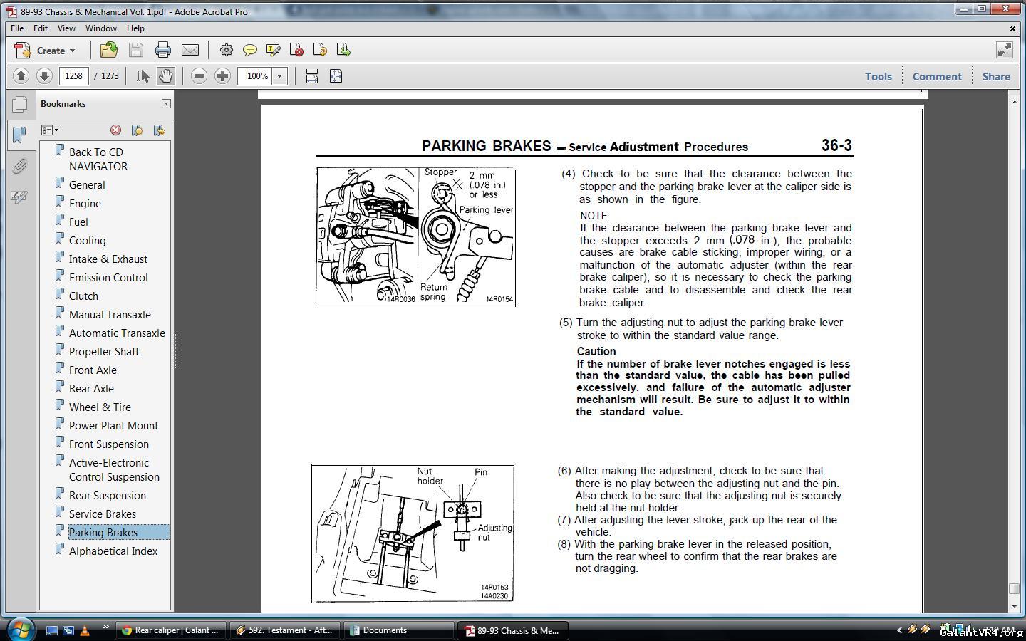

Swapping in a DSM subframe in 570/1000. I went to put the parking brake cable back on, and now I can't remember how the keeper went back on (the one that goes on the caliper's arm). I've searched google for about 30 minutes for a picture, but can't find one. Can someone post a pic, or do their best to describe on how it goes on?
