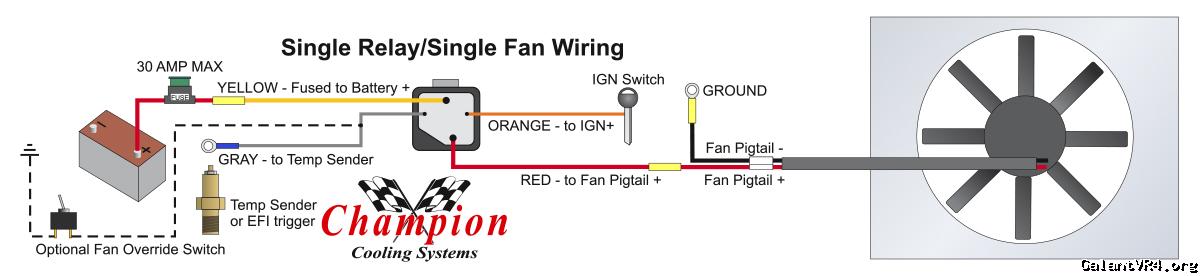

transparentdsm
Jul 27, 2011
3,690
Cherry Hill, NJ
to run a relay you need it to be set up like this. and if you want two fans you add another fan and another relay and splice into the first relay for your signals(temp sensor and ignition key).
tektic
Dec 19, 2012
1,497
ronkonkoma, ny
Thank you. The factor sensor has two wires. I fed one side ignition power. Other side goes to the relay. Other side of relay is grounded.
The problem is the fan goes on as soon as I turn key to on. I though it was a bad sensor, but now I'm assuming its going to shut off when the sensor gets to temp.
I just noticed there's two different sensors with the same plug but different threads. I'm using the ones that fit in the thermostat housing. That's the ac fan switch?
What I really need to know is if that's a temp sensor or a thermal switch. If its a temp sensor its useless in this app. If it is a switch I should only need to swap the output to fan to pin 87a from 87 to reverse logic of the circuit.
I'm pretty sure this will turn the fan on when the sensor is unplugged, off when plugged in and cold, and on when hot.
