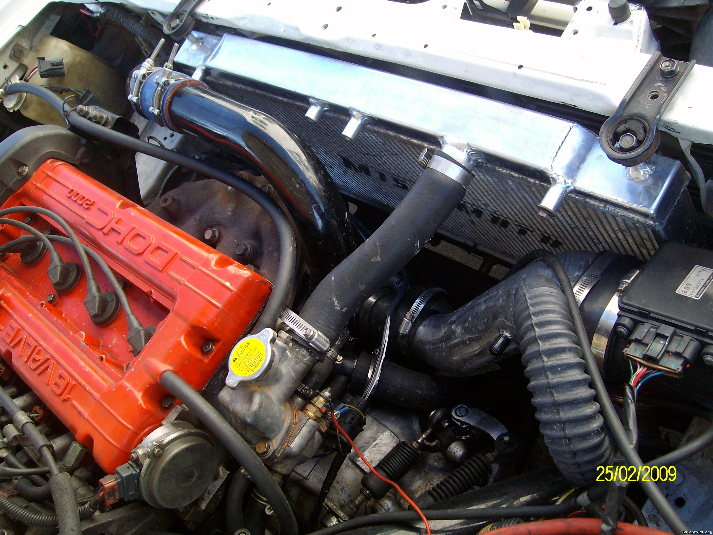

thats the one I have in mine and it works great, withstood 100= degree in the summer in tucson arizona and then -10 this winter when I moved to minnesota,its seen like two 2100 mile coast to coast trips and not one flaw, you have to get the termostat housing of a 2.0 dsm turbo or not, there both the same, or one of the 1.8 dsm but withthe 1.8 you have to get a diffrent hose and run a longer catch can hose, you can't use the engine side fan (puller) but the one infront of the radiatior works fine it has for me, the dsm unit is like a inch shorter so you will have to install bolts or something to make it reach the top radiator supports all this may sound like alot of work but its not it took me and hour to do all this the hardest part was yard surfing for a upper thermostat housing, but for a very good product and and great price you cant beat that, oh I got it off ebay to
