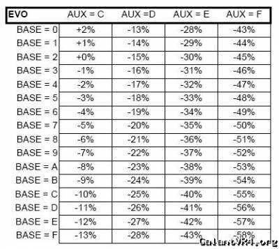

I don't know if the chip is different inside their MAFT made for the EVO, but you might try BASE=2 AUX-C
The EVO8 MAS is virtually identical in compensation to the good #482 MAS. If that doesn't work, maybe you can get them to send you an EVO chip for inside your Translator.

Would all the other Dials be set to 0? It idles at 600 when I tried that setting and it is extremely rich. Just driving around town, the wideband is pegged on 10.0 and it is extremely sluggish.
