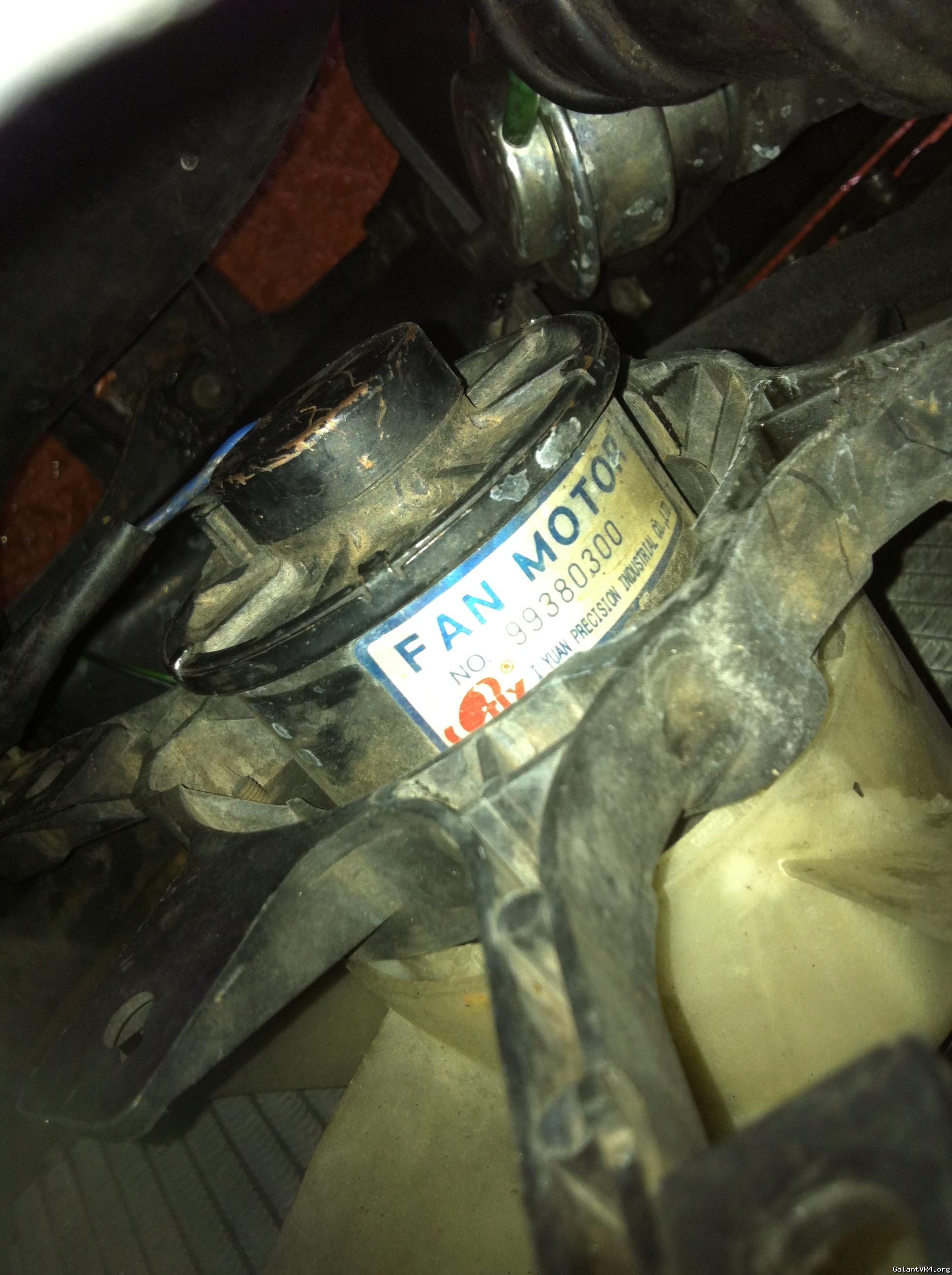

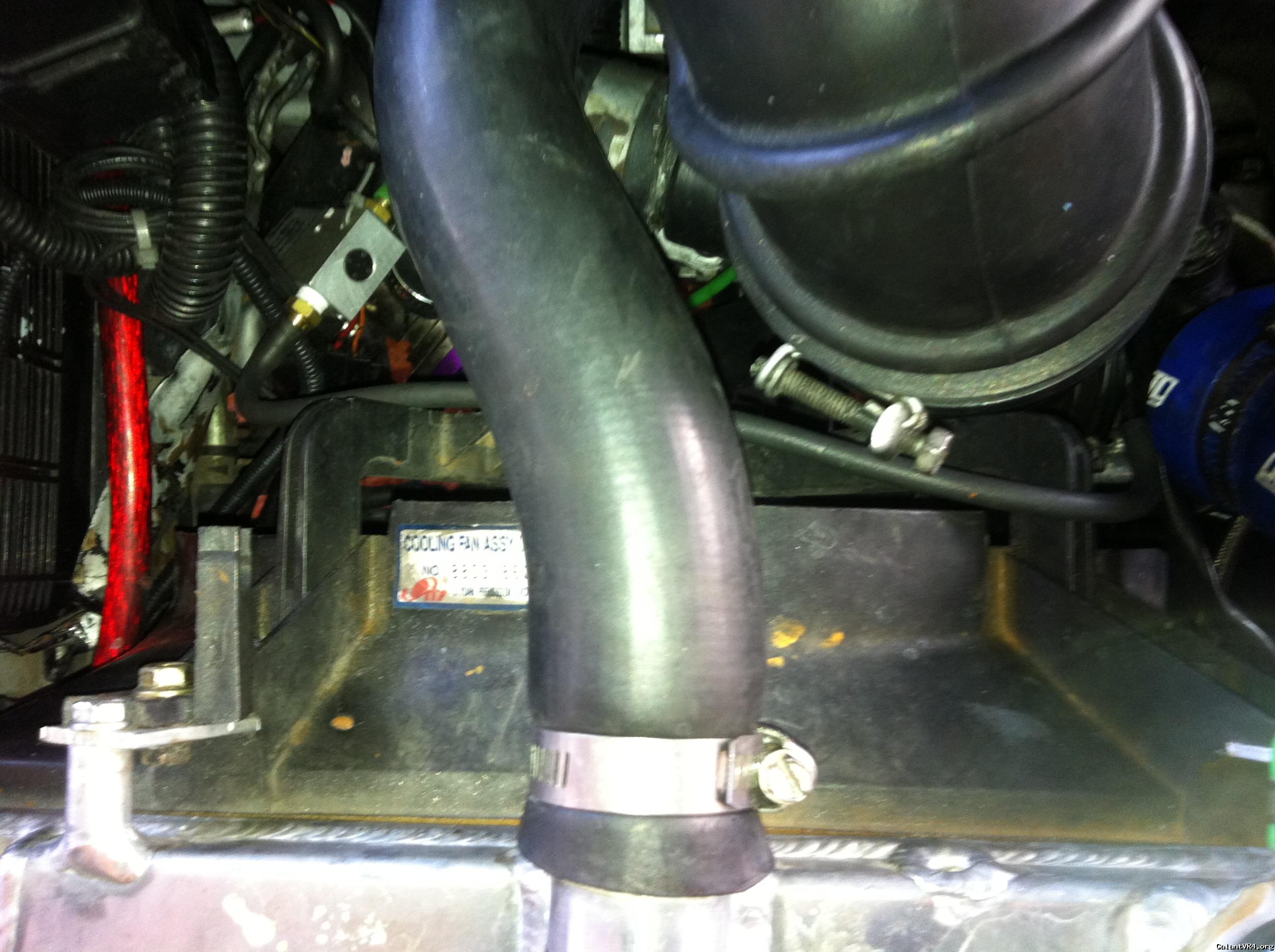

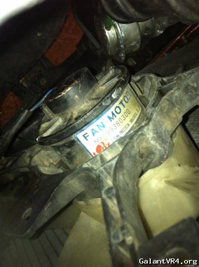

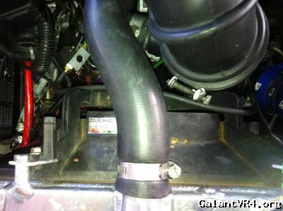

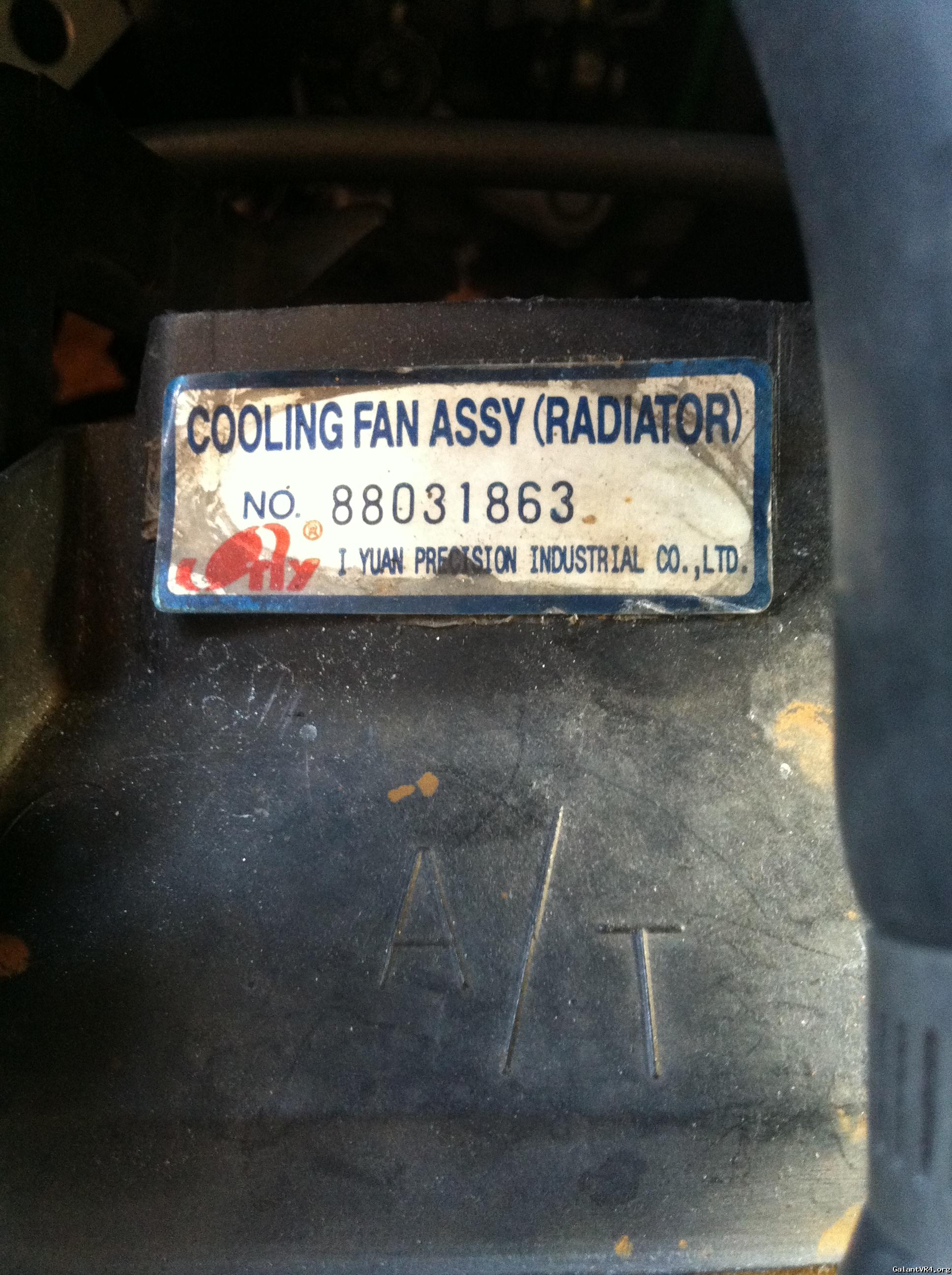

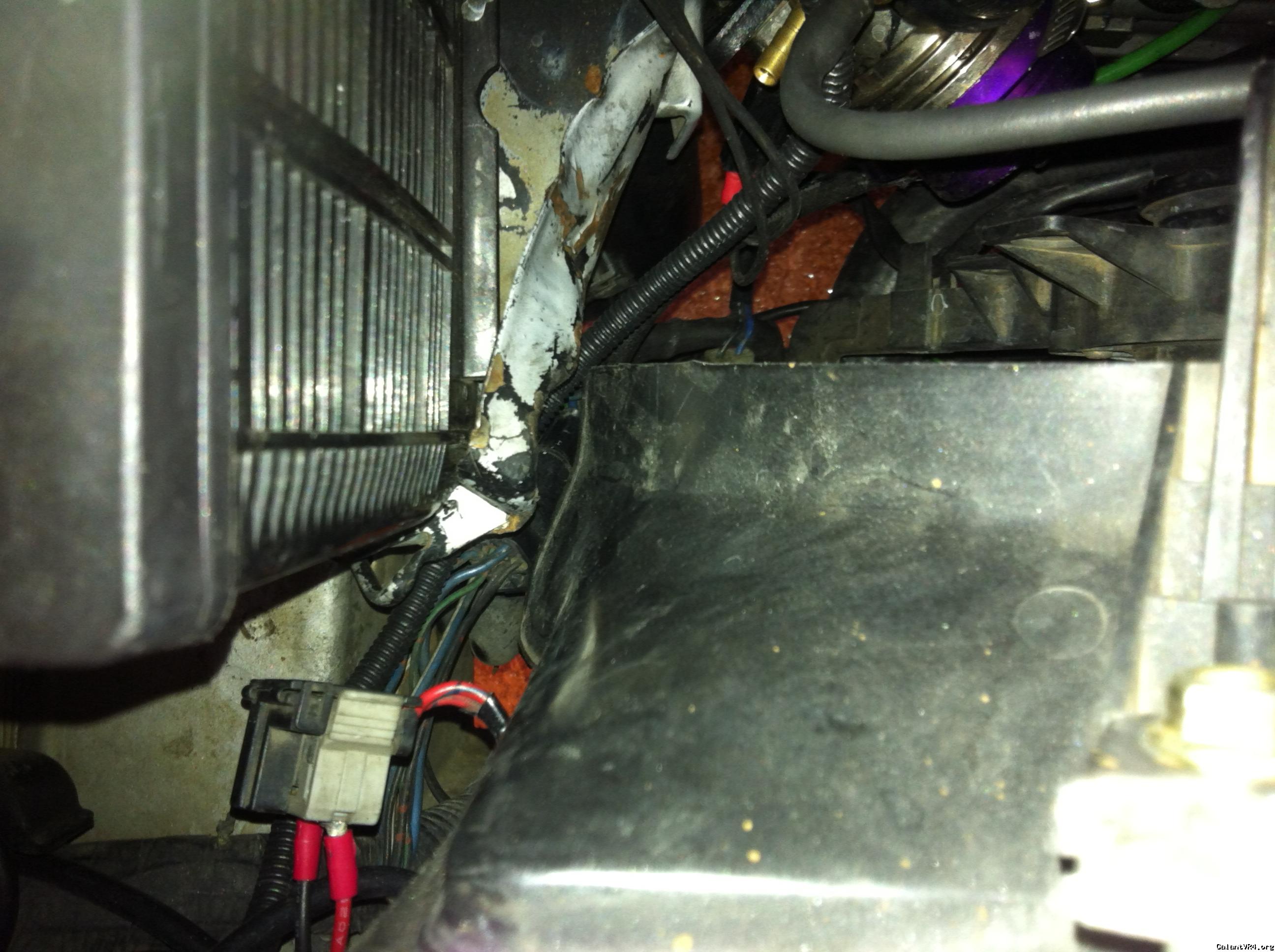

Here are some pictures of my fan, is this stock? i searched the numbers on the top and the motor and did not find anything?

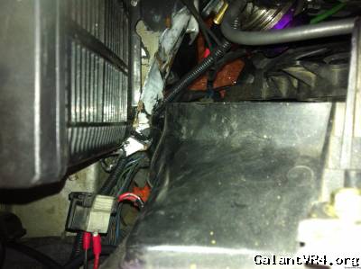

Look at the battery tray beside the shroud? i don't think that's factory?
Cheers, Brock

looks like factory fan. The second fan turns on when the sensor in the thermostat housing gets to the determined tenp. Its normally quite hot. If you take the sensor out it will say the temp on the base where you tighten it.

Hmm, those fan shots don't look like the Aspec fan that I have here.
The fan should be a straight bolt up fit on most alloy radiators. Your's looks like it doesn't cover the whole core Brock.

Yea Tim the radiator brackets broke so I fabricated my own. It all did line up but the old radiator and fan were pretty beat up
