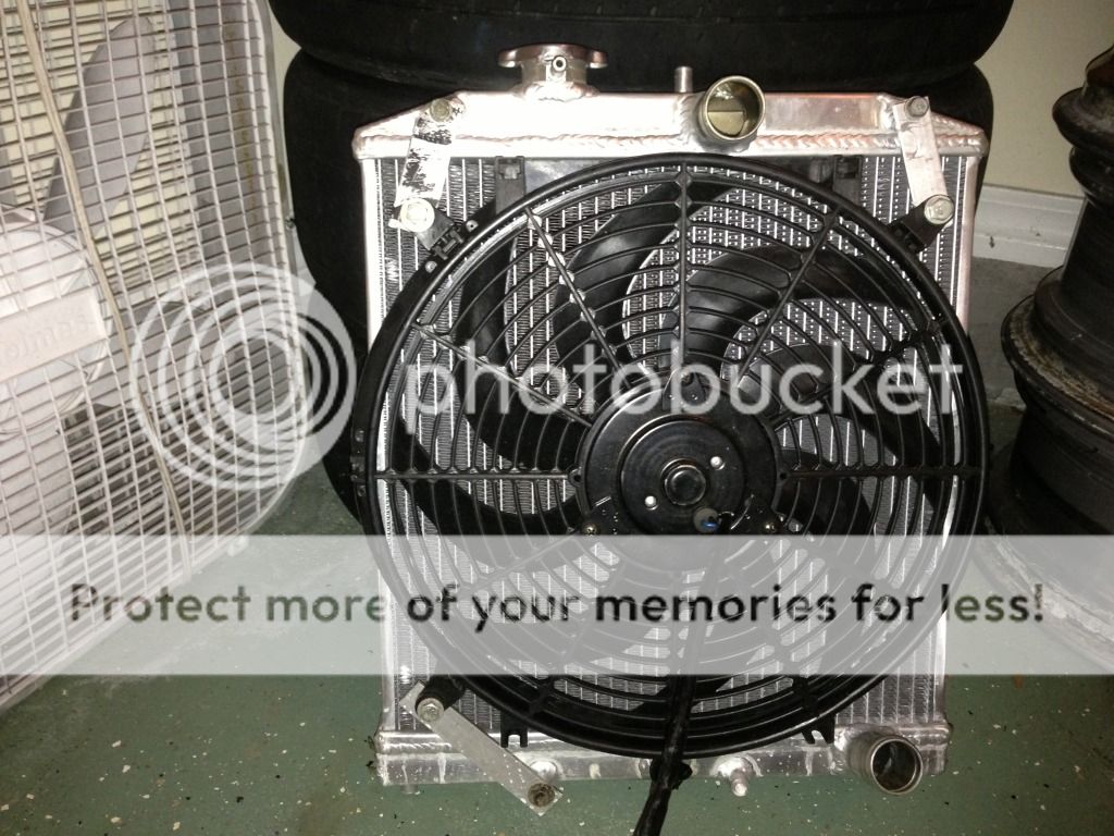

I now am looking into a Honda half radiator. I see people running a 2" or bigger but I just don't seem to have room at all. I mean I could fit maybe an 1.5 radiator with the fan but not a 2" with a fan. The shroud wouldn't clear the intake pipe, and yes im talking about a slim fan.
Do y'all think a Koyorad 1 1/16 radiator with a badass slim fan would cool enough?

i would say it depends on if its a single or dual core rad. and also what kinda driving you do.

most people run a slim fan with the civic radiators.
