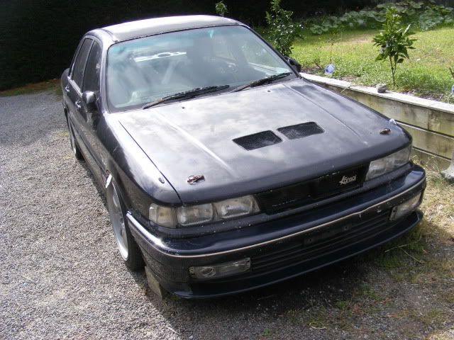

Just incase anyone's still wondering about vents, I just got a jigsaw and cut a pair of holes in the bonnet (I guesstimated the size/shape and position of Evo vents) then threw some mesh underneath with a rubber strip around the cut edge of the holes.
Works really well (valve cover leaked onto exhaust mani, airflow over the bonnet sucked the smoke out of the vents = impromptu wind tunnel test, haha) and looks okay, though I'd leave out the rubber strip if I did it again.
Constantly get people asking if it's an evo bonnet.

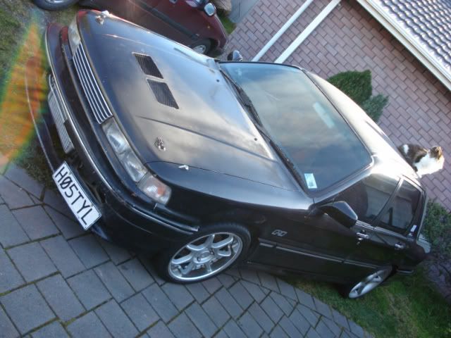

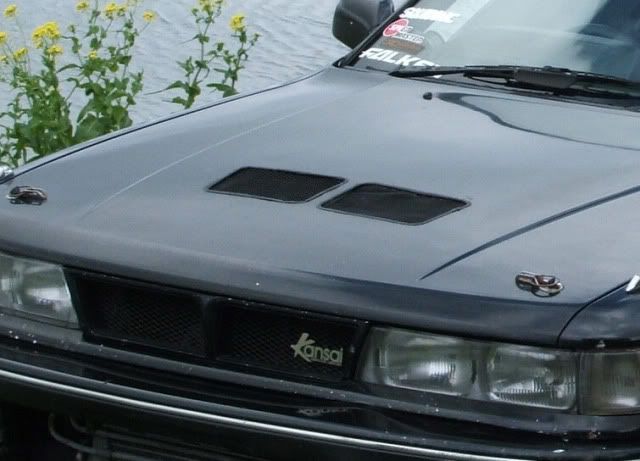

nope, about 5 years ago!
These are the best pictures I have - from most recent to oldest.
I believe the removal of the under bonnet heat protection stuff has probably contributed to the demise of the paintwork.
When moving little to no water gets in the vents. When stopped at traffic lights water steams off the exhaust manifold heat sheild. The car lives outside so I have a plastic sign (corrugated plastic, like real estate signs) that I put underneath the vents to direct water away from everything important.

That's actually not that bad looking. A higher quality screen/mesh/guard, some slight design changes like adding a deflector on the bottom to redirect water and it's good. I mean, sure beats the hell out of a $600 jdm hood and I bet those cutouts do a better job of pulling heat out.
