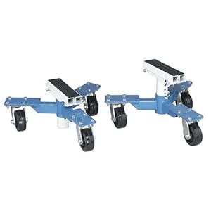

Option 1).
OTC Car Dolly
Says they clamp to the pinch welds (I've heard using the pinch weld is a bad idea?), and roll around...
Pros: They look very stable
Cons: Expensive ($300-$350 a pair), casters don't lock.

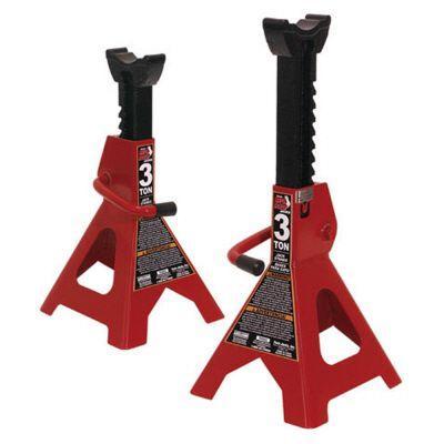

Take a wheel dolly, and then weld a jackstand to it. So basically
Or something of the like.
Pros: Probably fairly cheap, locking casters (on that particular dolly)
Cons: Might be less stable than the pinch weld clamping style.

I would not try anything around the "pinch" weld area. All it takes is one screwup, weak spot, et-cetera, and you're faced with nasty, expensive to fix, or permanent damage.

keep it on wheel dollies for mobility (as good as those work anyhow) and jack it up when you need it jacked up.

Do not weld regular jack-stands onto wheel dollies, they will pop out & kill you!!! The pinch weld ones look safe enough so long as you put them at the factory lift points, right behind the front wheel & right in front of the rears, there are notches you can see where it is reinforced. Same spot you'd use the fact jack to change a flat.

I don't think you'd want to have the car sitting on any area if you're going to be moving it around unless it's secured to the car, ala the first option with pinch weld clamps.
I don't see why using he pinch welds is a bad idea ? /ubbthreads/images/graemlins/dunno.gif It's going to sit with all of the weight of the car right where the factory jacks support it anyways; the clamping on the pinch weld is just so that the car doesn't slide off when you're rolling it around.
dollies+regular jacks = bad idea.

First option we have at our shop. The best way to go as stated by others before me. We've rolled alot of cars around in and out of the shop and even over 1-2" floor lips at the entrance. They can take a beating, as long as they are secured tightly. I've had cars with misplaced keys sitting in front of our E-test dyno rollers, this gets a 2wd car out of the way pretty quick. /ubbthreads/images/graemlins/smile.gif
