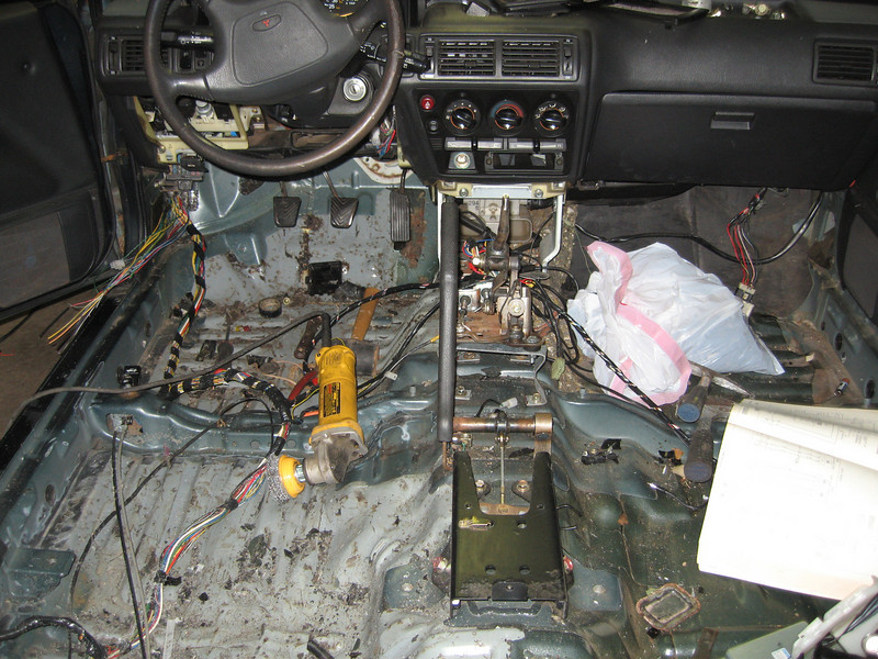

I have a garbage bag full of crap, it's got to be over 50lbs as it's starting to tear now.
I found a secret to getting the sound deadening up. smack it with a really really pointy hammer. I found one in my basement and I don't know what it's really for but it's like a hammer ice climbing pick thingy.
take's just one smack and a 2" x 1" piece will fling off. I tried to scrape it off, pick it off, rubber mallet it off, nothing. Gotta nail it with that pointy hammer. It puts a tiny ding in the floor but whatever, it comes off CLEAN and easy. That crap is heavy!

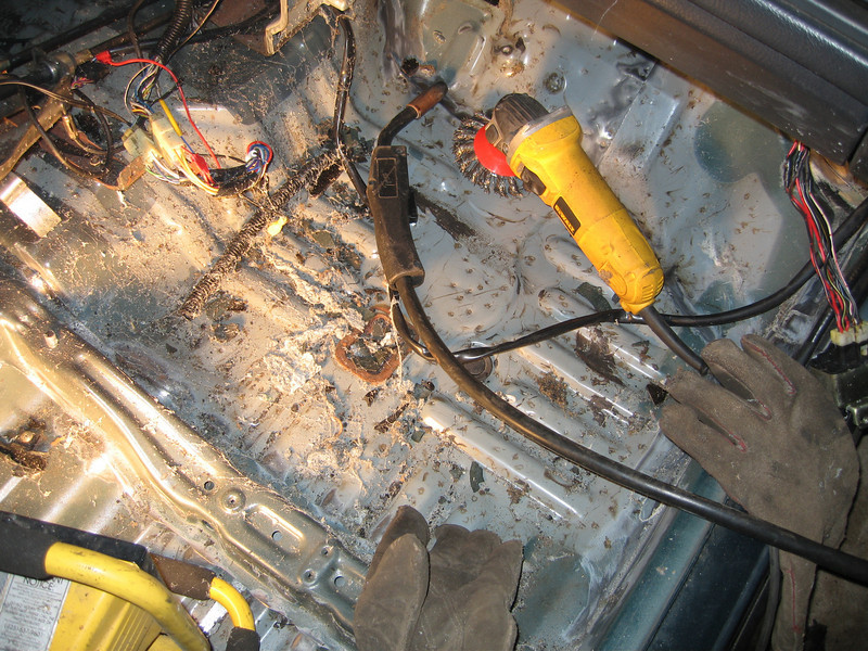

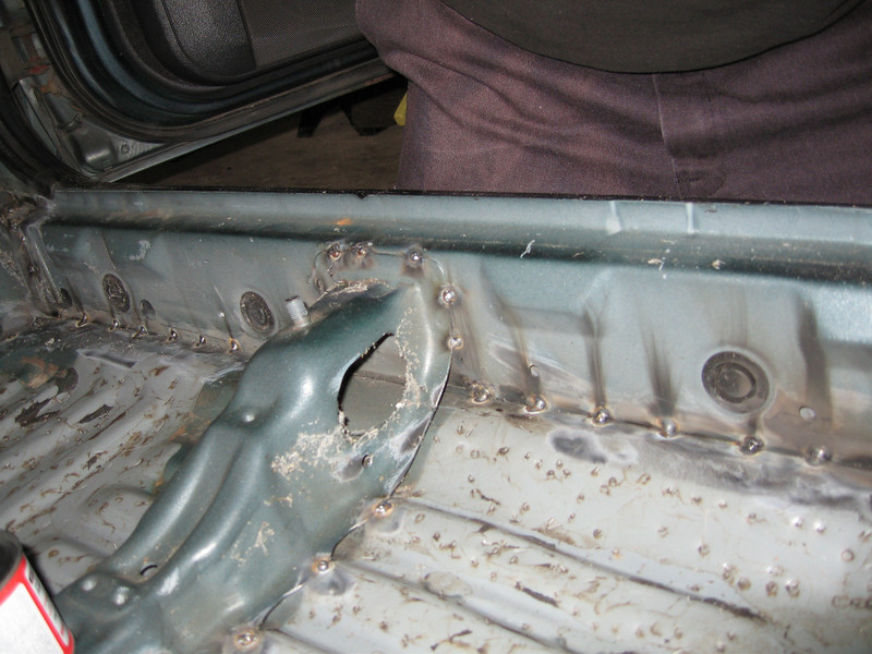

Once I got it up I stiched the floors. Once I ground off all the glue and most of the paint it was too late to turn around, but honestly it's not worth doing on our cars. There are SOOO many spot welds on all the pieces, and there really isn't that many sheets to weld together in the passenger compartment. I'm sure the one's up near the A pillars and firewalls are more important to get to but I'm still driving this car all the time so I can't rip it apart that much right now.

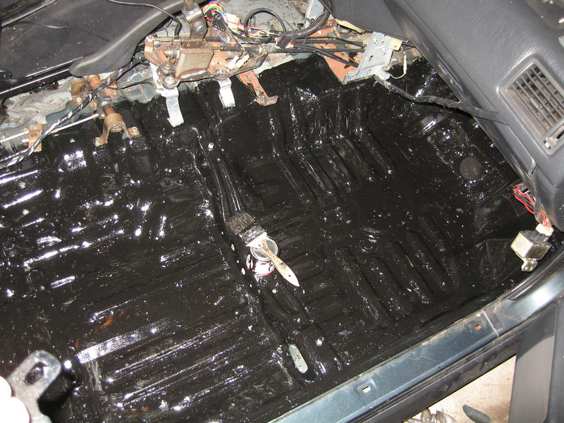

Then I smeared the floor with POR-15

And yeah, you can't weld for sh*t with the undercoating under the car in place. If i turned up the heat any more on my welder the undercoating burn, and rise through and rape whatever weld I'm doing. So all my spot welds are too cold, but i'm sure they will work. No way could I get all that crap off the under of the car, especially since our fuel lines are held in place like a g string on a fat girl.
I'm even more impressed now with the build quality of our cars that I've scraped away at the chassis. Top notch assembly, not cheap for sure. This is what makes our cars NOT DSM's
that wire wheel worked WAAAAAY better than the cup. $4 harbor freight! /ubbthreads/images/graemlins/laugh.gif

POR-15
Annoying that that paint is made in the town next to me but they won't sell it out of the factory. I have to mail order it. WTF!

Oh and the POR-15 is just paint, it's not thick or heavy. I think I'll be under 12oz to do the floor, and i'm sure it dries less than half that weight.
NJ = rust, all those welds would rust pretty much overnight if I didn't seal them with something.
