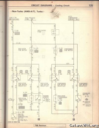

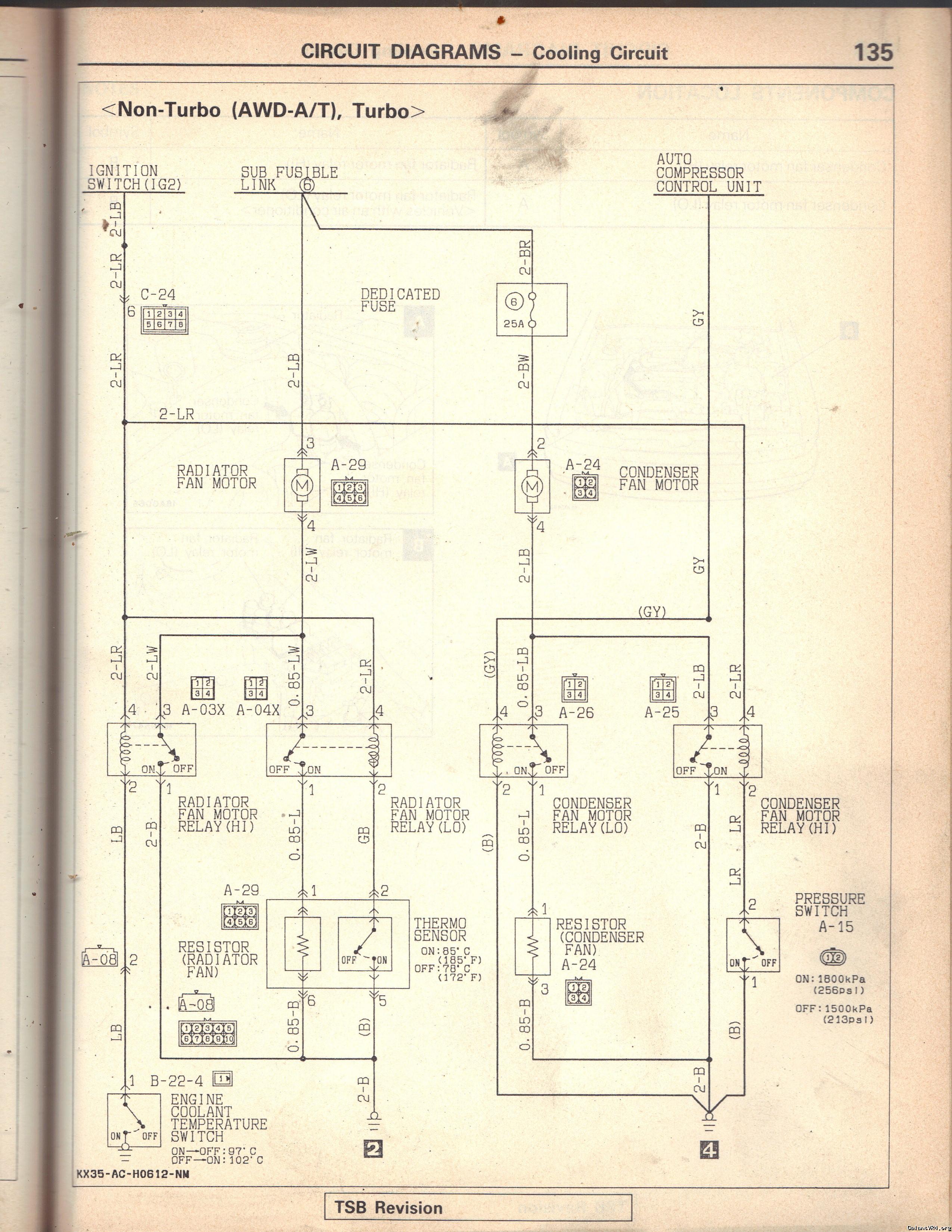

Our cars have a high fan and low fan relay. The radiator fan always has a powered lead (even when the car is off) and the ground to the fan is switched via relay. When the thermoswitch in your radiator hasn't tripped yet your a/c can still cut the low relay on (which has a resistor between ground and the fan). I would check both relays and make sure they are functioning correctly and aren't stuck in the on position. My electrical manual is at my shop right now but I'll scan you a diagram tomorrow.
