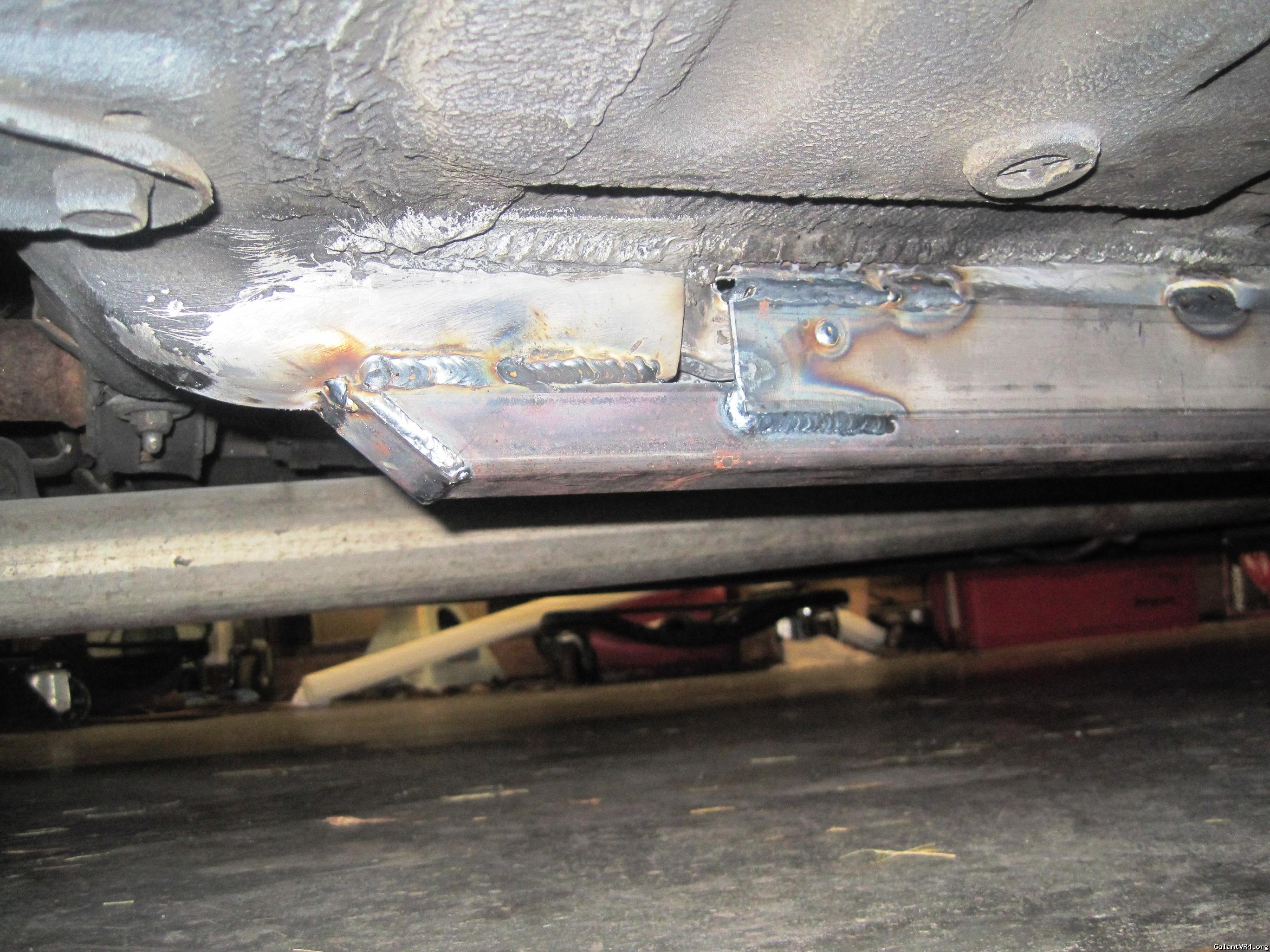

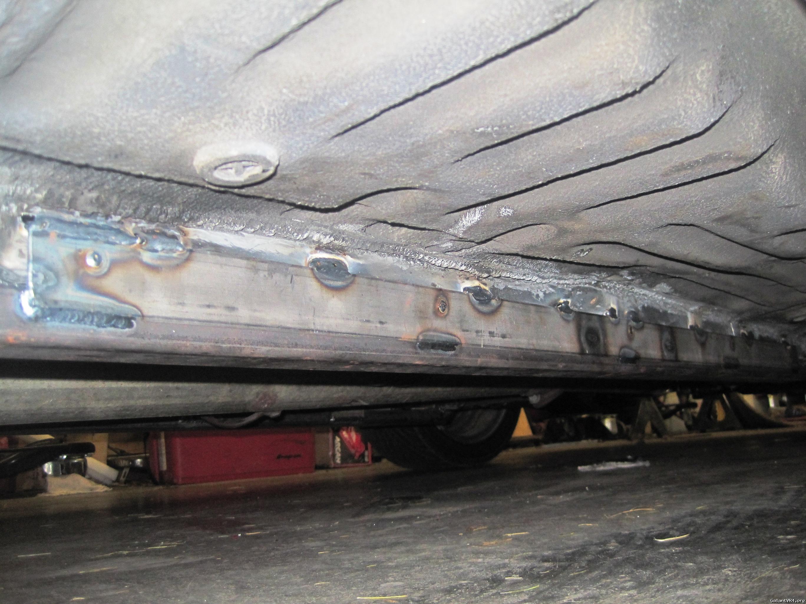

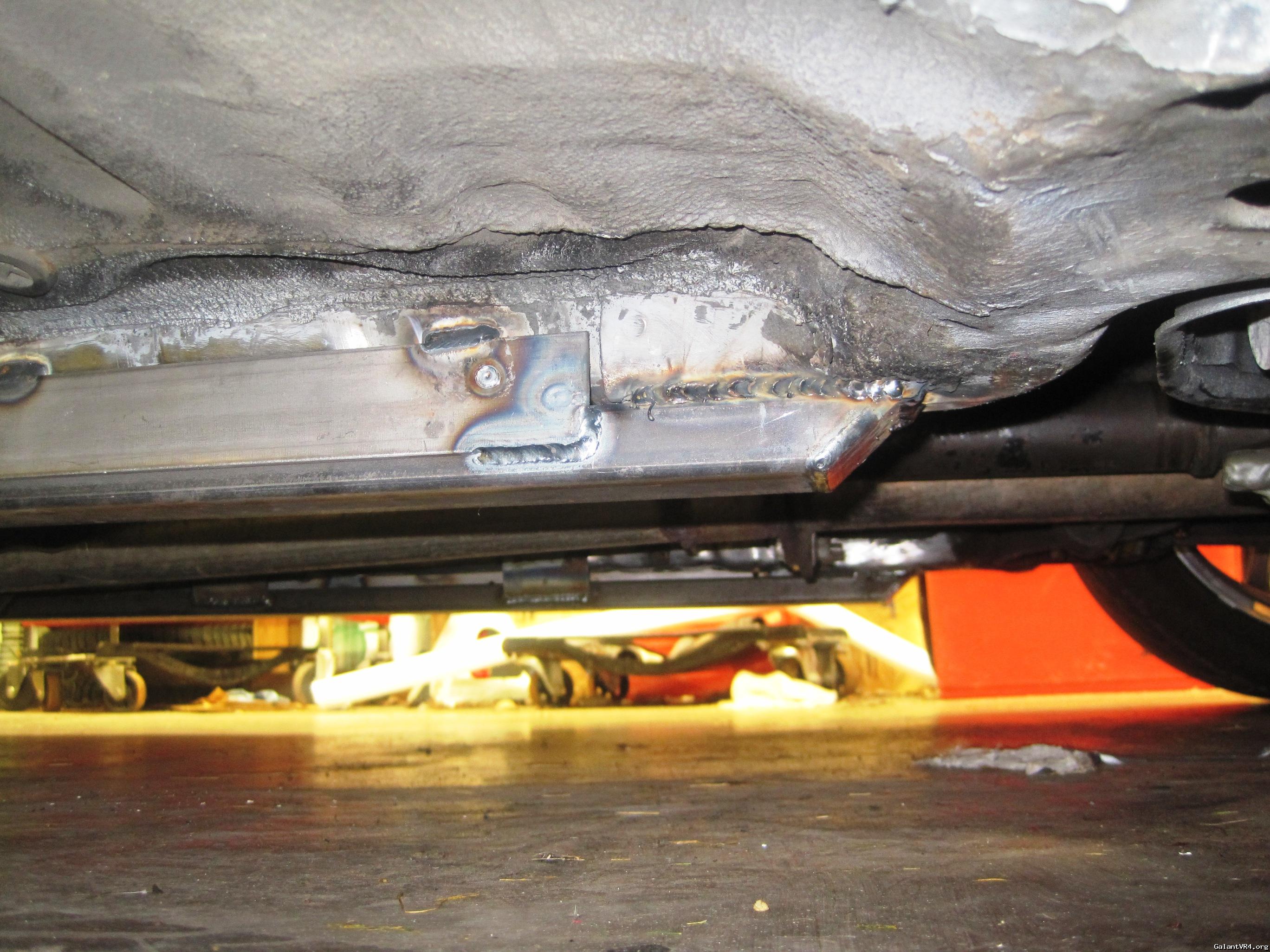

I just got my rails installed.
I wanted to post up a few pics and give you all my first impressions on these.
Installation:
The act of installing then was simple. The hardest part was striping the undercoating off. The next hardest part was getting the car up off the ground far enough and still being able to "load" the suspension so that the frame/body was at "normal" resting state without a drive-on lift.
The pics below show the extent of the welding we did.

Did you cut the other rails out or lay those over top of the existing rails? I can't tell from the picture but they look like they are over the top which I would assume, but one pic looks like it may have a cut in them. Might just be me bad eyes. How fun was it to weld onto that sheet metal? /ubbthreads/images/graemlins/smile.gif
Looks like it would make a big difference.

I'm a decent TIG on Steel and Stainless but I blow through aluminum like beer at a picnic. Not questioning the product at all but did you consider running the bead the length of the rail and is it welded on the inside seam as well or only the outside? I have no idea how the stresses are on the pan rails but it seems that if any weld failed or metal gave way, it would be the connection between the pan and the brace. Given that, it probably wouldn't matter if you did the full length weld anyway. That's not putting down the welds mind you, just thinking of what would break first under sheer or stress and I would guess, the pan would.
/brox
I've welded these to God only knows how many mustangs back in the day. Back then the original ones that came out and sold in the magazines were nothing more than a piece of bent round tubing with a band of steel on the front and back about 3 or 4 inches wide. I always thought that was bunk and started doing more welds all over the rails using 1 x 2 like I sold with these. Over the years I've never seen the welds fail even when done with a oxy acetylene torch and a rod on a dirty floor pan not preped.

I really think they want ever rip out because the factory frame pan is so damn thin on any car and it strength only comes from the bends and placement of bends in the seams in the unibody. This is why if you ever place a jack or a jackstand on it it crushes in. The welds are 4 times as thick as the metal on the unibody and will easily just bend and flex around or near the weld but with these rails keeps the flexing to a minimum and doesn't allow it to happen. Now in a perfect world I would build these to recess into the pan but that would require the interior to come out and braces welded in and the body to be put on stands. After the rails are cut open either from the top or bottom the new rail would be dropped in or up and then all welded back together. This is the first step to building an all out drag monster car. You do this then cross bars out of like 3x3 across the backseat area then start adding plates for the main hoops and legs and start tiding stuff together. But with weekend warriors like most are around here and not adding a full rally car or 25.1 chassis build the difference between doing them on the bottom or inside would never be noticed.
If you ever do these you'll never regret it besides helping the car also gives a safe place to put your jackstand when the transmission comes out and in and your on your back fighting with it.

That is the most impressive chassis mod I've ever seen. Are the rails just solid mild steel?
No there 1 x 2 box tubing with ends welded on then flat bar welded on the side. I welded flat to the outsides of both and then included small tabs for the inside of the rails. Would have like to get something the exact width of the frame rail but wear on cars over the years puts the dimensions all crazy and new materials in the states aren't in metric sizes so 1 x 2 is the best i could do. Terry's car had been jacked up and damage and took him alot of work just to get to the point of welding them on. I really bet 8 out of 10 cars on here have dents and crushed areas from people using jacks over the years.
How did you go about working out the dents and crushed areas?
The damage on mine is visible, like you described.

I used a dead blow hammer on the floor pan to put it back to level (had to remove seats and carpet) and then used a slide hammer and stud welder under the car. And just worked it back down a little. Then the new rails went up and Chris started welding.
OH, and I did remove all the undercoating from the pan rails. That took about 5 hours each. NOT fun.
The "damage" looked worst than it was. Just the rail area right in the middle of the car was bowed up. The rest of the pan is good. I never had issues with the doors not aligning or anything that goes along with a tweaked frame.
