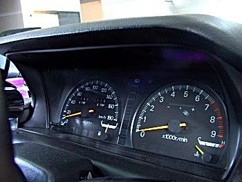

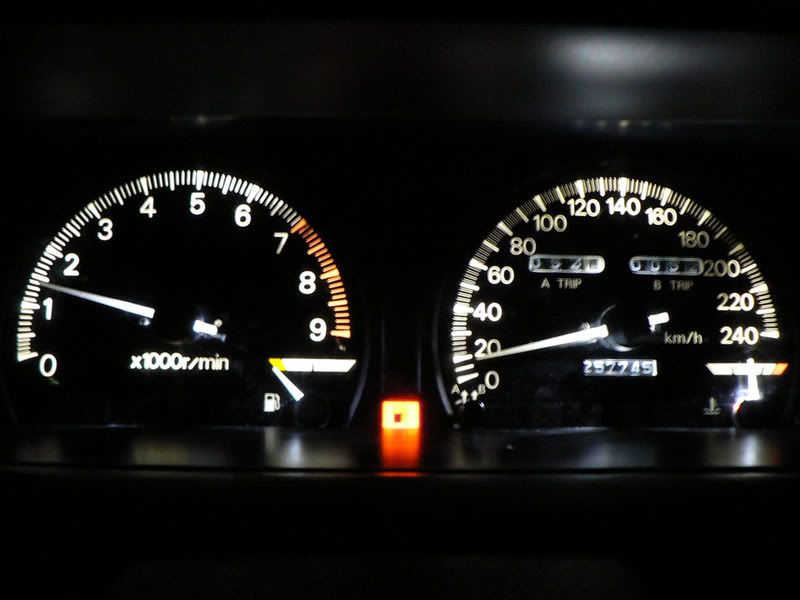

redtwo, I think he means flips the orientation of the gauges - on RHD cars it has the speedo on the left and tacho on the right with fuel gauge at the base of the speedo and temp gauge at the base of the tacho, and on LHD cars it has the speedo on the right hand side and tacho on the left side - however - the fuel and temp gauges don't flip sides like they do with the speedo and tacho, the fuel gauge on LHD is at the base of the tacho now and the temp gauge is at the base of the speedo.
*edit* with pics:
LHD USDM MPH gauge cluster
RHD JDM 180km/h and 7000rpm redline gauge cluster
JDM VR-4 (and other E3#A series model) gauges are almost usually 180km/h with a few RS models having the 240km/h gauge. World spec models vary from 200km/h to 240km/h depending on trim but non turbo models don't have the boost meter obviously. I think there is a LHD Euro spec VR-4 Galant with a 240km/h cluster but I'm not 100% sure.
Also, the colour change feature is only the pre-facelift models, facelift models lost this feature.
