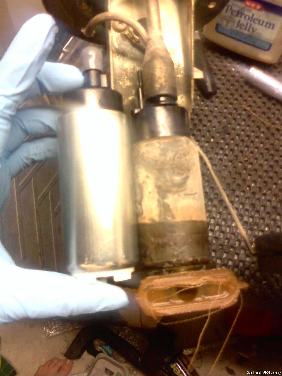

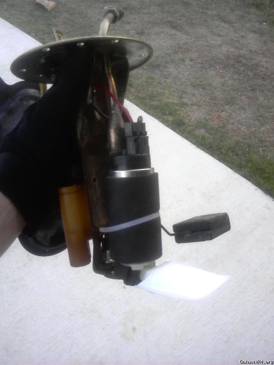

I'd try searching for "GSS". I've discussed this in a few threads, but I believe the 2g pump is actually correct for the vr4. The 1g pump is not. Hopefully someone can confirm this. I know I uploaded a pic of the two at one time showing the difference and how the 2g one was the same as the VR4.
