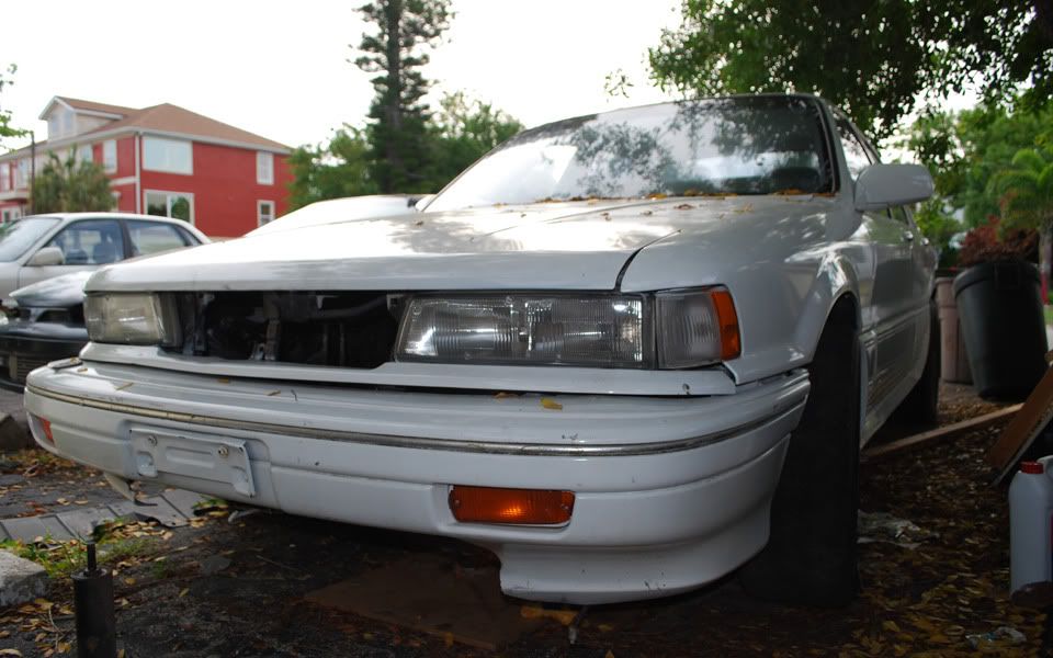

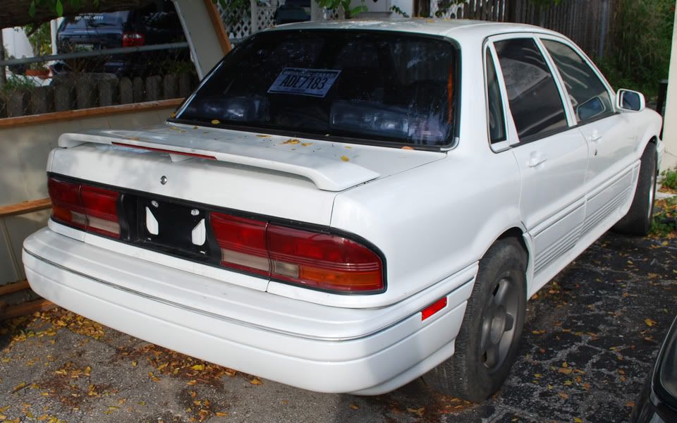

just to give u some ideas this post is how she sat before i got her

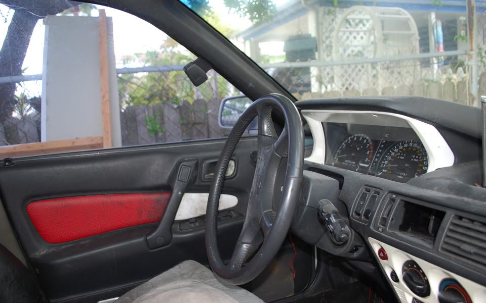

Hears what she is doing right now until time to get in the garage

I dont know because we have talked about putting back a color that is not to bad and deleting the red out the interior.
I know ive been slacking lately but have been working and buying stuff hear and there.

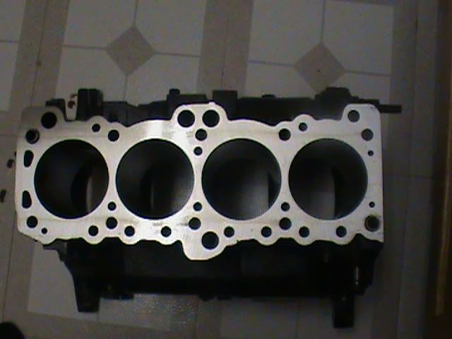

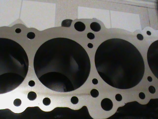

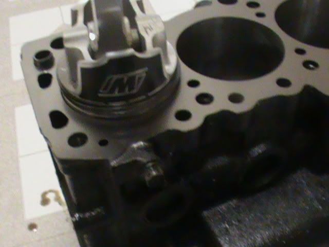

6 bolt bore .20 over

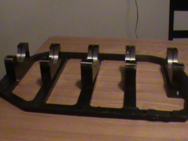

pro gram engineering main girdle and bearing caps

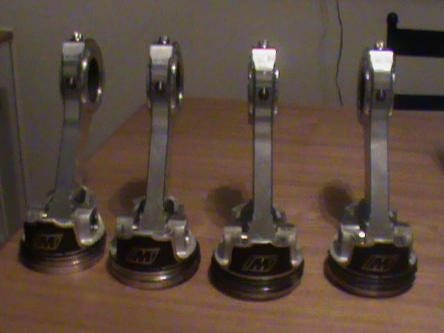

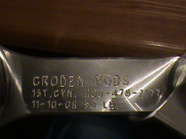

groden rods
and some wiseco 1400hd pistons attached to them

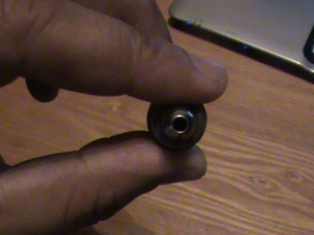

and some revised lifters i also have the evo 8 rockers to

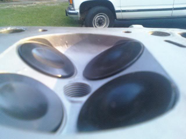

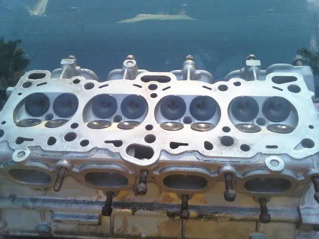

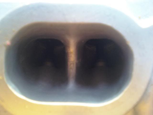

head is fully deck with ferrea valves 1mm over as u can see
Welcome. Nice project you're building hope to see you at englishtown. You should check out dsmpartout.com he has a lot of oem parts for vr4.

Hi Meeklo,
Be careful with those Groden Rods. I'm not about to start bad mouthing these (I run a set in my built engine /ubbthreads/images/graemlins/grin.gif) but a few of the "Seniors" on here whose opinions I really respect have had real problems with stripping threads when torqueing down the end caps. Obviously you need to torque stuff down properly. Just be careful!
Paul.

BTW.....IMO, loose the ricey interior. That red to white sh*t is hidieous. /ubbthreads/images/graemlins/crazy.gif

Jertech were planing on it. Last year was our first year up there and the 1g broke the first qualifing round against JMF's car in the street 16. Ran the second qualifing round and ran a 11.32@132 on street tires. Since then the car has not made a full pass. Ive been thinking of buying the 3052 from him but who knows from now till then what will happen.
Quoting cheekychimp:
Hi Meeklo,
Paul.
Ive hear horror stories to man and Ive got to tell you it took me alot of courage to deside what i want to do. The car i was refering to with jetech has the same rods in it and has not seen trouble yet. and hes been one of the stronger cars around but just drivetrain issues. I hope to be careful with them like u said. I want to make sure this bottom end stays golden for a while until im tired of it...lol. And thanks man
ROFL.....we all said that when i picked up the car...the former owner of the car owns 145(MadbeachDSM) or something like that. I know the interior is the thing i would face but Ill fix it at the end when it is running. Only thing I like about it that is not pictured is the headliner. other than that...we can see it will be crazy looking for a while
