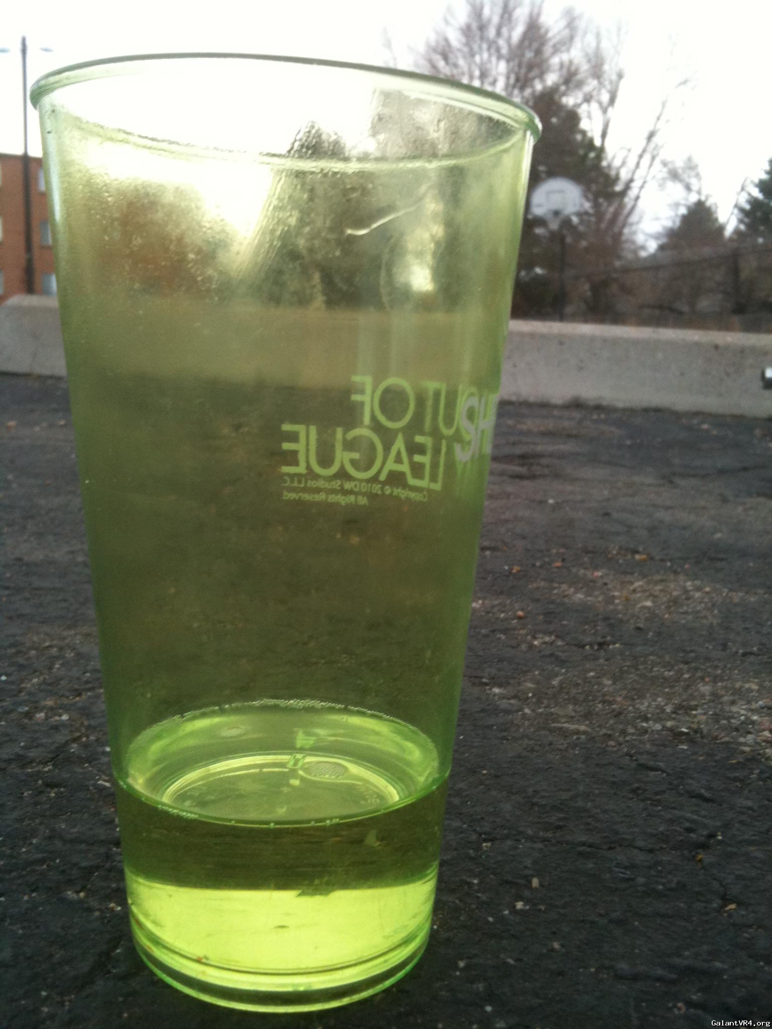

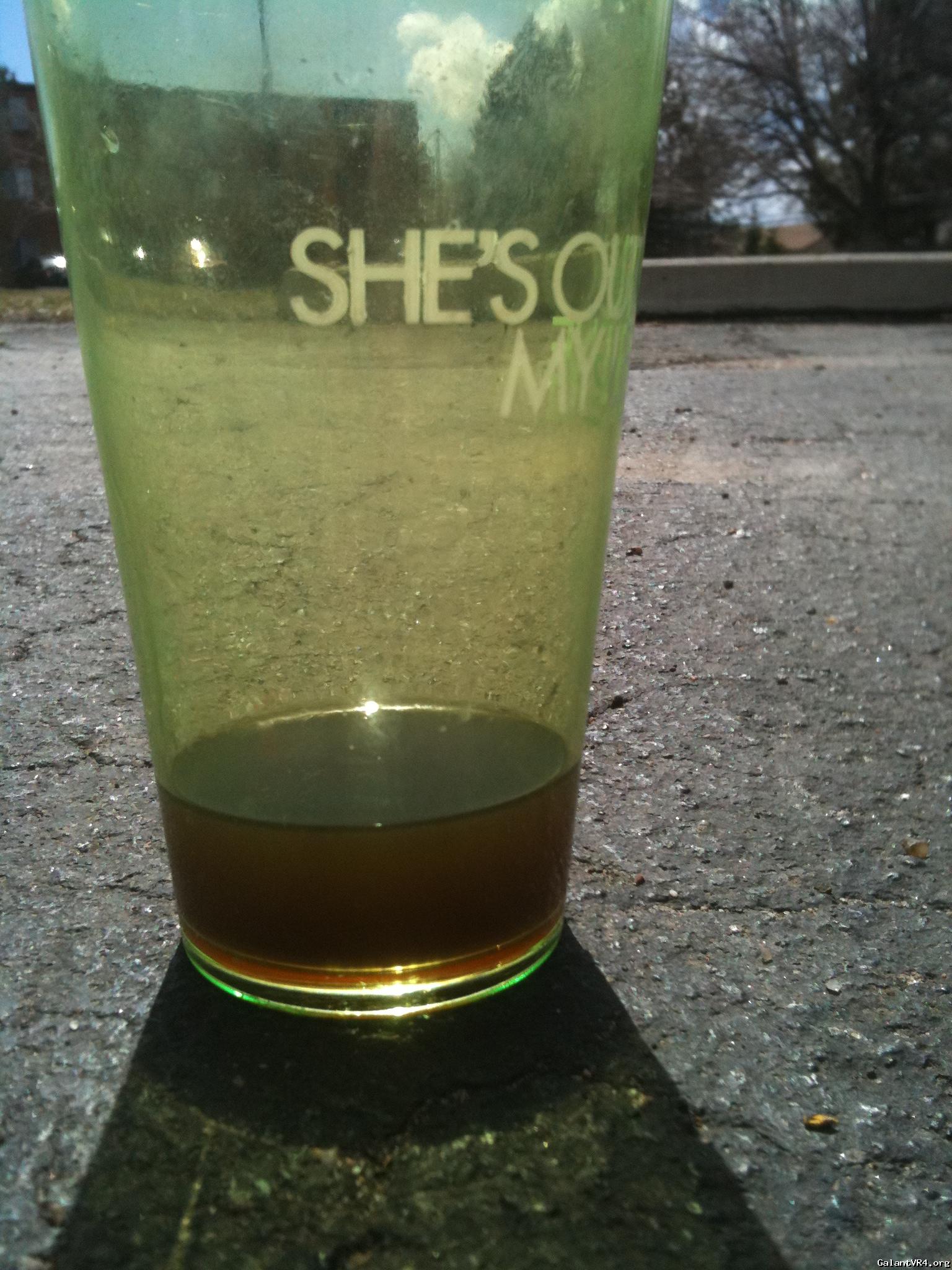

I recently replaced the brake pads on all 4 wheels, I thought you might like to see
what drained out of my calipers and break lines.
This is what Drained out
This is normal DOT 3

I guess you could spin this to a "top tip" tech post.
Brake fluid will look like that after a couple years. Best to replace every year but only about .01 of us do that.

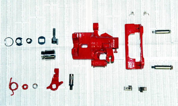

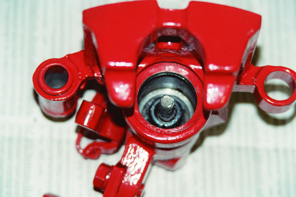

You compressed the rear caliper piston? How well did that work for ya?
They screw in, not compress like the front. If you compressed the rears, they either did not move or you better go and get a new rear caliper.
I compressed the piston and watched the brake fluid squirt out of the side,
So I take it that both rear rotors are SMOKED?
When you use your e-brake it pulls a cable that engages a spring loaded lever on the rear caliper; that lever
actuates the piston and pushes the brake pad against the rotor,
That is the piston I am talking about, the rest of the caliper just floats toward the rotor as the pads wear out.
Maybe I am just a genius and I am explaining a broken rotor.
Someone Chime in here and tell me I am moron. /ubbthreads/images/graemlins/grin.gif

The lever activates the piston via a threaded self-adjuster rod and a cam. The piston threads on to the rod and as the pad wear the rod is free to spin and take up the slack in the parking brake.
When you compress the rear piston you do it by screwing it back down the rod into the bore. If you just use a clamp it either doesn't move or you bend the rod and hose the rear caliper.

Anyway, you need replacement calipers, and it's pretty much your own fault. I mean, how the f*ck can you manage to compress the piston of the rear caliper? You must have used REAL force to be able to do that, and simply thinking about it would have ruled out the possibility of this being normal. And if you don't get that, you'd better take your car to a shop, instead of playing with crucial parts of the car and the lives of the people who get into that car....
I do believe that if you don't have any common sense about certain things, you shouldn't be playing around with crucial parts of the car. I'm a car mechanic, and you simply don't believe your eyes sometimes when people tried making repairs themselves, before coming to the dealership. There are more than enough ways to improve your technical skills, but screwing around with brakes that are on a road legal car, when you don't know what you are doing, isn't one of them. /ubbthreads/images/graemlins/crazy.gif

If you are as experienced as you say you are then you would know that you can use both a "LISLE" or "C-Clamp" to compress the front and rear CALIPER piston.

I hope my post didn't sound harsh. I was just pointing out that you kept saying rotors when it is calipers, as in you ruined those calipers, not rotors.
I hope you can find a good source for replacement rear calipers. The rear calipers are more expensive than the front calipers.

Quoting GVR4NGER694:
Please check the FSM. Your pictures aren't for the correct rear caliper.
You can't compress the rear caliper pistons with a clamp when they have an integral parking brake. You will damage them.
There are other types of rear calipers, like on the 2G DSMs, that compress just like the fronts but that's because their parking brake is external to the caliper.
As it states in the FSM:
6. Clean the piston; then use the special tool to thread the piston into the cylinder.
Be sure, at this time, that the stopper groove of the piston, correctly fits to the projection on the pad’s rear surface.
You are talking about the rear brakes on a GVR4, right?
