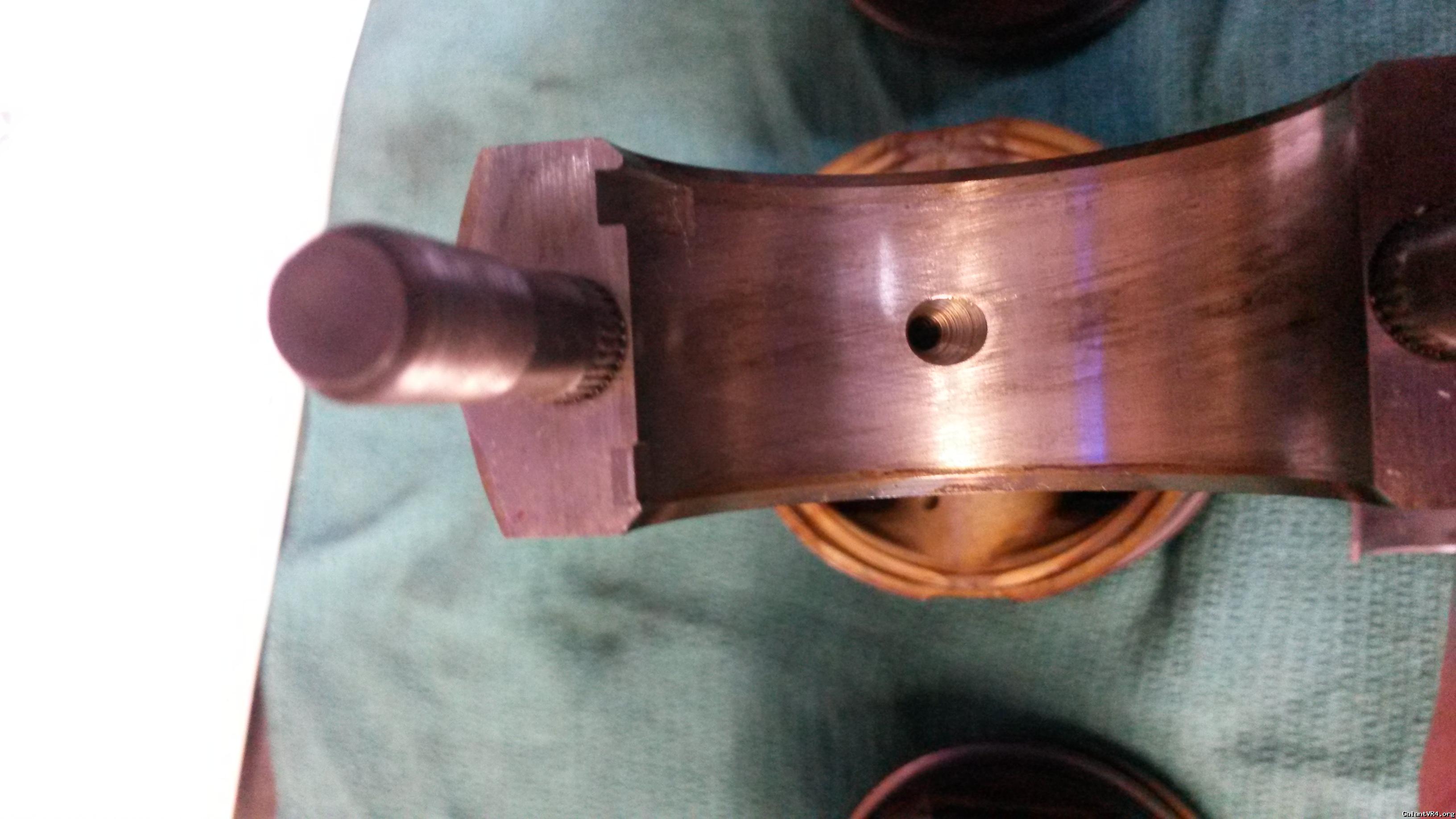

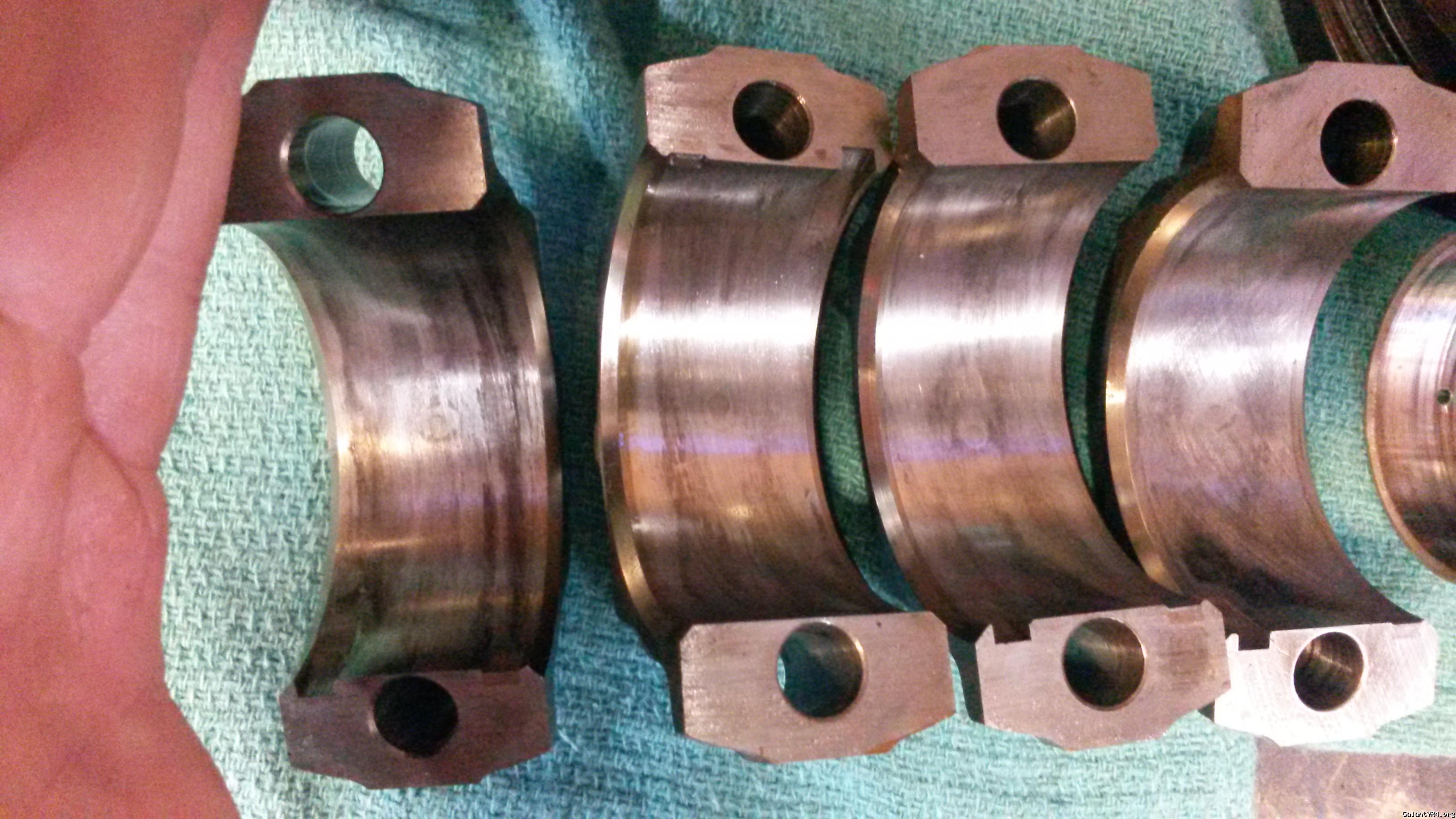

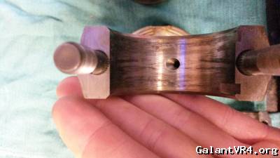

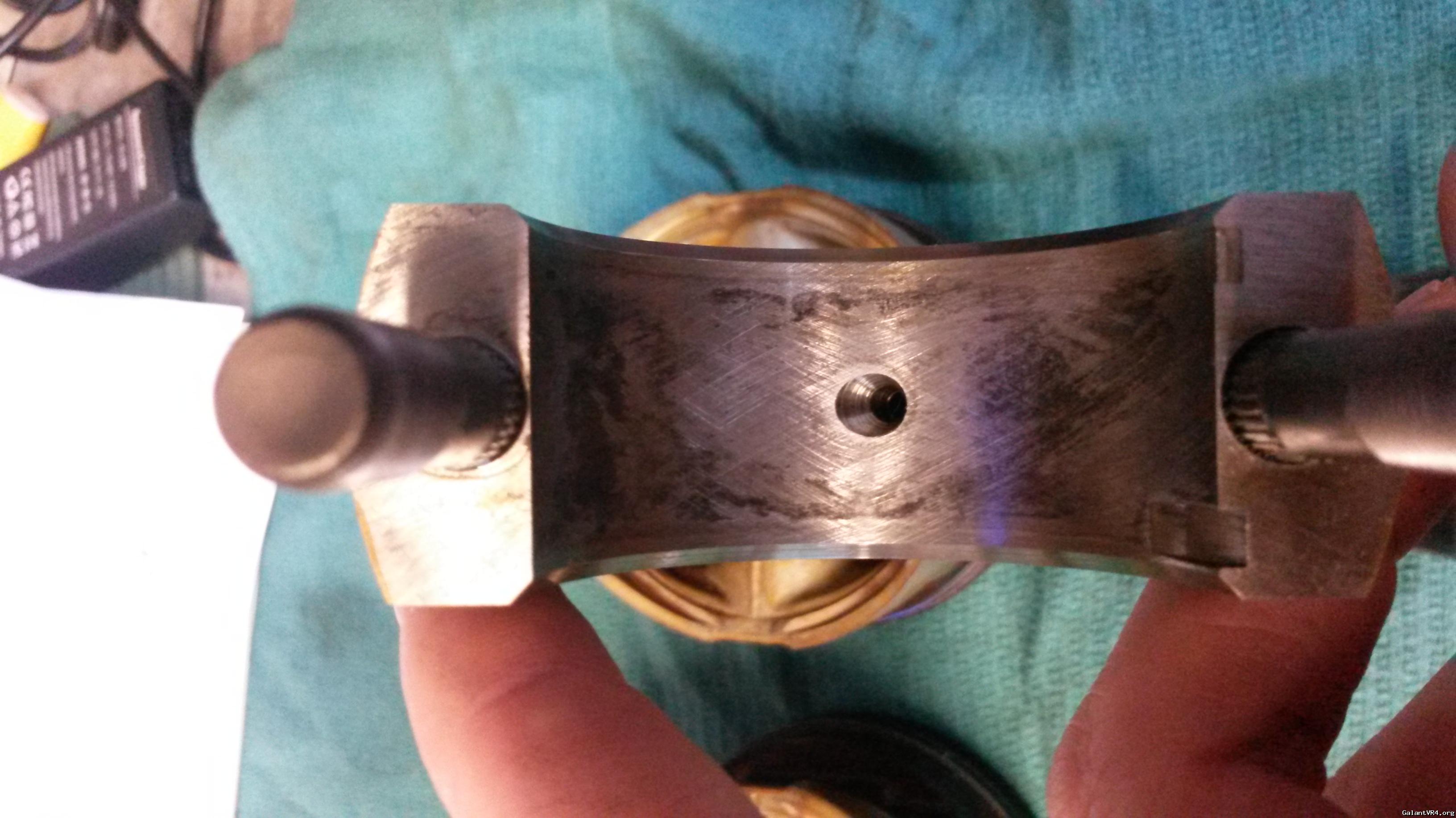

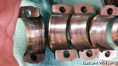

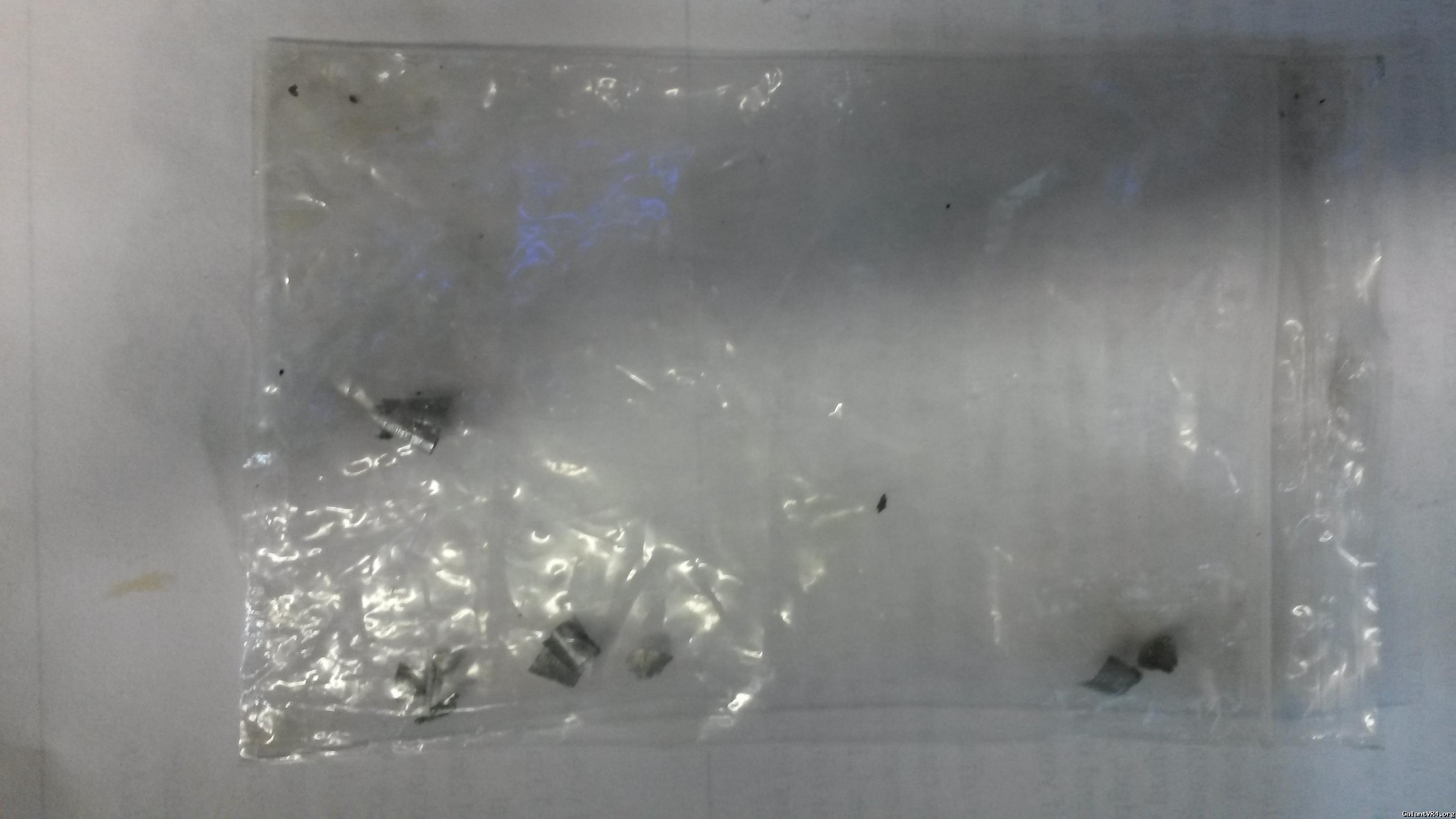

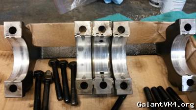

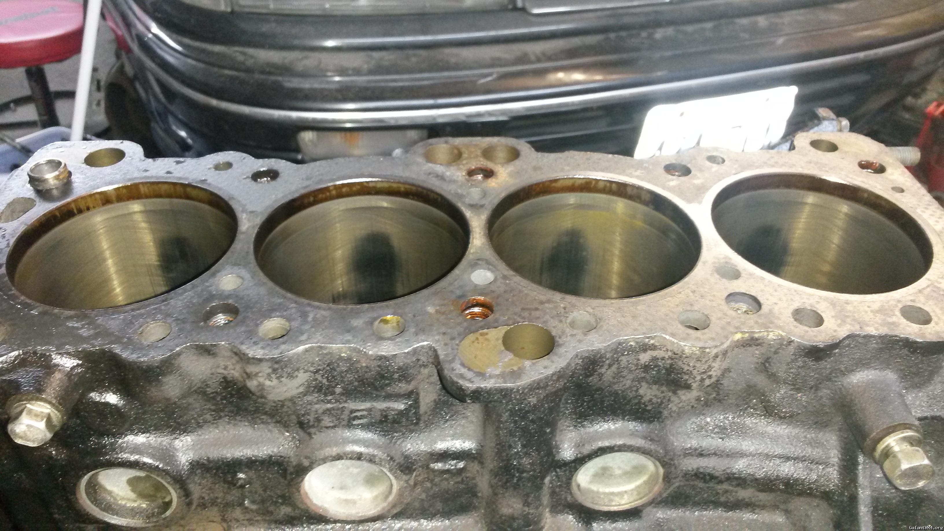

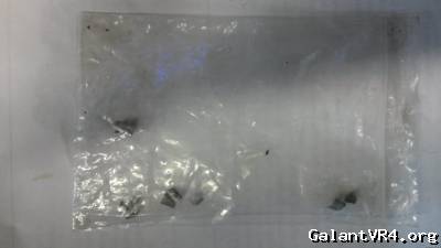

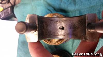

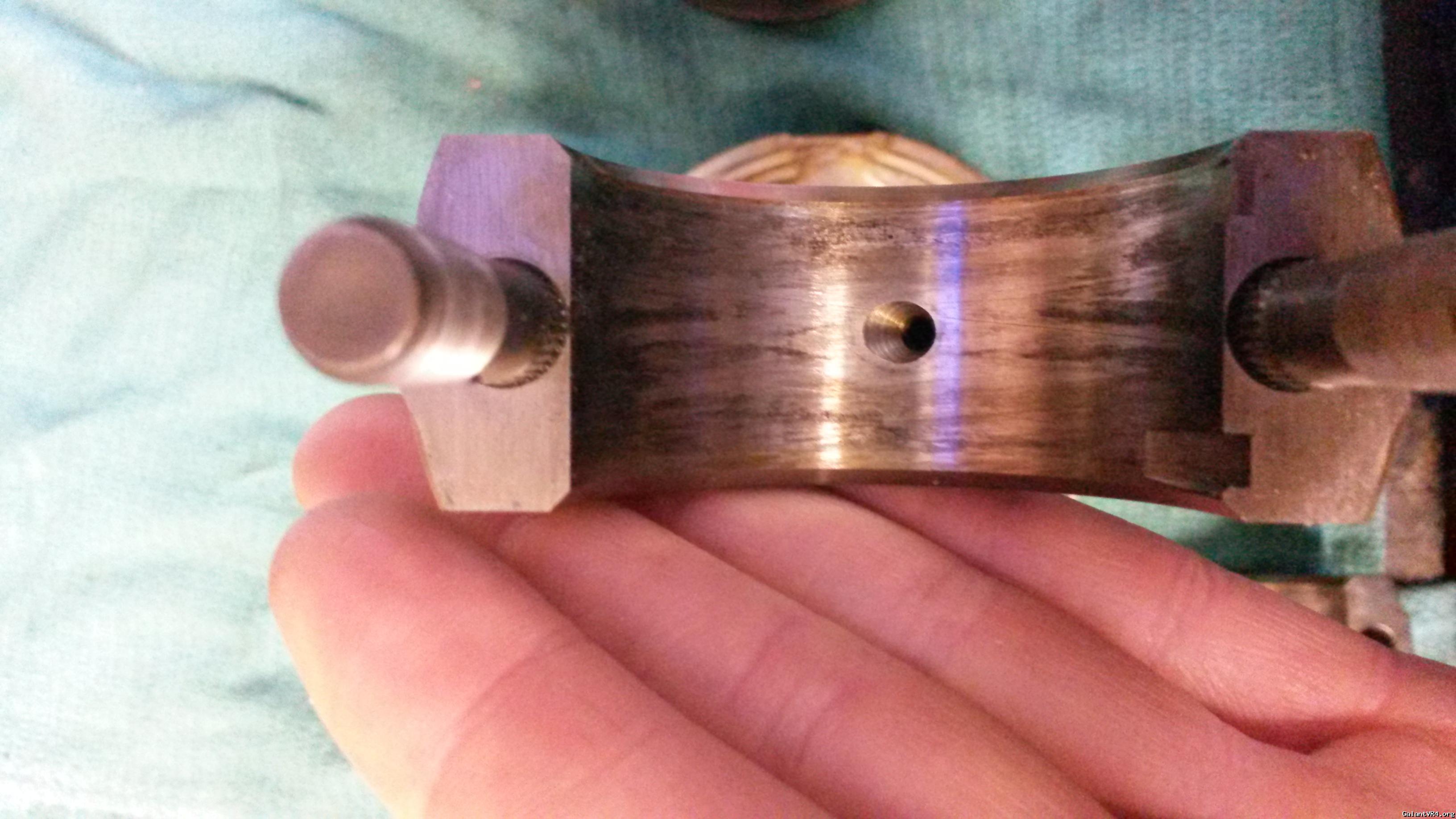

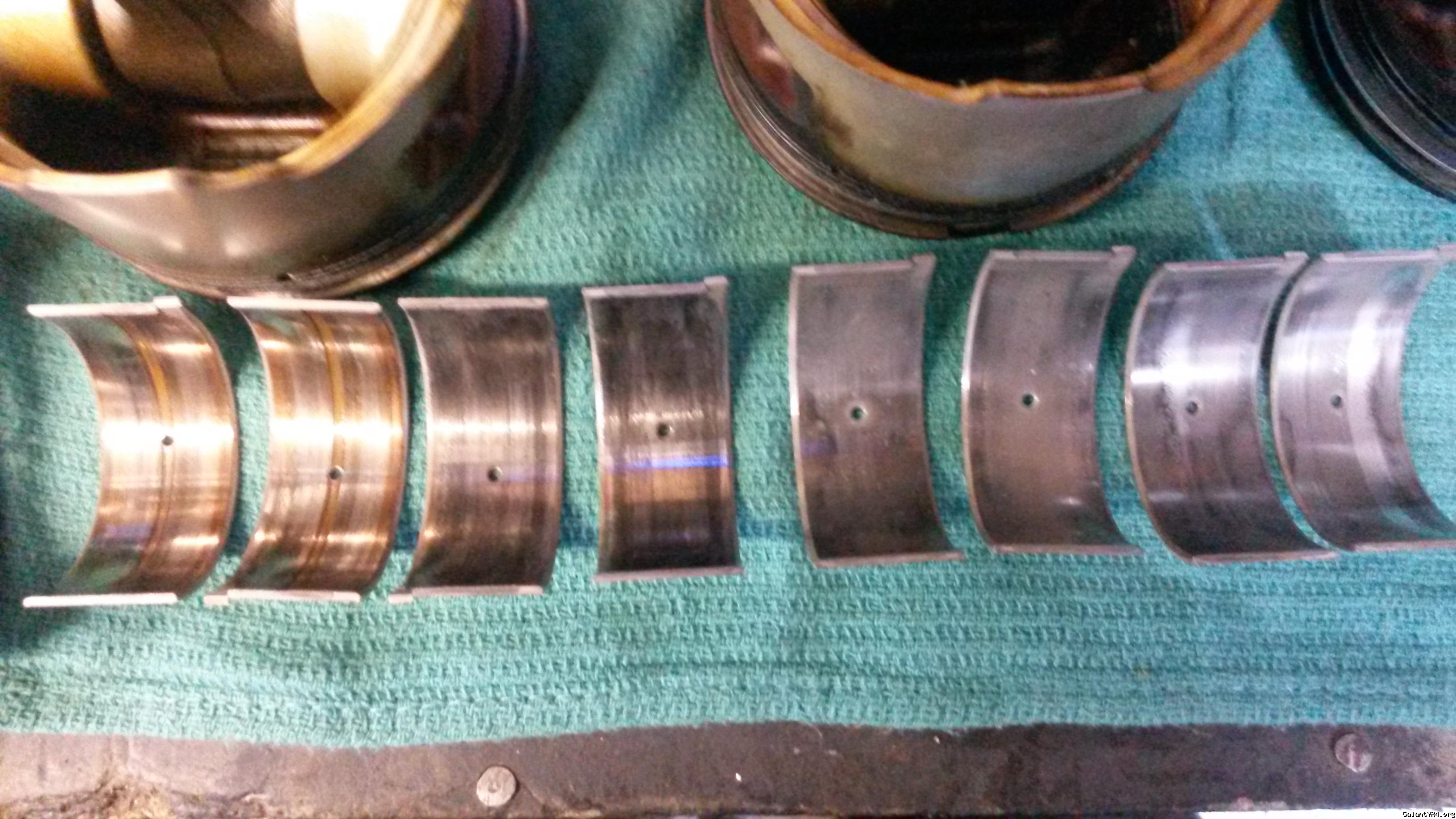

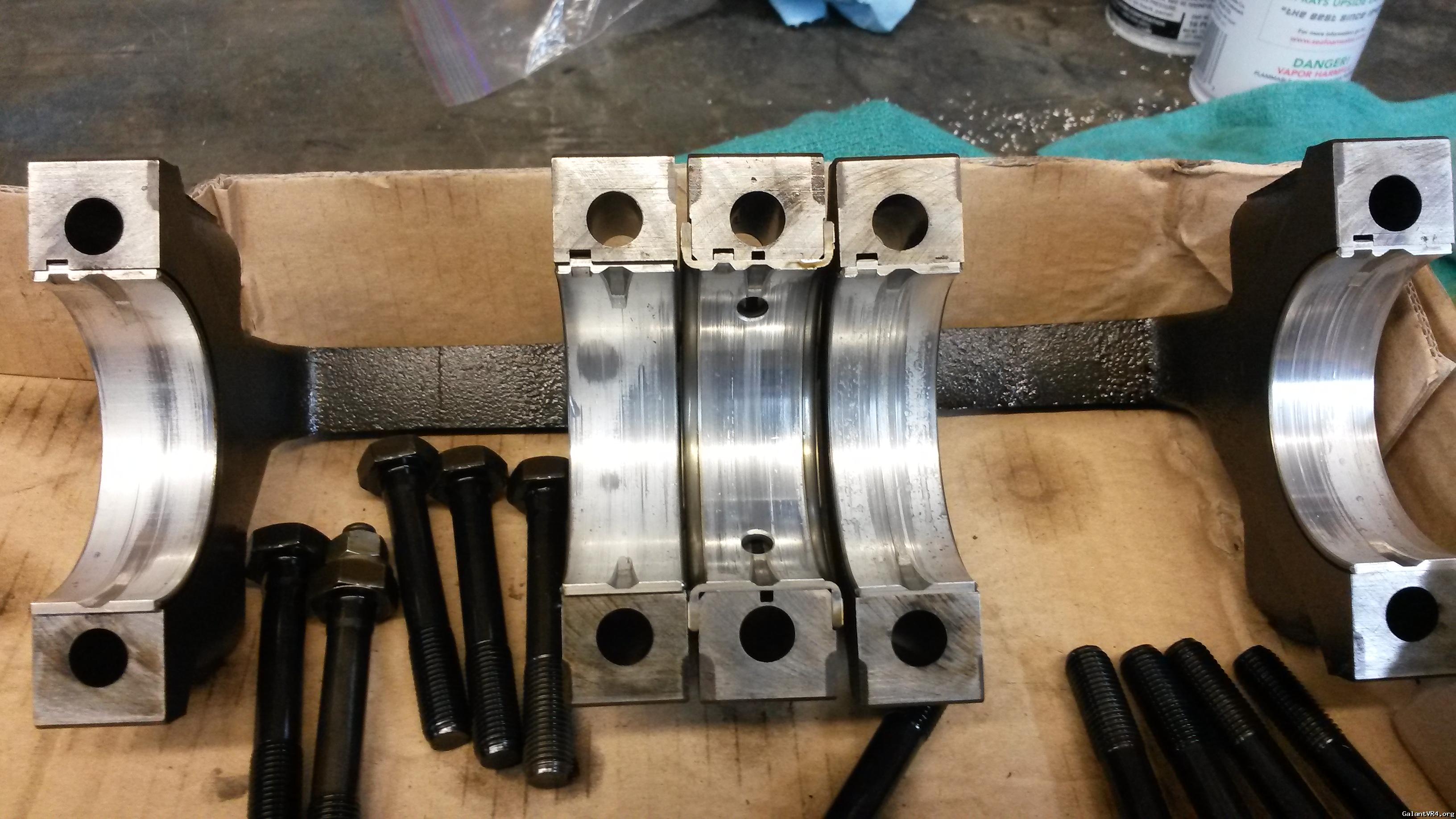

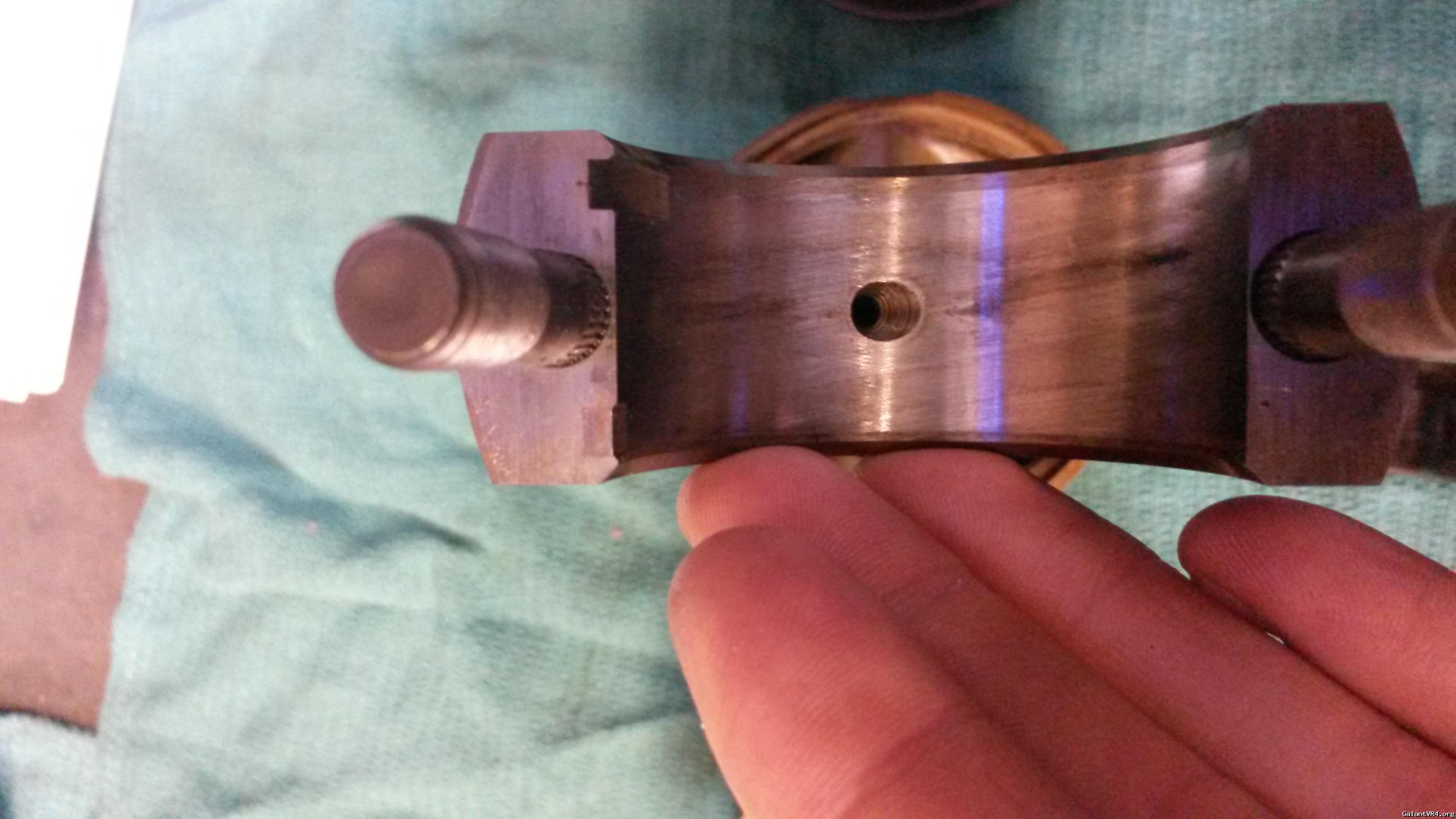

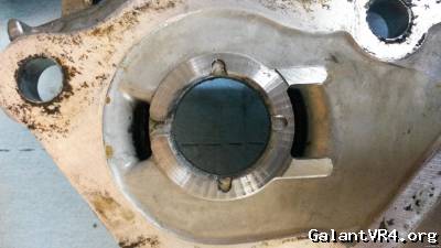

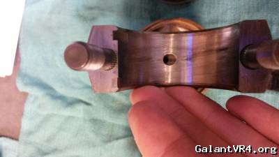

Now that being said I recently pulled the engine to start on the ps leak/clutch/oil pan. When I pulled the pan I found large amounts of a soft non magnetic material in my oil pain which i am assuming is babbit. main and rod bearings are not all but partially bad so long story short i am rebuilding the engine. And this is where I need some help/ some suggestions, mainly with machining and parts.

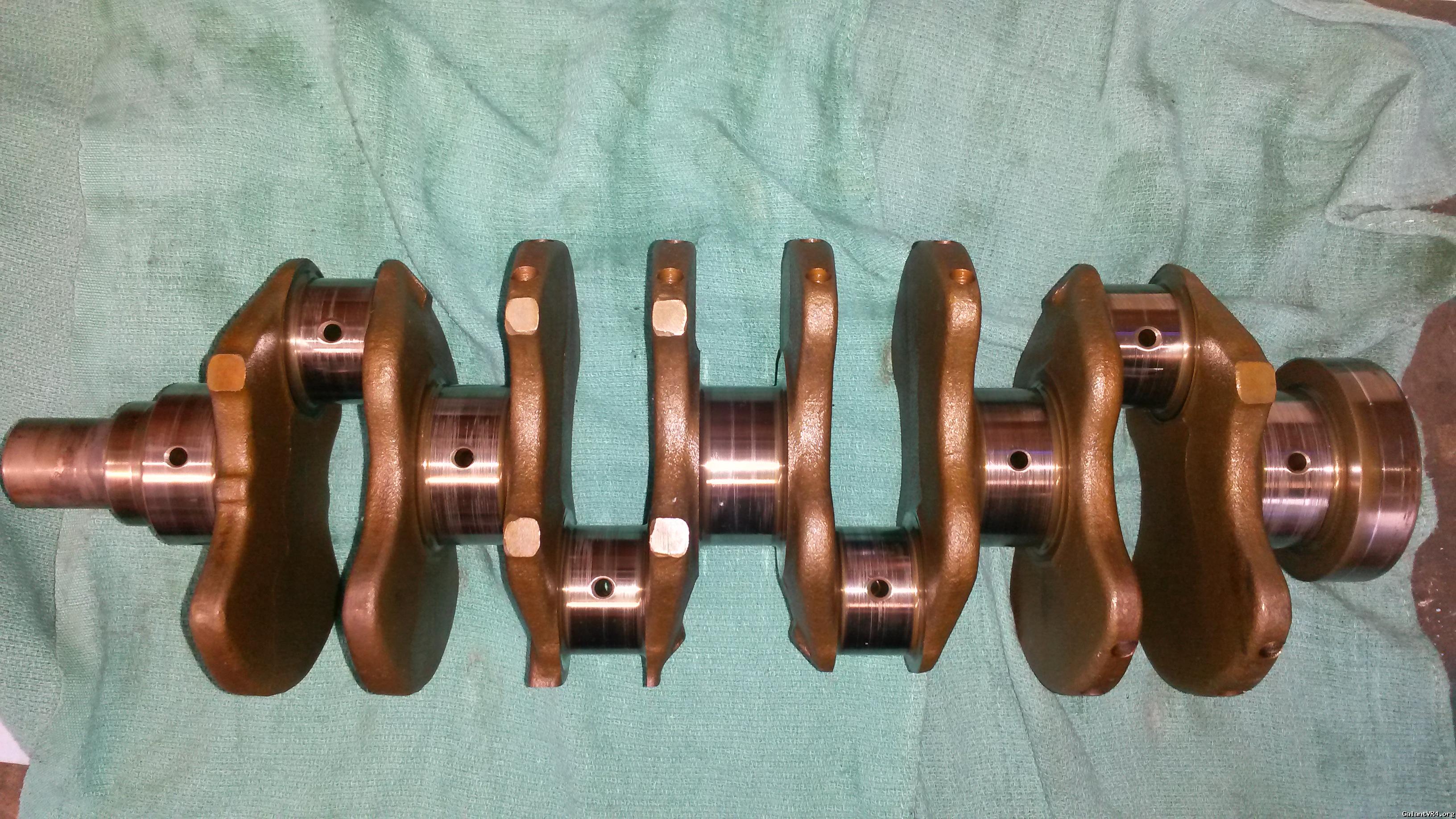

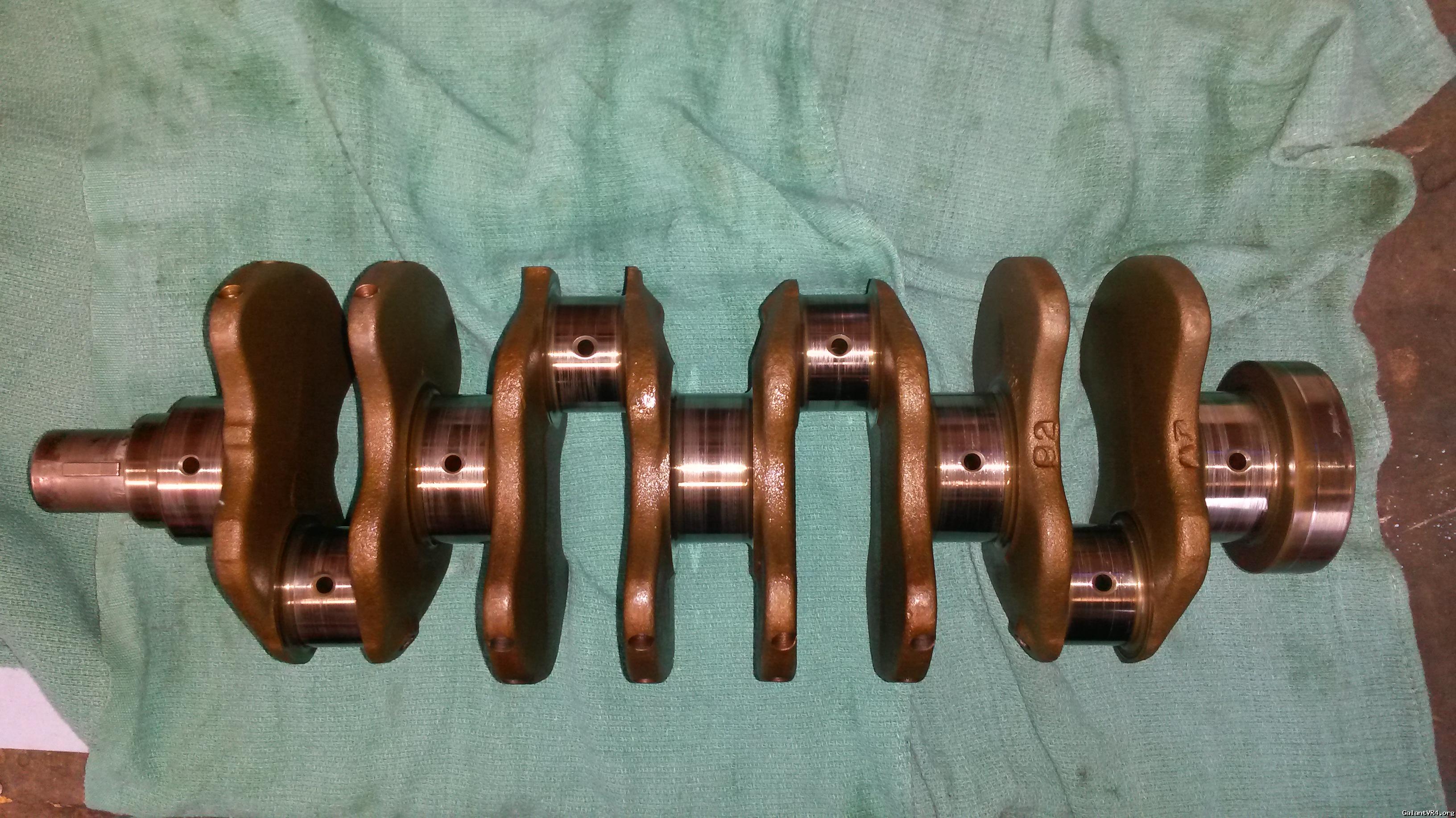

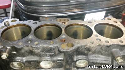

Machining: I had a machinist of 20+ years look at my engine internals and block and he said to have the crank reground and polished, get new main and rod bearings, have rod big end checked for roundness check and replace balance shaft bearings, check balance shafts for damage, repair as needed and small scoring in block means go cheap and give it a good hone or go expensive and bore the block (whichever i feel is necessary), and finally replace the oil pump as it appears as though oil starvation has been a big problem in the past. Considering the balance shafts aren't out of the block yet, and the cylinder head hasn't been disassembled, what other machining and or professional cleaning should i have done? what can i get for cheap as possible since i am in college from rock auto or whoever?

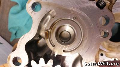

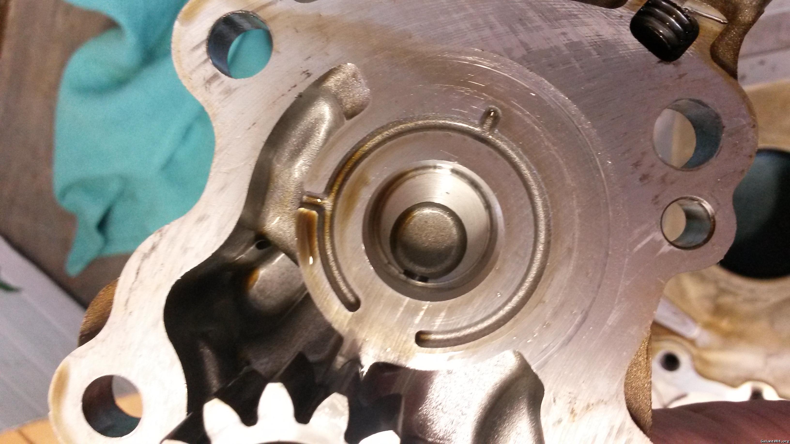

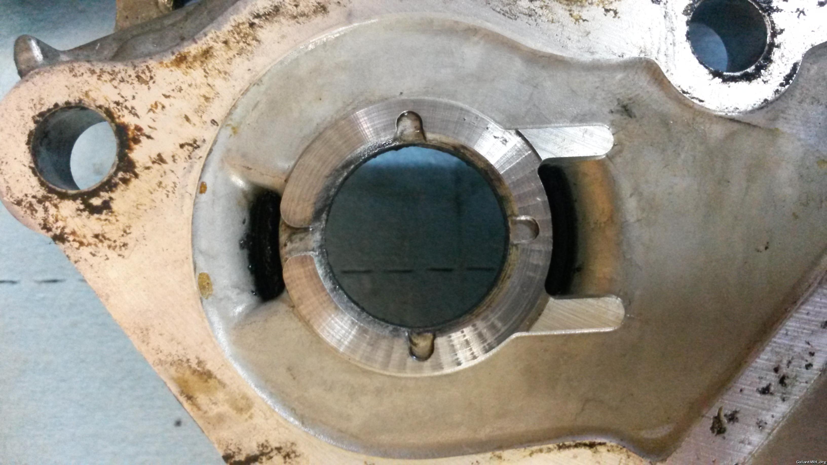

new oil pump - can i go reman here? or oem is the only way. do i need a new case with new gears or just new gears? based on machinist recommendation i will replace but i also have a chunk broken out of my case.
