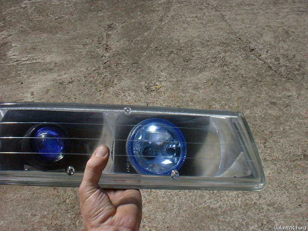

It would be awful in a VR4. We don't have a projector style housing, which is what you need to properly retrofit HIDs in a car that doesn't have them. Our glass housing would just scatter the beam and blind everybody. You can get the crap Ebay kit if you just want the look, because you definitely won't get the performance.

if your going to do it, do it right. just what dustyduff does click if your not doing it like this DO NOT WASTE YOUR MONEY.

The most oem like color range is 4500 "kelvin" or candle power, or 5000. Anything higher than that and you are getting into a light that is more harmful to your vision than helpful. Not to mention, the oem galant housings were not made for a high intensity discharge bulb, the stock housing has no cut off line built in so you will be throwing light at all different angles into oncoming traffic.
You want hid's, do it the correct way. Send them to a knowledgable shop that does auto lighting upgrades, or get busy on fiberglassing a new housing that integrates a proper projector or cut off. Couple people on here have done it.
