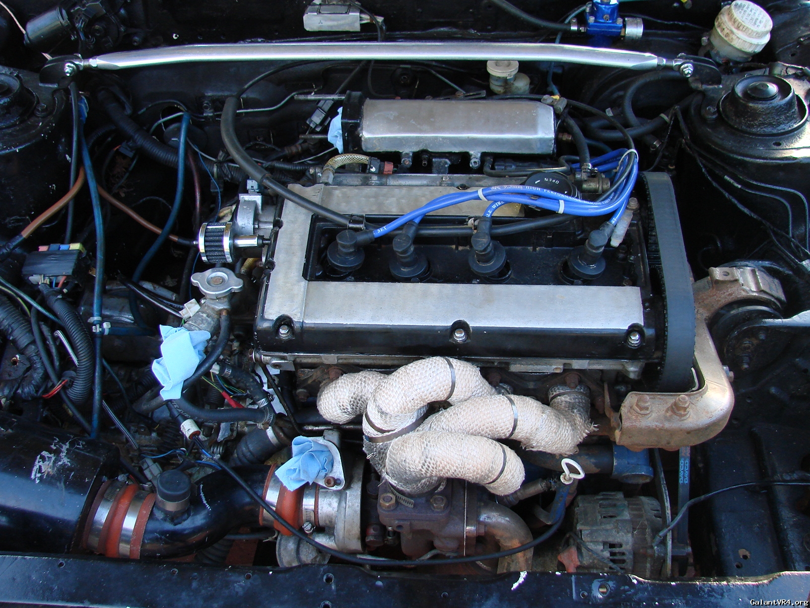

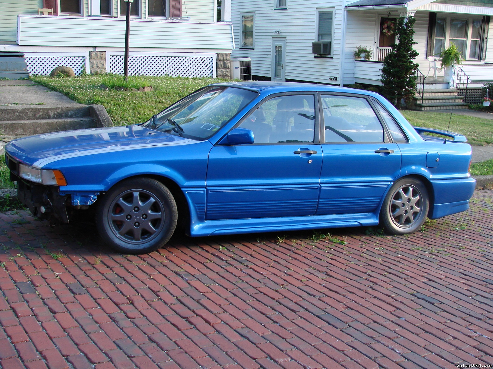

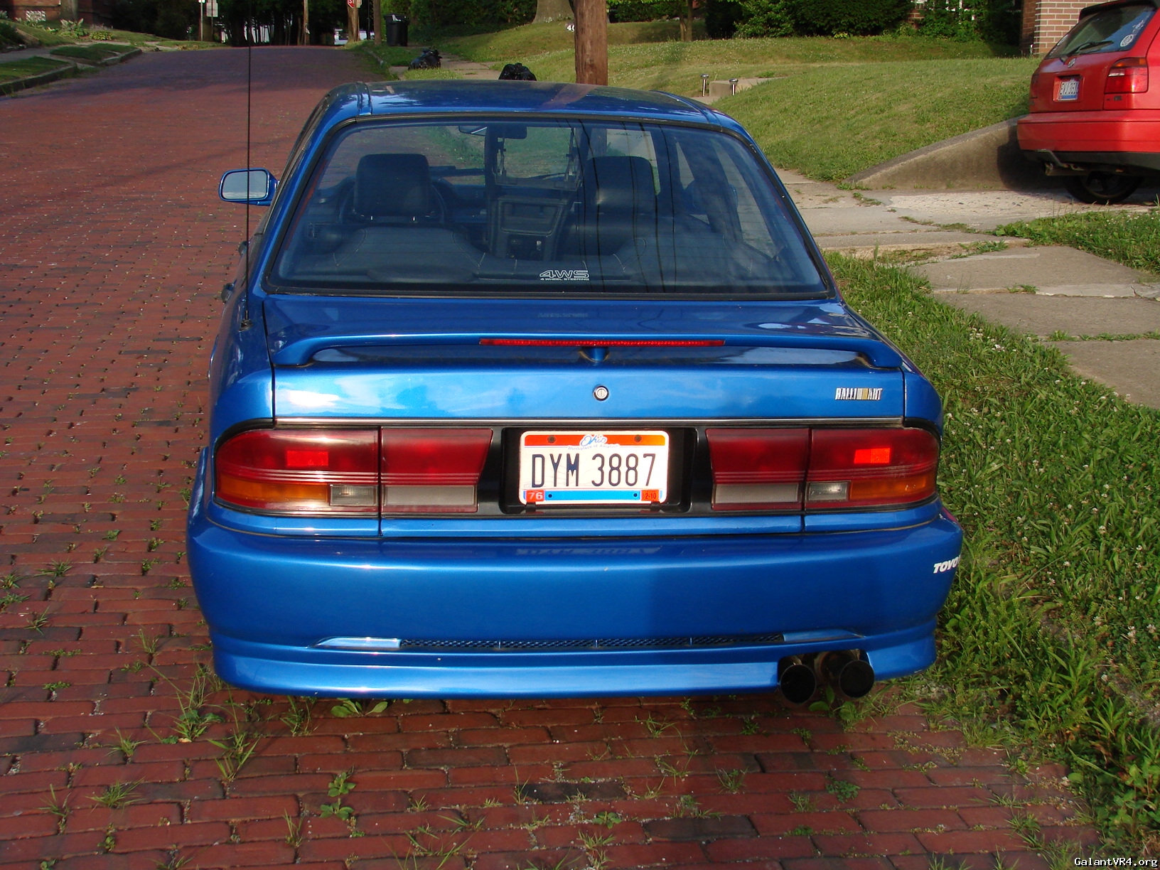

Thanks. I had never even heard of one till I saw this one on craigslist actually, lol. Always wanted a GSX or talon though, so it fit the shoes. Anyways, as promised here's the pics as it sits now. Front bumpers is off it at the moment.
Engine bay looks pretty bad. Not really fond of the fact that he shaved the manifold and valve covers, but i'll see what I can do.

Guess you don't have to worry about losing the doglegs since they're all molded together with the side skirts. /ubbthreads/images/graemlins/uhh.gif
Overall, the body kit isn't hideous, but certainly makes the stock wheels (and is that overspray?) stand out in a bad way.

I had it running for like a day after I hard wired the fuel pump, switch out the plugs, and toyed with a lot of other things. I couldn't get it to idle either, which I'm hoping is an intake leak. It also stalled as soon as the clutch went in, which I hope was the BOV. Also wouldn't go into 2nd. The linkage was bound and set wrong so I'm hoping thats all it is, though I'm changing the fluid too. If not Shepards 10 minutes from my house, though I'd rather not incur that cost at this moment.
I agree that a lot of it is hacked pretty bad, but I'm hoping to sort through it. For the moment I'm looking at sorting out all the major mechanical issues, then cosmetics. I am going to clean up most of engine now though, as I'd rather not have to pull anything major off after I get it running...atleast until I get the itch.
Body kits aren't really my thing either, but I decided that I could live with this one for what lies under it. As far as the paint goes, it doesn't look bad, but they didn't paint the door jams, under hood, or trunk. They then spray painted the engine bay and most of the things in it black. It looks sloppy and they didn't clean it first so a lot of its soft. I'll attend to it some time in the future when the engine bay is momentarily empty.
