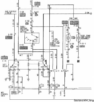

Yes the big silver relay is the fuel pump relay, technically called the "MPI control relay." It switches power to the fuel pump either when the ecu activates the relay or when the starter circuit activates the relay.
Hopefully this will help:

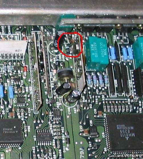

While cranking or running the ECU grounds pin #56, which pulls in the righthand half of the MFI relay, which connects +12 volts to the fuelpump.

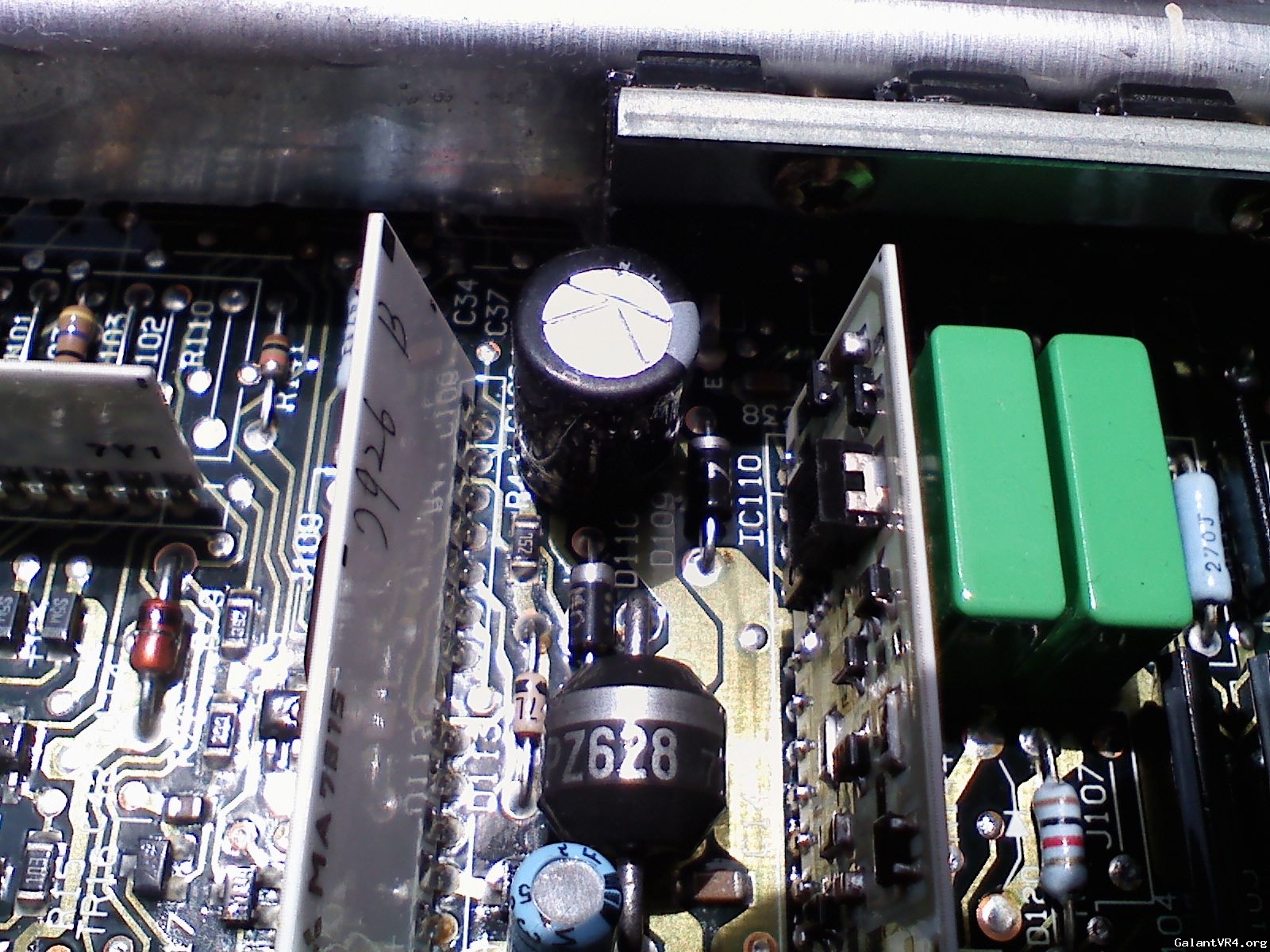

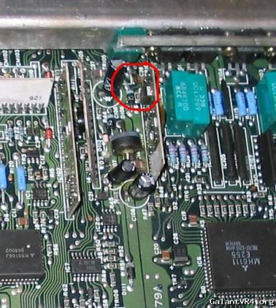

Its very common for acid damage from a leaky 47uF cap in the ECU to spill over to IC110, which is what drives pin #56.

went to the house and checked that portion of the ecm and didnt see anything that looked suspect. I took some pics but cant load them up till I get back to the house.

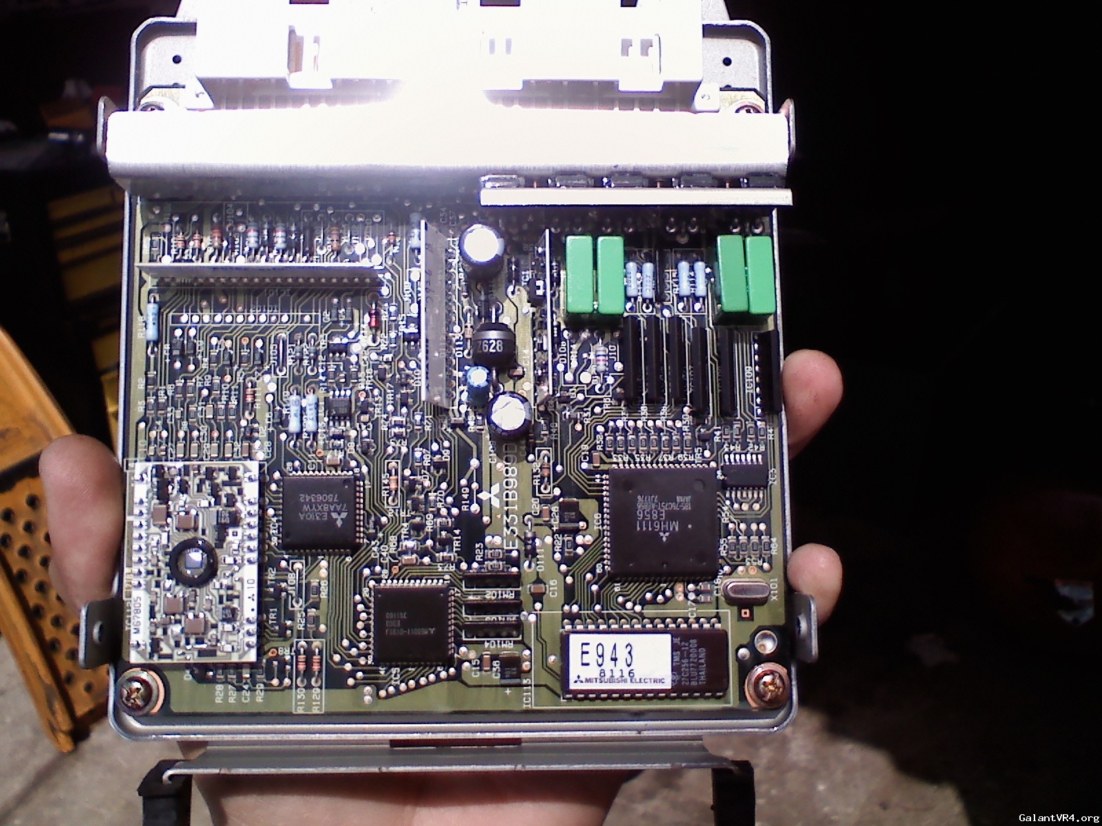

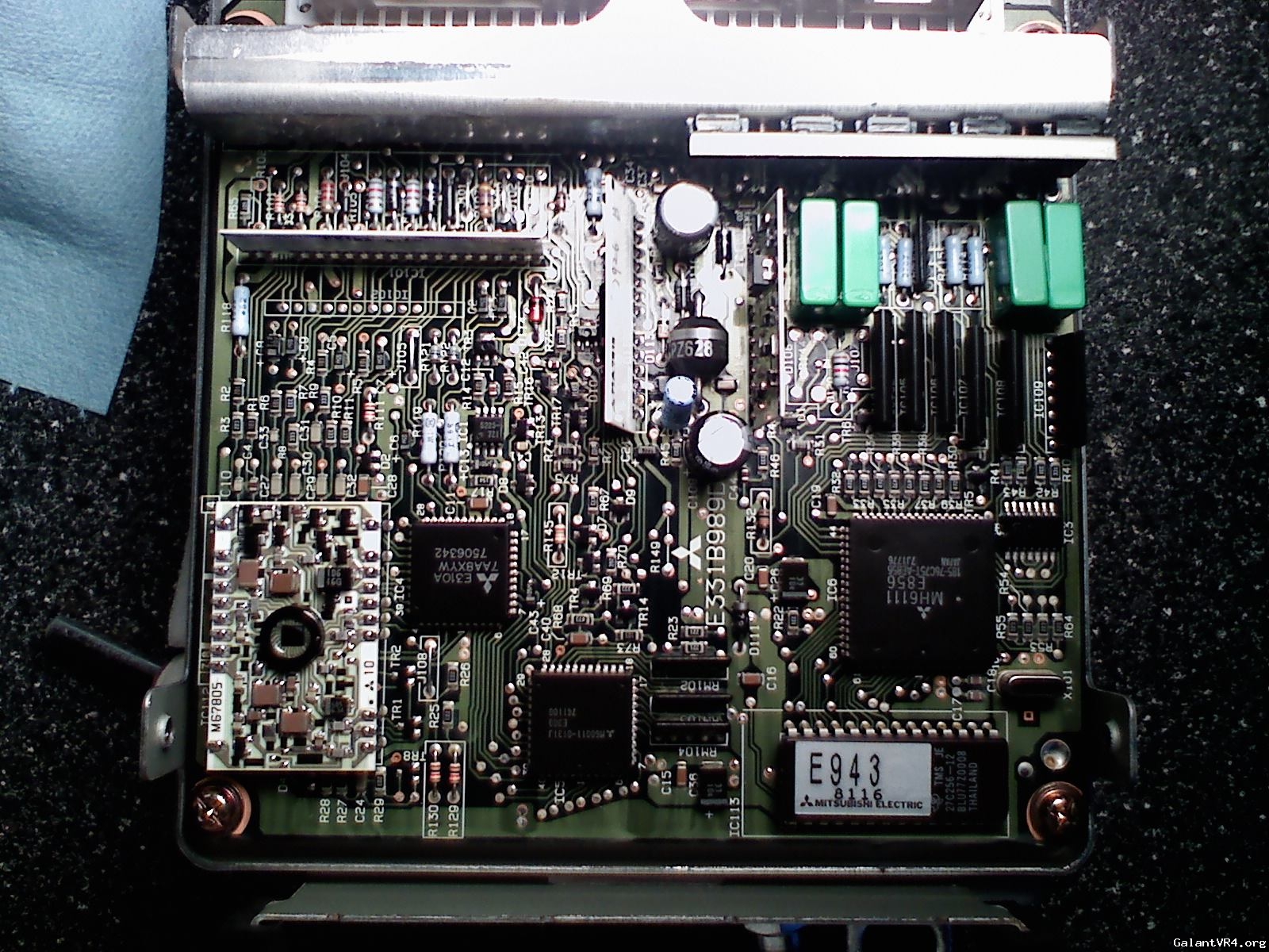

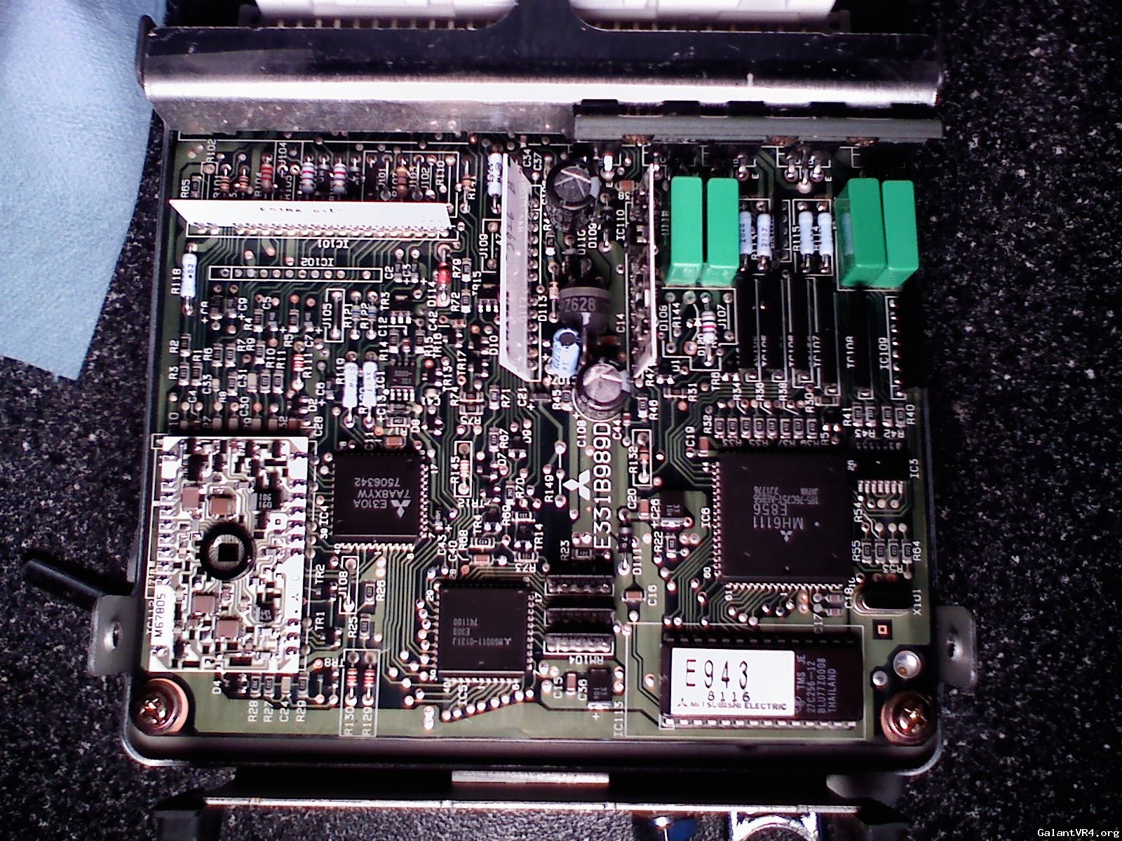

well with all the crap that happened last night putting it back together, its safe to say its just gonna sit. here are the pics and Terry the ecm will be heading your way.
I doubt that is necessary. That appears to be a new factory replacement ECU, so it has no acid damage. /ubbthreads/images/graemlins/applause.gif
You need to keep looking. As I said, the ECU simply grounds pin #56, pulling in the MFI section that connects the +12 volts to the fuelpump. It should be easy to find with a voltmeter and a jumper wire.
