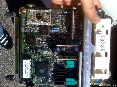

Pull the cover off the ECU and take a picture of the chip. The ECU is to the right of the glove box, behind the passenger's kick panel. You just remove one 12mm nut and one 12mm bolt, and it slides down out of there.

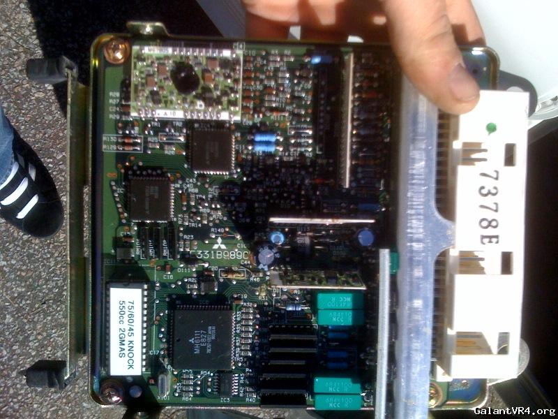

did that first thing this morning before I even saw the post lol
found it has a chip...

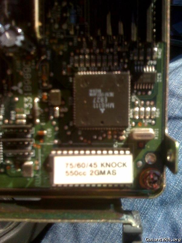

chip says 75/60/45 KNOCK
550CC 2GMAS
any ideas who makes this or what it actually is?

It also looks like the caps have been replaced...soldering looks decent(Im an electronics technician)...Im worried about the injectors though...when I pulled the plugs they all appeared to be evenly burnt, and I am not running lean so I dont know what to think.

If that chip says 550cc on it, I'm sure that's burned for 550cc injectors, and yes like mentioned before someone mixed 2nd gen injectors with 1st gen injectors. Either way their 450cc and yea that's no good. I bet it's running lean, no doubt about that.

So The chip is a Stage Three EPROM chip?

Most likely a stage three chip. I would pull the injectors and look for part numbers on the tops and post them here.
Keydiver might be able to chime in on the chip details.

550's should be easy to find. Check the link above for all the specs on the chip

You should probably find out what's on the chip before buying injectors. 550s will run different deadtimes than what is burned on that chip. Either that or get a chip burned for stock injectors to get you buy. It looks like the guy wanted to keep his 550s and just cramed in there what he had layin around. Before driving it to much either get the right injectors or chip so your not screwin anything up.
