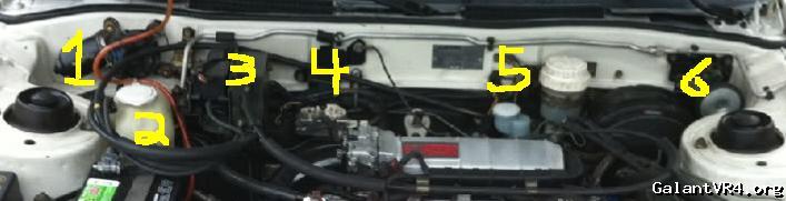

Almost 2K posts in and I don't know what some of the crap on my firewall is... if it ain't broke I guess. Can you guys help me out here on 1) what it is, and 2) what are y'all doing to remove/delete it?
1) Wiper Motor? I don't think we have many options on this one...
2) Washer fluid. Easily removed, a couple bolts. For those that do, where are you doing instead?
3) Cruise Control. Easily removed, requires a non-cruise throttle cable. See how to for detailed link.
4) Transistor... thingie and some other junk on a bracket. Transistor thing maybe bolt to less conspicuous spot, lower?
5) more stuff
6) Horn thing. Is that for teh alarm only? Can it go?

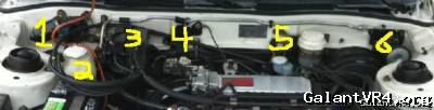

5) more stuff
