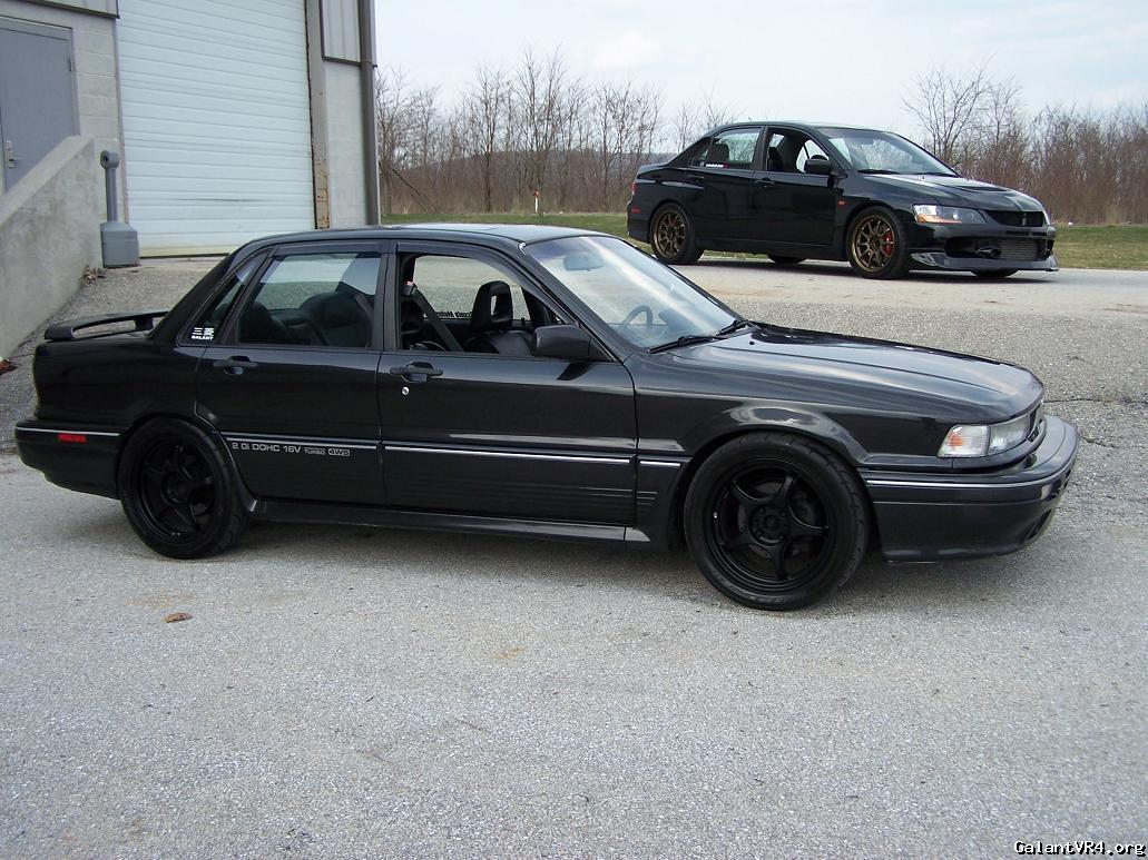

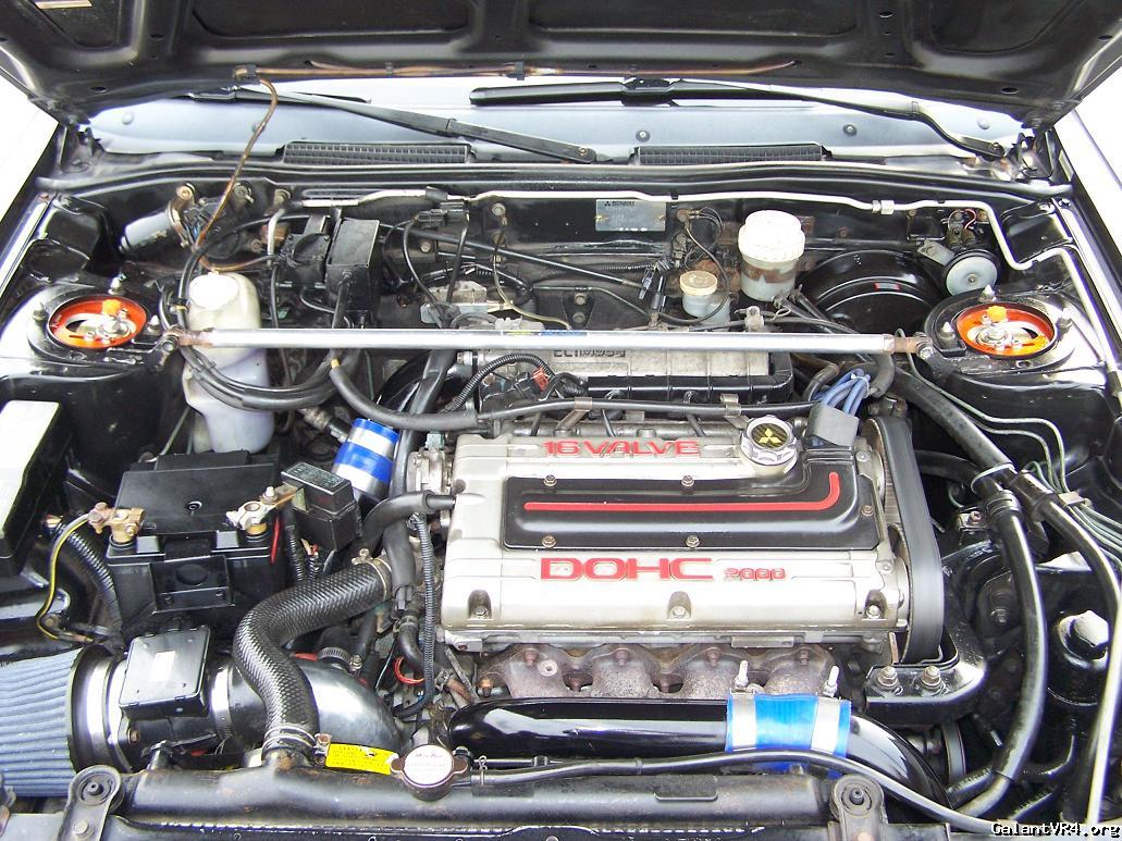

I finally feel my galant deserves to be in this section with more parts to come. This is my DD so nothing too crazy goin on here.
Engine/Drivetrain Modifications:
8.5/1 Pistons .040 over
1G Shot Peen Rods
Clevite Main and Rod Bearings
ARP Main, Rod, Head Bolts
Ported Polished Head 1mm Oversized Valves
3G Lifters
GSC 264 Cams
Evo III Exhaust Manifold
Evo III O2 Housing
Evo III 16G Turbo
ETS FMIC Kit w/Crushed 1G BOV
3inch CM Turboback w/4" tip
Shep Transmission
ACT 2100
4WS Removed
4 Bolt LSD Rear Diff
1G P/S reservoir
Odyssey 925 Relocated Battery
3inch 1G Intake Pipe
Evo VIII Maf
ECMlink V3 (Self Tune 24psi)
255hp Fuel Pump
FIC 650cc Injectors
Suspension Modifications:
K-Sport Kontrol Pro Coilovers
Whiteline 22mm Rear Sway Bar
JDM Spats Front Strut Brace
1G Rear Strut Brace

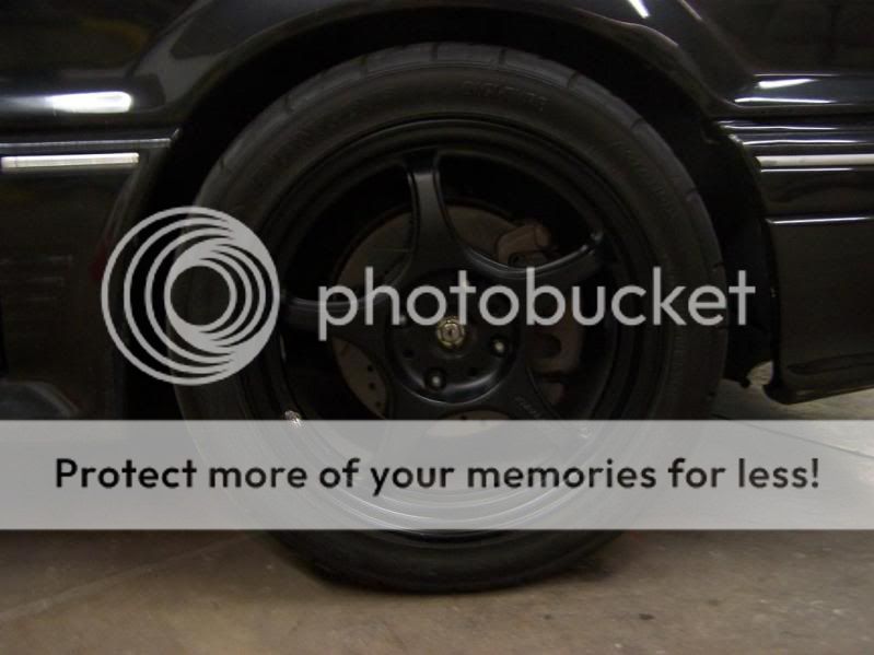

Wheels/Tires Modifications:
195/60/15 Blizzak WS-60 Stock 91 Wheels (winter)
235/45/17 Dunlop Direzza Sport Z1 Star Spec
5Zigen FN01R-C 17X7 +42F +35R Matte Black(summer)
Interior/Exterior Modifications:
JDM "Pre Facelift" Grill w/"Full Time 4WD" Badge
JDM Headlights w/city lights
JDM Single Bulb Clear Corner Lights

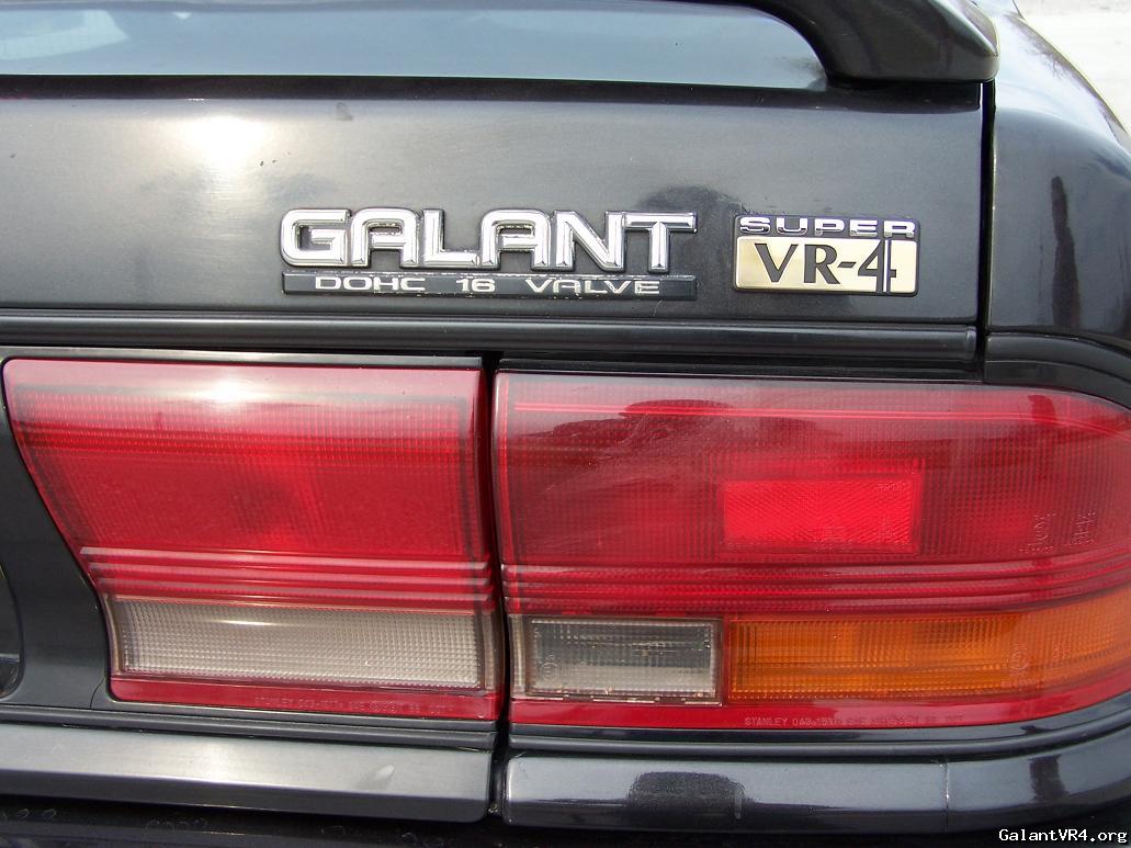

JDM "SUPER VR4" Trunk Badge
JDM "MMC" Badge
JDM Dash Mat
Replica JDM Door Badges
6000k H1/H4
2500k Yellow Fogs
Old School Greddy Profec B
Old School Greddy Turbo Timer

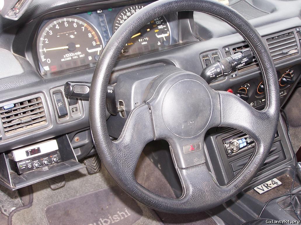

89 Underdash & Glovebox
Stewart Warner 30psi Boost Gauge
1G Steering Wheel
1G Short Shifter
TEL Shift Boot
Evo VIII Shift Knob
(First pics are with old evo viii suspension)
winter trim
