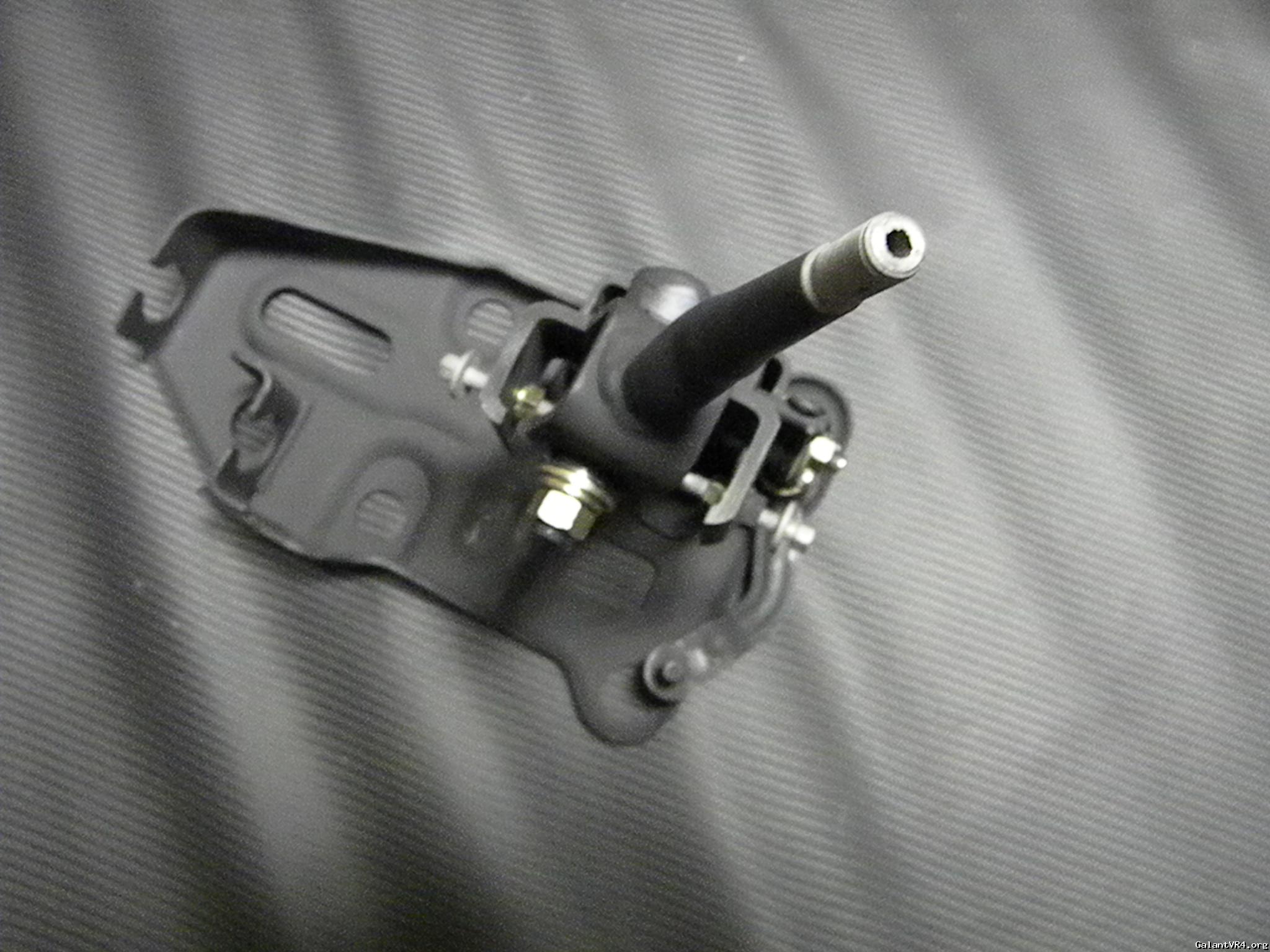

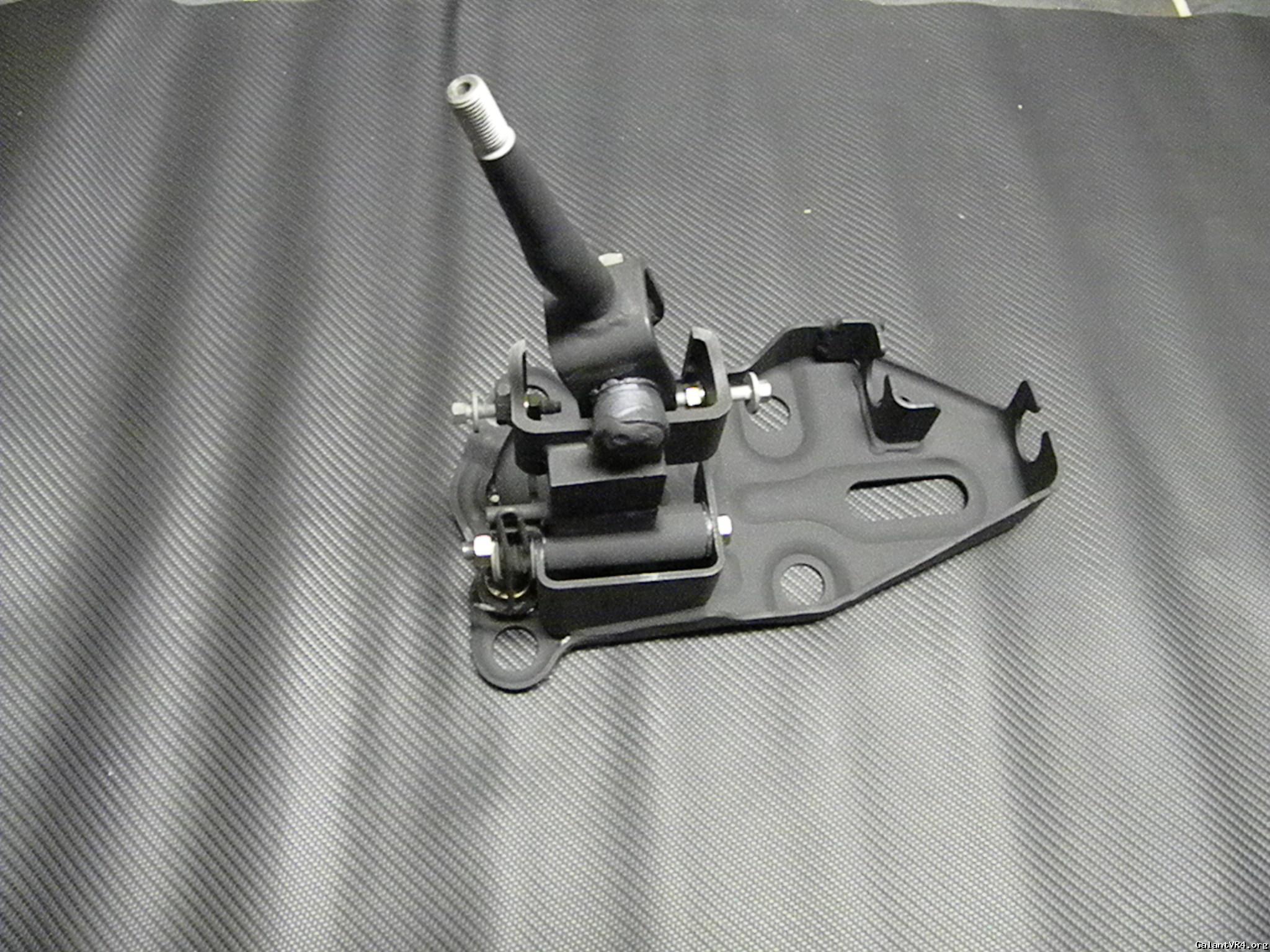

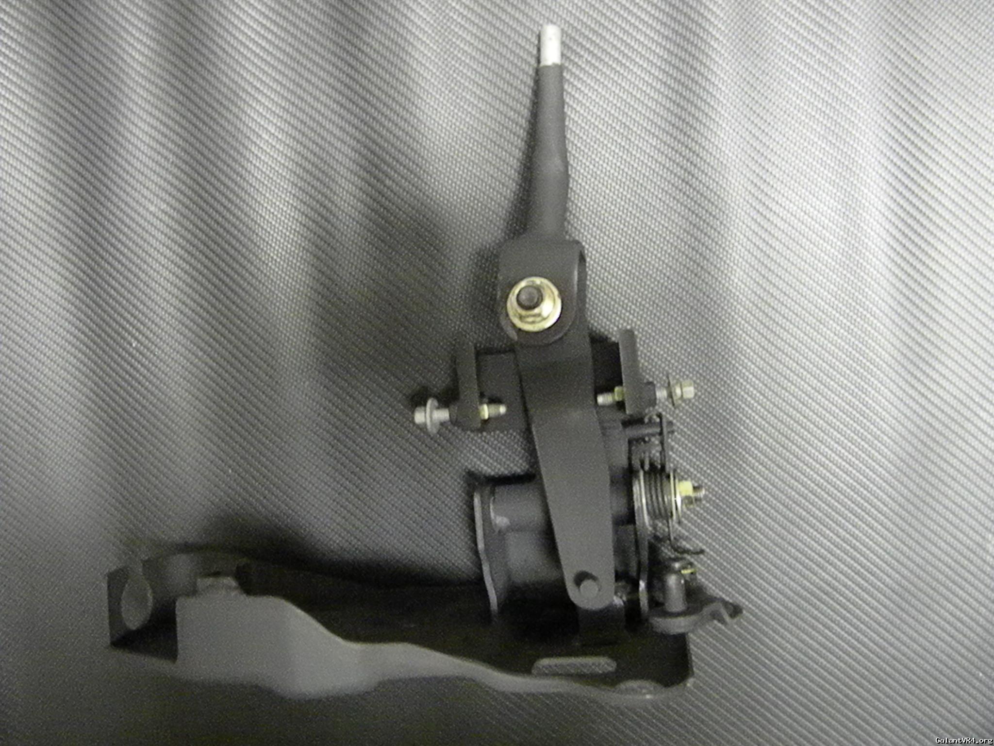

Did this for a member a few weeks ago as i try to work the list of parts wanted down...
It started life as a dsm one and was going to weld on washers to the base but he already had the after market bushings. You can also space it up about 3/4 of an inch off the floor.
This one I cut the handle and lengthen the throw on the bottom one inch and changed the pivot point on the handle one inch and replaced the bushings from JNZ, also machined out a bracket for adjustable stops so there never any worries about over forcing the shift forks and grinding gears into metal chunks. Similar feel to a hurst shifter in a Mustang.
As said above the roller blade bearings work on the cable ends and also the cable bracket on the trans can be modified. Simply remove it and mark with a sharpie fine point marker. Then remove the middle two bolts and stupid rubber spacers and replace with just normal bolts and washers lining up the marks so you don't have to re adjust the cables. Now with it torqued down and tight take it to the welder if you have one and cook the two pieces of metal together. Makes a world of difference.

very nice, How much would you charge to do another one of those for your close kin (474/1000) /ubbthreads/images/graemlins/smile.gif
May 4, 2003
11,892
Clarksville TN
I charged him $140 shipped back to him. You supply the dsm shifter assembly and you pay when I'm done. I supply everything else, wear items like bushings, adjustable stop assembly, paint yadda yadda.
