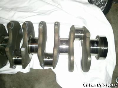

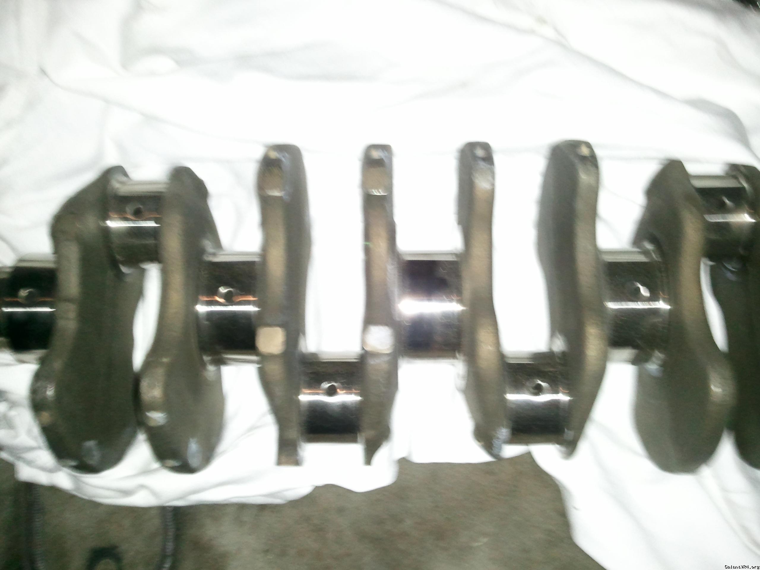

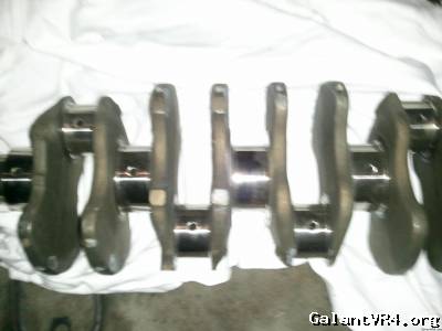

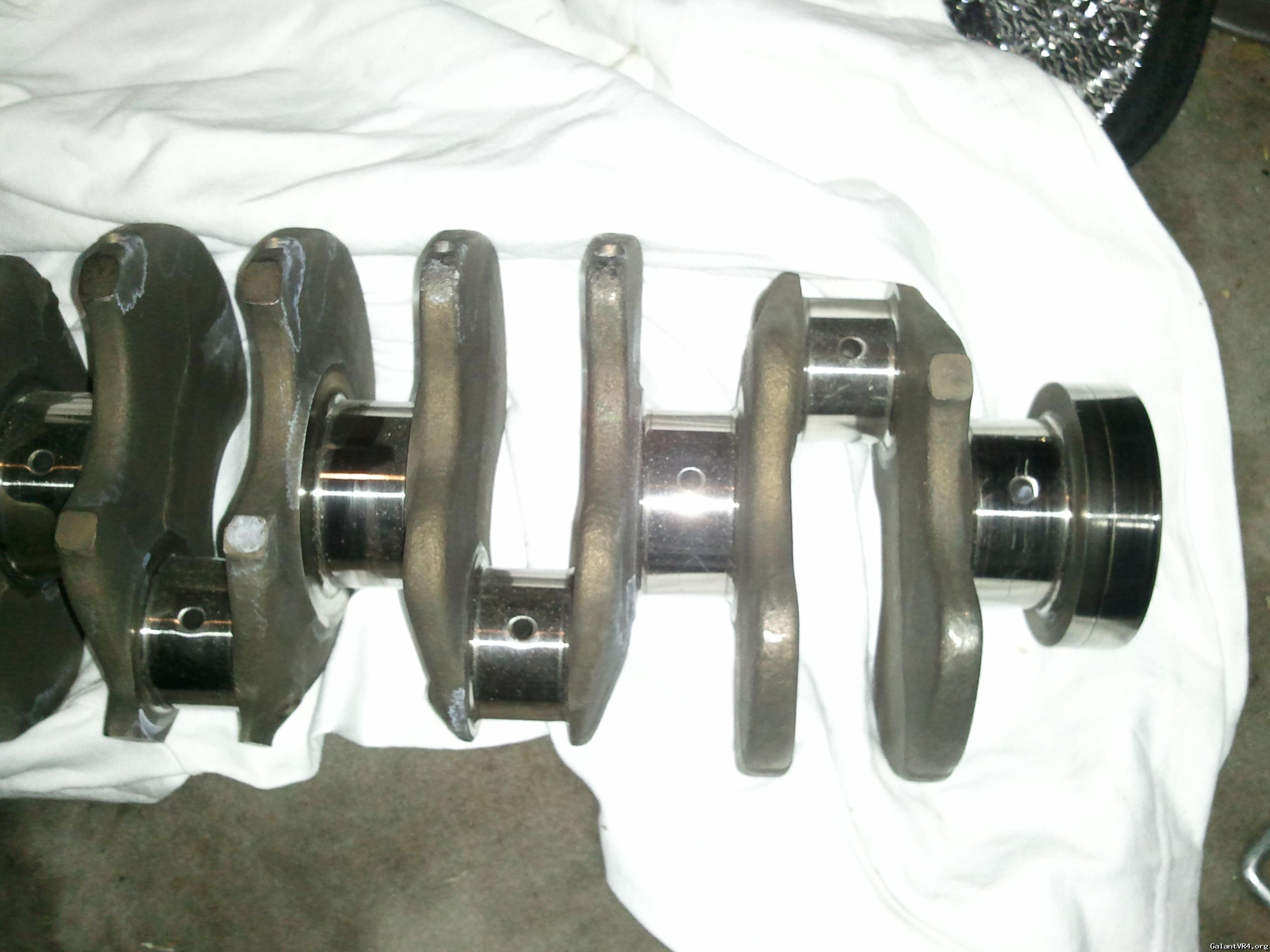

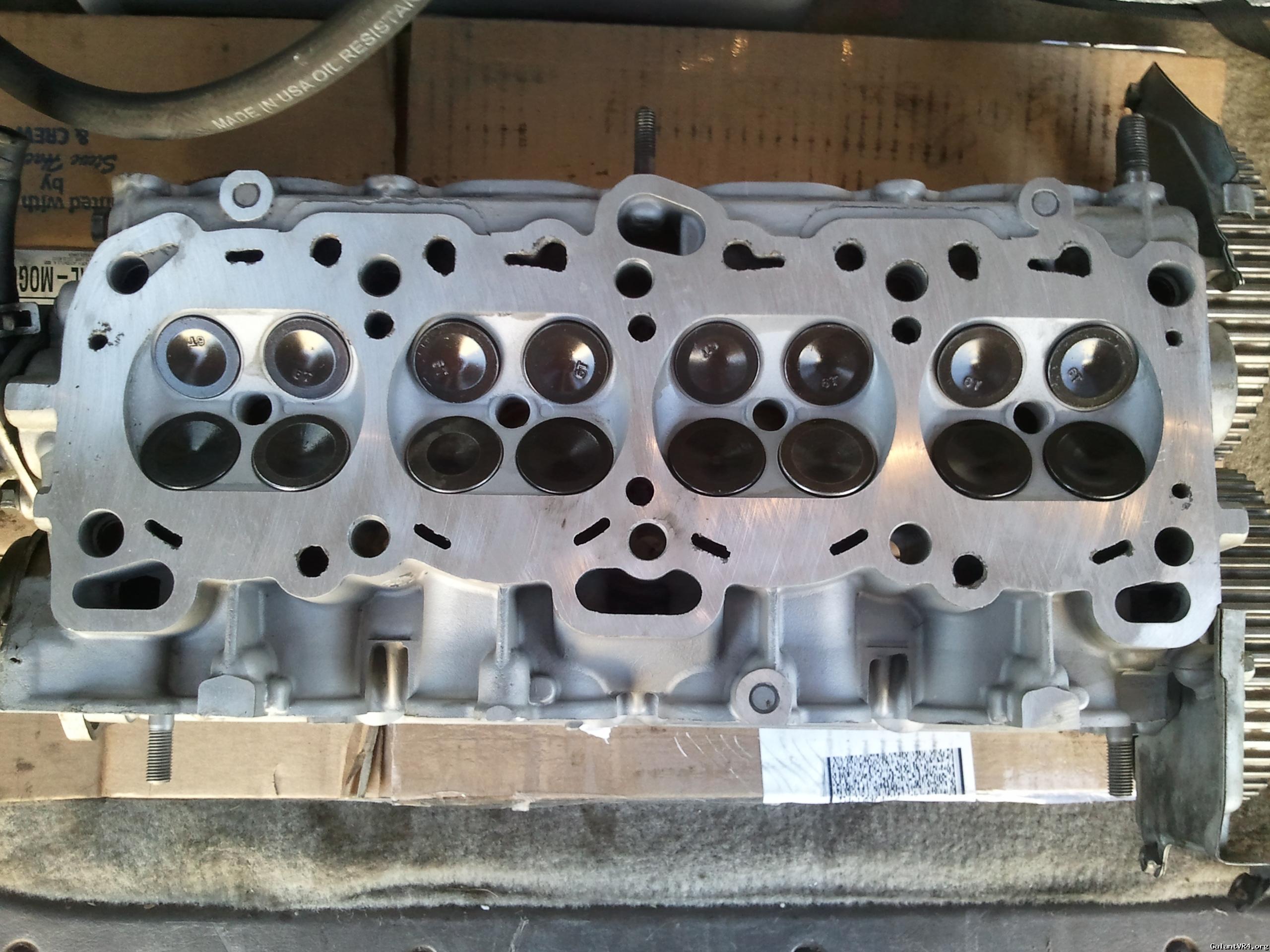

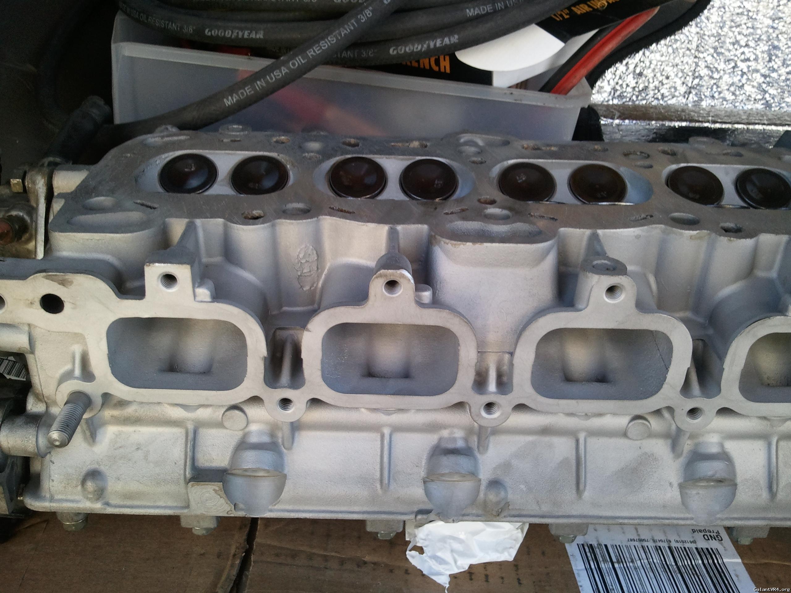

Hello all as you have all seen from my other posts that my motor ceized ( probley spelt wrong) any ways here is an update I got my head back and it looks good for 320.00 and as for my short block new crank,bore,oversized pistons,oil pump, ect 1000.00 I hope to get from locals put her all back together anyways here are some pics thanks to all for your info and as for the spelling nazies out there sory in advance.

Please tell me you have a short block ready to go. Seeing pictures of the crank all by itself makes me nervous. For $1000, you should have got new pistons, rods, rings, bearings, oil/water pumps, back as an assembled short block. If not, you got ripped off (and, if the vendor was suggested by friends, I'd suggest not consulting them about automotive topics in the future).
Let us know what's up. What's important now is you have good parts and it's time to start putting the car back together.

The stock crank ended up being junk so this is a new one I found for him from a local that "should" be good to go as is. He is saying that the total short block once done will be about a 1000.00 A little pricey but a few of the parts ended up being way out of spec and some addittional machine work is needed as well.

The only thing I can think here is that maybe someone screwed you guys on a "good" crankshaft.

No the crank was supposedly looked at by Tony at UMS and the guy I got it from is a pretty stand up guy. If anything I HIGLY doubt he would throw Tony under the bus to make a few bucks. While I can't say 100% that is it fine I don't have a bad feeling about it.
