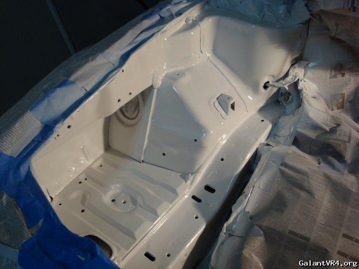

I recently repainted half of my engine bay where the original color was lacking. I used Rustoleum Professional enamel, along with the professional primer. I was trying to match the summit white, and it turned out a little brighter than the exterior, but still looks pretty good. I think that black would not be that hard to match. Just pick up a high or semi gloss to make it cleanable.

all you have to do is remove all the rust completely and sand down the preexisting paint, then lay the primer, then paint. Just follow the instructions on the can. I used a lot of paint (almost the whole can)to make it durable, but 3-4 coats should do it. Looked like this in the end....
