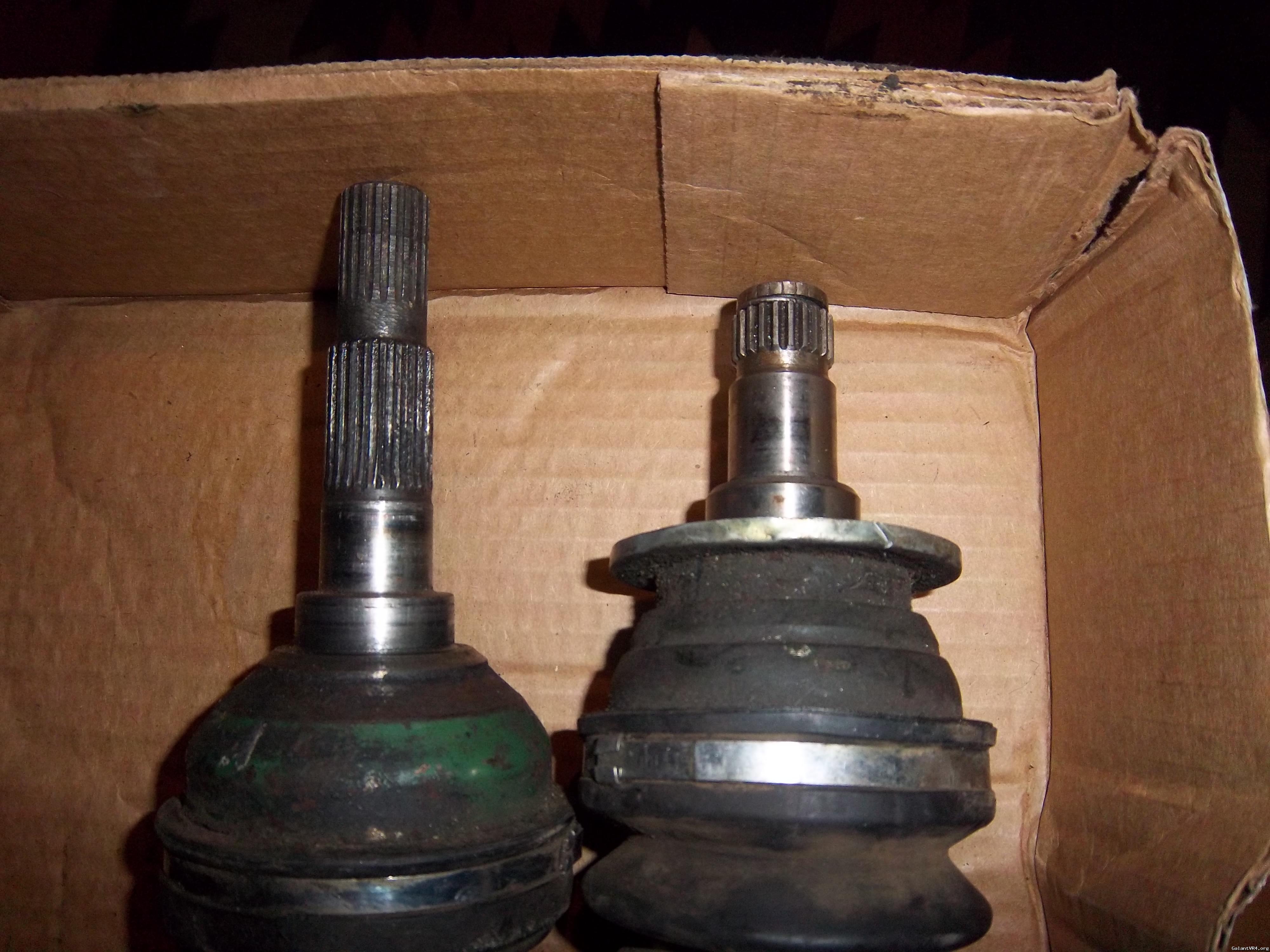

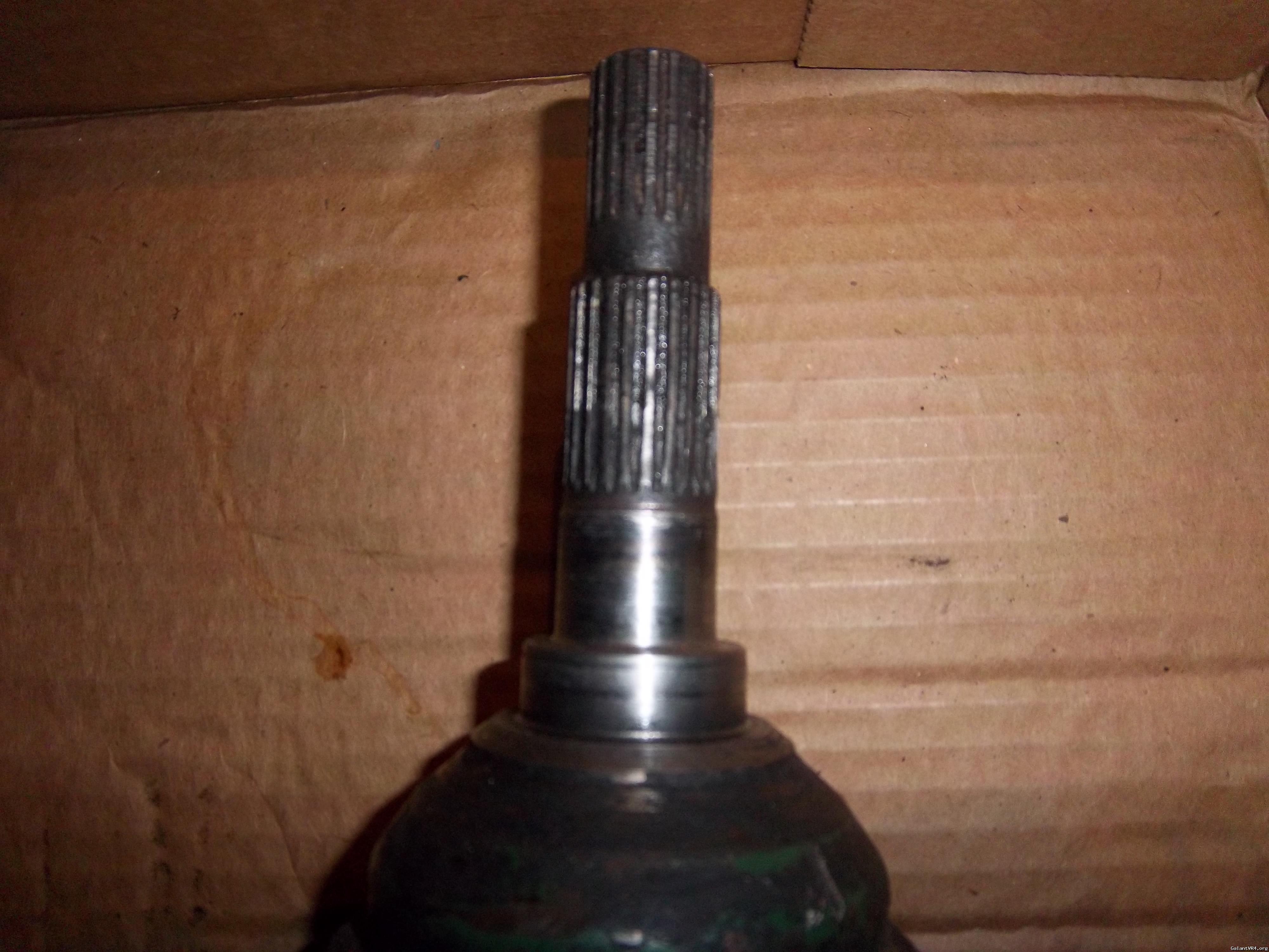

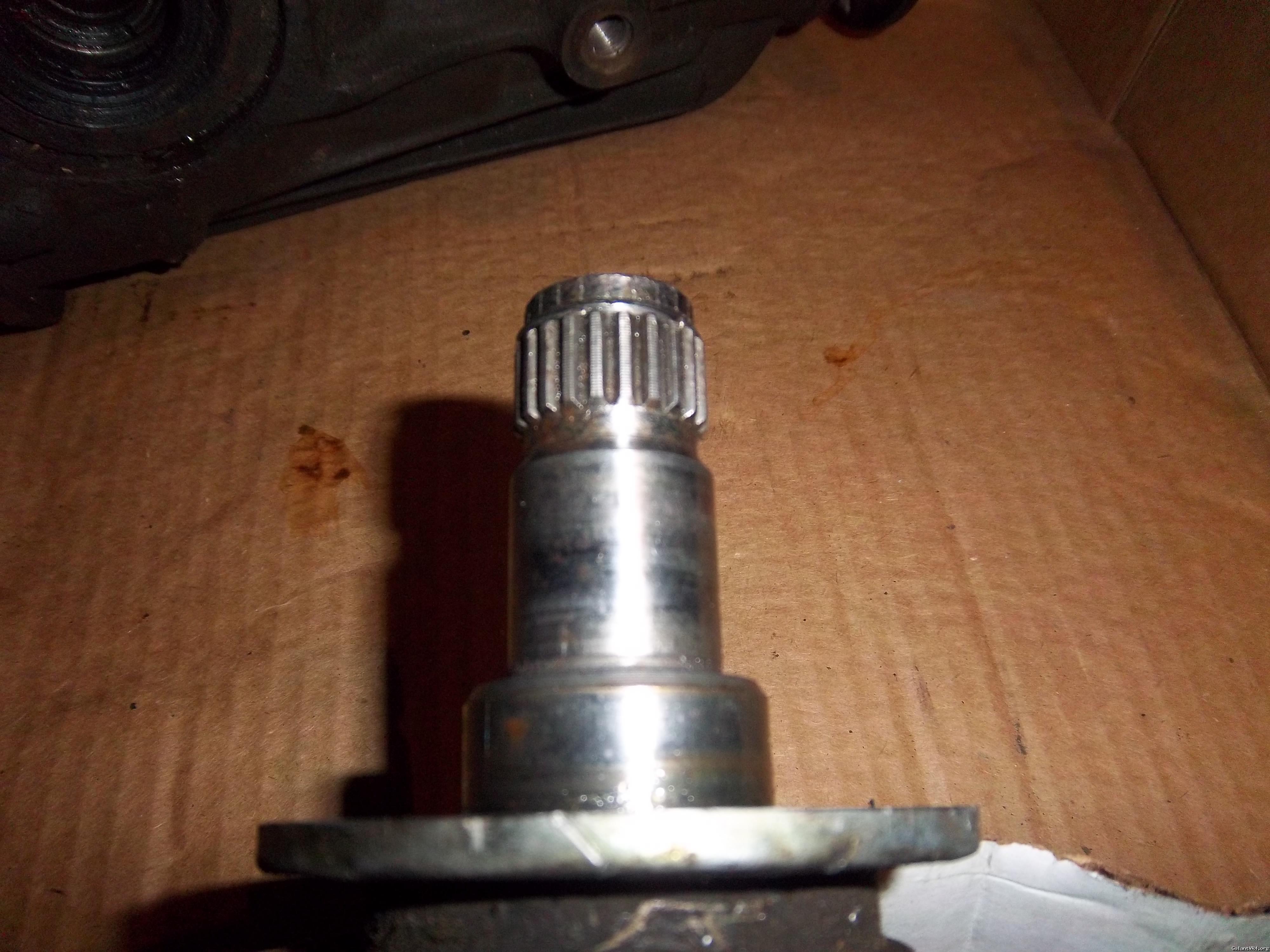

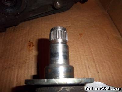

About six months ago I bought LSD gearbox to this machine, and 3 bolt drive to it. Himself reducer in good condition, but the condition of the internal grenades drives are not very good.
Question: do the internal grenades OEM number to order them? We find these parts impossible....
Thanks in advance))

Gearbox with 3 bolt drive.
I think you are referring to the "rear differential" ring and pinion with LSD, 3 bolt axle shafts model ????
Rear axle gears NOT the AWD transmission ???

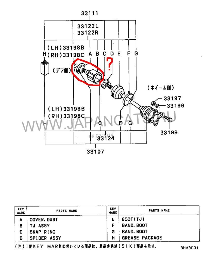

Online catalogue here will help:
click
You need to know what model car the LSD rear differential came from.
Seals for LSD (Limited Slip Differential) and OPEN differential (standard) may be different, I don't know.
FlyingEagle
Mar 5, 2005
1,635
THE Ottawa
That part "B" is likely not available separately.
You will likely have to purchase a whole axle assembly, unless someone has a matching cup they will separate.
