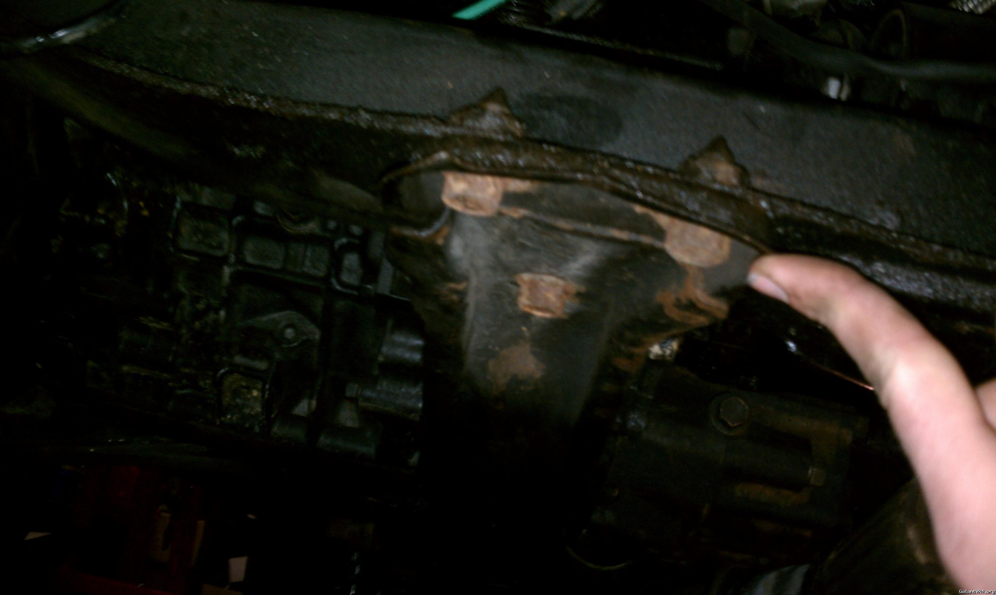

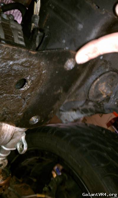

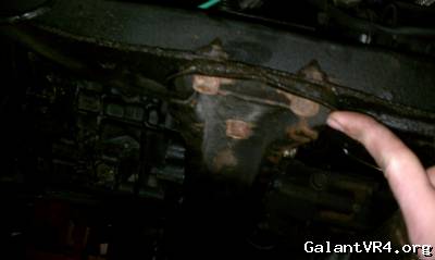

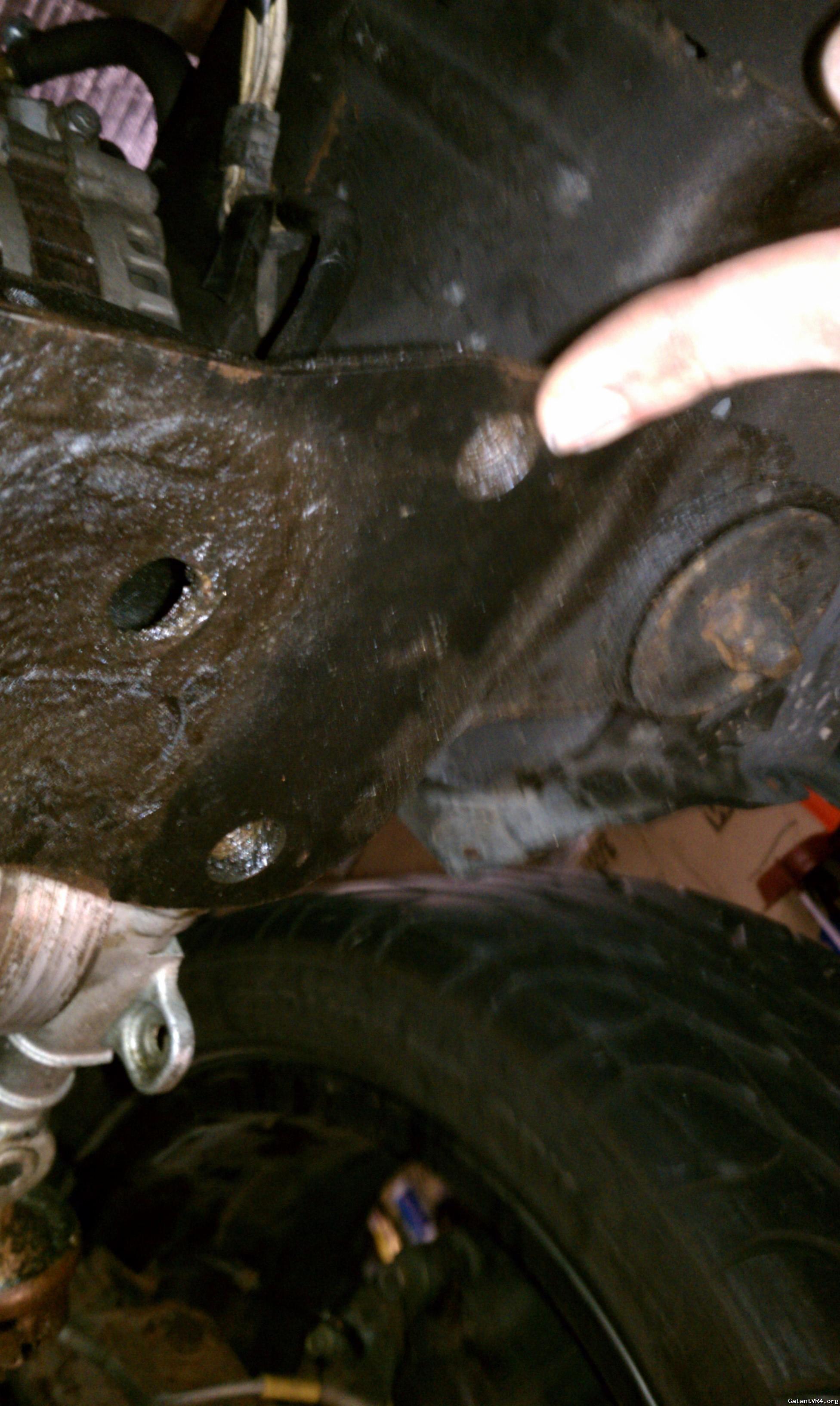

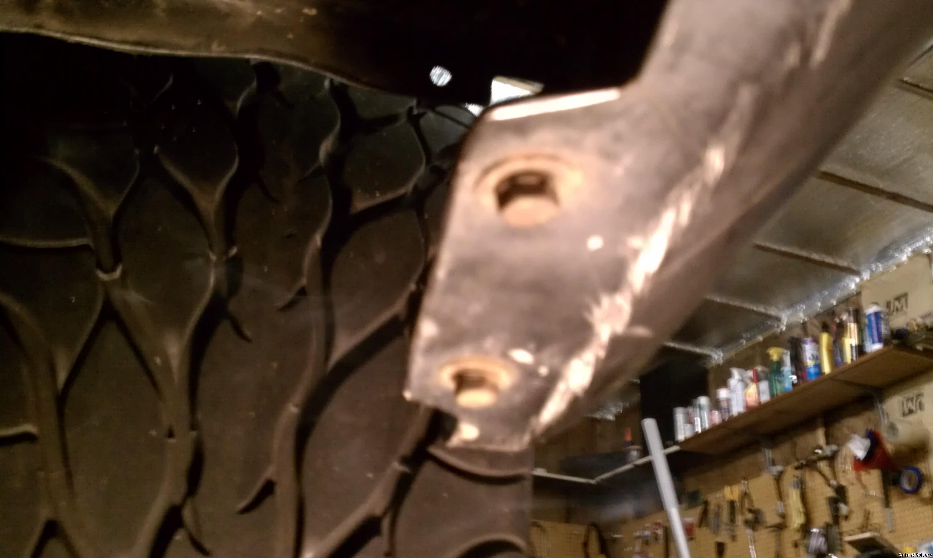

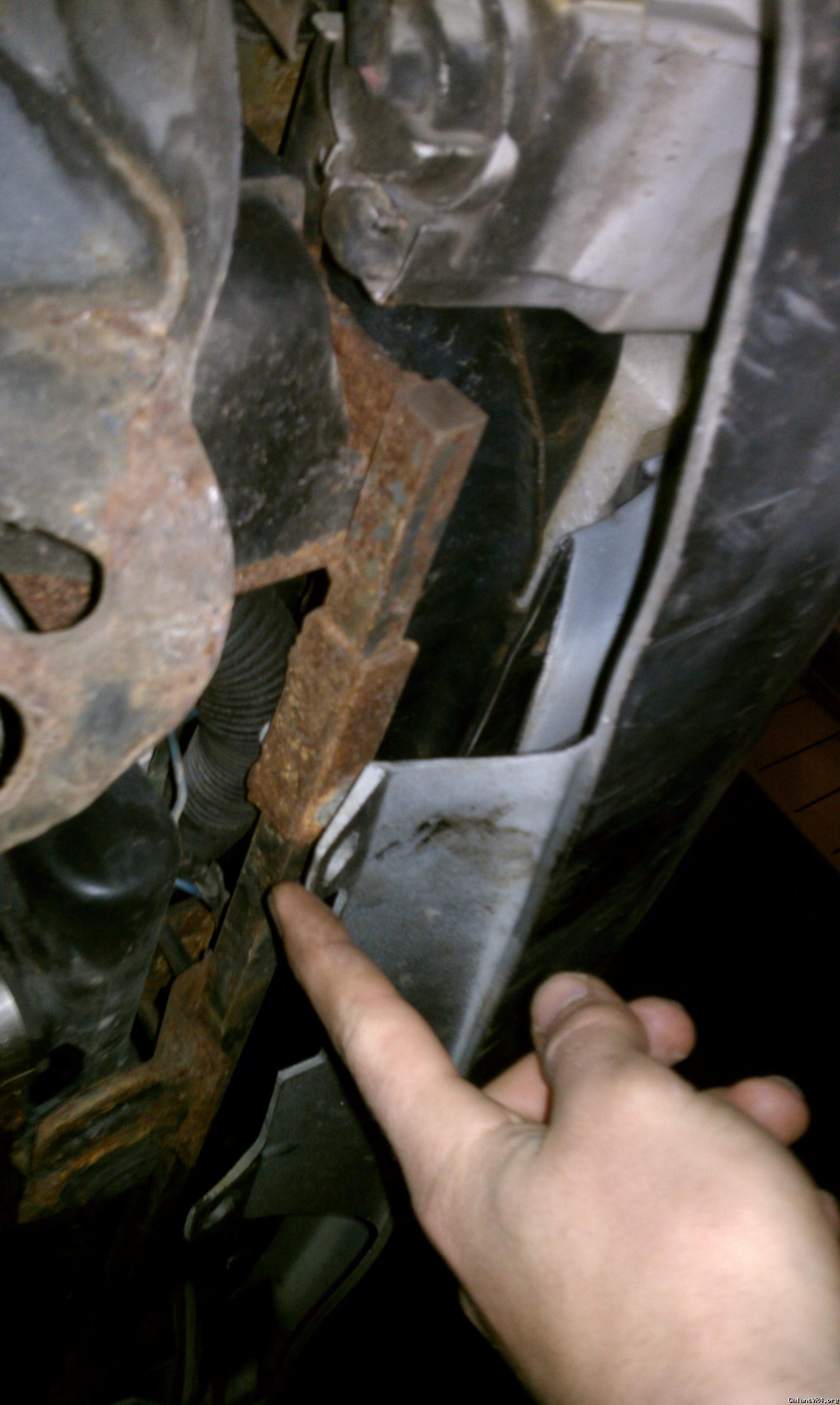

I don't like having everything open to the elements. My plan is to run a piece of aluminum from the bumper cover here:
to the other side.
Cut off these:
and bolt the piece of aluminum to the underside of the bumper cover.
Mount to these bolts as well:
That's the, well I dunno what it's called, engine cradle?
I may also mount to these:
that's the passenger side btw, what are those used for?
