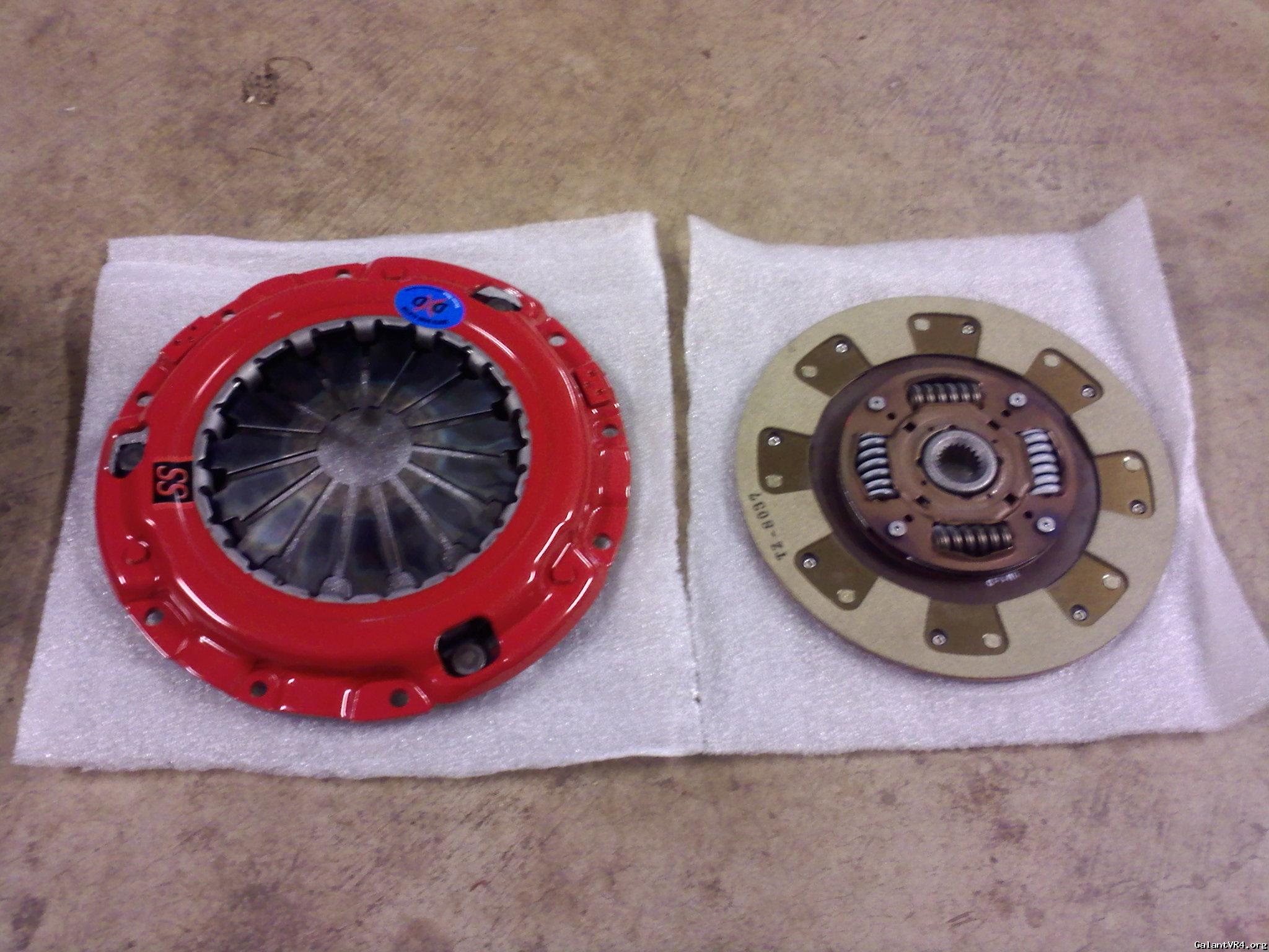

I replaced my clutch with a South Bend Clutch Heavy Duty TZ/B-Series Kevlar/Ceramic Clutch Assembly.

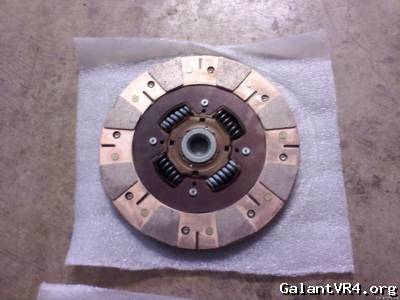

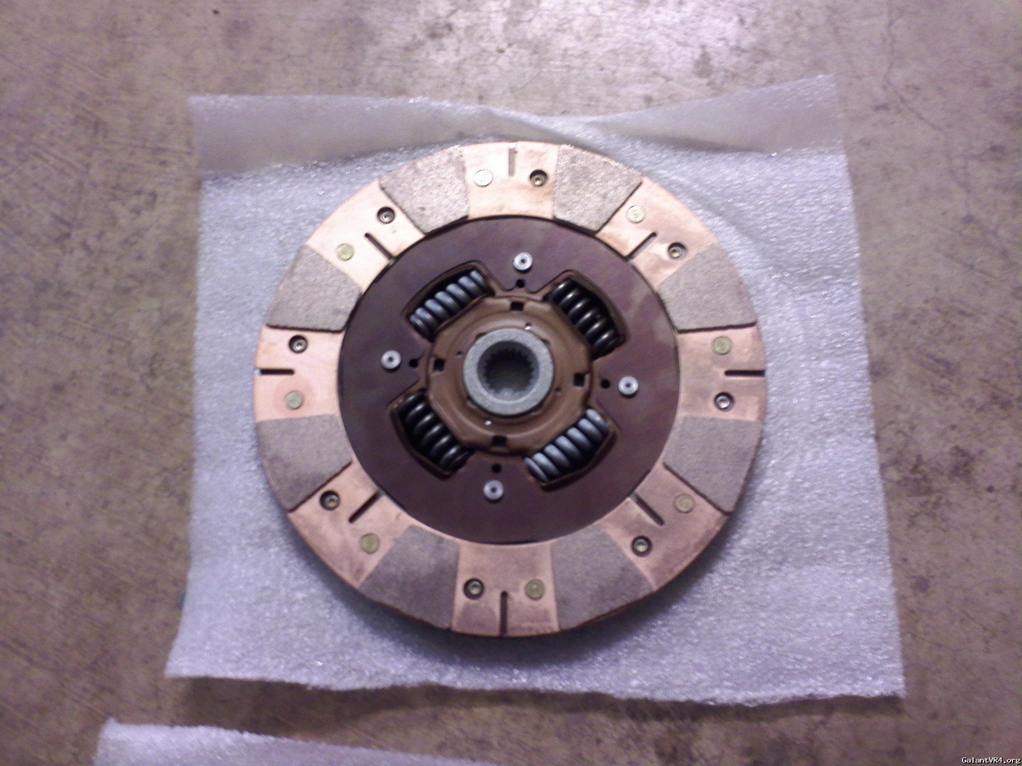

11,990
That's the same clutch I just put in my car, works great with my ACT flywheel. I did shim my pivot ball. Strange though, my disk has the Exedy racing 6-spring hub, not the 4-spring style like yours.

And Mark that is strange considering that we got the clutch from the same place. My disk is an exedy also.

Did you get the SS or the SS-X pressure plate? I can't tell on my phone. I got the SS-X.
I got the SS pressure plate due to me daily driving the car.
