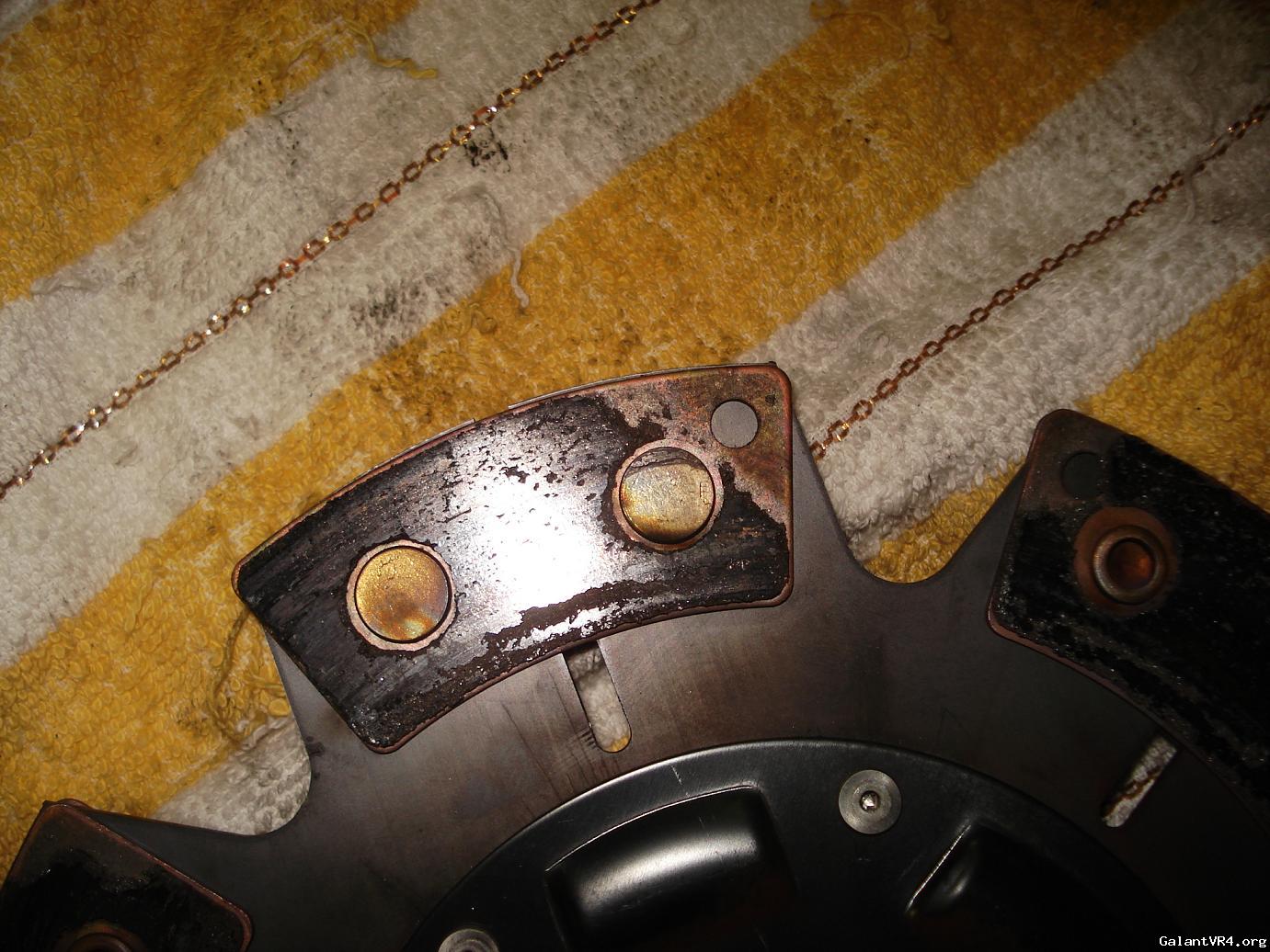

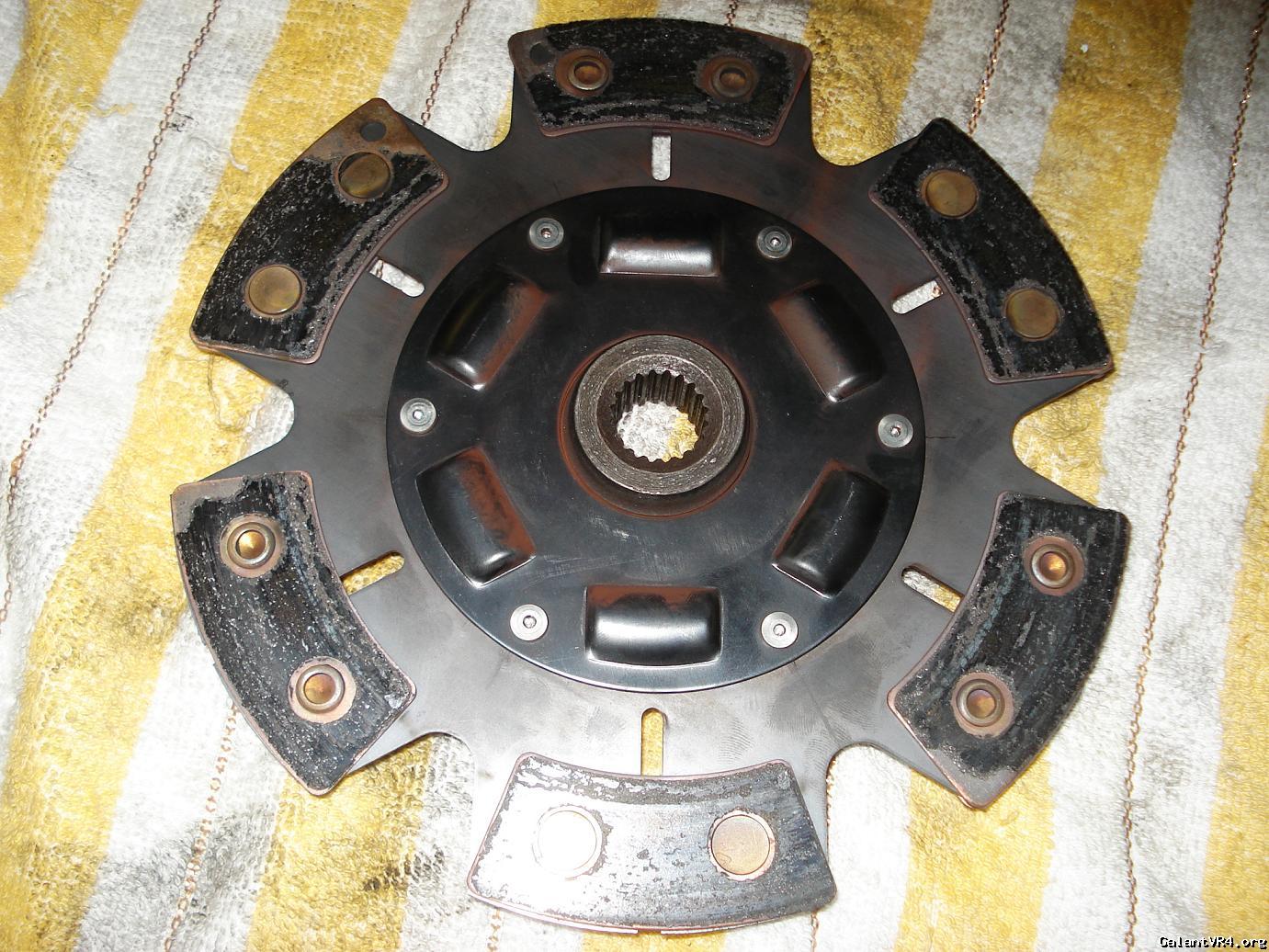

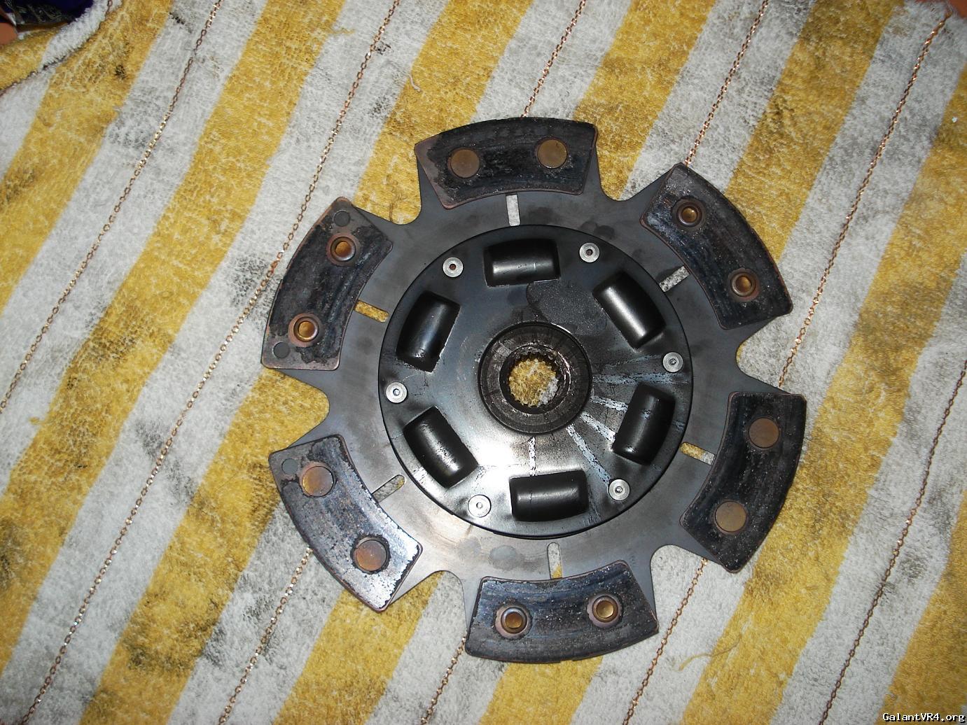

I purchased a Clutchnet clutch about 12 months ago and it has recently started to slip.
It is a sprung 6 puck with a 2x PP.
The car has only done approx 2100 miles since it was installed and I did break it in for approx 500 miles.
The friction pads actually seem to be disintegrating? I do run a Fidanza flywheel as well. I wonder if the screw holes in the friction surface on the flywheel have anything to do with it?
I do drag race the car but I would have though that a clutch would last longer than a oil change? /ubbthreads/images/graemlins/banghead.gif
It has probably been down the 1/4 maybe 20 times in the last year.
I have another clutchnet disc here but if it is going to die just as fast I won't bother installing it. I did notice that neither disc actually has the laser type etching that they show on their website?

In the 4 years I worked for ACT that type of chipping of the friction material happened quite often. In most cases the clutch still functioned properly but if a customer sent one in it was most often repucked at no charge. Contact Jesse at Revolution and he can probably help you with that. You may also want to check the thickness of the pad to see if it was worn down past the minimum limit and caused the slippage you described instead of the chipped pucks.
It's not likely that the disintegration of the pucks was caused by the flywheel bolts.
Daryl
Thanks Daryl, I've just checked the friction surface wear and it isn't worn down as far as the rivets on any pad.
I've sent Clutchnet an email about it but from what I hear i'm not too hopeful about getting a fast reply!
I don't really want to hassle Jesse with this as he was fantastic when the original disc arrived damaged by USPS or Austpost ( not sure which ).
I just want a clutch that works for longer than an oil change that I can play with on the track!

You could use a 2600 with a 6 puck disc (MB1-XTR6), but like I said the chipping can occur on the puck material that ACT uses as well ( they might be from the same supplier) but the chipping exhibited typically does not cause the clutch to slip. If at all possible it would be a good idea to test the clamp load of the pressure plate. Because of your location that may not be feasible.
The other option is get a twin as mentioned by Brian or the ACT when it becomes available. The drawbacks are going to be initial cost along with a great deal of floater noise at idle (more of an issue when standing next to the car than when you're driving the car). Apart from that the twin is a good option for a car that visits the drag strip pretty often. Although I no longer work for ACT if you're interested in the ACT single disc set up PM me.
Daryl

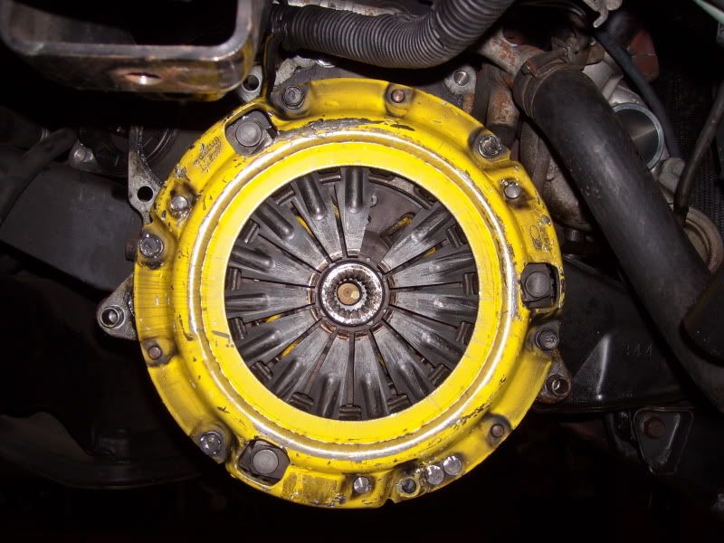

656of1000
Jan 18, 2005
292
Phoenixville, PA
This was my ACT 2600 pressure plate after a year and a half in the car.
I vote for the twin.
