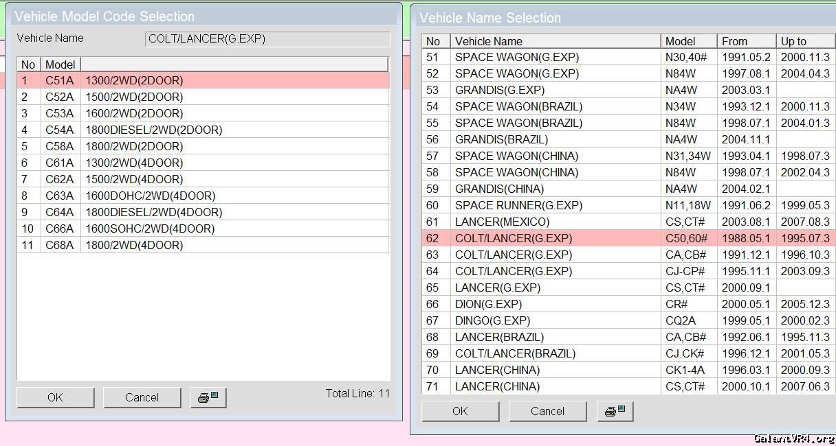

OTOH not definitive, covering the C50/60/70/80 series of cars:
C52a Hatch 1.5 SOHC NA
C53a Hatch 1.6 DOHC Turbo in many areas, non-turbo in Europe
C58a Hatch 1.8 DOHC NA
C62a Sedan 1.5 SOHC NA
C63a Sedan 1.6 DOHC NA - Lilevo type? Also Eagle GS type
C69a Sedan Europe with a 4g93 DOHC, possibly the bubbled rear window
C73a Much like the Eterna version of a Galant, this is the Eterna rear window version of the Mirage 4 door sedan
C83a 4WD non turbo hatch just like the c53a, but with a solid rear axle and matching AWD drivetrain
These are screen shots from ASA, and you can tell the region/type of ASA in the top left hand of each left side window:
