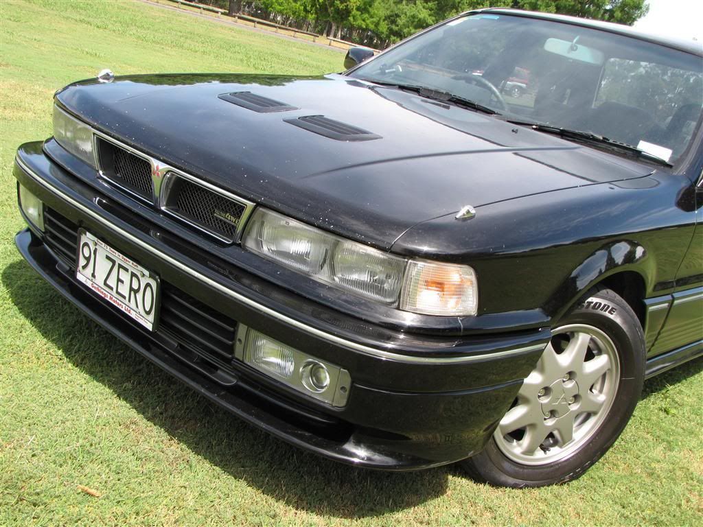

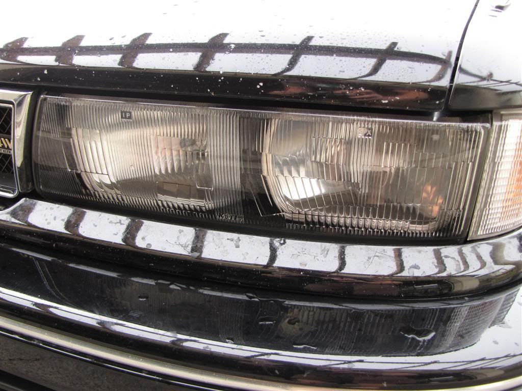

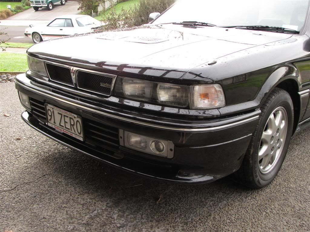

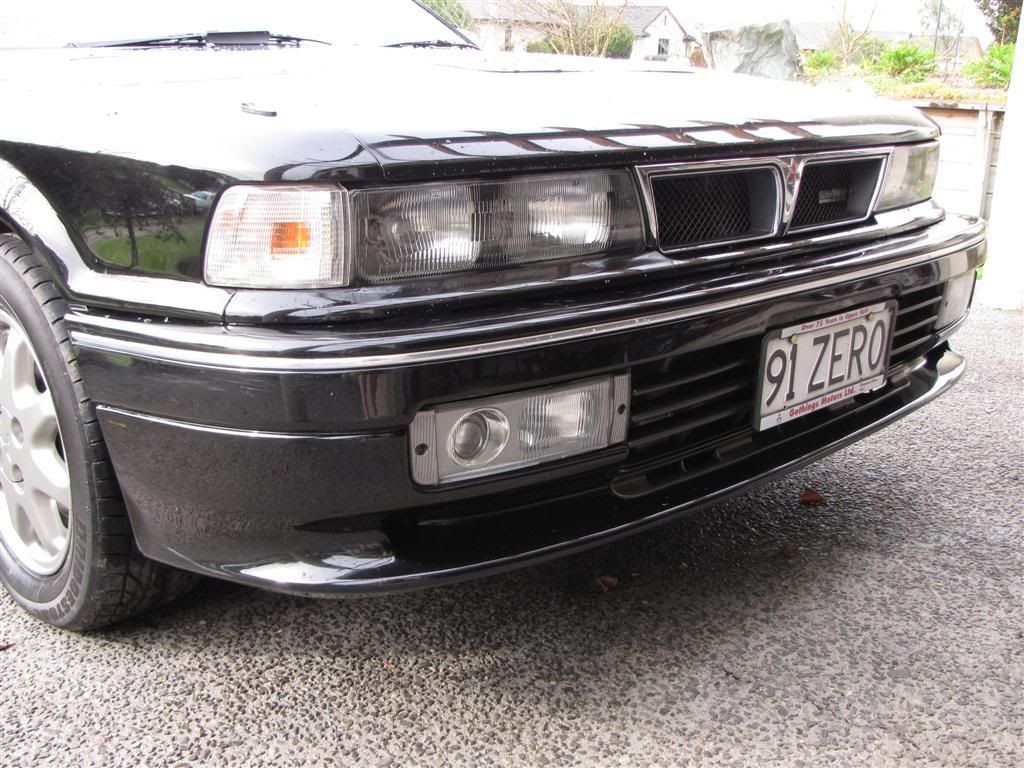

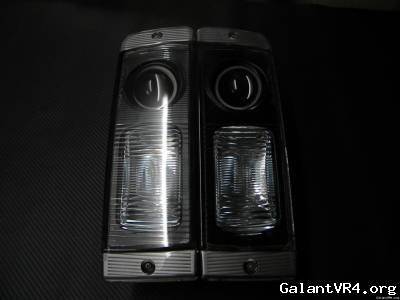

I thought I would refurbish the headlights - I did this to a previous 6G Galant of mine and thought it just updated its looks ever so slightly, and have been meaning to do it to the VR-4 as it looks better on black cars. I pulled the headlights out and put them in the oven to separate the glass from the housings then cleaned/polished up the glass, dusted the dirt off the chrome reflectors and painted the surrounds with high temp gloss black paint.
These are results, which you can mainly see on an angle rather than head on -
compared to before -

that doesn't look too bad but I would darken the end covers as well. How did you manage to separate the glass from the lamp assembly?

I think it has something to do with baking them in an oven at a certain temp, for a certain amount of time..Or maybe thats just for headlights? At any rate I would like to know as well because I have a few sets of JDM projector fogs I'd like to get apart..

You need to ask Curtis, he does it in the oven. He was responsible for these. I can't see how you can change the colour of the end covers looking at them.

I would say you would have to spray over them, perhaps with some kind of tint spray? The blacked out fogs look cool but without those end covers matching they look a bit strange.

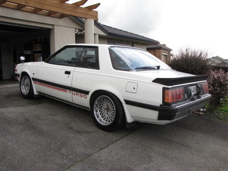

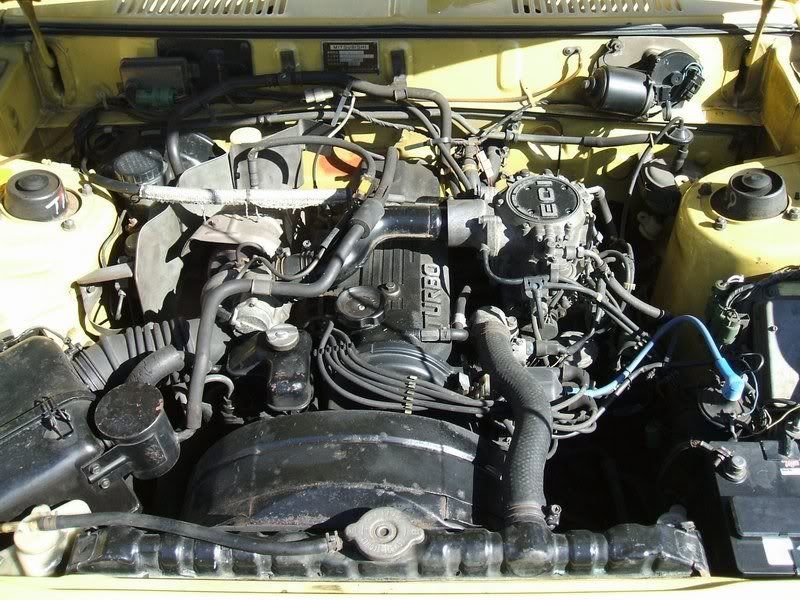

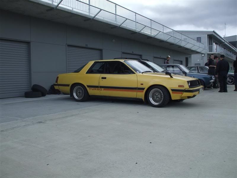

it's a JDM 1982 4th gen Galant GT Turbo coupe. Factory 4G63 (SOHC) Turbo powered, IRS with LSD, four wheel ventilated disc brakes.
I have another as well, a 1980 year Eterna GSR which is the upper spec version of the Galant coupe
Now has something other than the 4 banger in the engine bay
You could actually strip the backside of them then spray black that way they keep the little fluted shapes.

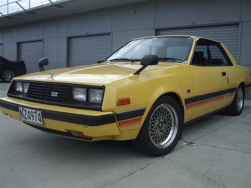

Oh and more pictures of the yellow monster above.
fuel
Feb 23, 2009
2,165
Toronto, ON, Canada
as requested :p

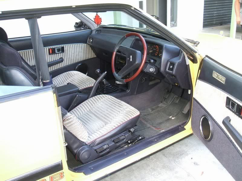

how I picked her up in 2007, only one previous NZ owner (came in from Japan in 1987), 128,000kms (just less than 80,000 miles)
custom built some coilovers using the original strut housings (has macpherson struts on all corners much like the 5G/6G Galant)
had 15x6.5 volk mesh rims for a while
then got some 16x8 0 offset rear and 16x7.5 20 offset front SSR star formula rims

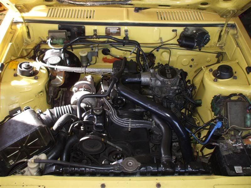

at that point I had fitted a FMIC and 2.5" mandrel bent exhaust system, a TC06 turbo (as opposed to factory TC05) and raised the boost a little

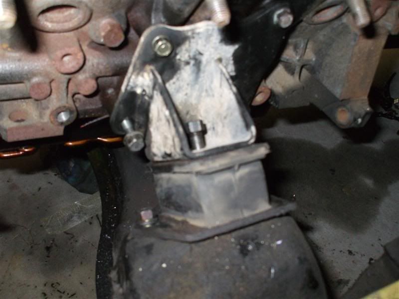

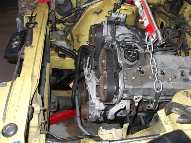

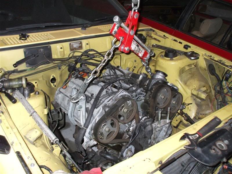

I was going to do a DOHC head swap using an Evo III head and inlet mani, but decided to do something totally different and fit a 6G72 MIVEC with turbos, picked up two donor engines - a 3000GT/GTO twin turbo engine and a JDM F36A Diamante 30M engine
am using the MIVEC engine more or less complete but will be using some parts from the 3000GT engine such as the inlet manifold. In hindsight I probably had no need to purchase a whole 3000GT engine.
used Montero engine mounts to bolt block to original crossmember
still needs a little bit more modification for the engine to fit snugly, such as the sump needs to be notched, and fit a smaller length clutch master cylinder (looks like a Toyota AE86 one will do the trick). I also need to purchase a gearbox, will be using a Toyota R154 and with a Montero auto bellhousing will fit the box on using a 1UZ->R154 adapter plate and concentric throw out bearing.
Basically I just need time, money and motivation to get back into the project! I purchased the white Galant GT beginning of last year to have as a run-around hack while the yellow car was off the road, but have decided it's better off selling it and freeing up some funds for the Eterna project.
