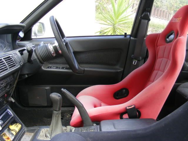

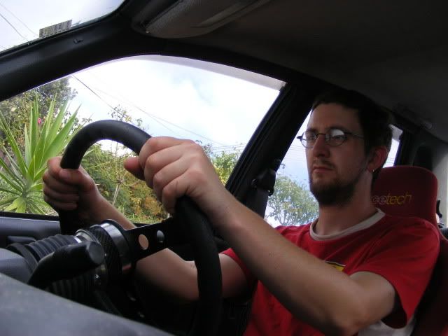

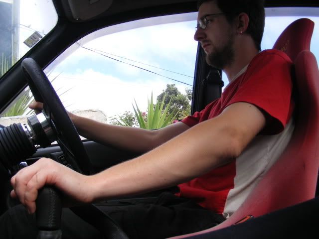

H05TYL, any pics o fthat hub installed on your car? How far out did it bring the wheel? It looks pretty thick.
H05TYL
Jun 9, 2007
752
Wgtn, NZ
Just went and took some, the QR adds 2.5" (75mm) between the boss and the steering wheel, personally I found this a good thing. With the lowness of this seat I could really do with the steering column coming down another few inches also.
