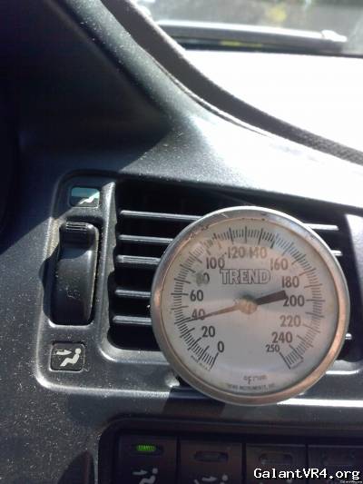

I'm using this stuff works good so far still messing around with it cheap available almost everwere and doesn't hurt our OZONE!!!
This is on a 93 MX6 with 220k + miles so might need to replace some parts to make it cooler.
marvinmadman
Nov 10, 2003
2,355
Lafayette, Louisiana
I'd be perfectly happy with 98° with that low humidity. <img src="/ubbthreads/images/graemlins/worthy.gif" alt="" />
